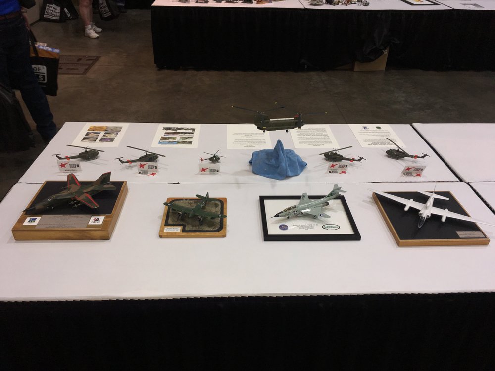

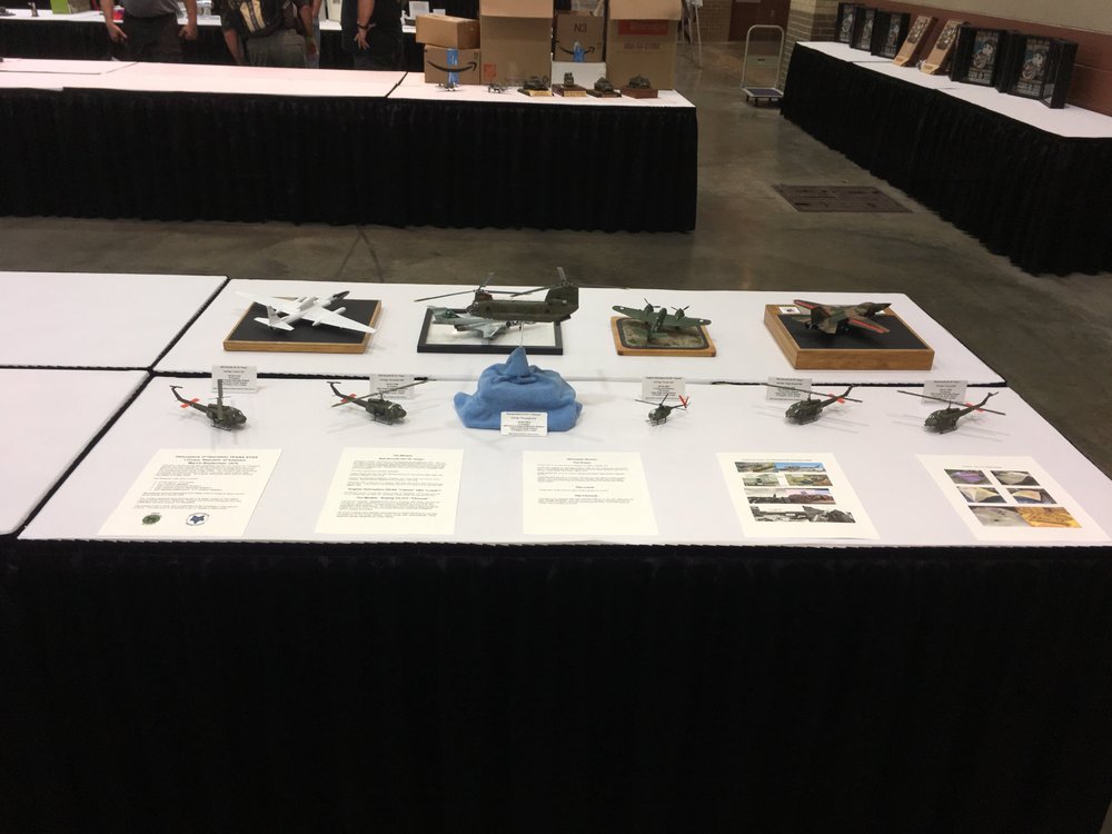

I'll play... My models on display. The Hasegawa Beaufighter illustrates part of my "Model Building 101" seminar, as does the Revell Voodoo. The other two were long-term projects that finally got off the bench and on to display bases--the Hasegawa F-111F was built as "KARMA-52", the aircraft lost during Operation EL DORADO CANYON, and the ER-2 is Special Hobby's kit. They're all in 1/72 scale: The helicopters--four Hasegawa UH-1H Iriquois, and an Italeri OH-6A Cayuse and CH-47 Chinook (backdated from CH-47D to a CH-47C "Super C") for the Fire Support Base RIPCORD project, then still in progress. If you want to see the completed project, we have a Facebook page dedicated to the project, and it is also going to be the centerpiece for the Vietnam display at the South Carolina Confederate Relic Room and Military Museum in Columbia, SC. The helicopters are a tiny part of the 1/72 scale diorama, and were built by various members of the clubs involved. I built one Huey and the 'Hook, and painted all of them. Decals, like most everything else on the project, were bespoke--Jodie Peeler did the artwork, and Michael Portaro of IndyCals printed them. (You IPMS/AMPS dual citizens are reading about it in the latest issues of the Boresight.) I can't knock anybody who puts together a display featuring the High Hatters. Insanity in brass. -
