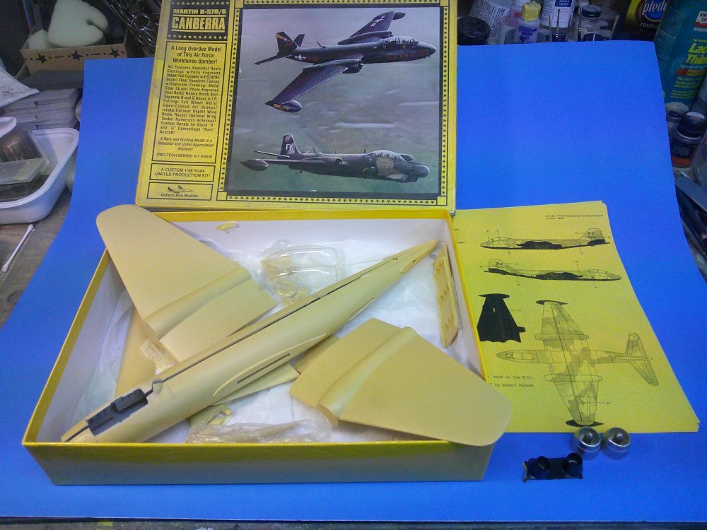

While I'm on my "Canberra kick" and since it's been a while since I posted a full build ride-a-long, I thought I'd show how this model was being thrown together. The Falcon vac Canberra kit was made @1984, long before the Classic Airframe and Airfix kits were available. It's actually designed so you can build an RB-57B with the "fishbowl canopy" (my plan, and as shown in the drawing) or a B-57B with the tandem seating and traditional long canopy. In this pic the parts have already been removed from their backings and sanded down. Also, on the far left you can see that I had to stack and superglue two concentric cones together to make the engine intakes for each wing. The smaller parts with a "E" on them are the exhaust fairings for each wing. There was one unplanned complication due to this kit sitting in my stash for almost 40yrs..... The parts were on 3 sheets of plastic. It seems that the one sheet that faced out and was exposed to the most light through its plastic baggy turned a bit brown and also became somewhat brittle after all those years! If you look very closely at the wing bottom (2nd from the left) you can see a crack where the it broke in two while I was trying to flex it off of the backing. There were also smaller cracks along the edges that have complicated the build more than anticipated, but nothing superglue cannot overcome! The 2 pics above show a couple of interior circular bulkheads added to strengthen things as well as the wing spars made to make the wing attachment more secure. The tail spar is simply a piece of sheet plastic bent to shape. The thin strips of sheet plastic added under the long fuselage seams in an alternating manner can also be seen. These enable the fuselage to be fitted together and prevent the thin edges from sliding under pr over each other. The resin nose gear well is from an aftermarket set made for the Airfix kit. I've also roughed out the opening for the fishbowl canopy and sawed off the solid nose in prep for the clear recon nose. These 2 pics show the test fitting of the assembled wings and tail planes to the fuselage as well as checking the sit of the model on its gear. The resin gear bays in the wings are aftermarket parts with some modification to the main gear leg holes so that my scratchbuilt gear legs will fit into them. At this point the gear legs are just basic parts without any of their detailing or actuators added yet. And yes.... there is a HUGE nose weight sitting in the fuselage to get that model to balance on its gear! Time to start working on the cockpit! Interestingly, the RB-57A was either a 3 seat arrangement (when designed and used by the Brits) or a 2 seat arrangement after being bought by the USAF in the late 1950s. Also, after some research, it seems that the USAF RB-57As COULD have a small window on each fuselage side behind the pilot or it might not, and it appears to be entirely random and arbitrary. So..... why cut and add windows if I don't have to? Also, why build anything behind the pilot's cockpit if it can't be seen anyway? On to the pics! The RB-57A appears to have had some sort of lining inside the fuselage, so I grabbed some fabric from my spares box and cut it to fit in each fuselage half. I used some sheet plastic and spare resin and plastic parts to add some detailing here and there. The wiring is all lead solder wire. Note the large fishing sinker that has been flattened with a hammer and added for nose weight as well as the support for the cockpit floor. The cockpit floor was made from sheet plastic. Its shape was attained through some judicious measuring as well as simple trial and error until I got what was wanted and needed. Note that the side console, main instrument panel, and other details are all spare resin parts. I cut and bent the main IP to give it the RB-57A's distinctive bend. I also added punched plastic discs for the instrument housings on the back of the panel as well as their cables made from more lead wire that was twisted together and routed over and down out of the way; all of which is visible from above through that big fishbowl canopy. Spare PE panels flesh out the side console. The rest of the cockpit parts are all from the spares box, as is the resin ejection seat. And last, note that the entire cockpit is offset to the left to allow for passage from the rear cockpit area all the way into the nose. Test fitting it all into the fuselage....... This should be enough to satisfy any prying pen light once it's all painted, although it's technically incomplete (without the rear cockpit section) and only "ballpark" accurate! This pic shows the addition of the engine intake housings and the exhaust fairings to the wings. As you might expect, their fit was marginal requiring some epoxy putty (Apoxysculp) to blend them in and eliminate steps. There's a home cast engine fan face in the rear of each intake and you can see the separate shock cones made for each one, designed so they can be added at the end of the build. The shock cones came from the spares box, but I did have to shorten them and use Apoxysculpt to give them their "bullet" noses. The exhausts each have some plastic hypo-tubing to give them some depth as well as a spare parts flame dampener up inside each; again just to satisfy any probing pen lights! Except for having primed the wings, that's where things stand as of today. Next up is to paint the cockpit parts and then assemble the fuselage, which I hope to have done by the end of the week. More pics when more significant progress has been made. Questions, comments, and critiques welcome, as always! Gil

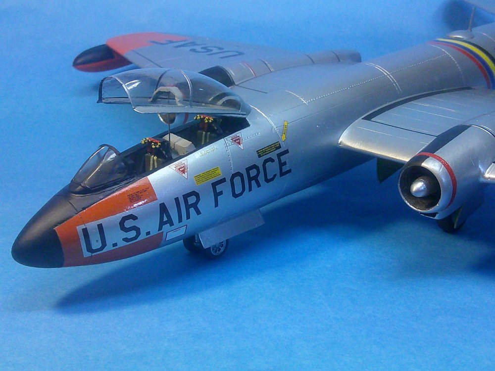

Thanks for the kind words Ron and welcome back from Telford! Most all of my Model Master paint seems to be doing fine, though the International Orange was slower drying this time than anytime before, even with my usual thinning with lacquer thinner. I skipped a panel wash (it just looked good clean to me!) so I'm guessing you mean the thin black wing walk lines...... those were done with decals, specifically the ones that are supplied in the Classic Airframes kit of the B-57B, except for the thicker ones near the wing roots which were cut from a sheet of solid black decal. An oddity I forgot to mention above was I didn't have enough "2"s for the BA-242 codes. The last number on each side is actually a "5" that was turned over and applied backwards and upside down to make it into a 2! It passes a quick eye test but can be discerned if you look closely! 😁 Cheers! Gil
