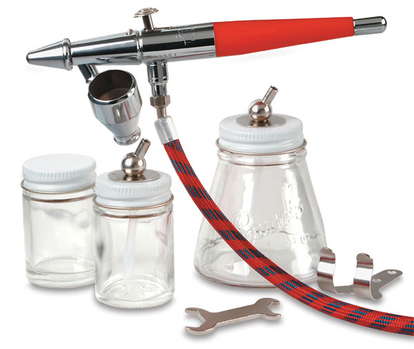

I have a Paasche H,
…a Paasche VL,
…an Iwata HP-BC,
…and an Iwata Eclipse HP-CS.
On both Iwata airbrushes I added the preset handle, which for a klutz like me is a lifesaver.
First off, like lots of people, I'd guess, I figured a double action airbrush must be twice as good as a single action. It turns out that's not necessarily the case. It does take twice as much practice to become facile with a double action, but it will give you twice the control.
On a single action, you adjust the paint flow, push down the trigger, and get air and paint flow together. On a double action, you push down the trigger to get air flow, and pull back on the trigger to control the paint flow. It takes some extra learning and practice, but I suppose if I can do it, anyone can.
Of the four, the Paasche VL is my least favorite.
The Paasche H is an excellent all-around airbrush. I still use it for applying primers or spraying large areas.
The Paasche VL is a high quality airbrush, but I don't consider it a good fit for me. The main drawback for me is that the only adjustment on the brush—a knurled knob at the front of the trigger opening (assembly 10 below), presets the minimum paint flow, which has two effects. First, it essentially turns the VL into a single-action brush, and second, there is nothing to prevent you from accidentally pulling the trigger back too far and shooting great globs of paint onto your work. For me it adjusts the wrong end of the paint flow range. There is a sort-of workaround, but it's not all that satisfactory.
Both the Iwatas spray finer patterns than either Paasche. The HP-BC is a siphon-feed unit, and the HP-CS is a large cup gravity feed. The preset handles allow you to set the maximum amount of paint flow, using the knurled knob at the end, which protects you from the kind of accidents that are waiting to happen with the VL.
Other little goodies include a crown cap for the Iwatas, which according to the instructions protects the needle while enabling you to spray extremely fine lines.
I also added quick release adapters on all the brushes so they can be interchanged with the same hose at any time. I also got the airbrush cleaning station, which doubles as a holder when I'm loading them up with paint.
Overall, cleanup is about the same for all of them, so that's a wash (you'll forgive the expression).
If I ever have to part with one of these beauties, though, it's the VL that will go first.
Hope this helps.
Regards,
Bruce

Dammitol Bruce, I was going to suggest the VL because you can turn it into a single action, but your mentioning the issues of the min/max limiting makes me wonder, but I'm still a bit unclear. In the words of one Ricky Ricardo, "Ju gonna ha' ta 'splain dat one to me Lucy, cauz I don' unnastan'". I've never claimed to be the brightest light in the drawer, so.... As I see it, and as I've used it, the knob in front of the trigger does set the max because wherever you set it is as far back as the trigger will pull, thus limiting paint flow. It's the first double-action I bought (12 yrs ago), and I still havent gotten the hang of it, so thats why I invariably use it as a single action. It may sound like a strange analogy, but using a double-action is too much like trying to learn to play a slide trombone.
Ok, after I posted my message I sat here and thought.... then I grabbed my VL and tried it. Now I get it. You're absolutely right, the adjustmment does indeed set the minimum. I'd forgotten (or hadn't ever really noticed), but after I set the knob I actually push against the trigger, and that holds it against the stop, so the effect (at least for me) is that it limits the max spray. I guess I've learned something, and I may have to investigate the Iwata HP-CS. Thanks!

Michael,
As you've found out, pushing the trigger forward against the stop effectively makes the VL a single-action brush, but with the maximum desired paint flow set as the minimum And it has the added feature that nothing prevents you from accidentally jerking back on the trigger in mid-spray and covering your model with a big glob of running paint.
Being a ham-fist myself, I could never understand why Paasche limited the minimum rather than the maximum paint flow. Spraying too much paint seems more of a potential disaster than spraying too little. I realize a good modeler never blames the tool, but I'm willing to go for any advantage I can get in view of my own clumsiness.
If you want to limit the maximum amount of spray on the VL, there's a trick:
  • Remove the handle (part 27)
  • Loosen the lock nut (part 26) that holds the needle.
  • While holding the needle firmly against its forward stop, pull back on the trigger about half way.
  • Tighten the lock nut while still holding the trigger back.
This limits the excursion of the trigger so that when it hits the rear stop the needle has only moved half its normal distance, and thereby limits the paint flow. Paasche makes a replacement cut-out handle so you can make this adjustment without removing the handle. The part I didn't find satisfactory about that was the trigger now kinda flops around the front half of its excursion and doesn't move the needle until it's half way back. I suppose the limit knob would help with that issue, but the Iwata had already won my heart before I thought of that.
Regards,
Bruce
