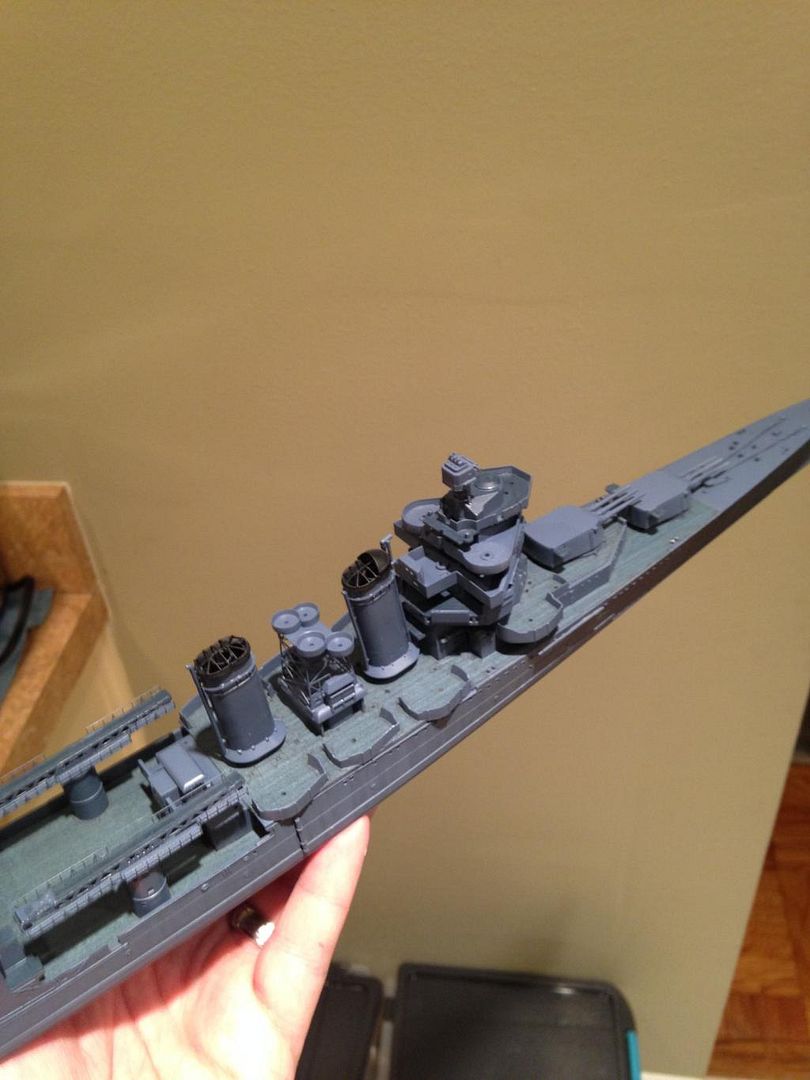

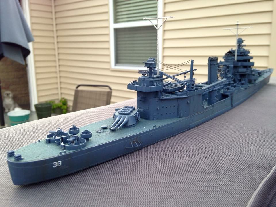

I've started a base wash on the hull. I'll do decals next, then another wash. Finally, I'll rust it a bit and then start adding superstructure as it's weathered to my liking. I LOVE this stage. Everything is dry fitted.
D3697CEA-552E-462F-AE31-3A3E431B3A50_zps
BC7A47EE-23EE-4D7D-83F5-BD1BBA182783_zps

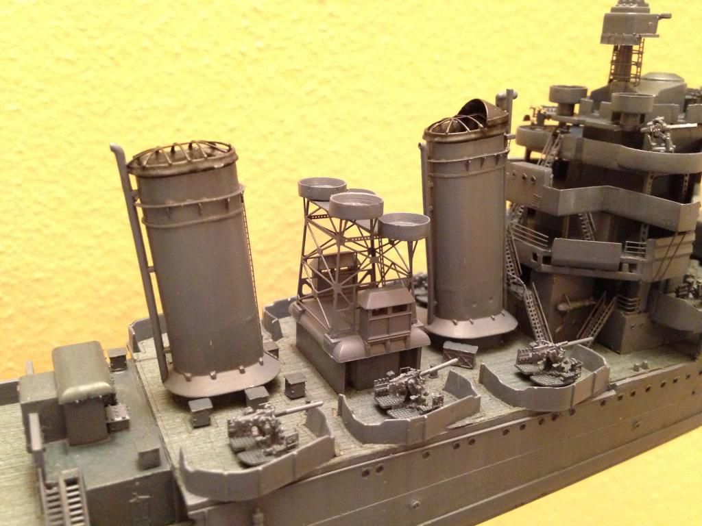

Pin indentations on the funnels are more apparent than I thought they'd be. Thankfully, I'll be covering them up with rafts.
E9D8A8B2-E046-4570-B8DC-C42814EF0060_zps

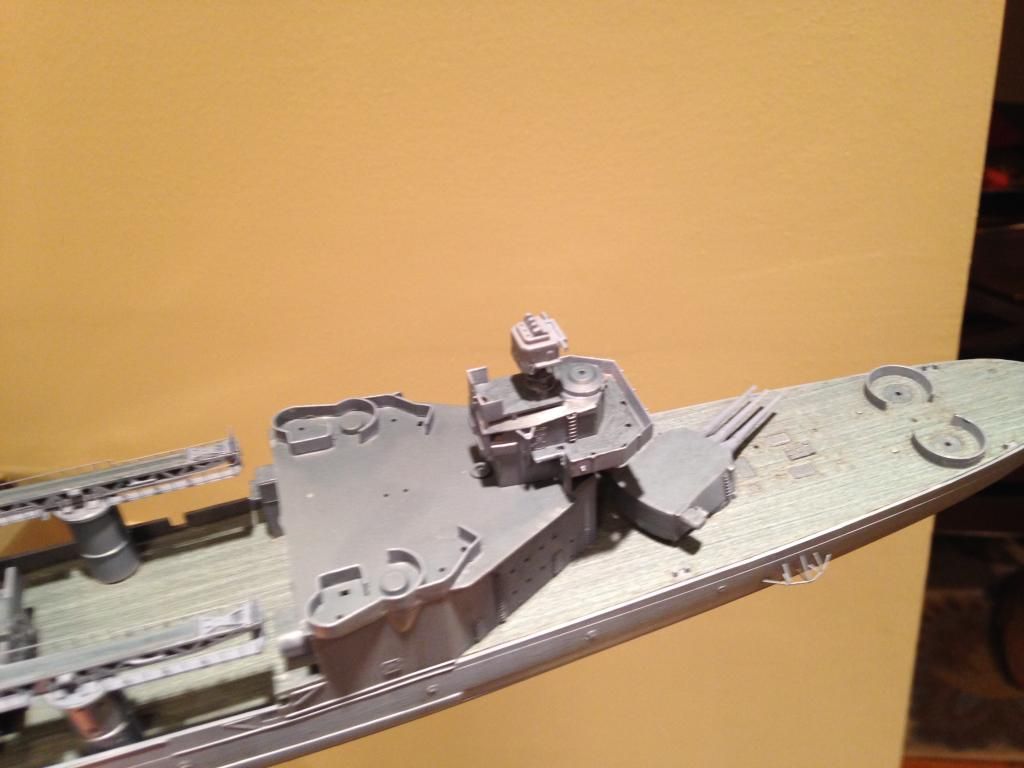

Decks look a lot better after a few washes as well.
72A139CC-0F85-4CC2-8B72-8AFB4FB7CD9F_zps
30A1D17F-F7AF-470B-B7A6-71F0C5CD17F5_zps
Tomorrow? More main hull work.

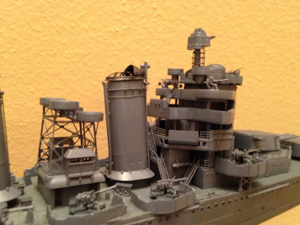

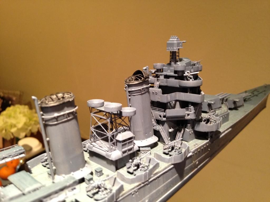

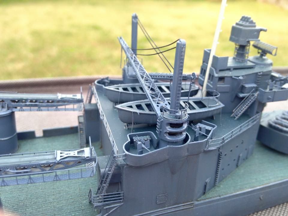

Lots of progress. I've been building up the bridge (nearly done) and moving aft. As of now, I've got most of the amidships done, minus paint touch ups (usually wait until next morning and then give it a lookover.)
56C43682-91D0-4DD2-84FA-3DB6D656A976_zps
Ship as of now. Catapults and turrets are dry fit.
01C7A499-11CC-4894-9B83-25048043F98B_zps
Aft 1.1" guns. I also used DML's smoke screen generators.

I'll work on the aircraft handling deck tomorrow. I need to finish some railing, the catapults, and install two of her life boats.

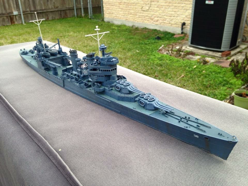

I took these before the Christmas holiday. I'm hoping to have most of the ship done this upcoming weekend.

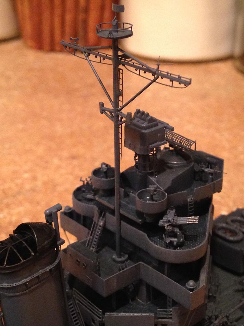

I done got masts. Trumpeter's offerings were uh, sparse.
Foremast: Replaced the plastic mast with brass. I added bracing as per photos and used GMM's yars. I also used some surplus DML recognition lights. I need to add some cables that ran up the foremast, as well as another ladder.
CB0CA1B5-4487-45E4-90CD-DD3A9701AD3F_zps
Mainmast: Again, scrapped the plastic and used the GMM parts. Trumpeter also did not include one set of yards and its support members or the small platform behind it. Those were added with brass and styrene.

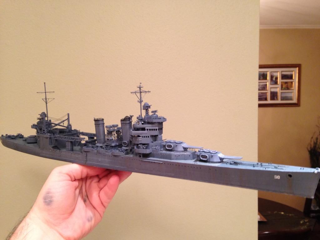

I'm very close to finished. I need to figure out what I did with my sheet of AMW USN signal flags, finish the water, and finish "glassing" windows. I'll also hit the ship with a bright light to help correct any areas showing bare PE.
Normally, I'd add barrels, boxes, and deck equipment. I wanted to leave this build relatively clean and uncluttered partially due to the look and partially time. I HAVE to put some more time into the Montana.

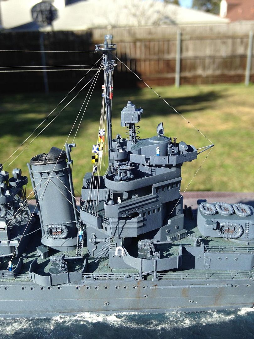

I've finished rigging and used Krystal Klear to make windows for the bridge. The process was a PITA, but it turned out well. Any residual gloss on the bridge itself will be toned down via some dullcoat.

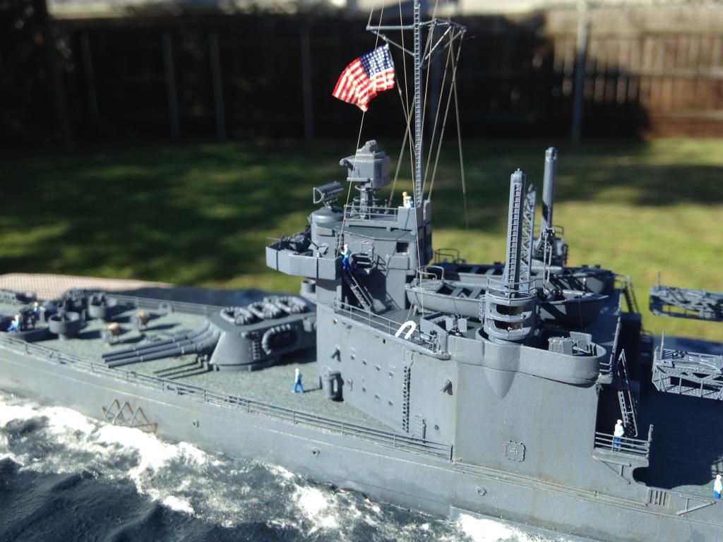

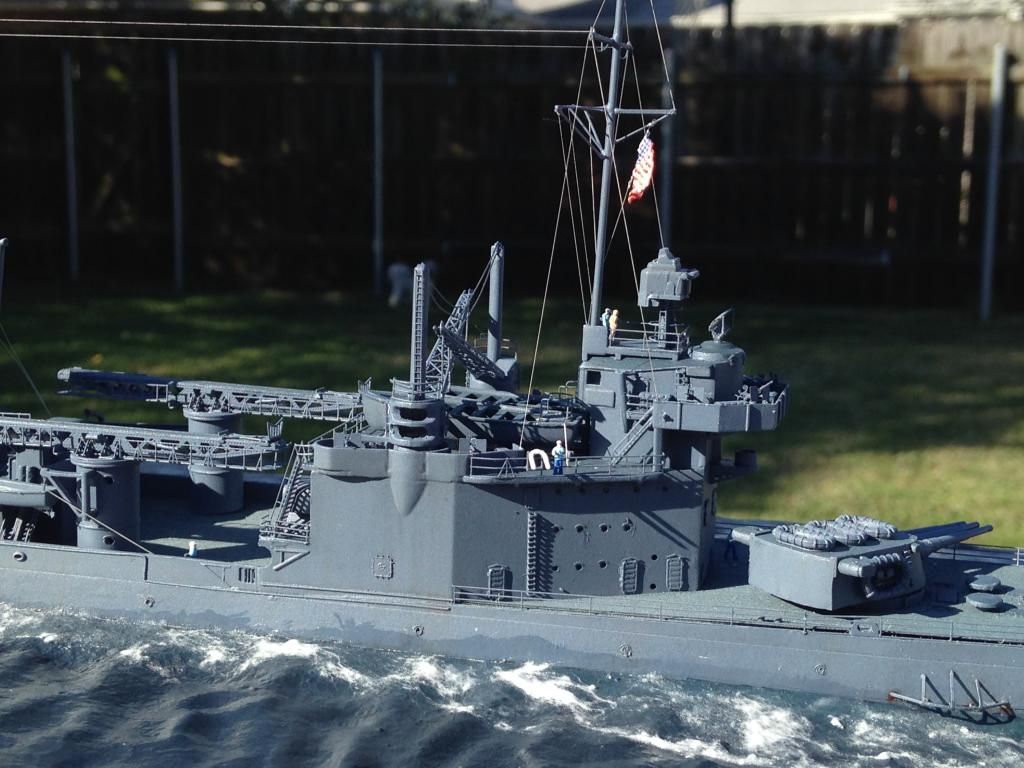

Flag and stern.
This view gives a good idea of where I've lightened the water. Cotton will be placed down and then I'll gloss the sumbitch up.
Finally, here's the midships. I'm still on the fence with the aircraft. I really don't feel like building it, to be honest.
All for now. Ideally, this'll be done by the weekend and I can focus 100% on Montana.

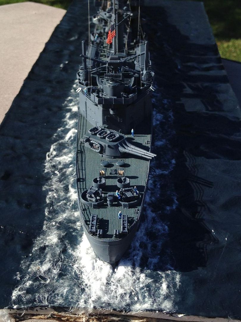

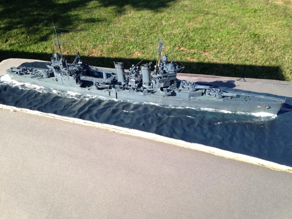

Agua almost done. I've added teased out cotton to the base based on pictures of the New Orleans class and their wakes in semi-calm water. I'll add a small bow wave and some "dry" cotton at the stern for foam. It's VERY close.

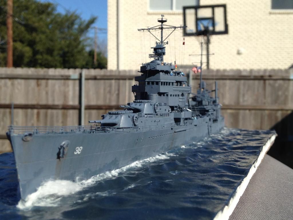

This is possibly the longest build I've had on my bench. This is partially due to the original kit being, erm, simple and my own lack of modeling time.
I've added a lot to this model. From memory:
- GMM's USS San Francisco set
- AMW Portholes, deck equipment, perforated bars and support structure
- DML 1.1's supplemented with GMM PE
- Veterans Models 5"/25 mounts
- Scratched main and foremast with GMM PE
- Modified bridge to better match plans
- Modified range finder bases
- Scratched depth charges w/PE rails
- Krystal Klear windows
- Sprue rigging
- AMW, old Midship (now BRM) flags
- Fujimi and Five Star figures.
- Stained artwox wood deck
I know there's more from the scrap box, but couldn't tell ya.
San Francisco absorbed a prodigious amount of Mr. Surfacer putty and filler, resulting in a lot of sanding and replacement of detail. Overall, I've enjoyed this build and feel like I did the subject some justice. I used Shipcraft's New Orleans class book and the Warship Pictorial 5: USS San Francisco (insanely good find at a shop for FIVE DOLLARS) for details.
The model is displayed as she was shortly after arriving in the Solomons and after her float planes were sent to Tulagi to avoid having enough flammables on board to repeat the fiasco that sent two of her sisters to the bottom. (*COUGH* IHATEBULDINGPLANES *COUGH*) I weathered mainly to break up the monotone hull.
All: I'm debating painting the horizontal rails gunmetal to better show that these were cables. Thoughts?
Anyway, enough typing. Pictures:
541E325C-AEB4-4A4C-9895-50810DC27233_zps
23A448A9-CBDD-4CA0-B1FA-6BBA999EF661_zps
D83756E6-5C8F-4518-88D3-5EB2E67699A1_zps
601681EB-3115-44E0-8B8A-F83C400E0F75_zps
Hull wetting is intentional.
38876CD3-0A5C-4E00-A27E-7F60922199ED_zps
7D33D6DB-4DC6-4305-AD46-A8F7493F1FAF_zps
FA6E05D9-145C-41A9-86BD-87DF07CA4ADF_zps
This will, hopefully, be the last model I photograph without a decent background. I'm building a small photo studio this weekend.
Is the water glossy enough? I'm debating adding another layer of Future.
Thought/comments/criticisms (especially this one) are appreciated.
Beautiful piece. Loads of intriguing, neatly executed detail everywhere and a paint job that captures her wartime persona. All it really needs is...an airplane...(kidding)

Another boat well done.
Looks great Chris. I'd leave the rails grey since everything gets painted on a ship at sea, right? Otherwise you'd have to rust them up also.
Just a thought.
Looks super to me! The water looks very good and I'm surprised just how well that cotton looks like foamy water. The wetting on the hull sides is a great touch!
Spectacular work Chris! For such a crap kit, it really looks the part. I'm curious, what fiasco befell her two sisters?
Guest PetrolGator
Bill: Thanks. Rails were run cable along the side and usually gunmetal. I just don't know if I want to risk damaging the ship...

The splashed wet areas just above the waterline are the kind of subtle detail that takes this to the next level. Given a nice, grainy pinhole lens and a suitable background, she would be indistinguishable from the real thing - even in color.
