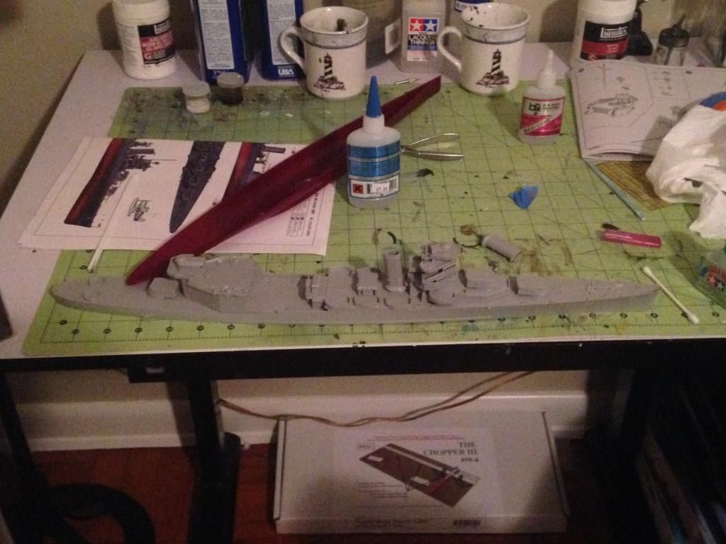

Current progress is at the dry fit and small assembly stage to check for gaps (lots) and misalignment. (Trumpeter kit.)
8C7A0534-9347-4643-91C4-7B6C391D50F2_zps8B7B6FE4-A1CC-4B50-87FB-612864A818D2_zps
These things cost almost as much as the dang kit.
Progress is going to be SLOW on this ship. There's a lot of clean up work and PE to add.

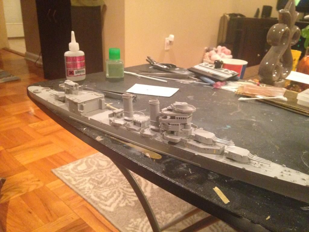

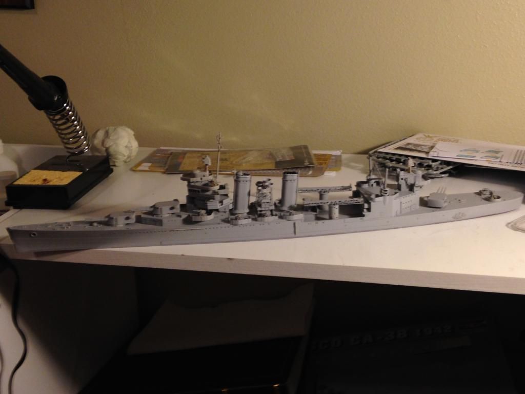

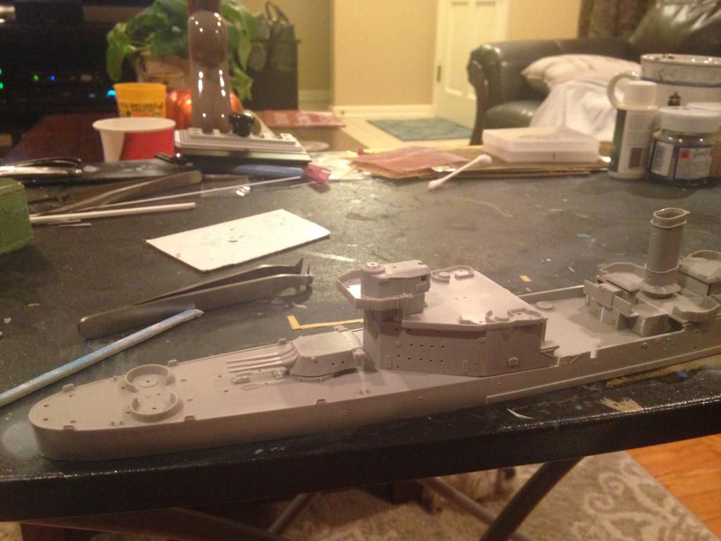

The dry fit model is actually looking like a cruiser after adding barrels and filling seams.
E7AF3951-BE59-4FEE-8B5F-EBA33968543A_zps
5158FC7F-F92A-45C2-9D90-6076A4A4C1F4_zps

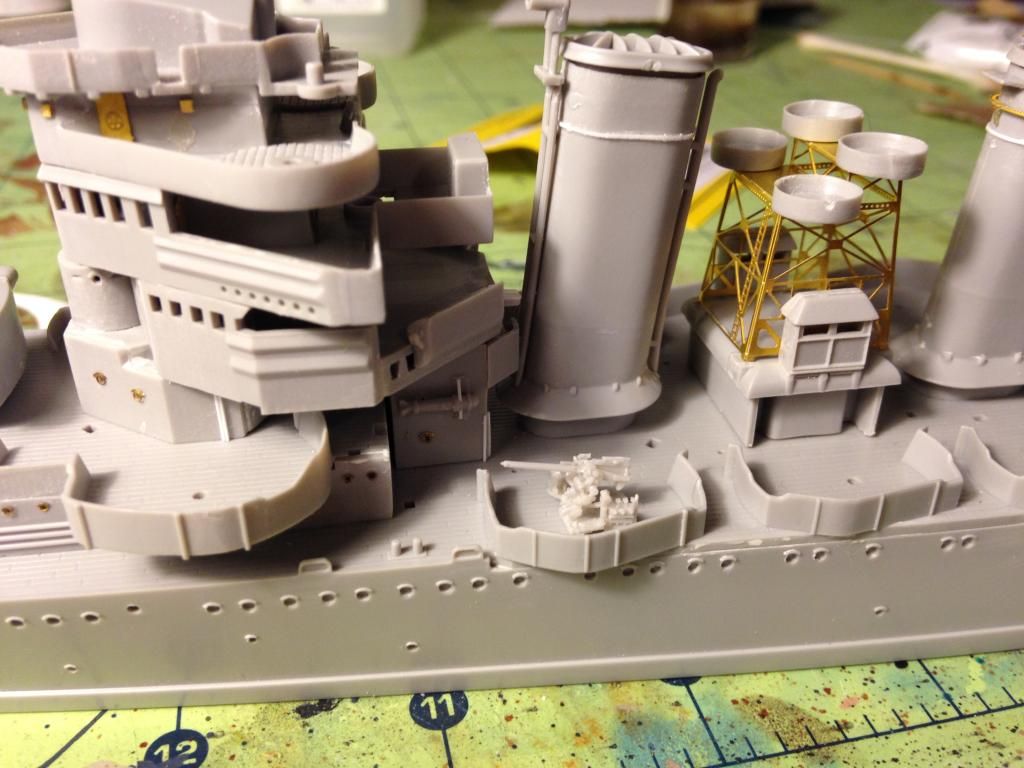

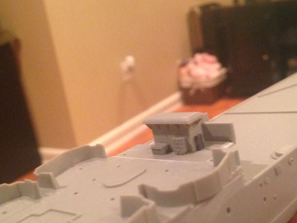

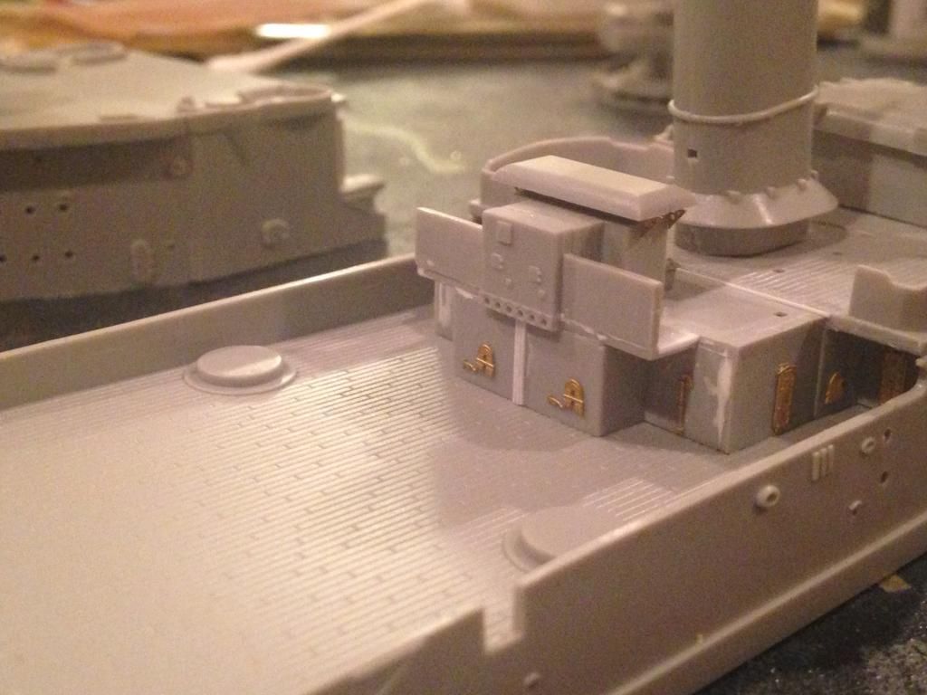

This appears to be some sort of large mushroom vent and pictures suggest some supports, so I added them along with some surplus lockers from my DML spares box.
01EF9842-CB93-41F5-84D1-DE86CB9589C2_zps
Also: PE and some styrene strip to suggest wiring, fire stations, and other details.

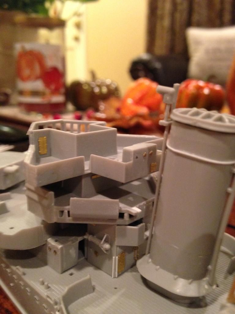

Bridge superstructure will be a bear to totally enhance. I'm not 100% sure how far I'm gonna go with the main bridge.... few buts of styrene make the paravines far interesting.

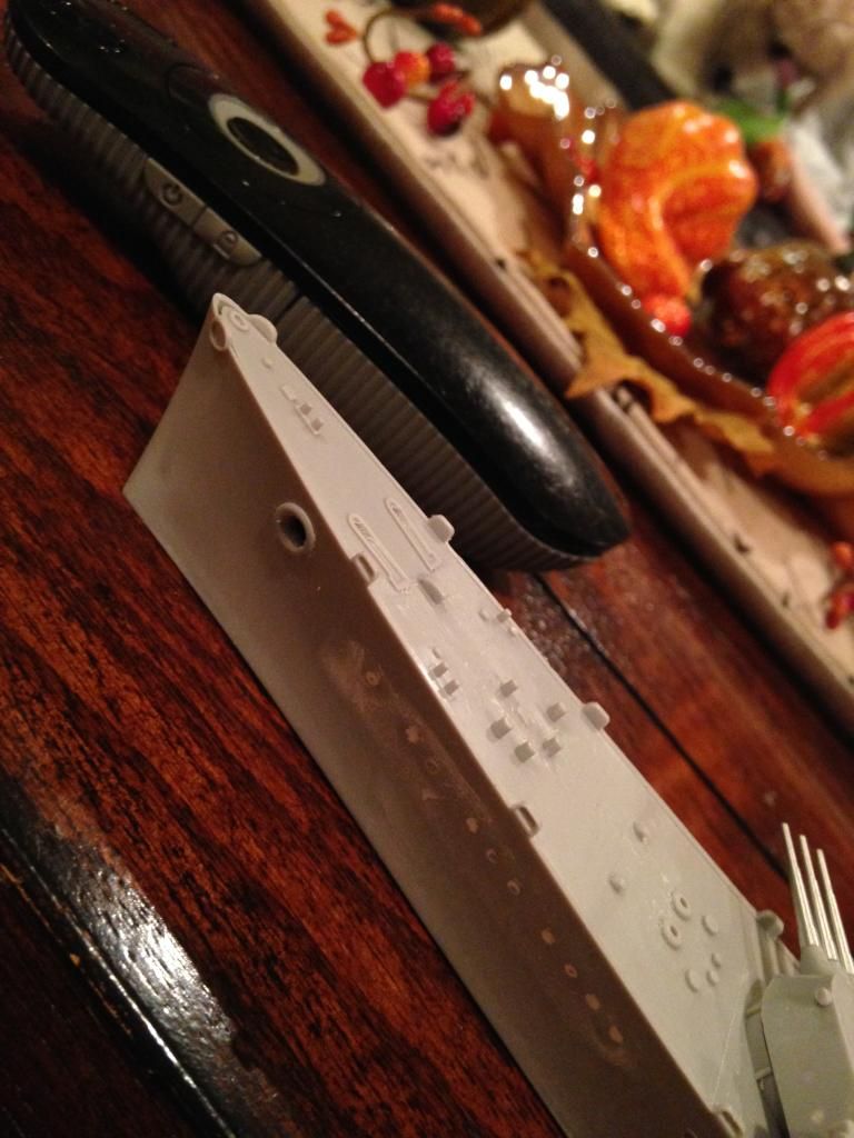

They were open. I just put a PE frame on them so that they didn't look so crappy. I will be filling some of the bow portholes that were eliminated after the USN realized that glassed over holes in the hull were convenient egress points for water....
Wnder how long it took for them to figure that out? No screens then, eh? LOL

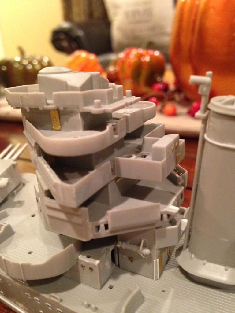

Bridge:

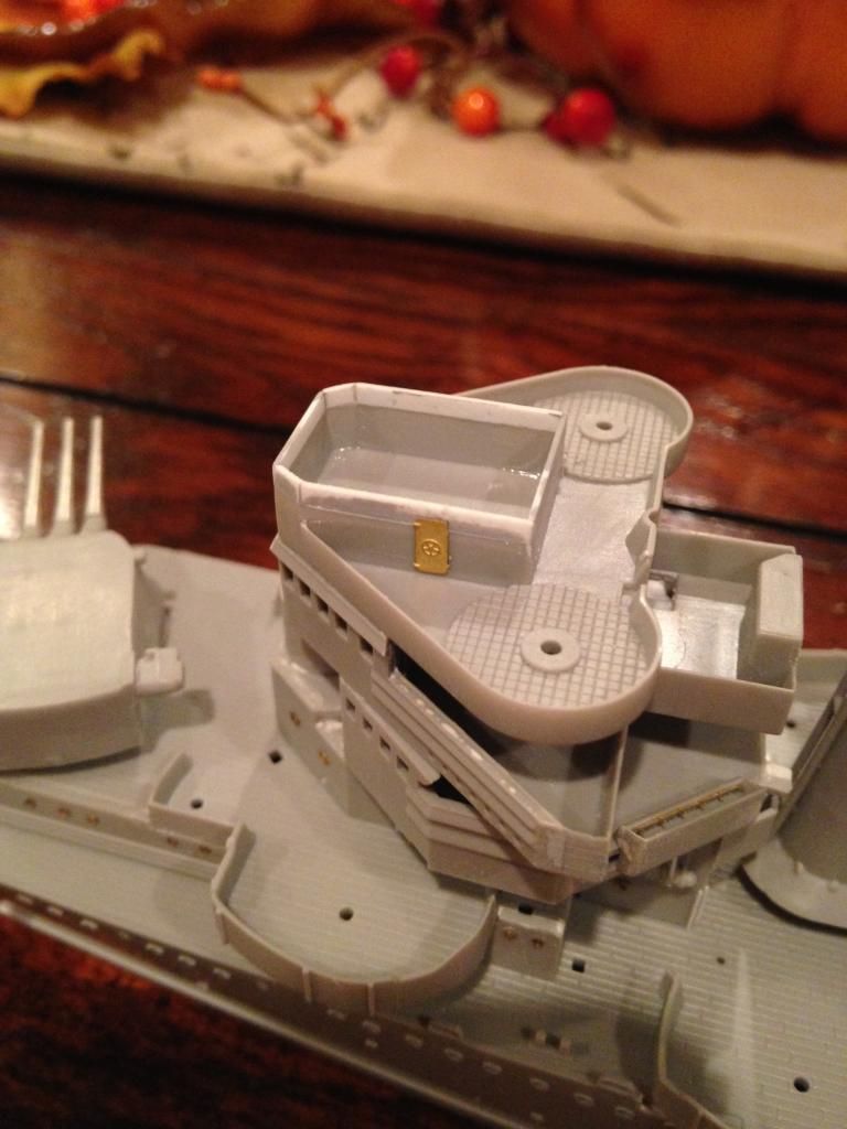

Top level of the bridge was too short as shown by taskforce88's build. I decided to modify the part as opposed to a total scratch. My skills are just not there. I've added some hatches and will add wiring and other goodies tomorrow.
7C24477A-987A-4329-B075-00A08DBC3CDC_zps

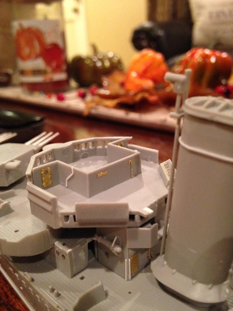

I've also added detail to various levels of the bridge including some uh, tie off points to the flag bags.
791AE897-8E18-4B83-8202-517B64B13B30_zps
605D38E3-B1BA-4D80-9A04-3ECF4371AAE3_zps

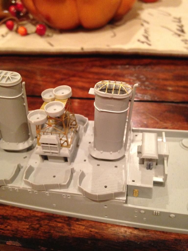

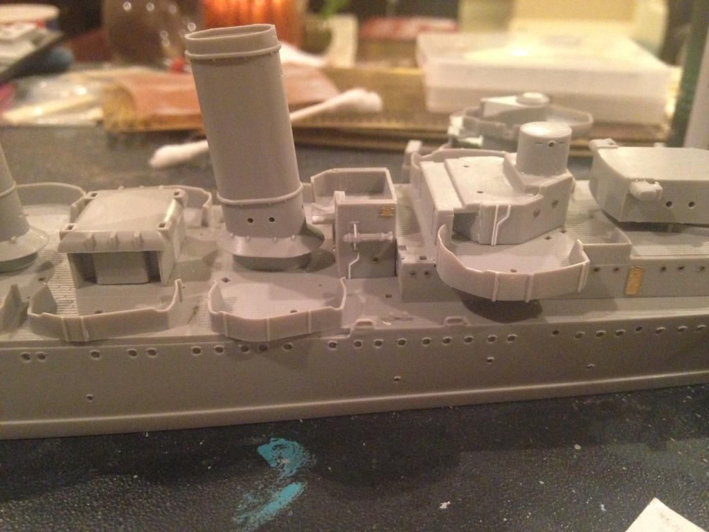

I also sanded off the funnel detail and added something a little more correct. The plastic band represents some thicker welding that the tie offs for the funnel were attached to. I'll sand it down a bit to put it more in scale. Also note that I've installed one funnel grill, though some filling will be required along the edge. The platforms and whatnot will be added tomorrow.
5BF08BA0-91AF-48DB-B445-D32A303FE1E7_zps
Finally, I drilled out the anchor hawses and filled portholes that were covered at this stage of the war. I may cover them with PE plates.
DC678BCB-7C67-402D-B69E-4E397609696E_zps

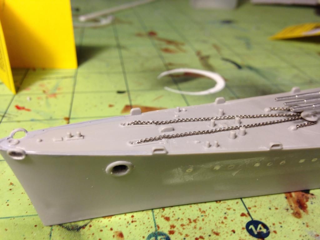

I've drilled out the two "eyelets" at the bow and rounded/softened them with a good sanding. I'll continue to use Mr. Surfacer to continue filling seams up here, along the deck, and at the stern until I'm satisfied with its appearance. I've also used some jeweler's chain to replace the kit chain and filled portholes that were covered by '42. I have plates in PE for these and my use them.

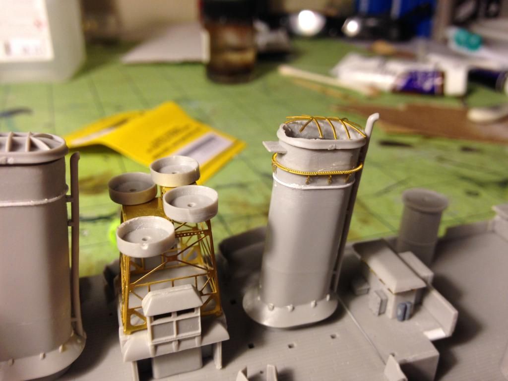

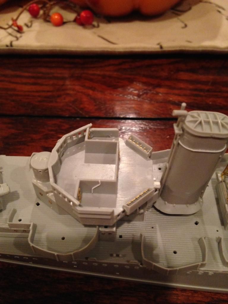

I've added the aft funnel platform, using some AMW PE angular supports underneath it to give it some support. The funnel fell previous to this picture and the grill came off a bit. Easy fix. Any remaining issues with the fit can be addressed with CA and Mr Surfacer 500.
7A690B37-1BF4-404F-88EF-930A20ED431F_zps

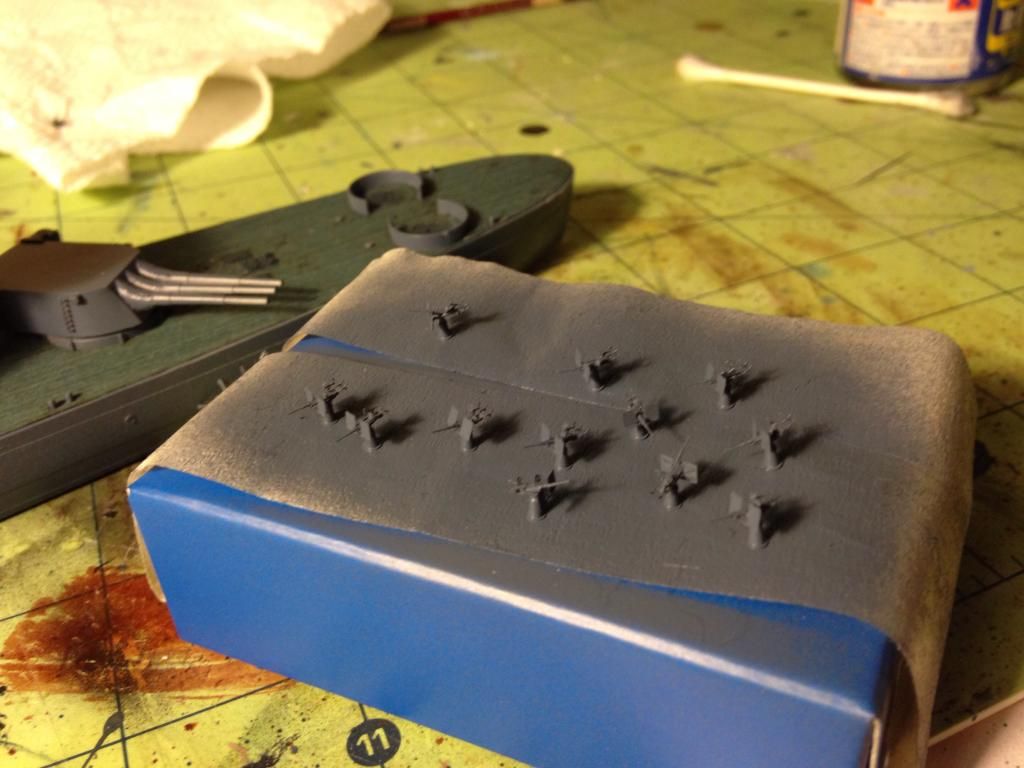

I also built one of the small 5"/24's from Veterans. These are surprisingly easy to throw together owing to Veteran's excellent product.
CD7D74A9-496F-4EA8-B32B-B81DBE289094_zps

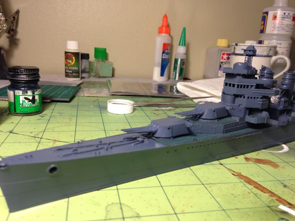

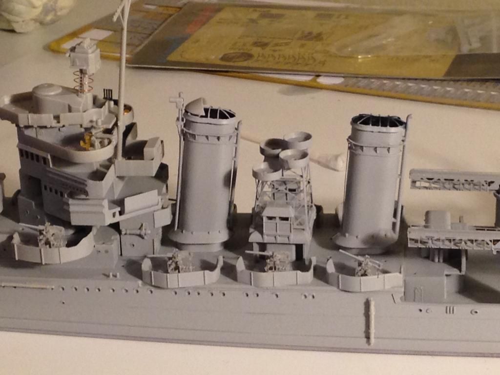

I've since primed the ship since taking these pictures which revealed a number of sanding flaws and seams. I'm now working to minimize/disguise/remove these issues so that I can move forward with painting. San Francisco sported the relatively boring Ms 21 at Guadalcanal, though I hope to weather it up a bit. I plan to show her as she arrived, before even the Beatty smashed into her aft superstructure.
Auxiliary control. Primed, this looked OK. I still had some work to do to remove any seams. Hanger needed some work as well.
Note the new supports. The "fuzz" was annoying remains of Q-tips. Removed before priming.

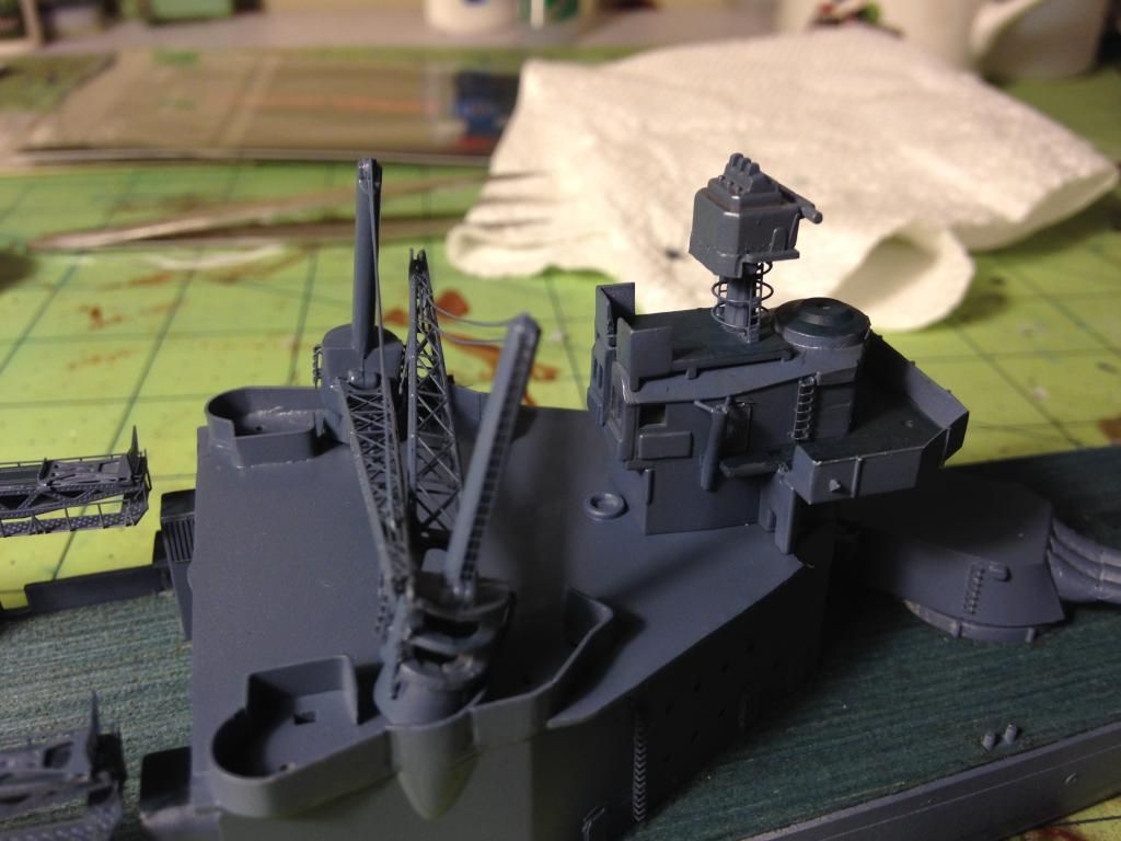

Turrets are complete here. Post priming, the blast bags look appropriately textured for 1/350 scale.
Here you can see the "plating" I did. I've got another technique I'll be trying with my next ship for even better results.
All for now. I'll post primed pictures tonight.

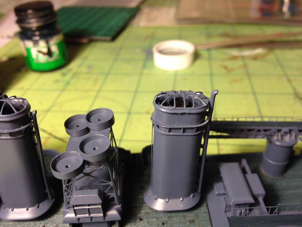

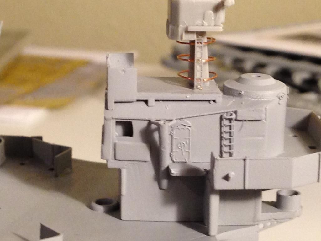

I build the weird hoops around the range finders with wire and added the ladders. I plan to cover the tops due to (a) lack of detail and (b) fact that they were, in fact, covered, outside of combat.
1A5639B5-2C3F-4F41-A310-44B0151B7214_zps
B6CCF825-BA12-4C9B-9C39-214D8F5C1E67_zps
Note also the forward funnel baffle doesn't sit right. I'll correct that with some sprue tomorrow. It's a minor problem. Note that all the Veterans guns are assembled and most of the model is primed. I've got a little more sanding to do, but am overall ready for paint.

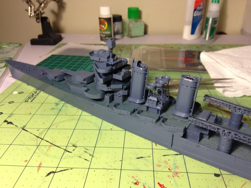

Paint!
...and wood deck. I'm "okay" with the color, though the uniformity looks odd to my eyes. I've been experimenting with the extra material for a good stain and have had mixed results I'll play some more and apply it to the ship once I'm happy. I'll also start weathering the hull with oils and do some light dry brushing to help add some more disunity to the paint. It looks VERY toy like at this point.
1E7E25E6-913F-4584-BB72-E281536E518C_zps
FF6CC07B-9A37-4D79-A429-B9DB992365AB_zps
