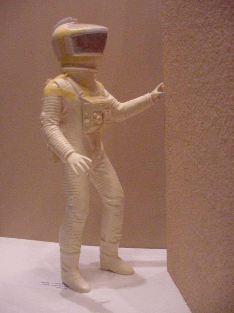

The figure is 1/8 scale, which I determined by looking up the actor's height and adding a few inches for the boots and helmet. The movie prop monolith was 12 feet high. From photos, I determined the width as 4 feet 11 inches and the thickness as 9 inches. I am using the movie prop dimensions and not those used by Clarke in the books or the dialogue in "2010."

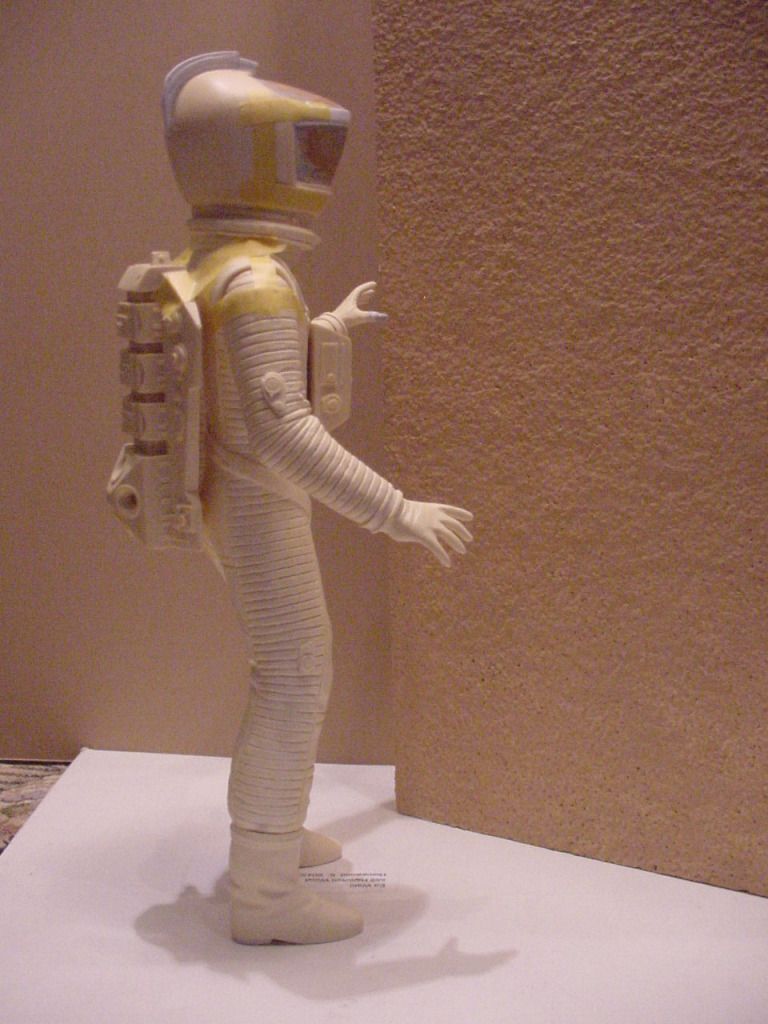

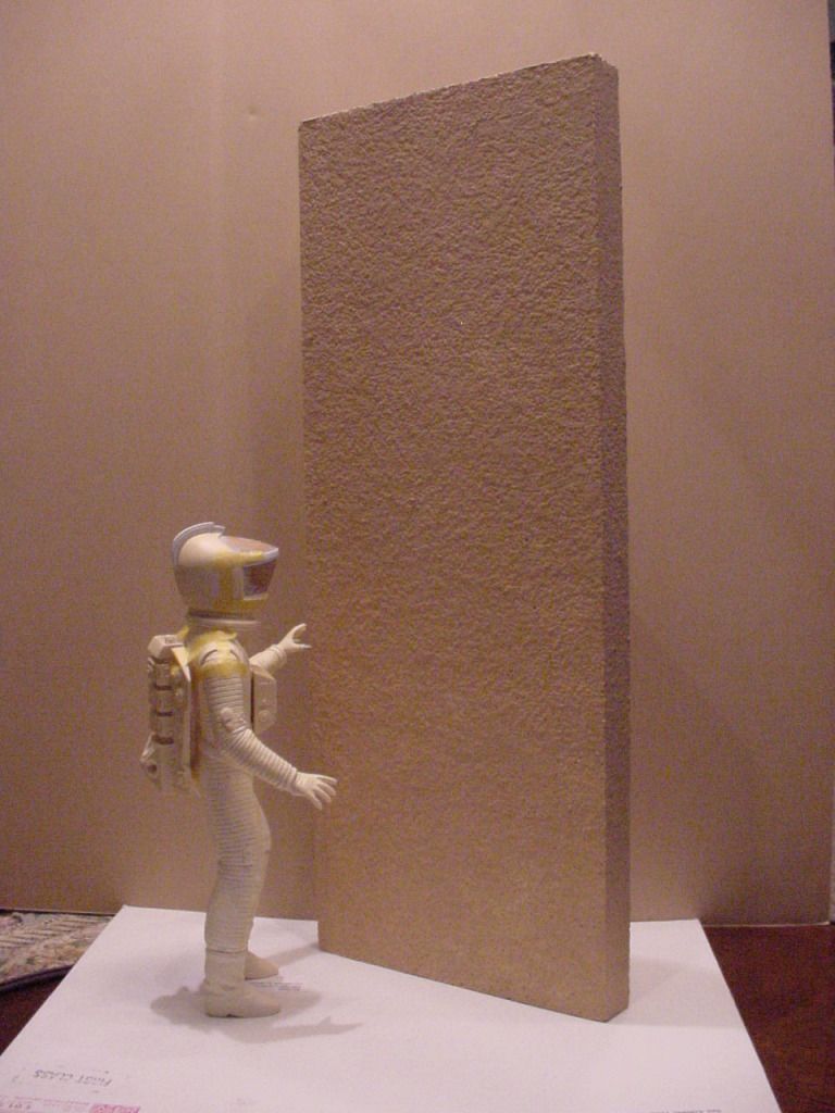

This is a work in progress, with the figure taped together and the monolith in its initial rigid foam core state cut to size.

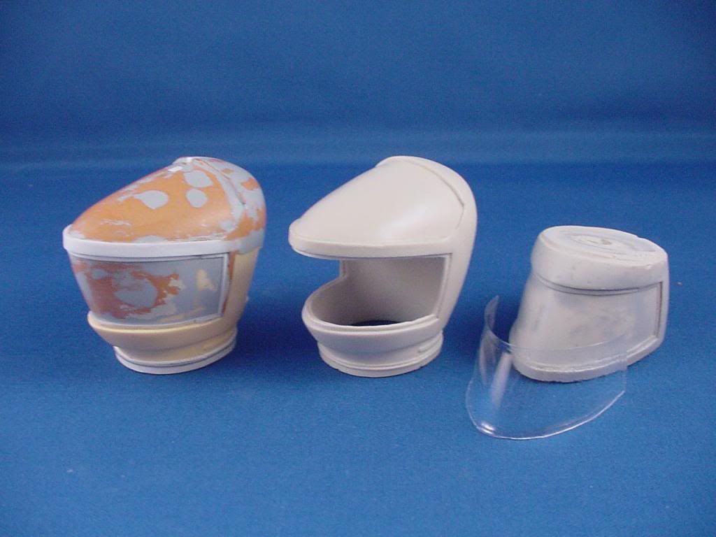

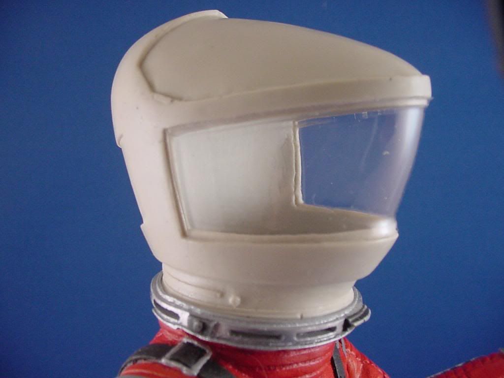

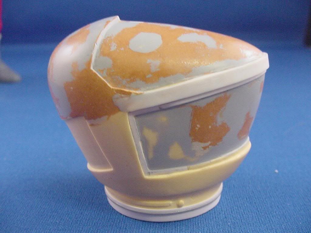

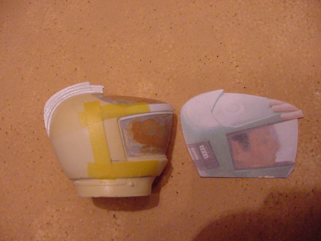

For accuracy, the helmet is the worst piece. I had to extend the front by 1/8-inch in order to get the correct shape to the glass. This led to filling and building up the front top. It still did not look right. I enlarged a photo of the helmet's profile. Horrors. I have to add 3/16-inch to the top (see white plastic strips to establish the height and contour. The glass must be extended back as marked by the tape. I've already sanded off the oversize and inaccurate panels on the back of the helmet to be replaced by scratchbuilt ones. For filler, I'm using Squadron White Putty, Elmer's Almond Wood Putty, and Mr. Surfacer 1200 out of the bottle. This helmet has a long way to go to carve the recessed window (both sides) and build up the entire top to cover the white plastic guide.
The foam core monolith will be covered with black sheet plastic that I have on order from the LHS.

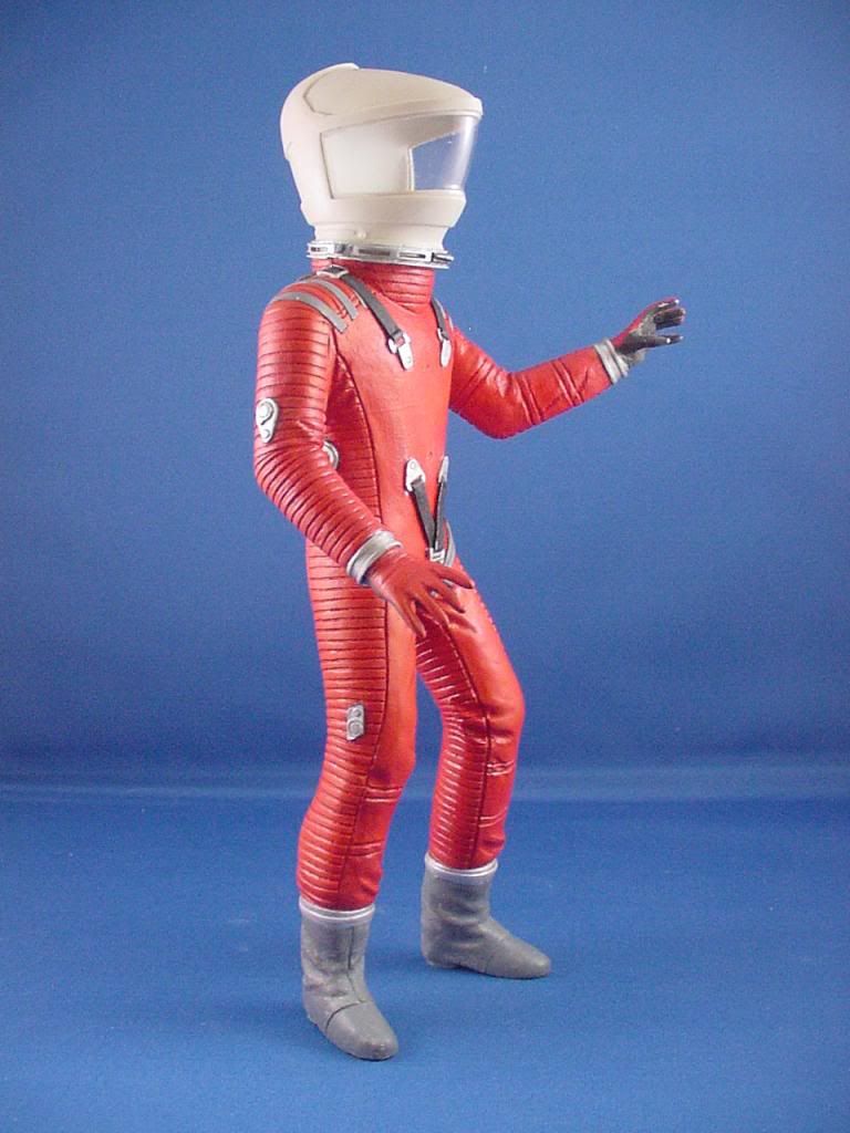

This project is in need of a major update.

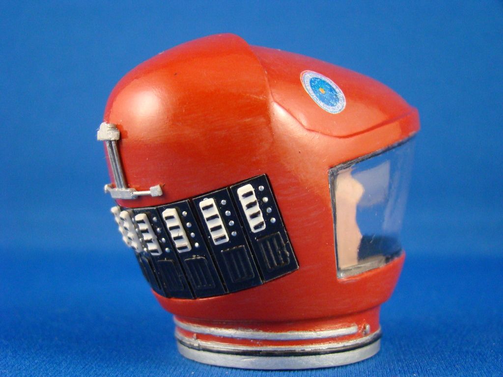

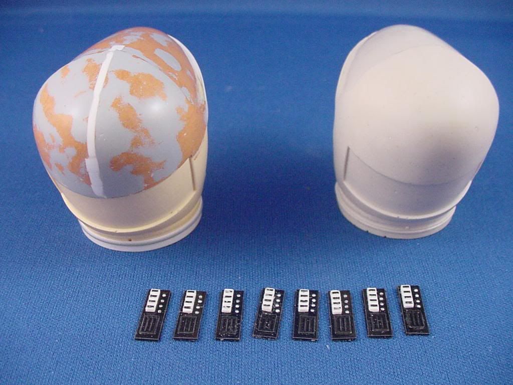

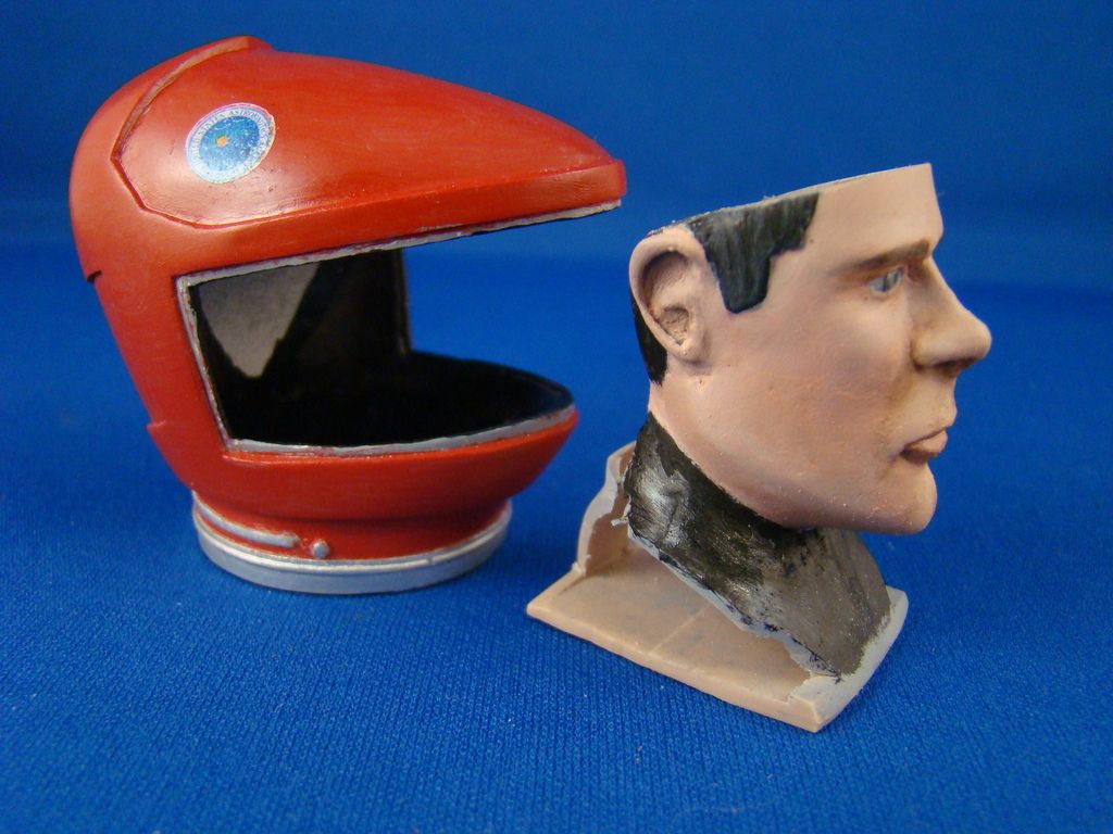

First, the helmet as built up, then with two casting copies. One casting copy was hollowed out to accept a head. The second copy was used as a master form for a vacuform copy of the glass.

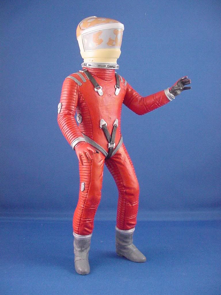

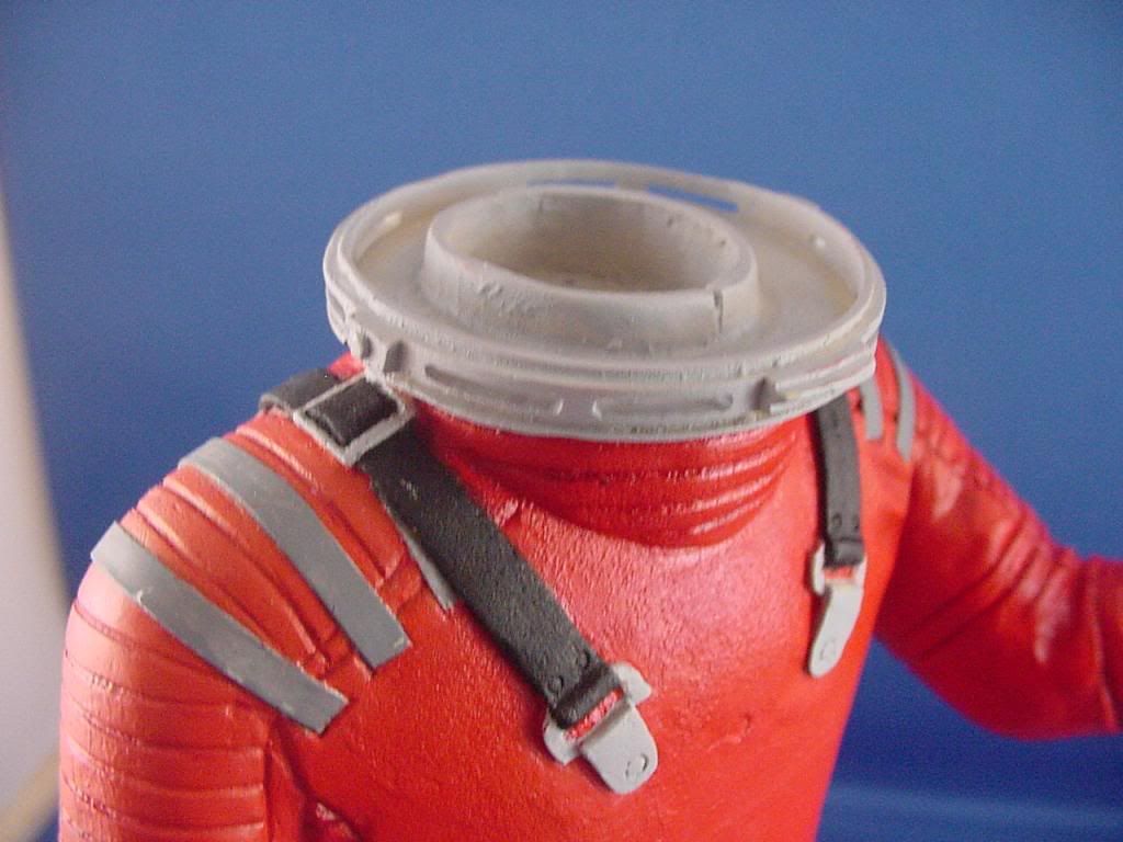

The metal collar ring on the suit needed eight open slots carved into the resin to match those on the real suit. Also, the shoulders had to be sanded down to a smooth curve, puttied to fill the incorrect grooves, and fitted with the six grey straps not included on the resin figure. The straps are Evergreen strips.

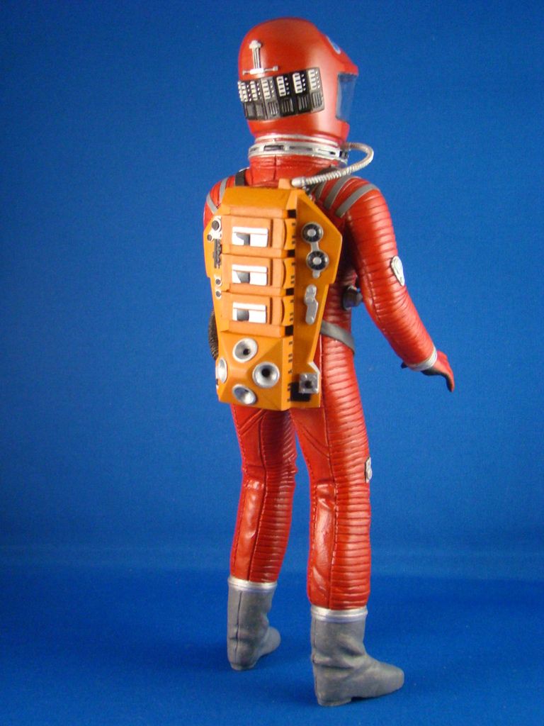

There is a pocket on the back of the helmet that can be fitted with "mission boards" that will assist the astronaut in preselected tasks. The original resin helmet had details that were so bad that I had to file them off. Then I had to cut the pocket into the helmet. The eight mission boards are close replicas of those seen on screen and in the few photos taken of the helmet from the back. I made them from a combination of materials, including Evergreen strip, PE ship railing segments, Evergreen grooved siding, and tiny silver metal buttons.
Here are some shots of the full space suit with the solid helmet, the carved out helmet, and a close-up of the empty helmet with the glass tacked into place.

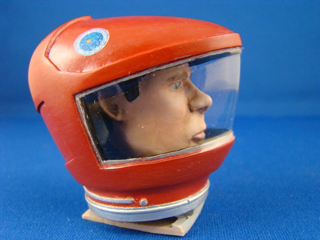

For the hollowed out resin helmet, I purchased a pilot's head bust for a flying model in 1/8 scale from Williams Brothers. Let's just say it was a generic head, and the proportions were not anatomically correct and the features were soft. I spent many hours trying to reshape the face with putty and carving and sanding, followed by more of same several times. I tried, I really did, to sculpt a passable likeness of David Bowman, but the basic misshapen head defeated me. I finally had a face, so I primed and painted it. Then I had to trim away anything that would not fit into the helmet.
From an image on the internet, I reduced and made mission emblem decals for the helmet, chest and back packs, and a shoulder patch for the left shoulder on the space suit.

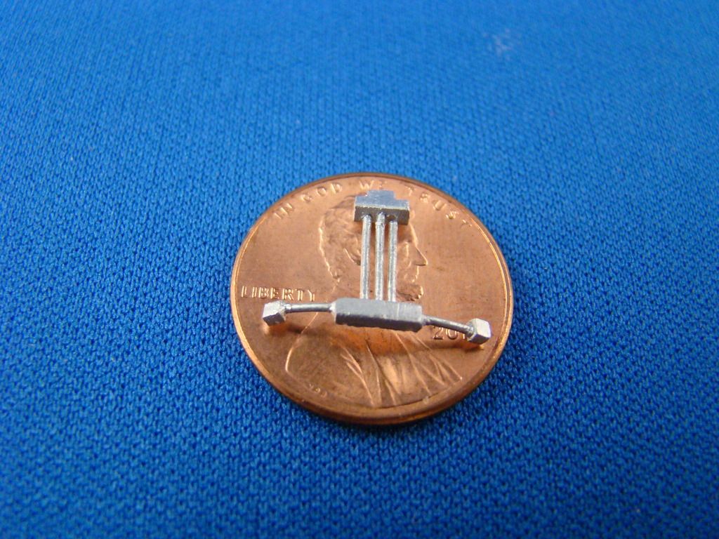

There is an antenna array that is at the upper rear of the helmet. These are very difficult to see in the movie, but using still frames I was able to determine its size, shape, and look. It is tiny. I used short lengths of fine wire and plastic chips held together with super glue.

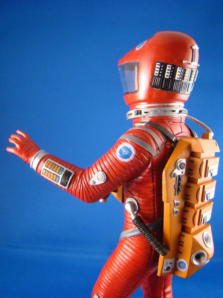

Here is the completed scratchbuilt helmet with head installed, front glass in place, mission boards in thier recess on the back, and the antenna in its correct location.

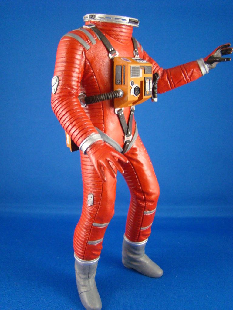

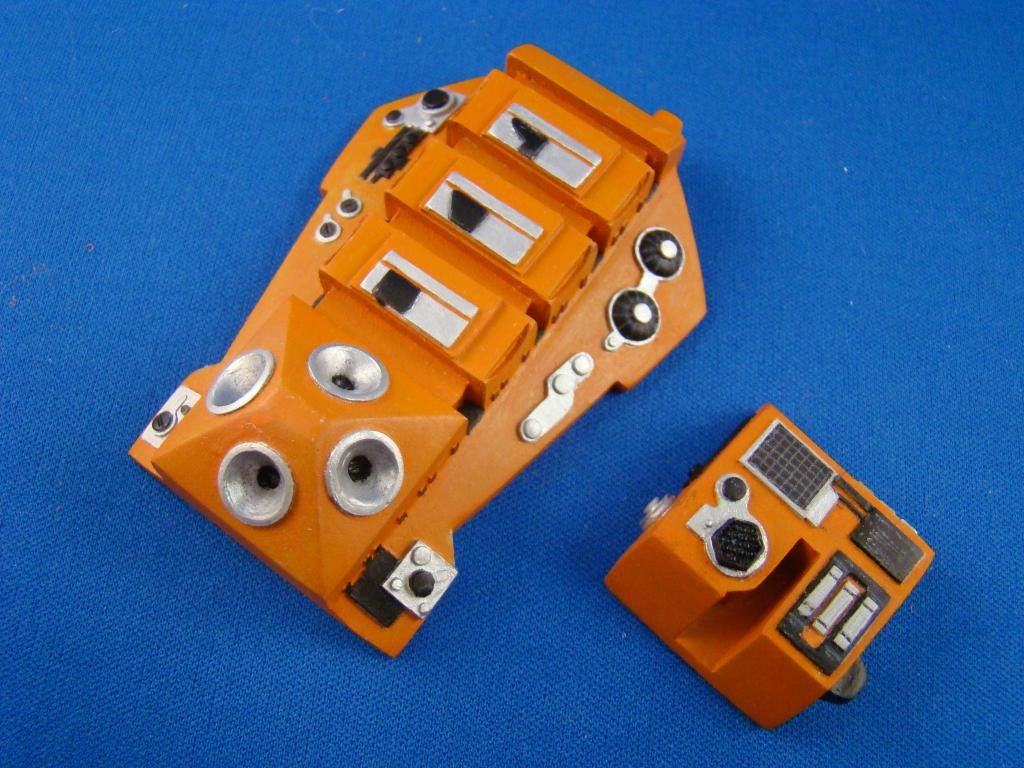

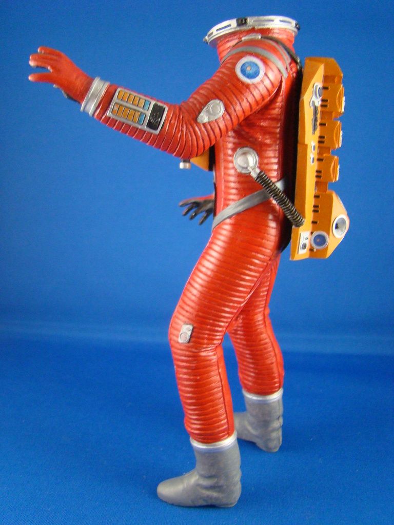

At last, it was time to assemble the various components. Here we have the chest pack in place with the hose connecting it to the suit fitting. Also notice the hand controller on the left side of the chest pack, which is used to control the thrusters on the back pack.
The back pack connects to a fitting on the other side of the suit. Note the shoulder emblem patch.

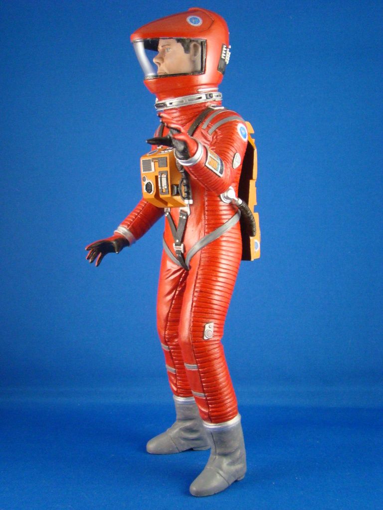

The helmet/head assembly was glued to the collar ring of the suit. The last piece added was the air hose from the top of the back pack to the right side of the helmet at the collar line. Here are three views of the completed 2001 Astronaut figure, presumably that of David Bowman.

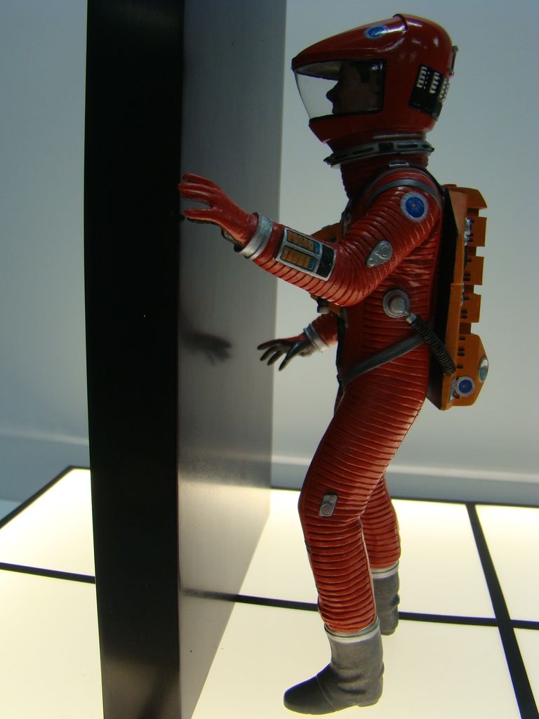

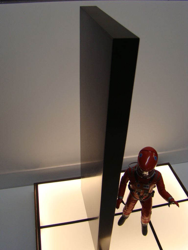

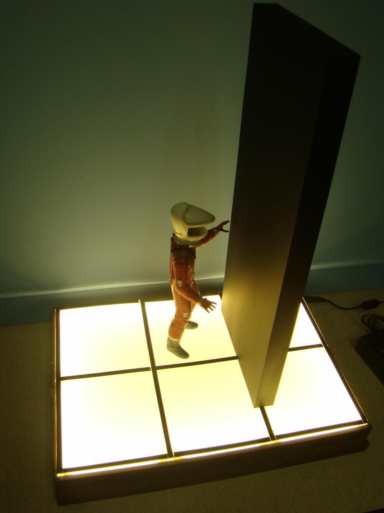

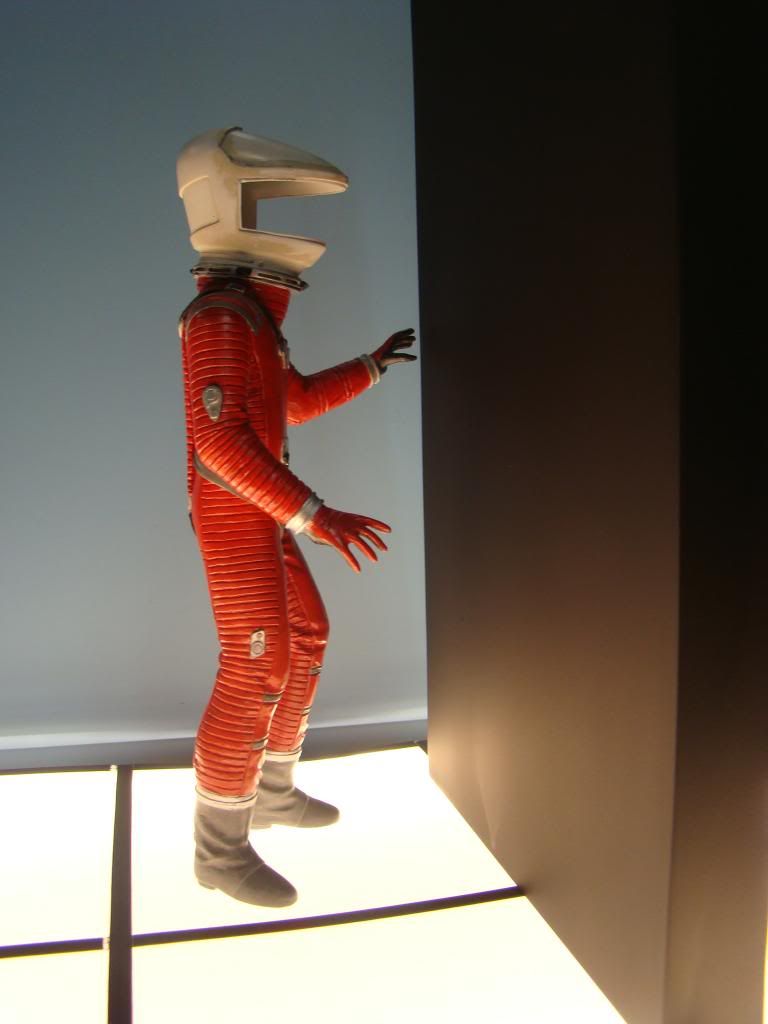

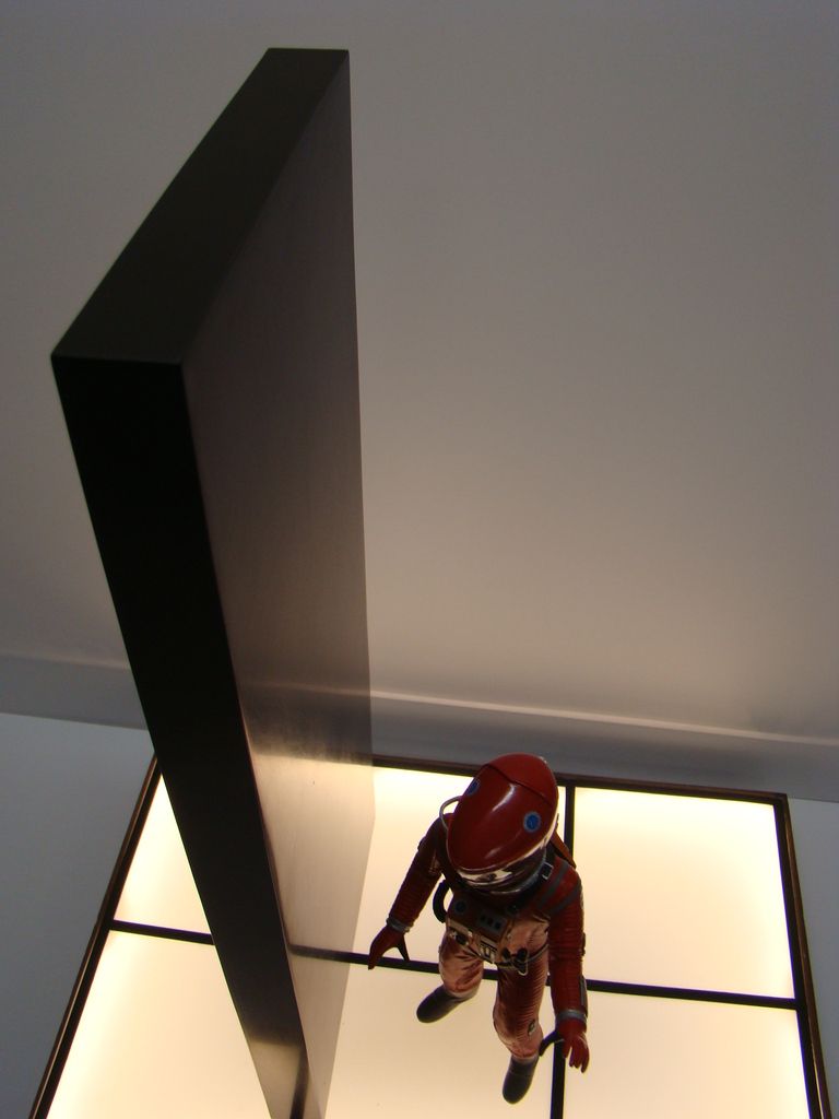

Now for completing the scene. See the next post for the whole thing finally assembled. The monolith and lighted floor were separate projects in themselves. I did add a dimmer to the lighting to tone it down a bit.
Here is the finished diorama that I started at least four years ago. I'm happy with it. It looks like the original vision I had for the final result. What more could I ask? [better lighting would help.]
