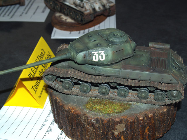

When I am shooting models on the table at a show, usually for use in our club newsletter or my blog, I use the Puffer to take away harsh shadows and some of the color shift. This tends to give me an acceptable photo that I can then work with in Photoshop. I'd like to shoot with a tripod, or even a monopod at a show but find that it is just too much trouble given the crowds, etc. The photos aren't as nice as if I'd shot in a lightbox with a backdrop, etc.
Here is an example from the Cinci show. It is Jack Bruno's JS II. I adjusted it a little in Photoshop, but didn't do much. It is a good representation of the original that I saw at the show which is what I am going for. Mostly what I try and avoid are the harsh shadows and radical color shift. This one was shot without the puffer which is why I got the flare off the turret.
A perfectly fine photo, David. The reason I like to use a flash off-camera is that I'm able to move the light to provide better depth and accentuate the portions of a model that I want photographed (like the engine in a car or tank, underwing stores, etc.

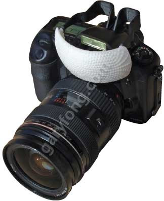

I would also recommend a Gary Fong Lighsphere II diffuser - I've had great results with them, especially in weird lighting situations. at about 35.00, they're relatively cheap versus the benefit you get from using them. They can be kind of tricky to keep them on the flash head though.
