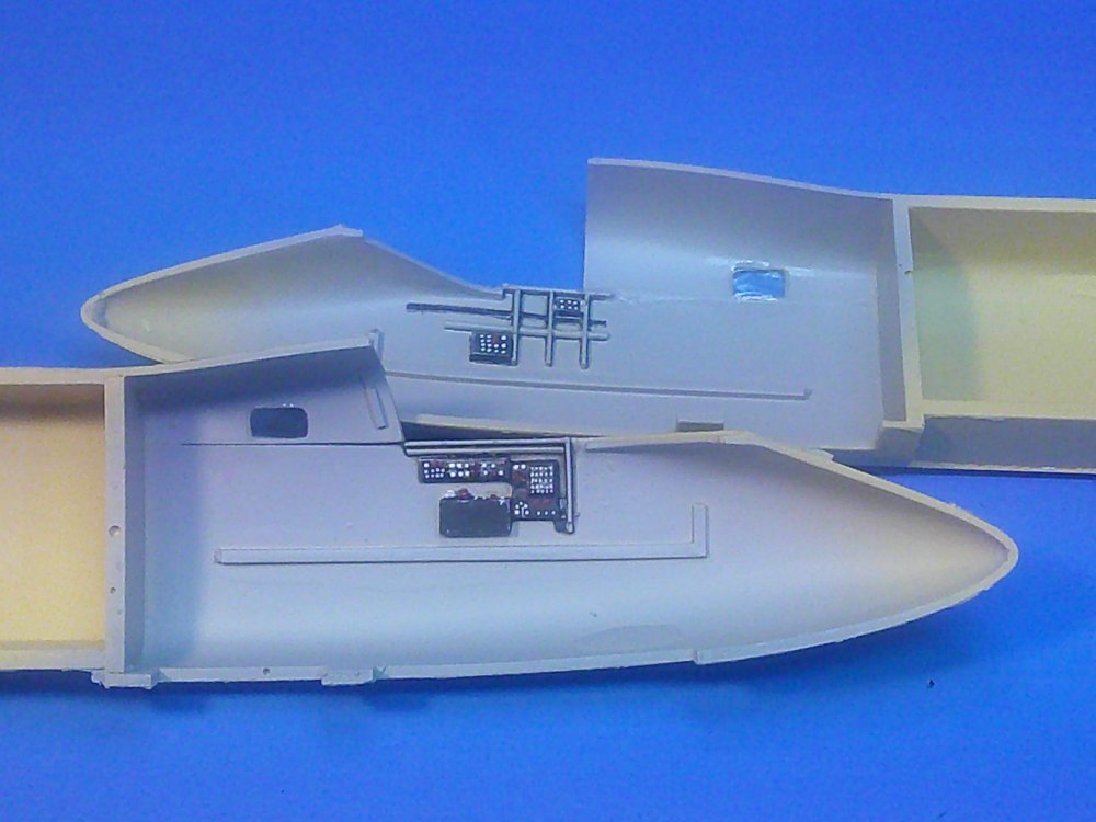

The fuselage was cast with cockpit side console detailing included. Note that the small windows have been filled with UV cured clear resin to make them.

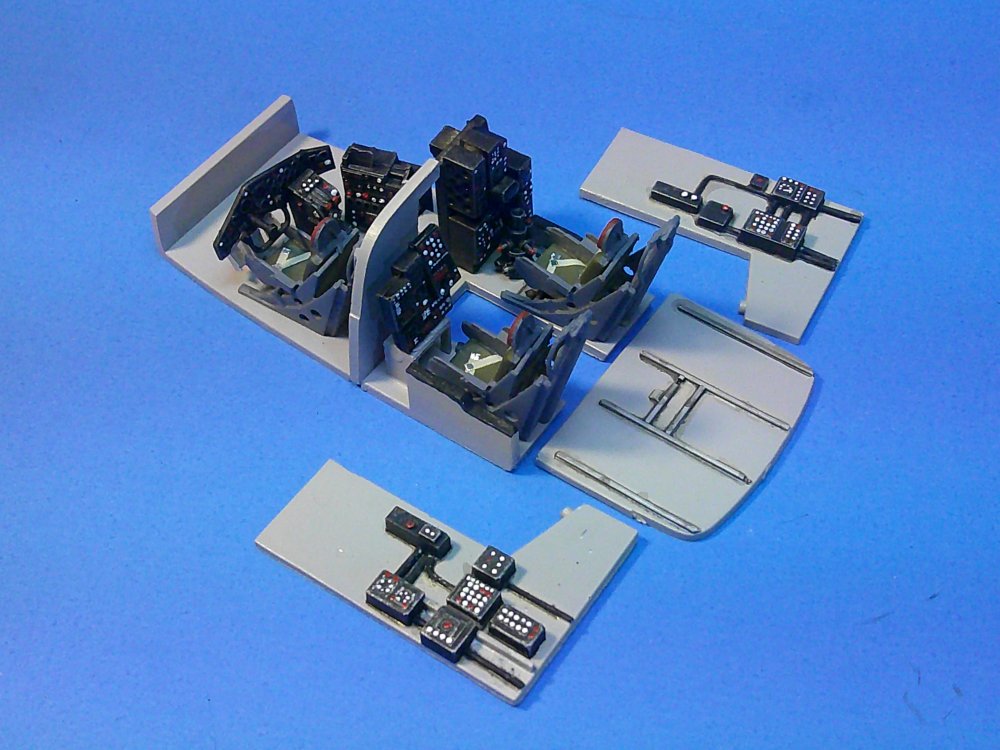

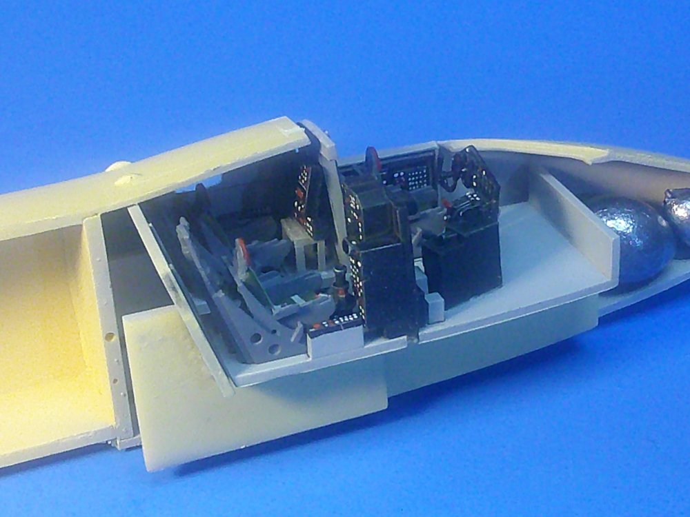

All 3 crew stations are very well represented as well as the avionics on the walls of the lower entry well. The kit includes a staircase to display the well open. As an interesting aside.... most of the detailing on the faces of all the black boxes and consoles were made using bits from my old HodgePodge generic cockpit PE detail set!  🙂

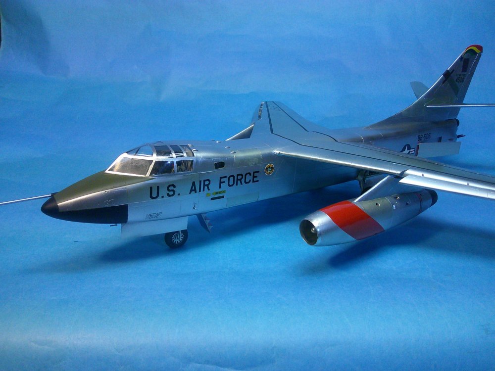

The cockpit engineering is well done and fits nicely, even if a bit snug and with limited ability to see the 2 rear seats. Note the lead fishing weights superglued into the nose just to be sure of avoiding a tail sitter.

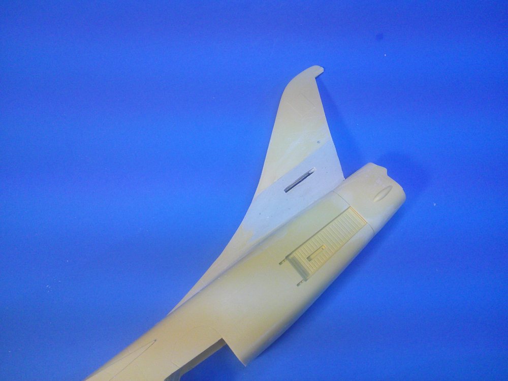

The only real construction issue was that there was a severe step on the left side of the tail fin after the top half was added. It was eliminated by first rolling out a thin sheet of ApoxySculp and then applying it on the bottom half of the fin to fill it out so the step was gone. This is how it looked after sanding and reopening the tail plane locator slot.

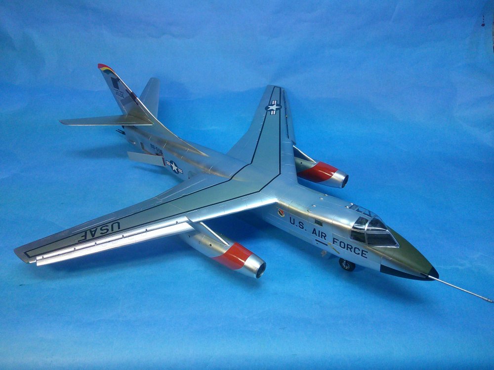

The model was so big it was primed and painted in 2 stages.... first holding it by the wings in order to paint the fuselage and then holding it by the fuselage the next day to paint the wings. The model was primed with Gloss Black Enamel and the NMF was done with AK Extreme Metal Aluminum and Duraluminum. The thin black wing walks were masked and painted, as were the red sashes on the engines. The only thing left to paint here in this pic was the OD antiglare panel on the nose.

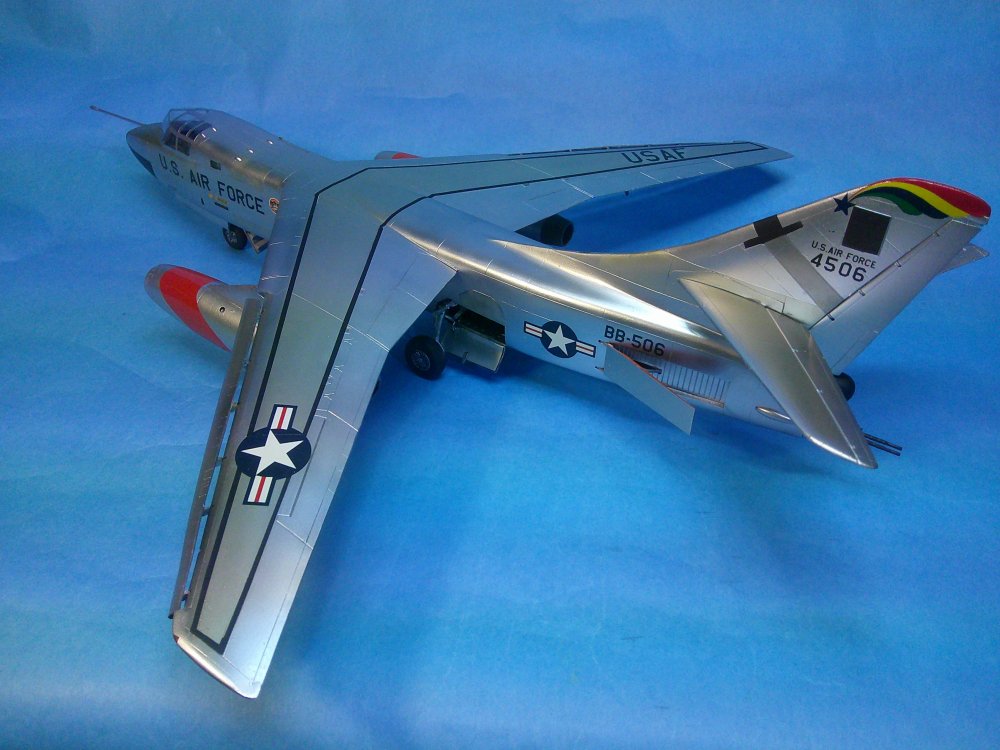

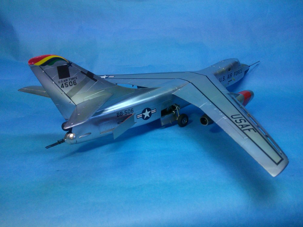

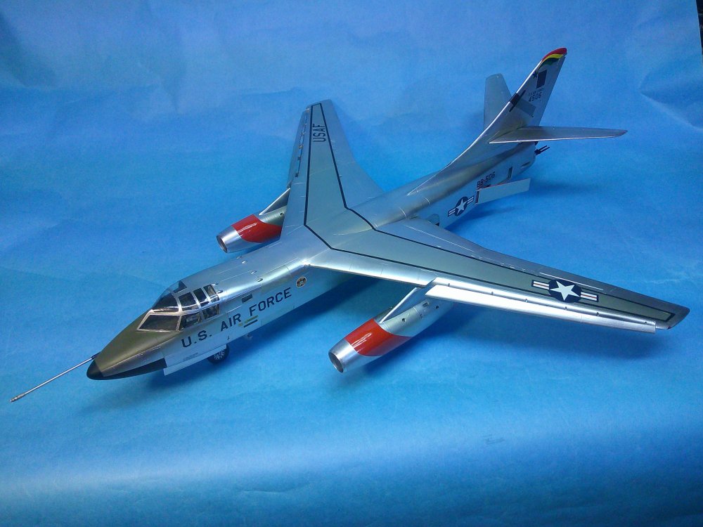

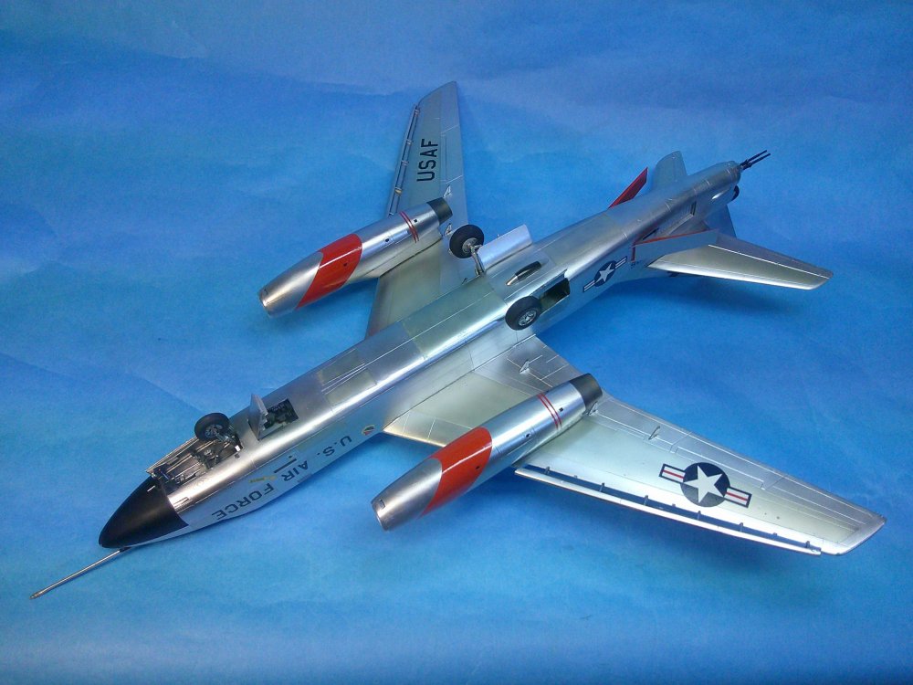

Most of the markings came from the kit decal sheet, except for a couple that shattered and had to be replaced with spares. On to the finished pics!
This is 2nd of these I've built since it was issued; but I'd sold the 1rst one many years ago not realizing how hard (and expensive) it would be to get another one. I'm very happy to have this rare 1/48 jet bomber from the late 50's/early '60s back on my shelf again!
