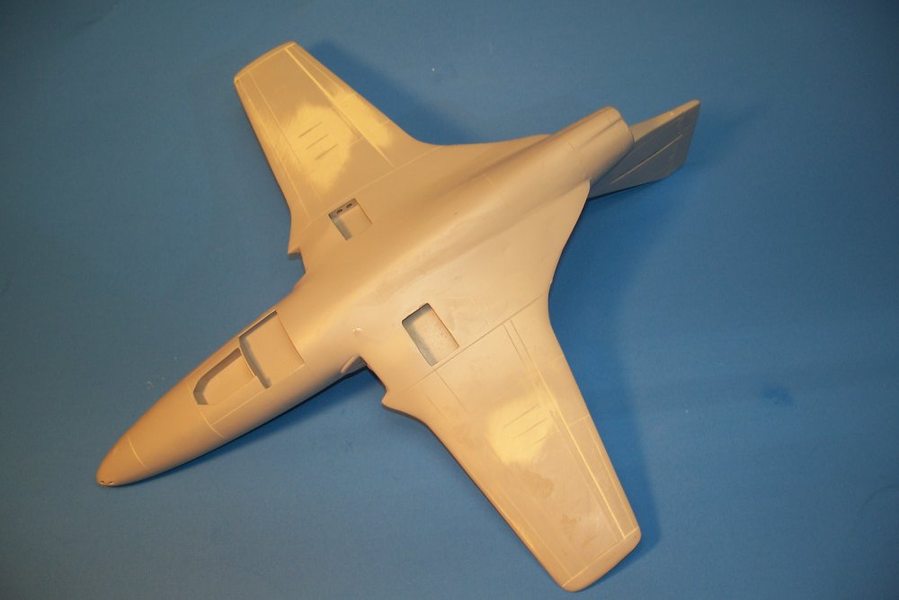

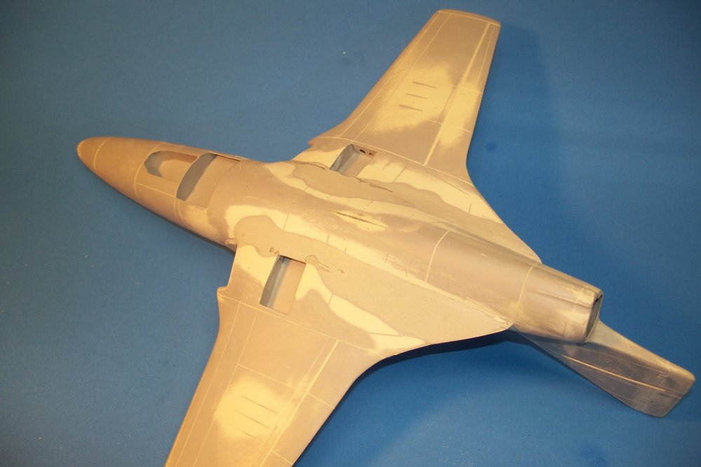

Some concrete progress! It took 4 hours of sanding to smooth out all of the plastic rod I glued into the existing panel lines. I was pleased with how that went as it did fill 95% of all of the overly soft lines. You can see all of the lines that have been rescribed and also how the control surface lines have been deepened and also some scraping done to create a slightly curved surface down into those lines. The scribing was done using a razor saw and also the UMM scribing tool.
The 2 pics above show the ApoxySculp epoxy putty that was smoothed into the wing roots to help even them out and fill them. A roll of it was laid in place and then it was squished out into shape and then contoured with a finger wet in alcohol. That helps eliminate 90% of the sanding needed since it's mostly blended in already.

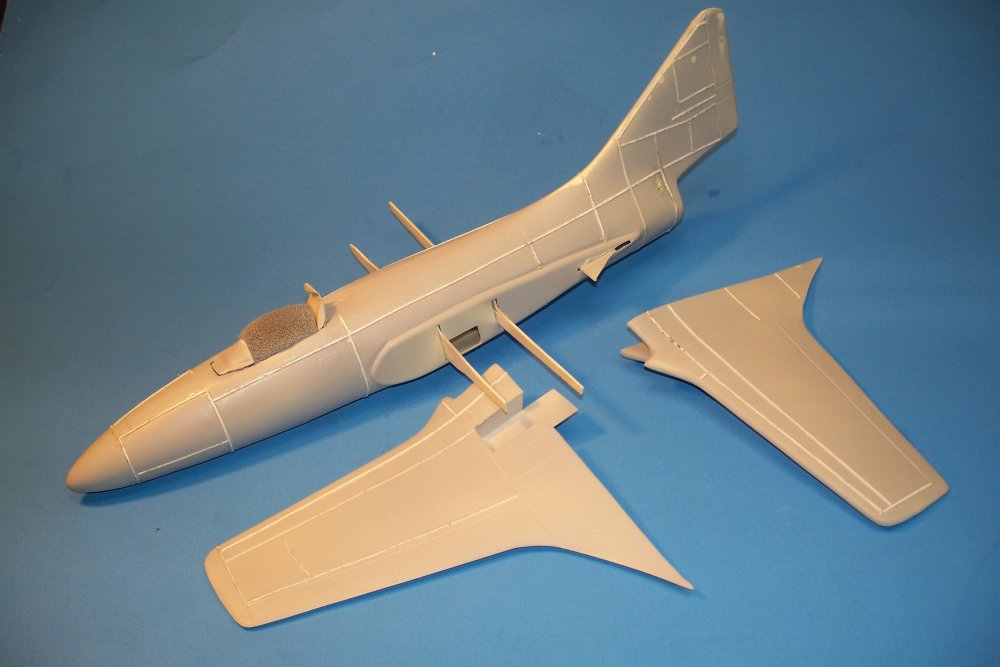

I also decided that it would be easiest to cut a slot to accept the tail planes. I used tape and pencil to mark the cut lines on both sides and then carefully cut open the slot on both sides. I actually got a much tighter fit than I thought I would, though there is some wiggle room to allow for it to be aligned properly before it gets finally glued in place.
Next up is to sand those wing roots after they dry for a day or two....then prime it to see where things are! Comments, critiques, and questions welcome as always!
Round 1 of sanding the wing roots is done.....
As is round 1 of the priming..... bit of a paint run on the bottom that'll have to be sanded out.

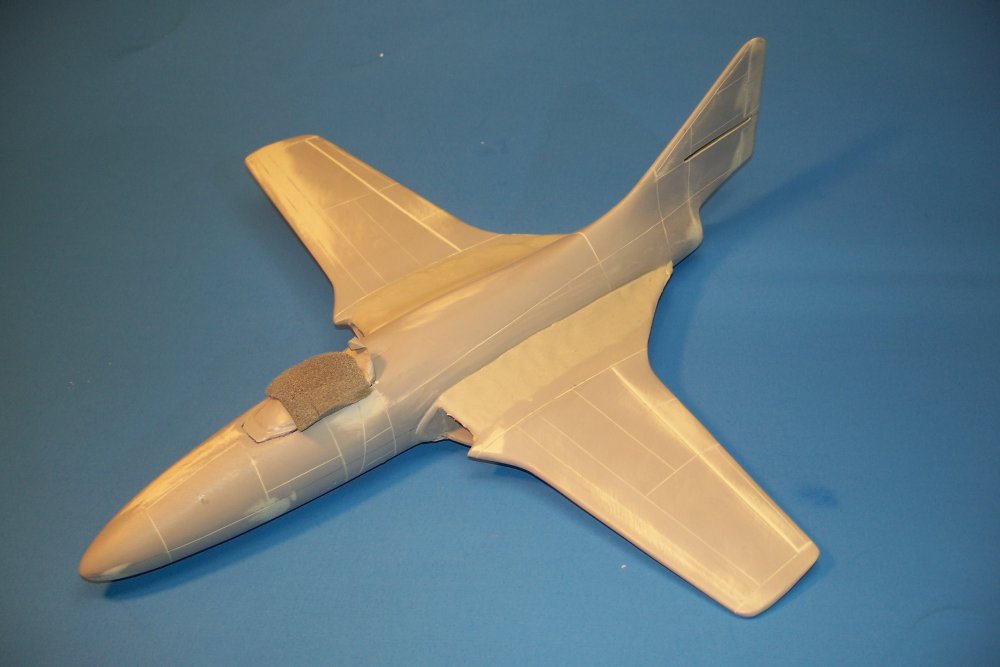

Next up is to get the scribing done to blend that on the wings and fuselage together, as well as establish the closed gear doors and central flaps.

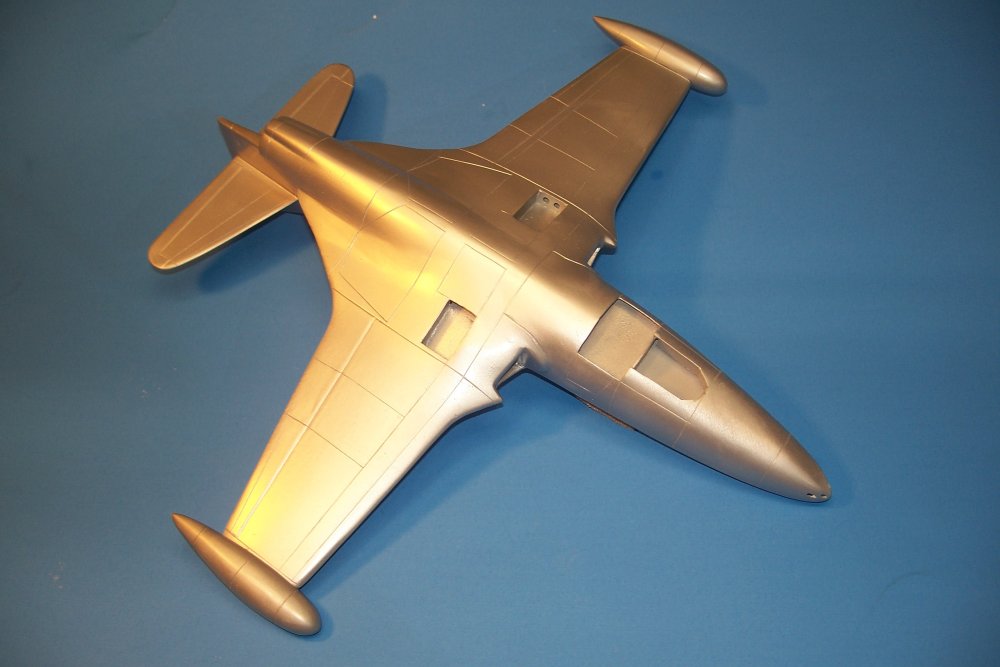

Rounds 2 and 3 of the sanding, scribing, and priming are done. I switched to using some Tamiya rattle can silver as primer in order to better show what imperfections were still there and the work was left to be done. Overall I'm pleased with the results thus far, though there's still the final round of primer down the road before the actual painting will start. Before that happens there's some construction work left to be done, as well as some final surface detailing to be added here and there. Still.... it is taking shape and starting to look like a Grumman Panther!

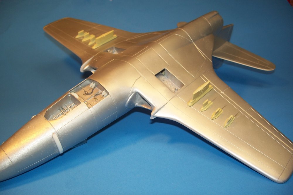

The bomb and missile pylons have been drilled and pinned and their positions under the wings determined. Also, you can see the gun gas deflector panel (the white plastic) on the side of the nose has been scratchbuilt and added.

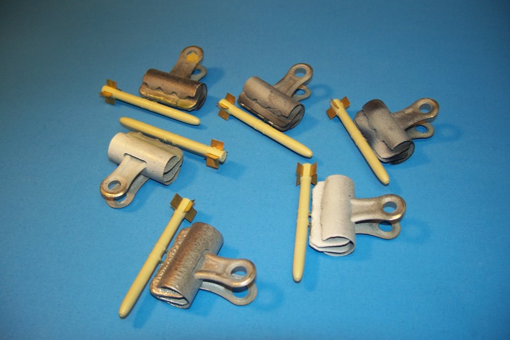

The resin rockets have been assembled, drilled, and pinned (and also now primed).

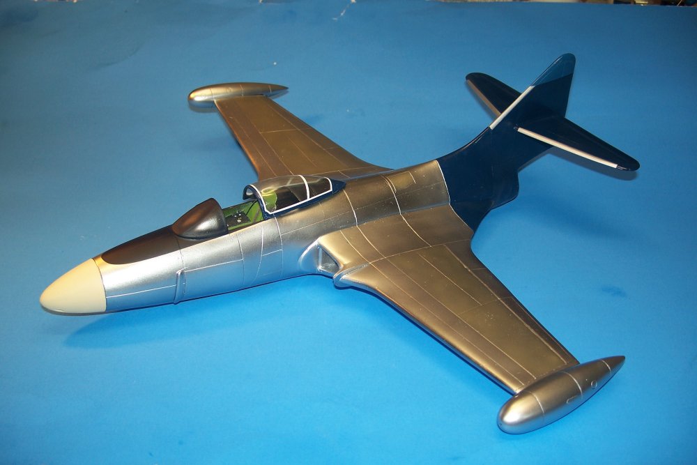

Thanks all for the very kind words! The Panther is painted!
Used Alclad Aluminum and Duraluminum for the NMF. Decaling will be next!

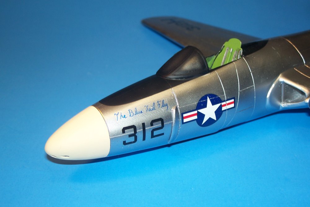

And the markings are all on....
The plane names (it's on both sides) were hand written onto decal paper using a .03 tipped Blue Sharpie permanent marker several times and the best 2 selected for use. I sealed the artwork with some clear gloss and then when it had dried applied them as the last decals to go on. The rest of the markings all came from an assortment of 13 different decal sheets from the spares box. It pays to hunt down all of those various scale stars/bars, letters, and numbers decal sheets in the vendor areas and buy them so they're handy when the time comes!

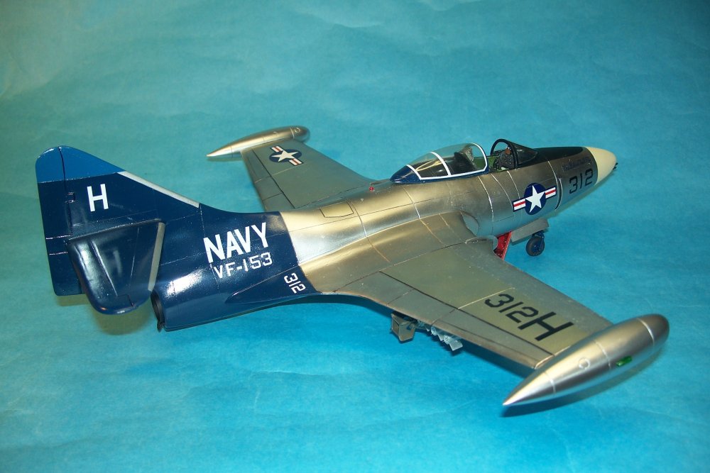

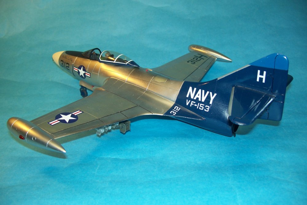

For better or worse.... she's done!
This model wouldn't survive 30 seconds under a judge's eye, but I'm happy overall with the result. My main goal was to pull off this paint scheme and though flawed, it looks about as good as I can expect considering the starting point. This was number 19 for this year and my 370th "recorded" build since I started doing so back in the mid '80s. If my airliner decals arrive by Monday from Joy decals, I might slide a 20th in under the wire!
