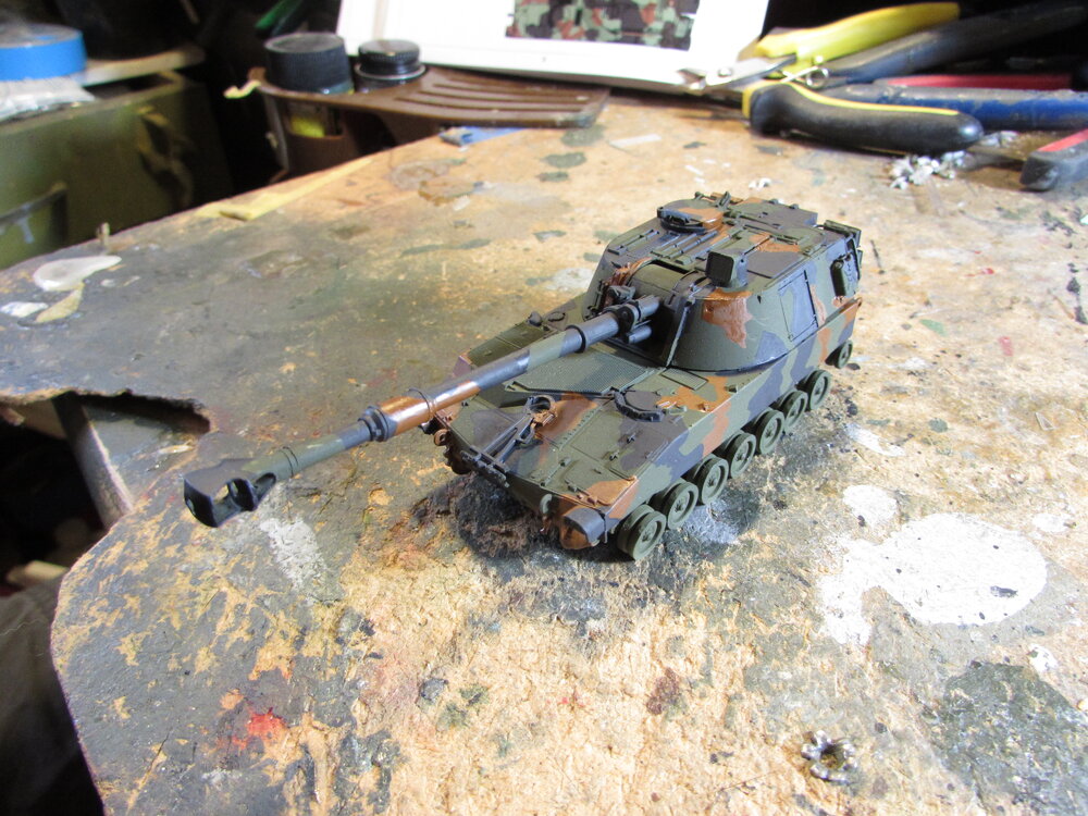

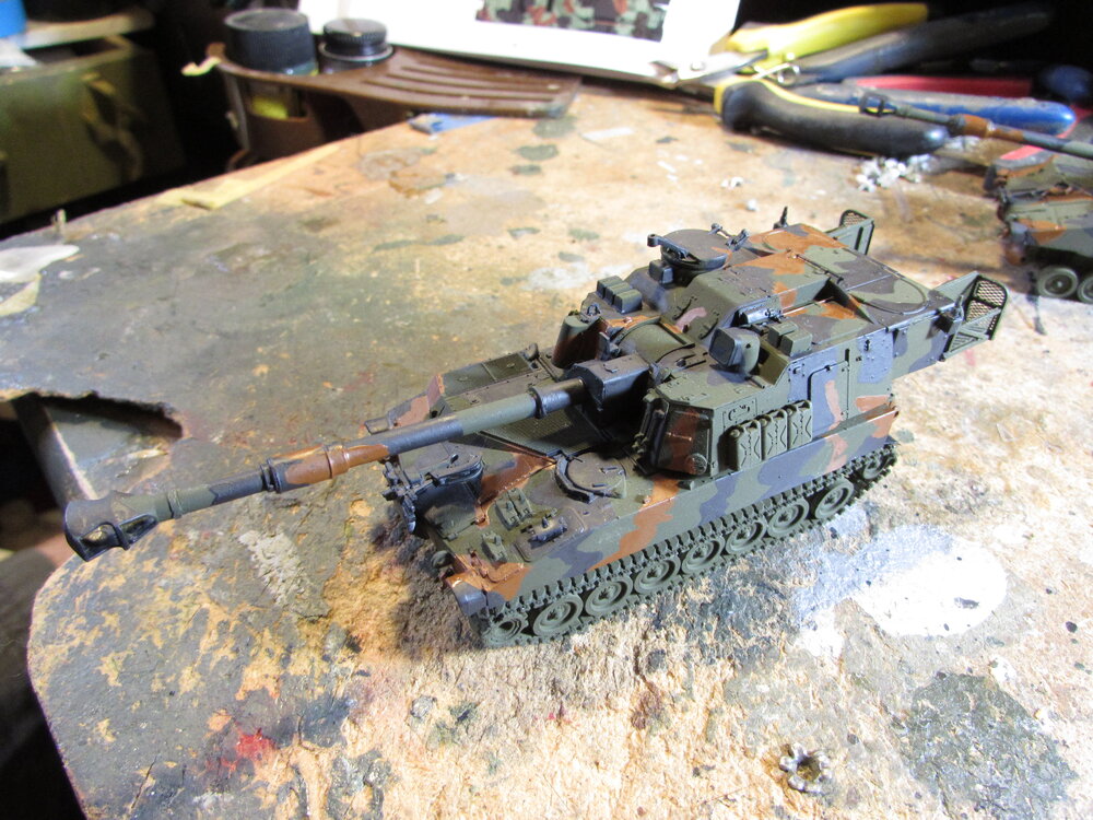

Mark Deliduka Posted May 28, 2021 Report Share Posted May 28, 2021 Having done that very thing for more than twenty years before getting an airbrush, I can say it's not as effective as an airbrush with proper masking. Occasionally, I still use a brush for my 1/72 scale armor camouflage However, I've found that having the softest brushes that have no loose bristles tend to do the best job. I also have slightly thinned the paint so it lays down better and use the tips of the brush to make the edges. Sometimes a stray bristle makes a rough line, but then I turn the brush and re-do it. Here's some examples of the results: Link to comment Share on other sites More sharing options...

Mark Deliduka Posted May 29, 2021 Report Share Posted May 29, 2021 True Stuart, I see no reason to mask if I'm brush painting as there's far more control over where paint goes. The exception is when I'm painting around clear parts: windscreens, windows, canopies etc. That way I can continue a pattern over the mask to the other side and when the masking is peeled off, the pattern looks more consistent. Otherwise, yeah: no masking when brush painting camo. For masking camo for airbrushing I find the Silly Putty to be the best masking agent for me. So, as Rusty said: good quality brushes and slight thinning of paint and you'll be fooling people into believing you airbrushed the model! Link to comment Share on other sites More sharing options...
