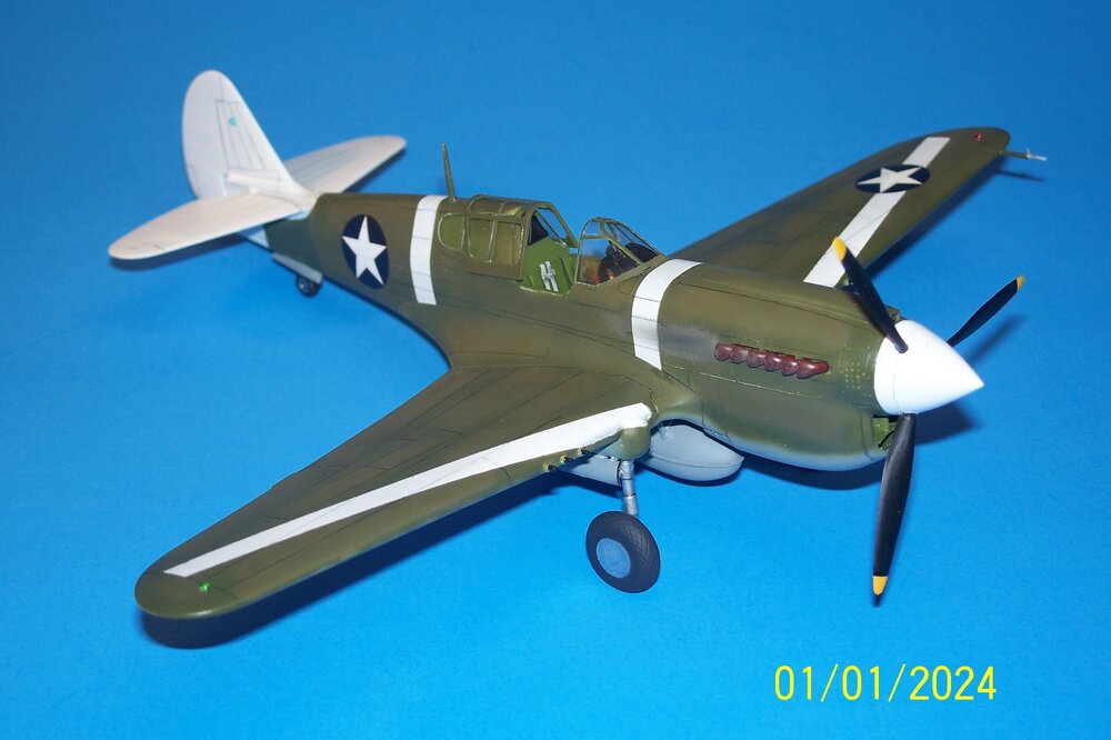

Someone posted a "24hr build challenge" for New Years eve/day, and I opted in. Proud to say I was able to "get 'er done" in just over 24hrs, starting at 2pm yesterday and finishing at 3pm today. This is the Mauve 1/48 P-40M with a True Details resin interior, but otherwise OOTB. The white in the scheme is actually the white primer used in the build, helping speed things along. I also used dry transfer stars, which eliminated the need to gloss and flat coat the model. Overall it took just over 10hrs of actual work, 7 of them yesterday (with final paint going on at 3am!), and 3hrs today to finish painting and assembling all of the details. All in all, it was pretty good fun to get one done in a day!

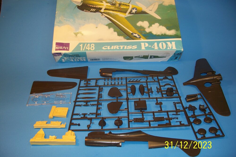

The starting point at 2pm.... I spent the 1rst hour just masking off all of the clear parts!

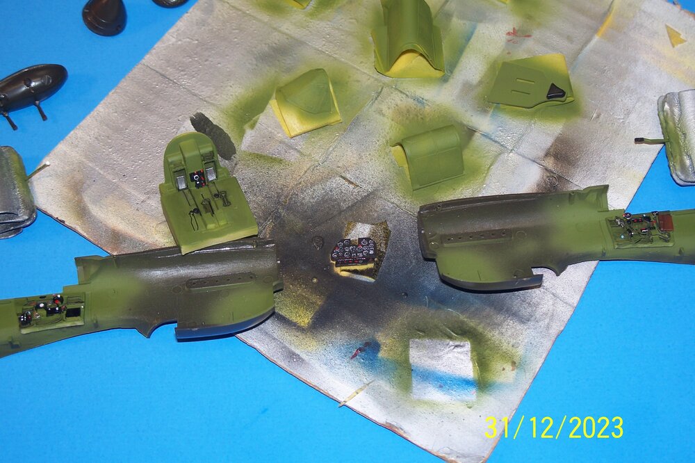

This pic is at 7pm. You can see all of the parts that have been glued and assembled, as well as all of the interior painting done.
A close up to show the resin floor and side panels. as well as the kit main IP panel.

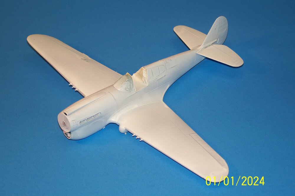

Took a break to let the glue dry a bit and came back out about 10pm to sand seams and apply the Tamiya Fine White primer.

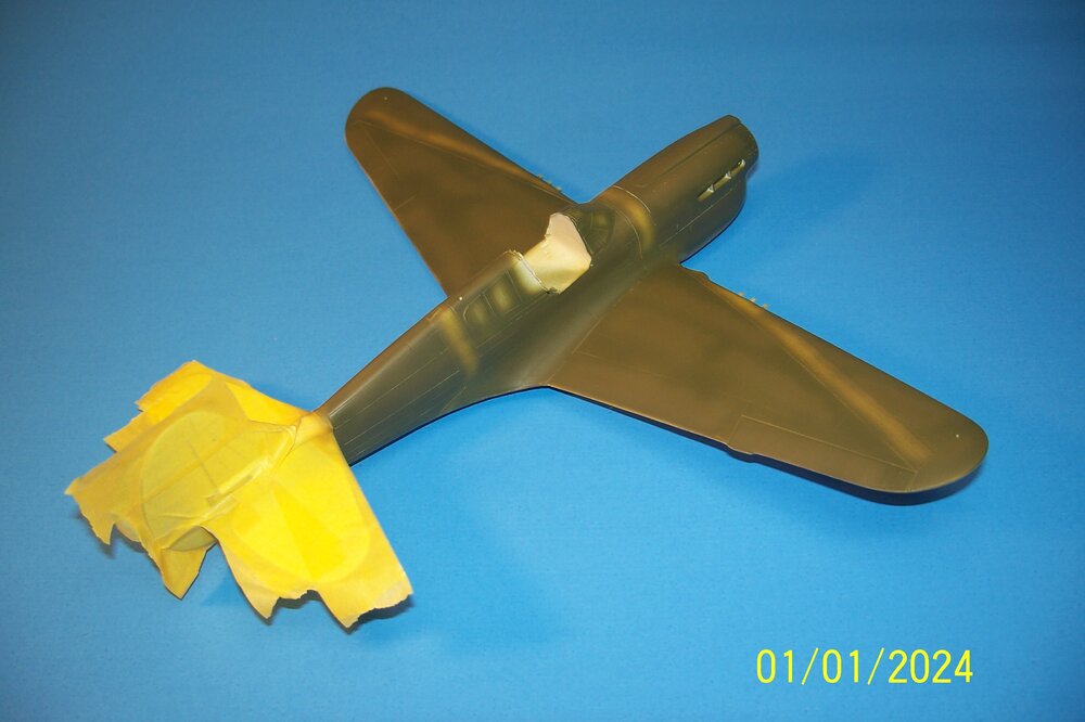

After allowing the primer to dry for a few hours, got back to masking and painting about 2am, applying the bottom gray using Alclad Gray primer.
This was it's condition as of 2:30 am...

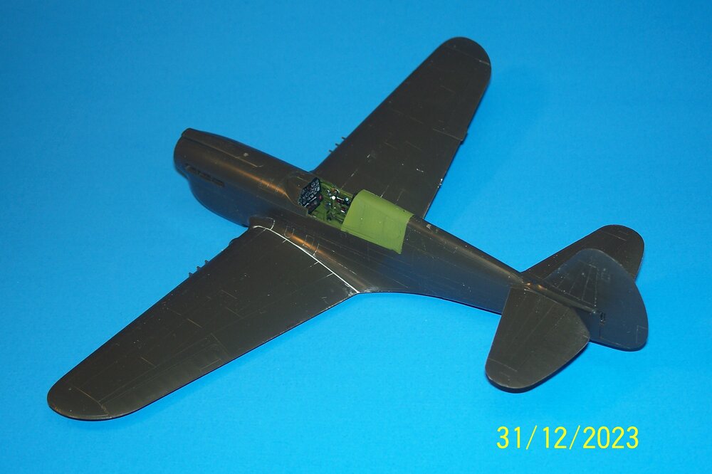

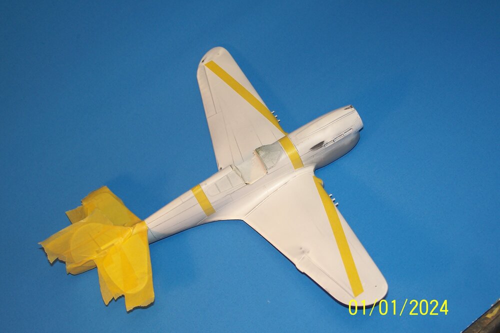

The OD has been applied, along with some lighter faded OD to finish the painting process at 3am.

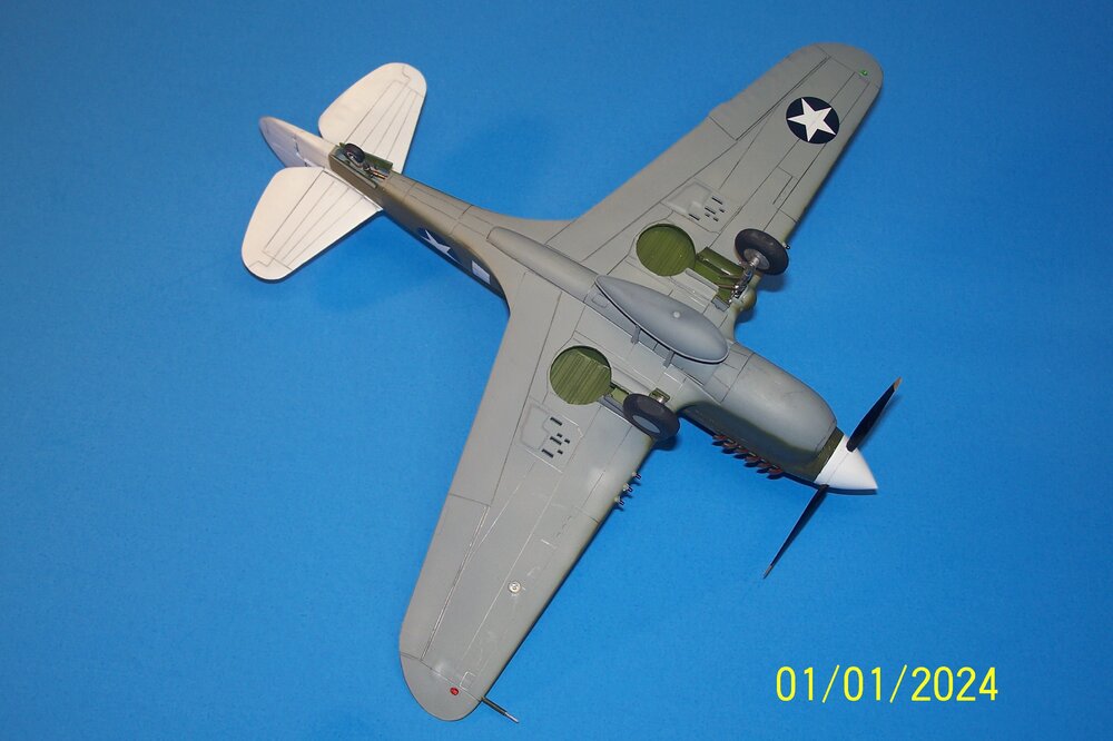

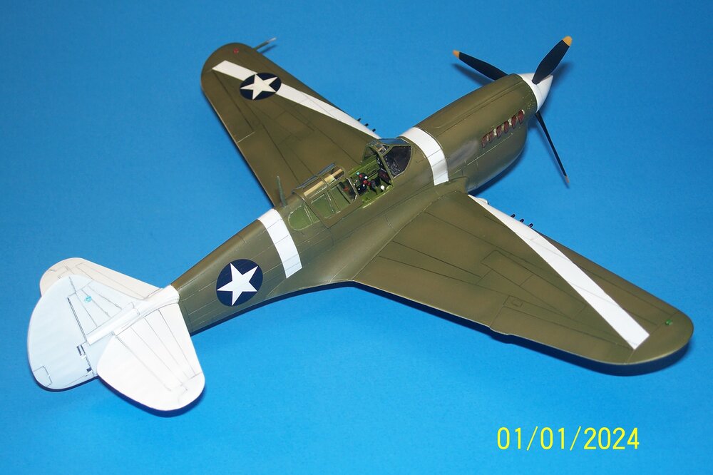

And on to the rest of the finished model pics!
Comments, critiques, and questions welcome as always!
Unbelievable job in one day Gil. Are those white stripes on the fuselage and wings decals?  I’m curious about why you masked those areas before you applied the olive drab coat. Do the decals adhere better to the primer coat?  If you painted those stripes, can you explain your process?
Edited by StuartMont
Now that is some hardcore model building! A completed kit within 24 hours! Not to mention being built to a high standard! Wow!!! Bravo!!!
Thanks for the very kind words!
Stuart (and all): the white stripes on the wings and fuselage (like the white tail) are actually the white primer used during the build (rattle can Tamiya Fine White primer).  It dries well enough to handle and mask in 1-2hrs, which is another one of the reasons I used it on this build. That way, after priming the model, all I had to do was mask off the stripes and the tail before applying the gray on the bottom (Alclad Gray Primer, which also dries in about an hour or less) and then the ODs on the top (Tamiya lacquer and MM).
Decals generally will adhere and go down worse over a primer coat because the paint is so flat and "rough". I only used dry transfer (rub on) stars that had no clear surround to them, so I didn't have to worry about applying a gloss coat to smooth the paint for decalling, or then having to add a flat coat at the end. That said, technically those stars aren't "sealed" in place an could be scratched/damaged if I'm not careful in handling or even pulled off with tape if needed.
