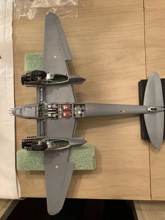

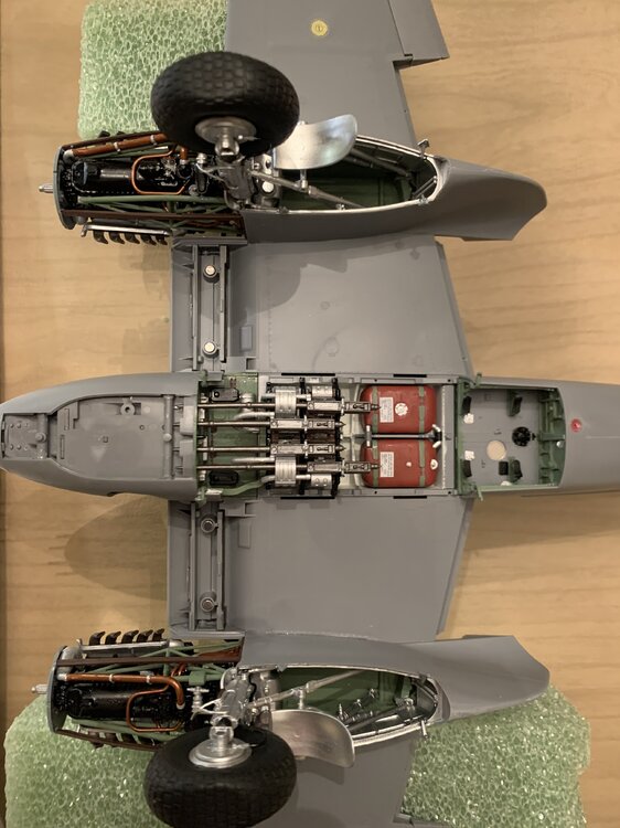

I wanted to post progress photos of my build of the Tamiya 1/32 Mosquito.  It would be great to read comments on how I can improve.  Several photos were posted in the “techniques“ forum where i received very productive comments and i have put an aircraft weathering how-to book and some weathering products on my wishlist for Xmas.
There is a specific issue that i wanted to discuss (although there is nothing i can do about it now).  The wheel/tire assembly consisted of many pieces in order to mimic the flat spot at ground contact.  I took great care in putting all of it together.  However, when I mounted the nacelle to the wing/fuselage, i was very disappointed to find out that the flat spot on the tire is not flush with the surface.  You have to get down and close to see it but there is definitely a triangle of light that shouldn’t be there.  If anyone out there built this model i would love to hear wether you also had any issue with this detail?

Nice progress and excellent detail painting! Getting the flat spot perfectly aligned can be tough....but it sounds like some slight sanding might change the angle of the flat spot just enough to eliminate that sliver of light you saw. The only other suggestion I can make is that for future builds, try not to glue the tire in place without also at the same time test fitting it and the entire gear leg assembly to the wing so you know the tire's in the correct "spot". On a tire like the Mosquito's, you might even be able to leave it loose in place until setting it on it's gear, and then add a spot of super glue to the hub/axle to cement it in position. All in all, it's a very minor thing, and shouldn't detract at all from those lovely details!

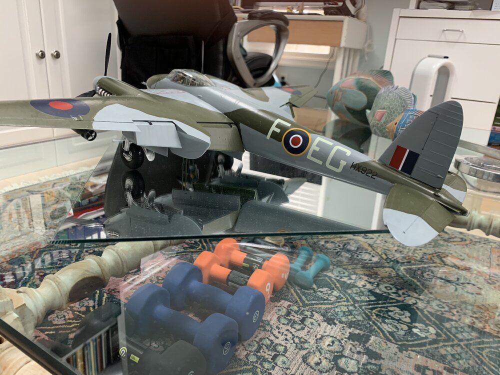

Here is the finished product sitting on a mirror base as suggested here.  Difficulties still include the application of decals and the hand painting of very large surfaces.  The thickness of my coatings are noticeably different.  Question - how many of you apply the “hundreds” of tiny decals?1BEABF92-38E2-421E-895E-544CC02E44A1.thumb.jpeg.cb5a575c9c90a607398a653fb2cdafd4.jpegF5DC1C0C-E843-482E-994D-E2851762D507.thumb.jpeg.35897c9e120ce07dd320ffd2894e0dcb.jpegBE5F981D-1849-48C6-A041-F23A61277081.thumb.jpeg.7bc8202ef3d6e7e7078d7cba2d3d8557.jpegCE1923D2-DCE7-4518-945A-BF733FC16C81.thumb.jpeg.d2fcb97d2d15fd2a32ba8d35d6d2b482.jpeg
Beautiful job! I am most impressed with this model!
I will only apply most of the stencils that can actually be seen. Anything else that looks like a smudge or out-of-place dot of paint will stay off as I invariably paint over them thinking they are flaws in the finish. LOL! Anything that looks like a stencil of information that enhances the look of the model goes on.

Decals continue to be frustrating for me.  They went on nicely when I built the Corsair but not so much on this one.  I have to start trying the solutions that are sold at hobby stores but I don’t see how that will help the tiny ones.

Tamiya decals have a reputation for being way too thick and hard to work with so I can see where they were a source of frustration on this one. Aftermarket decals such as EagleCals or Peddinghaus are alot thinner and alot easier to work with.

Good looking build! Brush painting without getting it too thick or leaving brush marks is always a problem. My suggestion, if you continue in this method, is simply to do some VERY LIGHT sanding of the overall paint finish once it dries. Use the 1000 or higher grit wet/dry type, and WET sand all of the surface with a LIGHT touch....using just enough pressure to take off the very top "extra" layers of paint. This will (hopefully) make the paints all look "level" and remove some of the brush strokes. With luck, it may even add a touch of a weathered look to the finish.
After you get the camo where you want it, then brush on a coat of Future (now Pledge all purpose) clear acrylic. This will further give a more even look to you paint surfaces AND also provide a smooth surface for your decals and help avoid silvering. Once the decals are on and dry, seal them with another coat of clear gloss.
To get the final flat finish, spray it with a can of Testors Dull Coat, or Tamiya clear flat. BUT, be sure when you spray the flat that ALL clear parts are masked off, or they'll get "dull" too!
That's a great looking Mosquito and the presentation on the mirror is the icing on the cake! Congrats, and thanks for letting us ride along!
