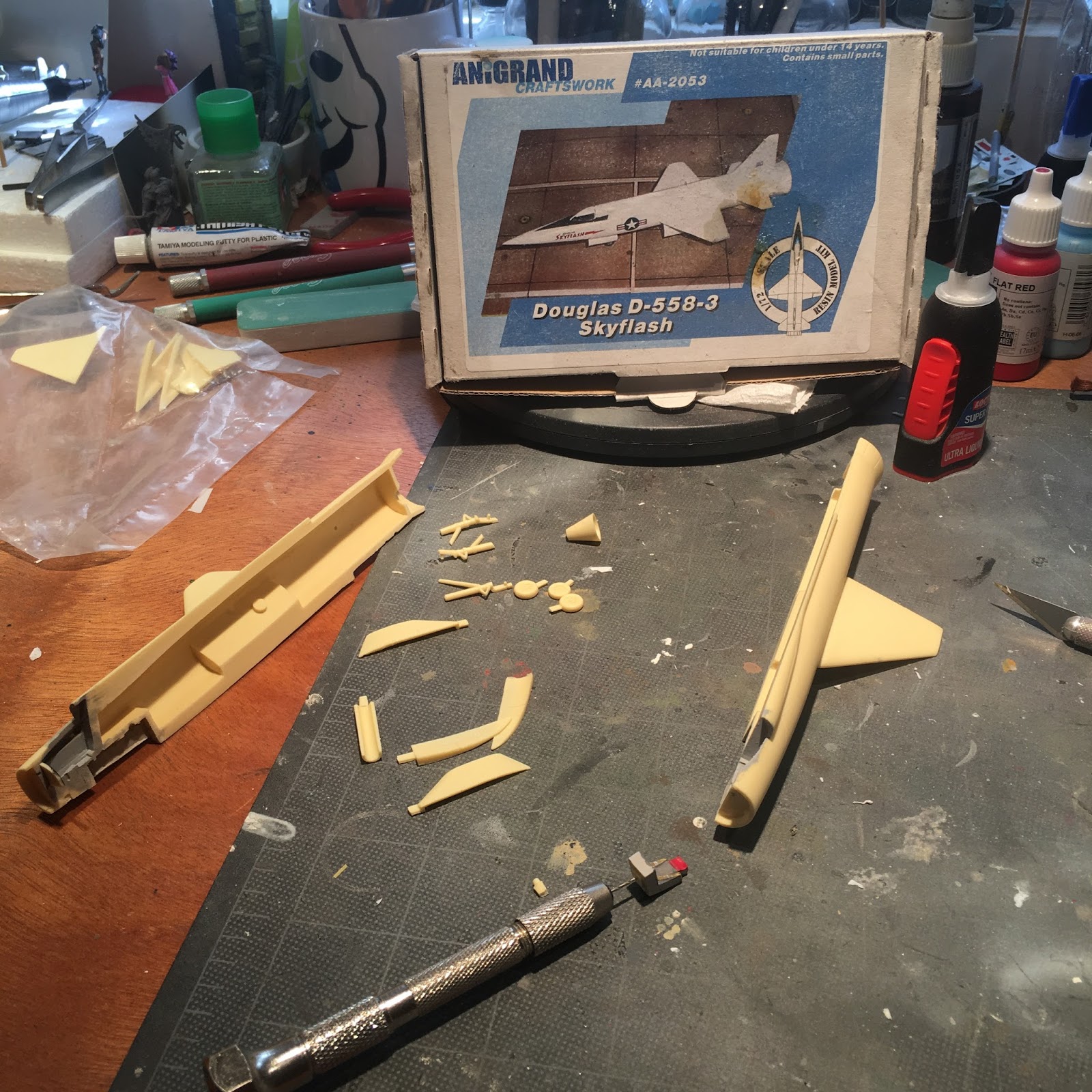

Here's the kit box art and parts -

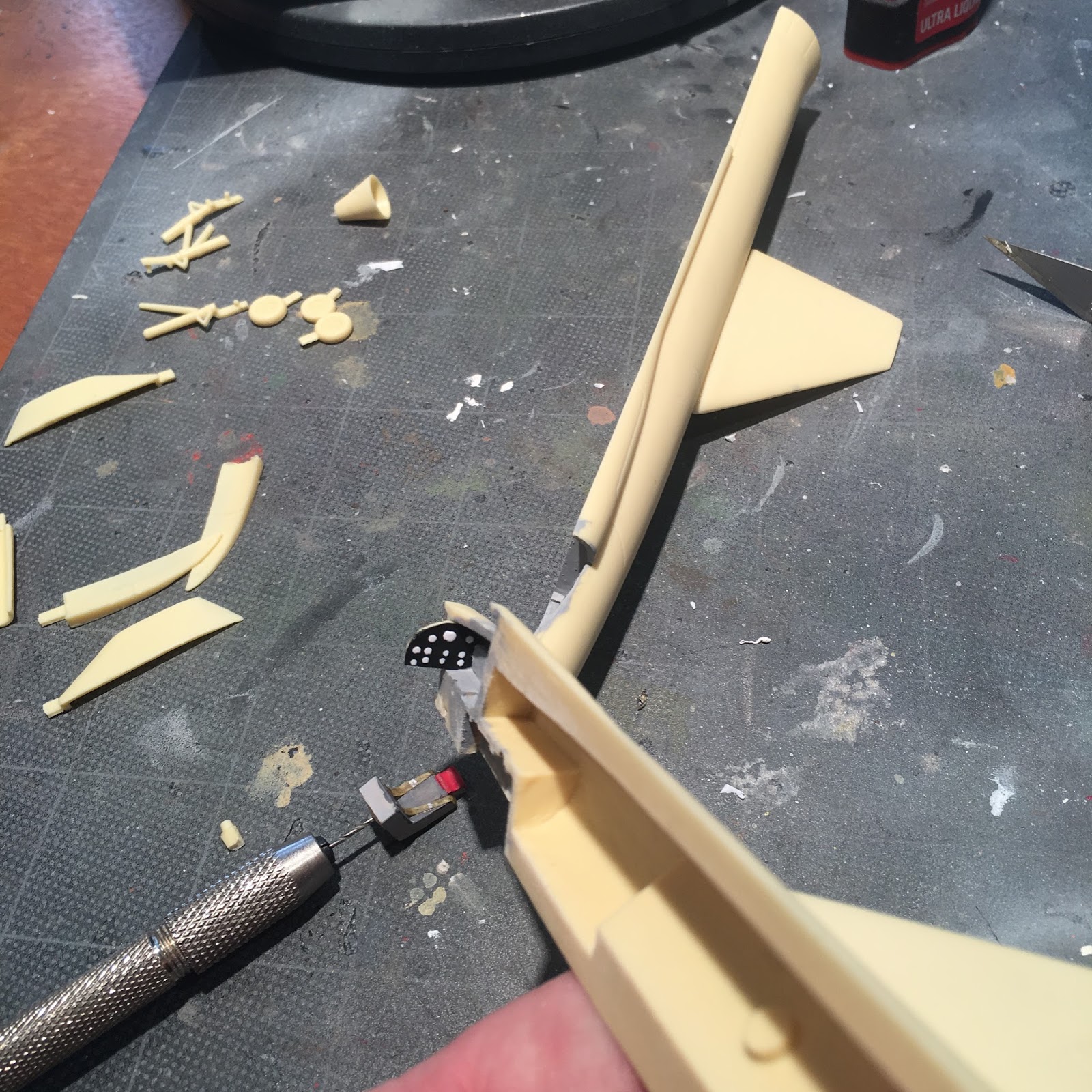

While there is an instrument panel, there is no detail to it. There are no decals for it, so I just added a few dots of white to mimic instruments. It looks like there's not a lot of room in there so this should suffice -

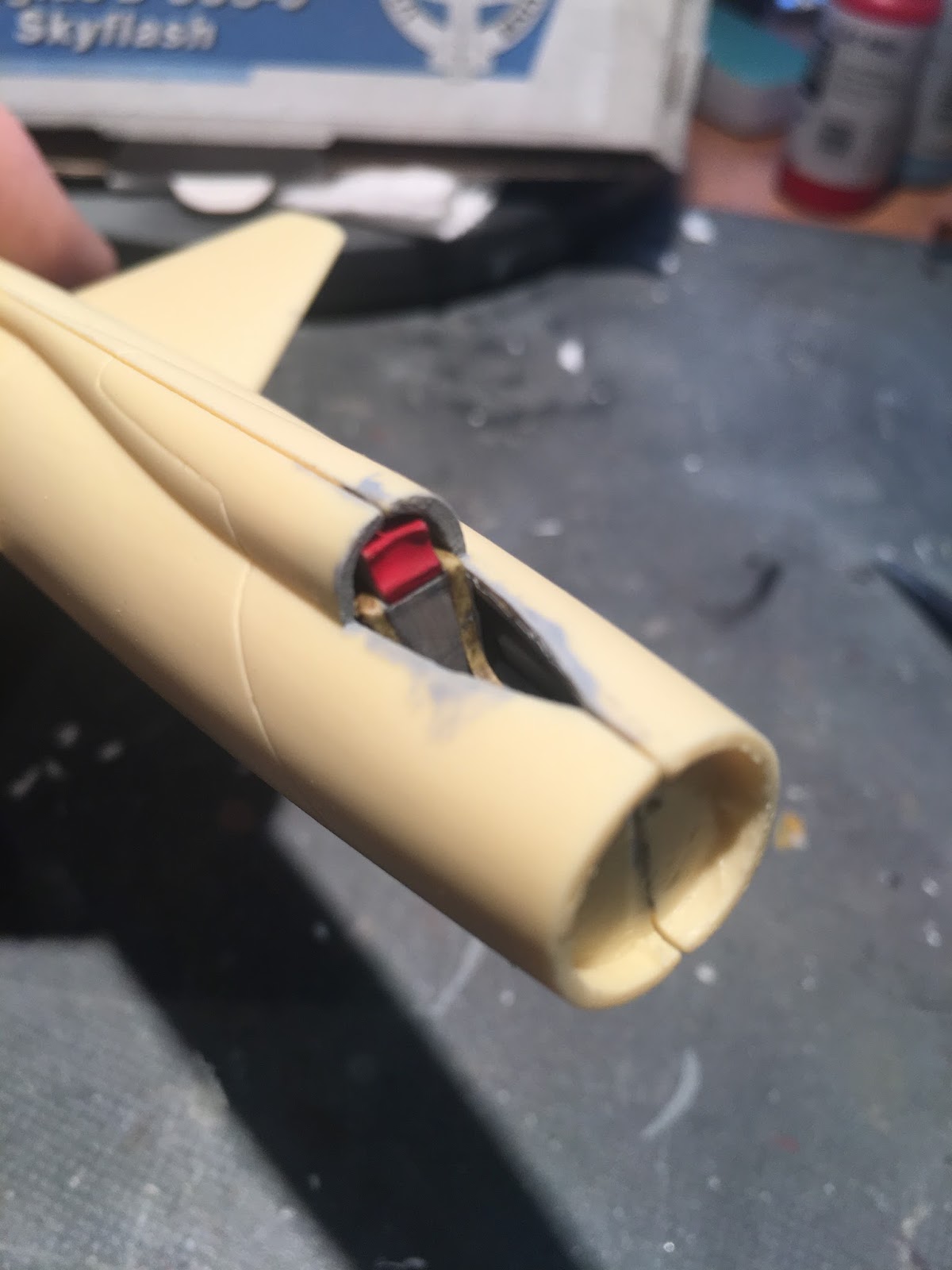

Not a lot of room seems to have been an understatement ;) I also added some Tamiya tape seat belts -

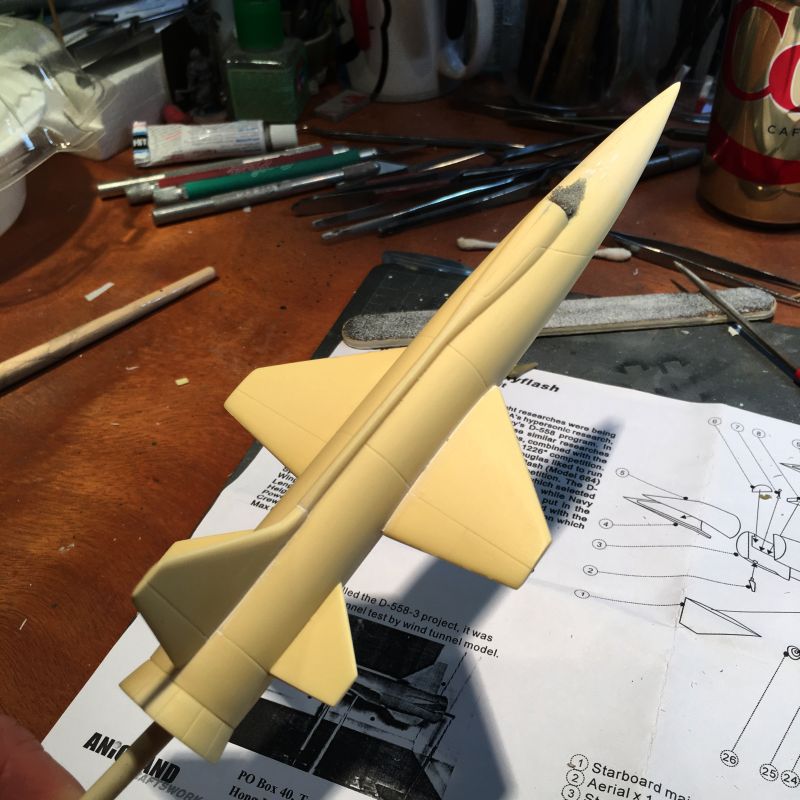

Nose cone added. This is going well -
The fuselage is mostly complete - Time to fill in the seams.

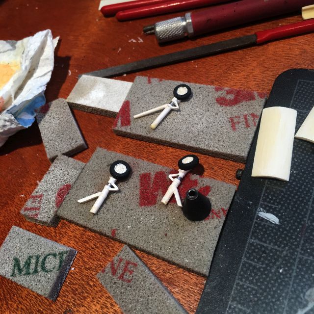

I applied Tamiya filler for the seams. While I'm waiting I painted the landing gear, wheels, and landing gear doors.
Added primer to see where I am re: the seam lines. Not bad, but I'll give a few spots a second go round. This is where I took my "Going to the Nationals" break.

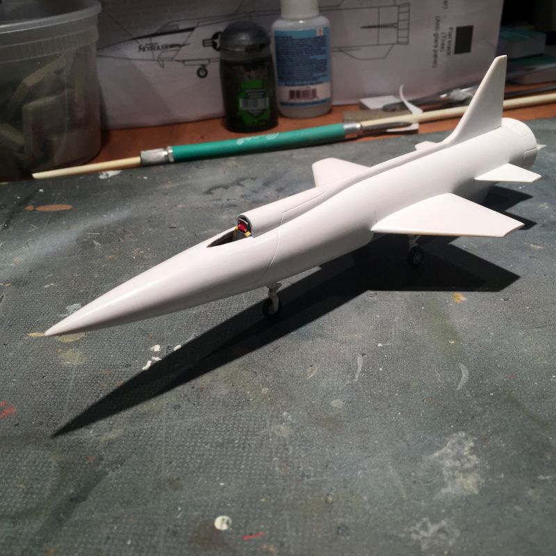

While the wheels were drying, I turned my attention to masking off the canopy. It was then I noticed I never even touched it. So I dipped the canopy in Future. While *that* was drying I went back and had a look at the wheels. Looked good. Then it suddenly struck me that I never put any weighs in the nose. Oh boy, I hope it's not a tail sitter. Turning it over while half wincing, I gave it a try. Whew, it rested on its wheels -
Now I turned back to the canopy. Now in the past 3 planes I did, the vac form canopies gave me fits. So I started my cutting, sanding and fitting with some trepidation. After about a half hour, I gave it it's 3rd fitting and Holy Moley, it looks good!
I was very happy and with that fit and decided to not press my luck and call it a session (BTW that piece of dust is not in the paint, and was easily whisked off).

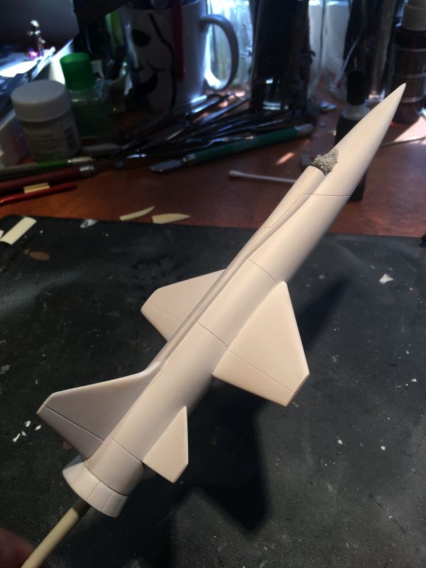

Having a relapse I left it for a few more days, and when I got back to it I wanted to apply a gloss coat over the decals to seal them in before continuing on.
Here's where disaster struck!
I sprayed on the gloss and all around the cockpit the paint alligatored!!! Bad! WTF! :angry: :angry:
I was so PO'd I just walked away. I really wanted to fling it off the wall.

Thanks. I looked at it today and only 1 section remained alligatored. The other sections drop down to a rough pebbly feel. I'll leave the paint harden some more for another day or so and then *hopefully* I'll be able to smooth the areas and repaint. I guess the bright side is that Anigrand sells extra decal sheets - in case I f*#k them up... <_<

Looking at the model the alligatoring clear coat in many places had settled down to just a rough pebbling. Being the pebbling was very close to the decals I wanted to be ultra delicate so I wouldn't have to redo the decals. I had 3200 sanding sticks and went to work. Not strong enough. I moved to some Ultrafine sanding pads (I forget the number) and once again started in. Even that wasn't budging any of the material. Finally I got out the regular "Fine" pads and started in this seemed to work. After a few minutes of light scrubbing I had the fuselage to where I wanted it. I got a little too close to one of the decals, but some paint fixed the goof.

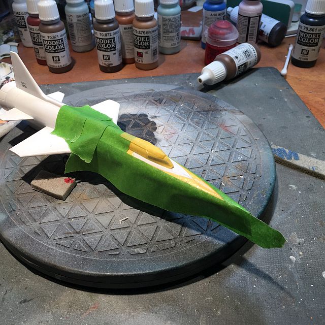

From there my next step was to mask off where the anti-glare panel -
Yellow tape is Tamiya, Green tape is Frog tape - good stuff
Using Vallejo's Black and my a/b set to a low psi, the panel went on with no problems.

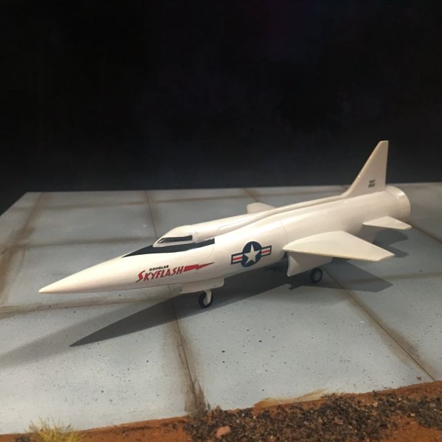

I'm happy to be calling this one done... Thanks for looking.
I thought I was finished until I came across the landing gear doors while I was cleaning the work table. So I go out the CA and now I'm really done. ;)
I thought to "celebrate" I took out my "airfield set" and set the jet up. Thanks for looking.
Wat to go Kevin and congrats on beating this into submission. You've done a beautiful job on a most attractive looking model.
That's really nice looking Kevin. Great save on the paint and decals.
This plane must have been a real treat to fly with the size of the control surfaces.
