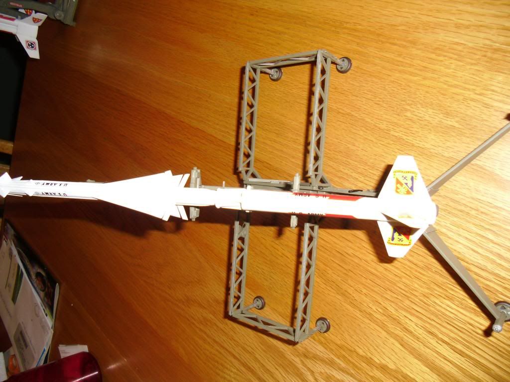

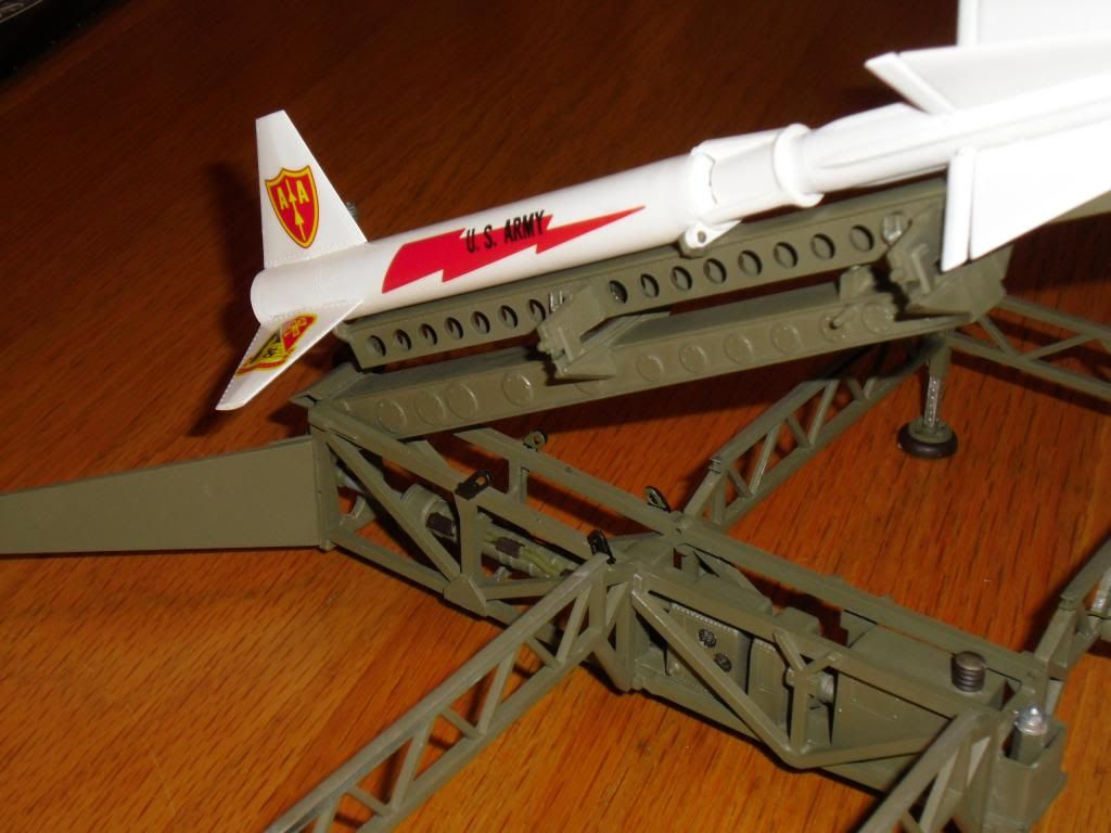

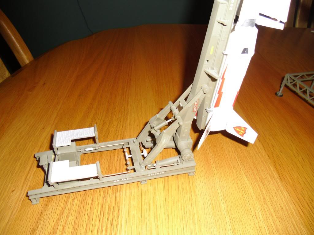

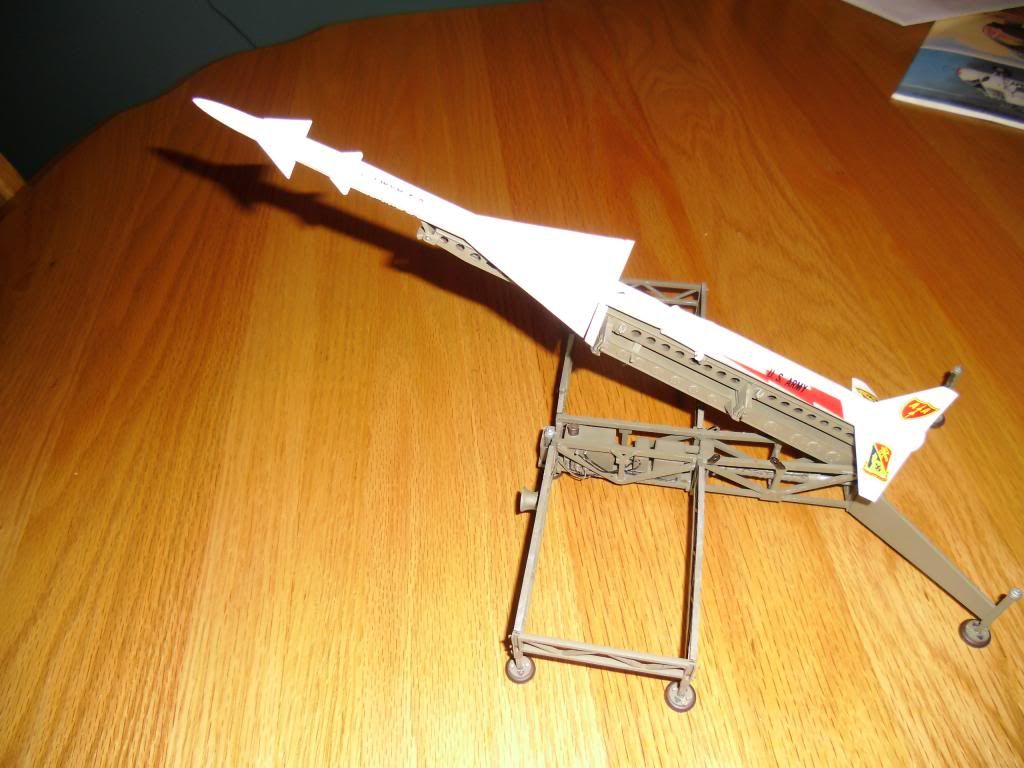

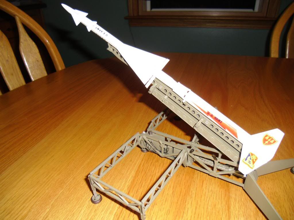

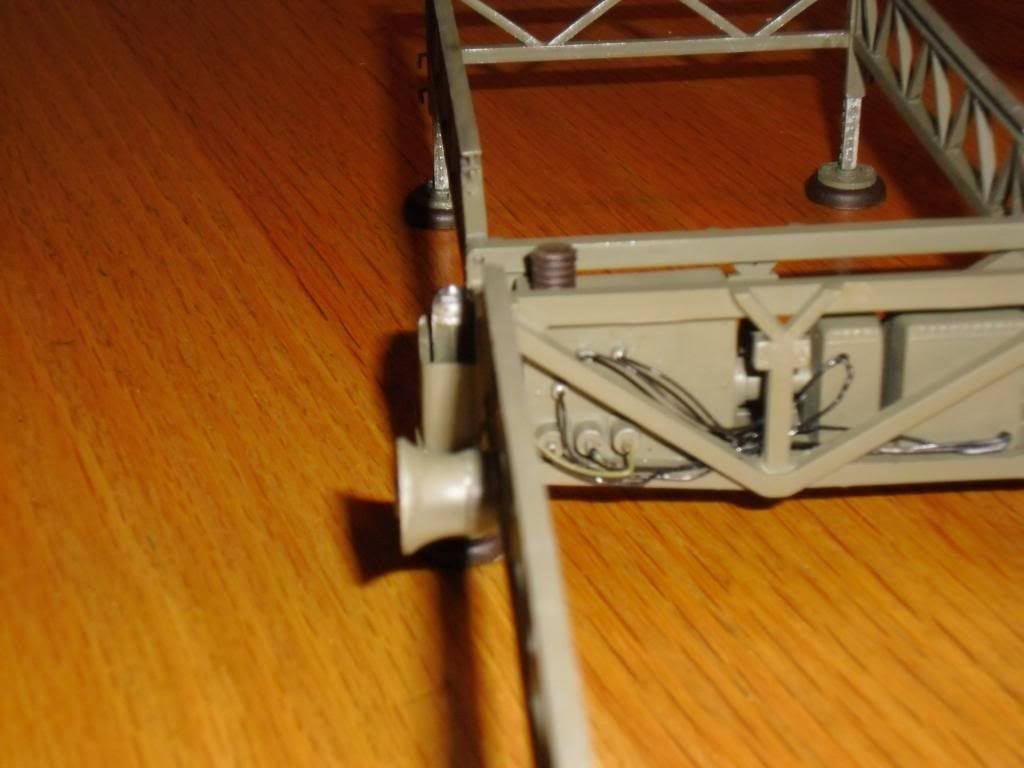

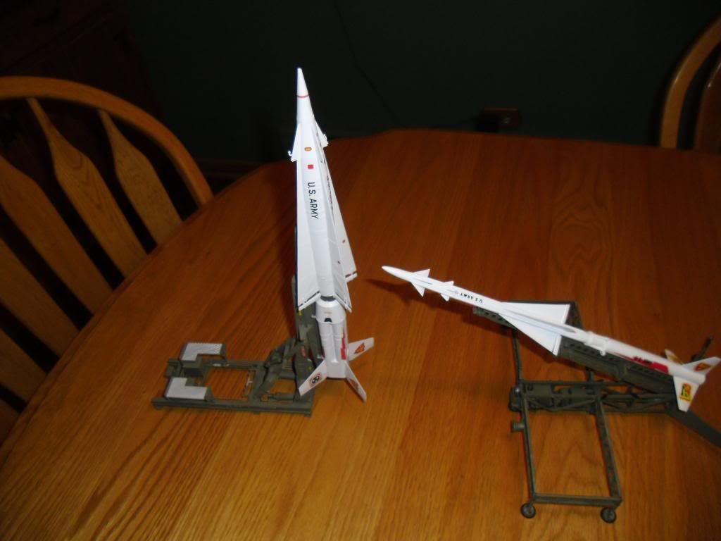

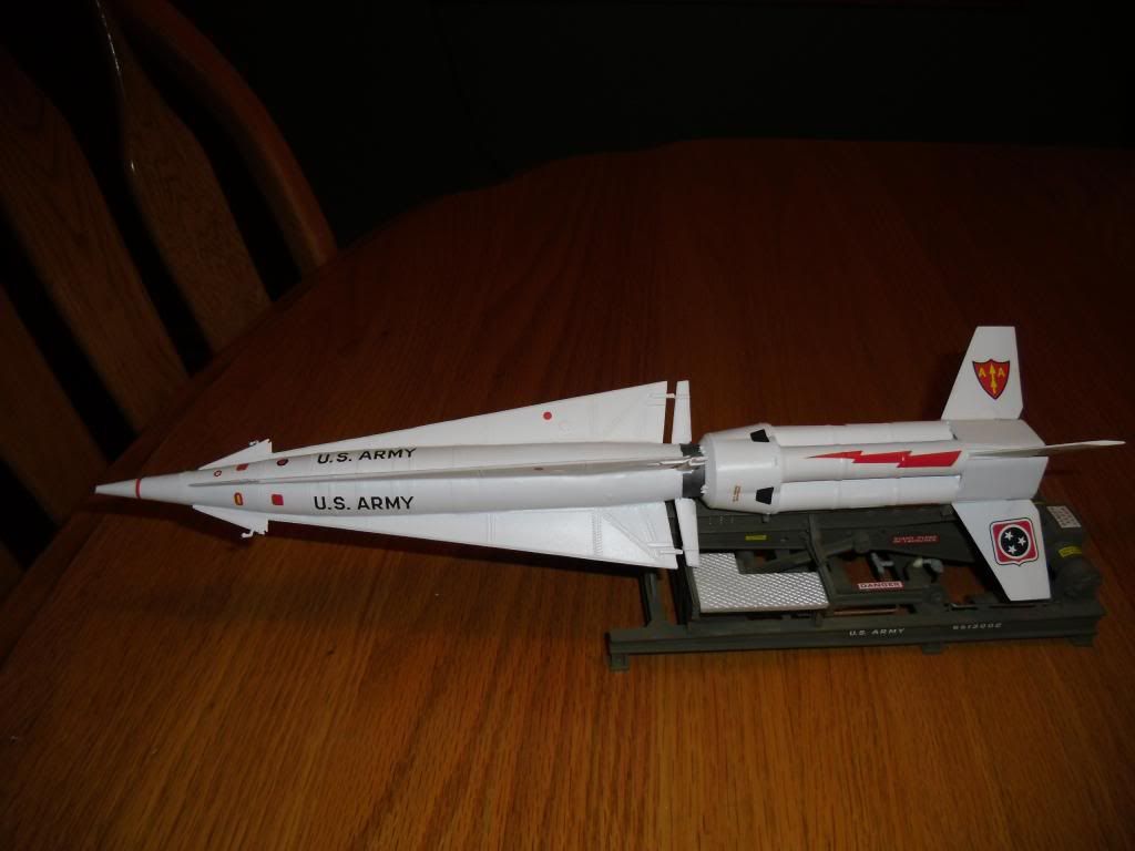

WildBill50 Posted September 11, 2013 Report Posted September 11, 2013 Hello all, Summer is over and one more model is on the shelf. I had to get the Ajax since it was re-issued. I've always liked this SAM as a kid. There was one by the VFW in my hometown growing up and I always thought it was cool to see out in front of the building. No one really took care of it though and it finally fell over one night due to it rusting away. Now there is a Hercules near where I live at the Post office. The kit overall is pretty nice, but there are ejector pin marks on a lot of pieces and also mold separation lines to clean up on all of the pieces. A couple of sink marks here and there to be filled with some putty. Once you get all of this cleaned up there is a nice little model in there. Not being a fan of working parts, everything on the missile is glued on its "no-show glue areas". This means no working fins (darn). The launcher was built in sections and painted in those same sections. I added some wiring to the machinery and klaxon horn and then put it all together and painted the resulting seam lines. A light weathering with some aluminum paint and colored pencils and the launcher was done. Decals were nice with no problems encountered. I painted the missile with flat white Krylon spray paint, overcoated with Dutch Boy Gloss White spray paint. The launcher was painted with MM Olive Drab Acryl paint with Testor's Rubber for the launcher pads feet. The Hercules was built some time ago. I wish they were the same scale. The Herc is 1/40th scale, so you can see that it would be quite a bit larger in the same scale as the Ajax. Hope you like it, and as always comments welcome.
wenwsaew1977 Posted September 12, 2013 Report Posted September 12, 2013 A well built kit. I was a radar operator at a Nike-Hercules missile battery,out in California. Revell made a model of the Nike-Hercules, and I brought it, but the instructions are in italian. But I figured it out.

WildBill50 Posted October 1, 2013 Author Report Posted October 1, 2013 Thanks guys. Fun to build, cool subject. Four colors to paint, with no crazy masking. What's not to like on this build? The local Nike site near my house is now the village civil defense office. All underground where the missile battery was.
