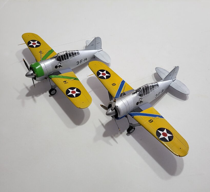

VMF211 Posted February 6, 2023 Report Posted February 6, 2023 I have decanted the Tamiya lacquers for a while now and love them. They airbrush quite nicely. I have used the new Tamiya lacquers in the bottles and they also spray nicely when thinned right. The colors on the PBY & Buffalo's are AS-12 'BARE METAL SILVER' which is a synthetic acrylic lacquer and TS-34 'CAMEL YELLOW' which is a synthetic lacquer. 1
