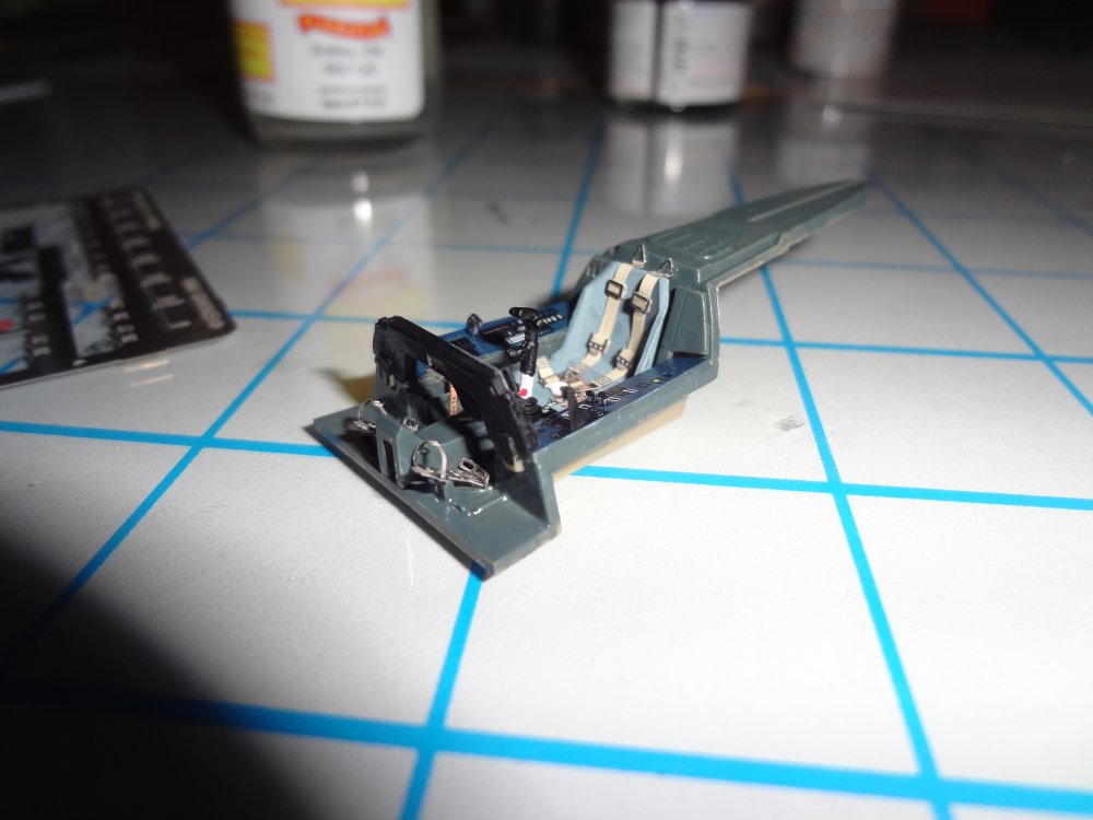

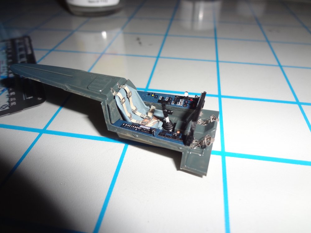

Wolfman63 Posted April 7, 2018 Report Posted April 7, 2018 Started on a 1/48 FW-190A-8 from Eduard. I will be using Cartigraf's Top Color # 38 decal set. Started on the main cockpit last night. Mostly assembled, just need to do some weathering/highlighting. More build photo's at https://davidsscalemodels.com/build-log/fw-190a-8/
