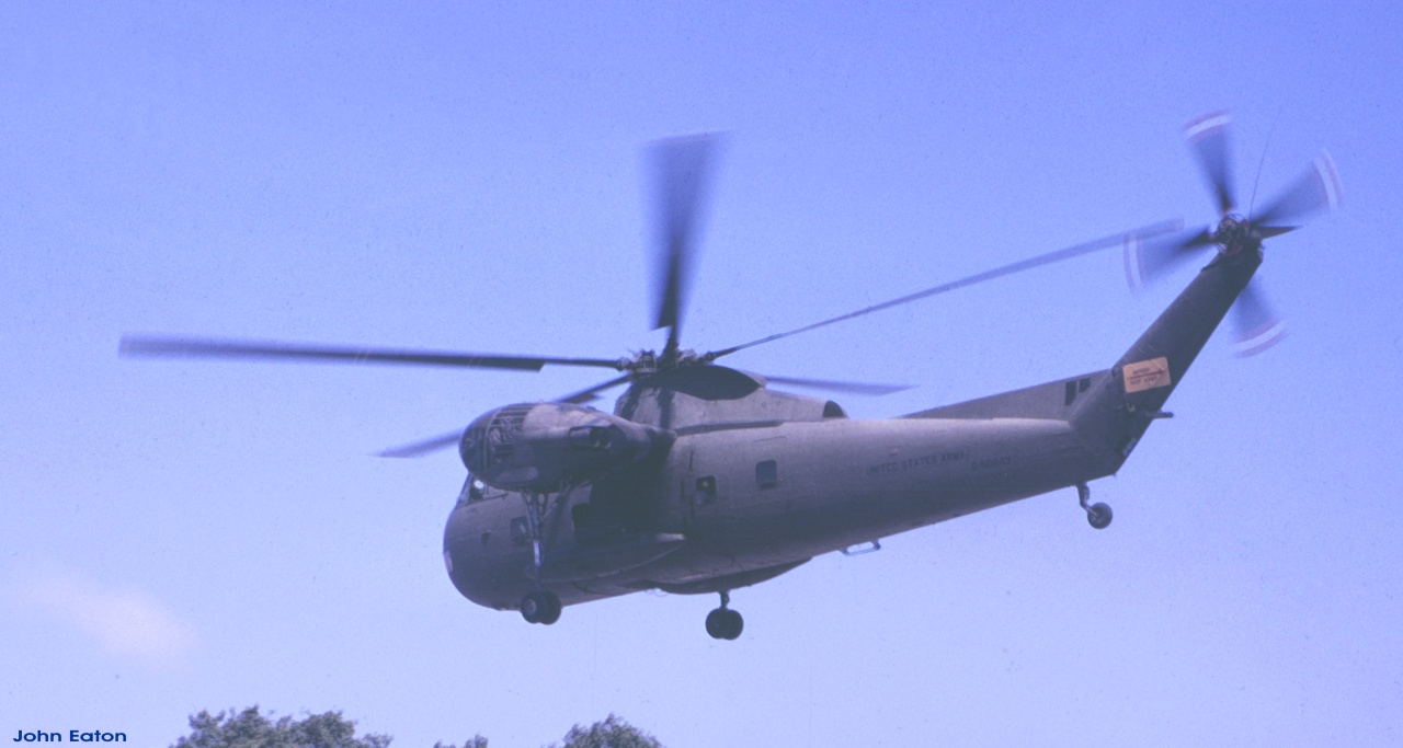

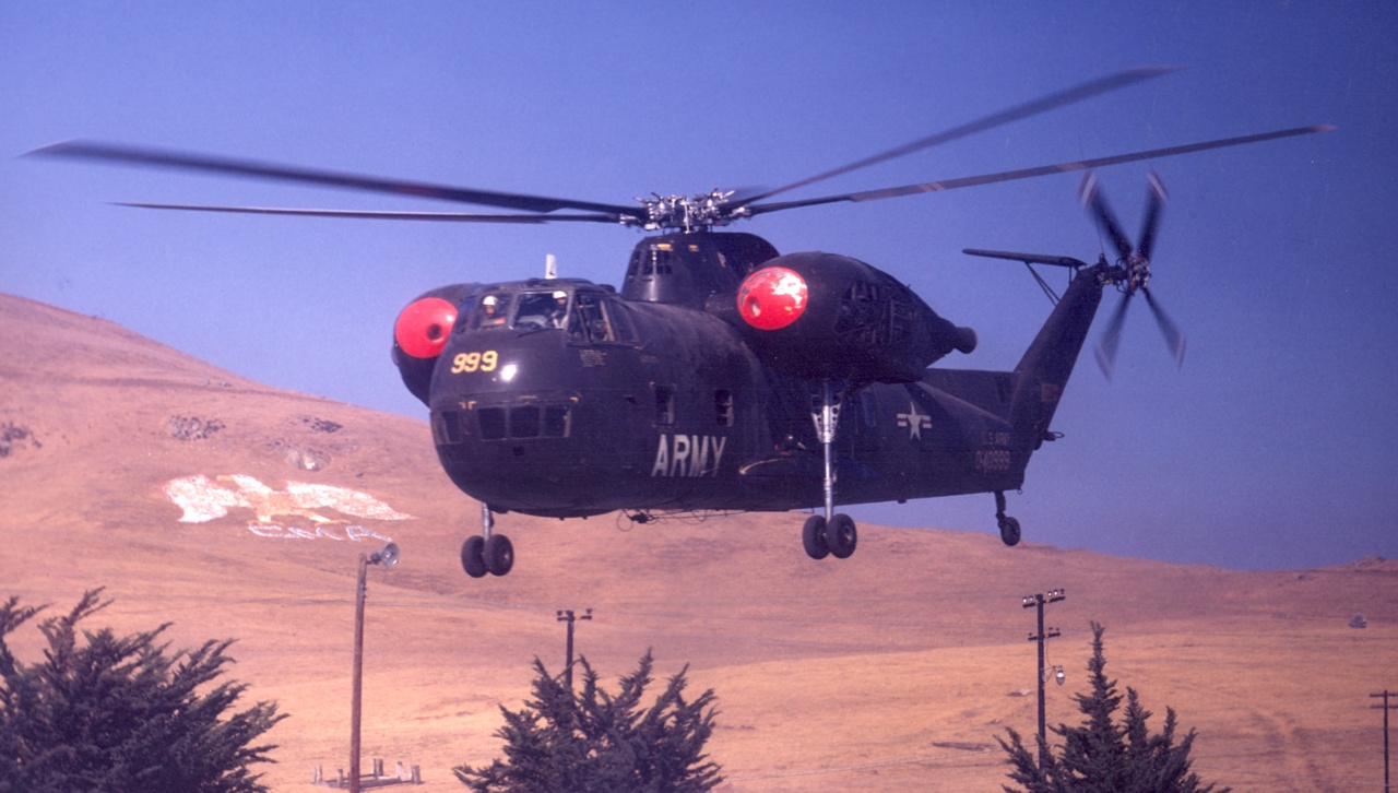

johneaton Posted August 8, 2017 Report Posted August 8, 2017 I think Olive Drab changes a lot depending on how flat the finish is. The CH-37's in my guard unit in the late 60's were transitioning to a flat finish from a glossy OD. Also the glossy finishes did not fade anything like a flat finish. Here is a CH-37 in the older finish, and then another after repainting in probably 34087.
