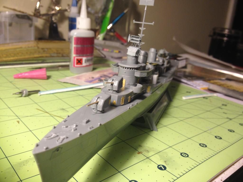

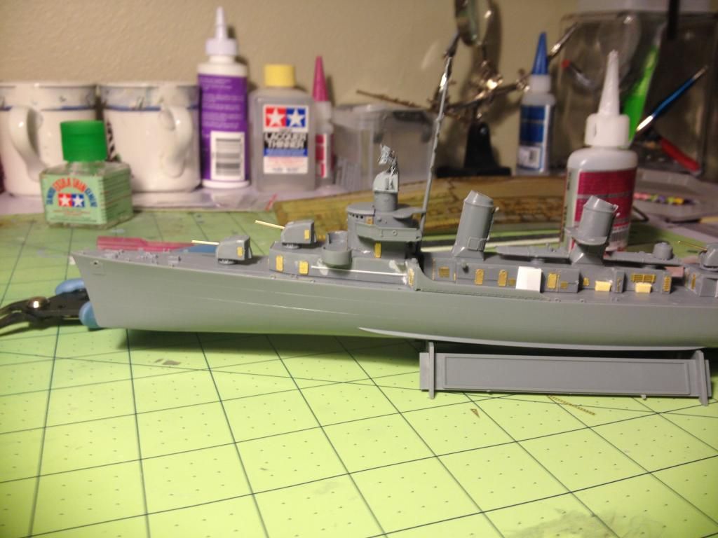

Anyway. Current progress. I've added PE to the forward, mid, and aft superstructure. They're mostly done outside of some port hole work at the bow. I have tool cabinets, cable reels, and ladders that I plan to add, but I'll do this after the base modified Ms. 12 camouflage. Again, I want Fletcher to look utilitarian and busy. I'll also be adding unreeled hoses and whatnot the crew was using to clean the deck.
4914D6A5-D041-4D36-9F51-10D33A7790E3_zps

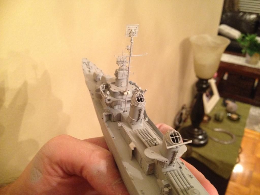

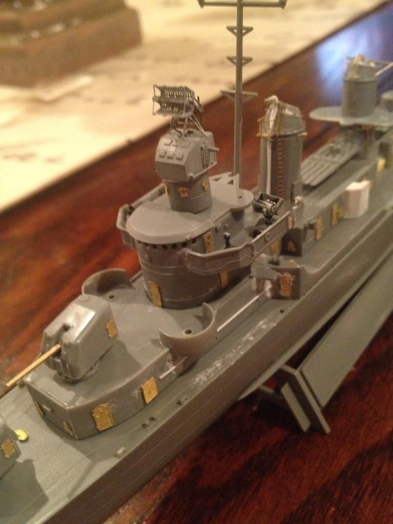

Bow view. I haven't puttied the hull/deck area but will shortly. The bridge wings also need a little bit of putty where they meet the conning tower. Still, overall? Fit is awesome. Her rangefinder is a gift from a good friend and currently has the IFF set that did not exist on the Fletcher at this time. I'm probably doing to remove it and save it for a late war Benson class I have in the stash.
05919B52-61C5-4A4E-8B81-65B362B37679_zps

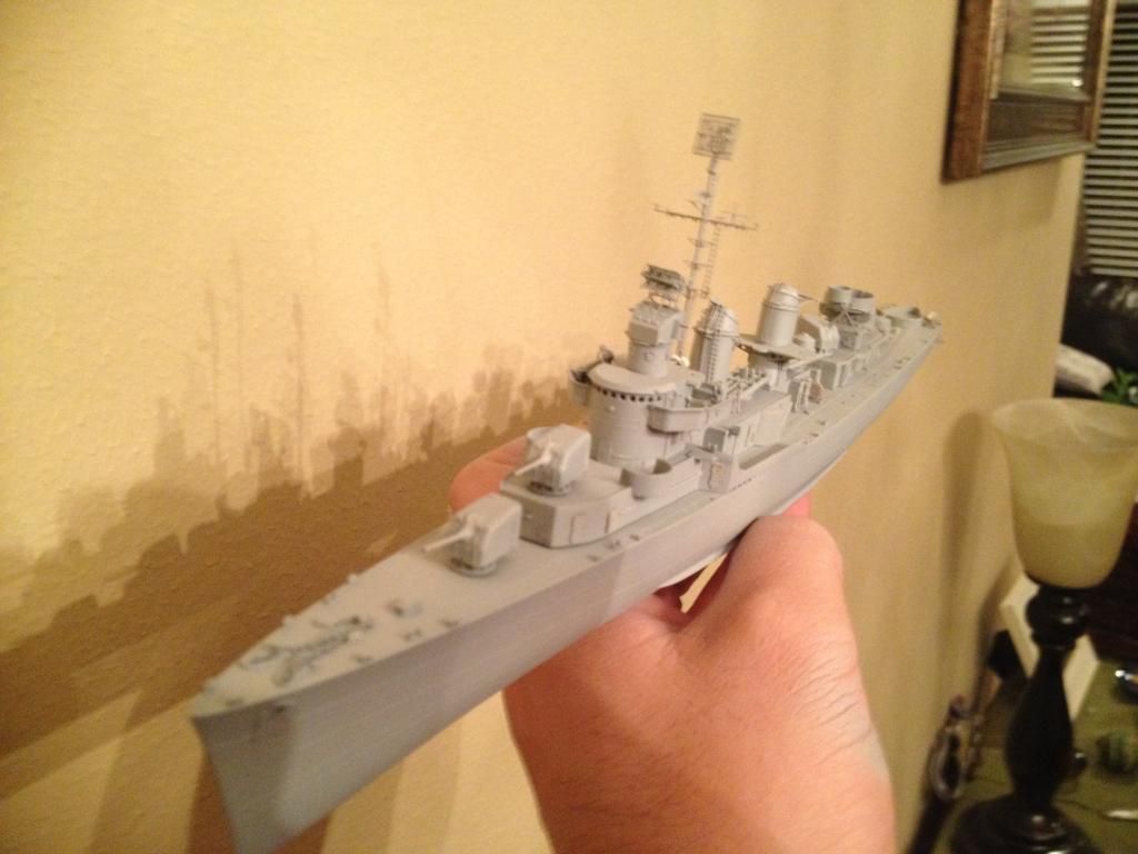

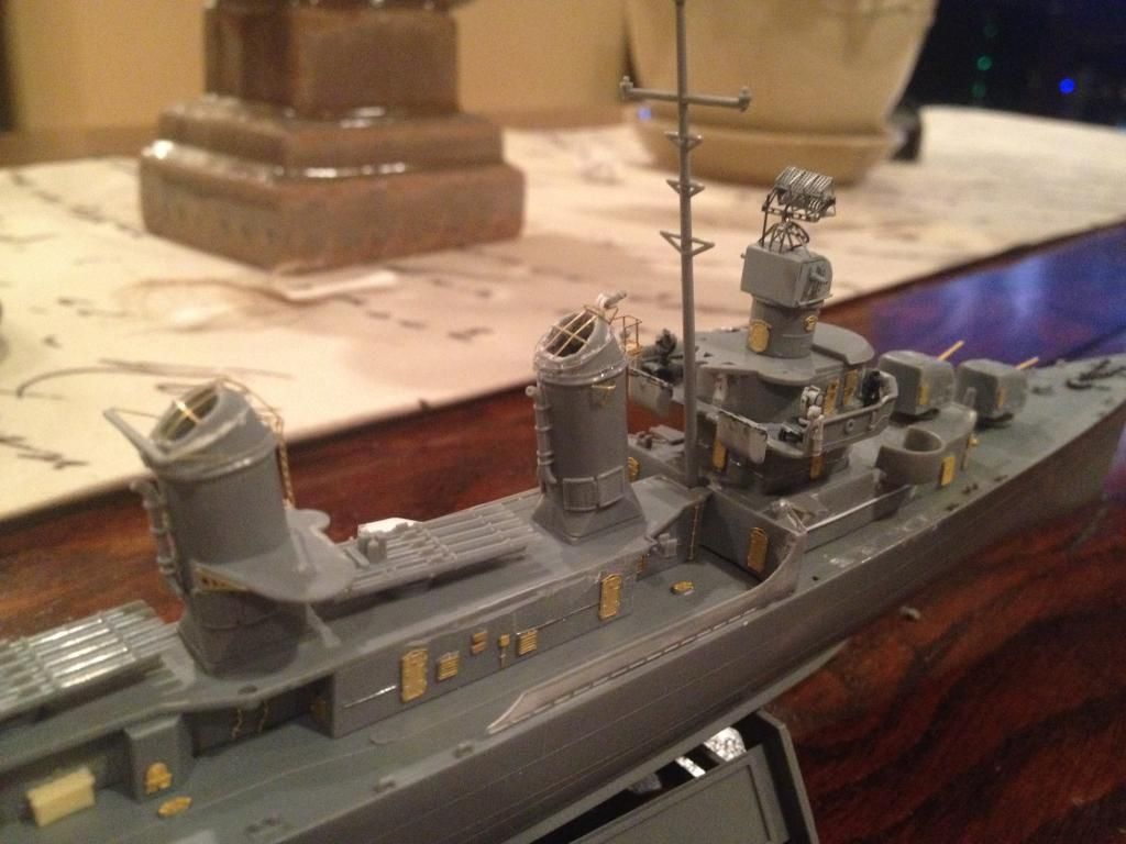

Port view. I attempted to use some styrene rod for handrails at the bow, but the steel surgical cable used aft of it looks SO much better. I'm probably going to shave it off and use the steel. It's a bit more challenging to place, but it looks much more in scale. Note the styrene extension on the midships superstructure. I've seen it on other Fletcher builds and photos, but have no idea what it was for, outside of some sort of shed to protect crew from the elements.

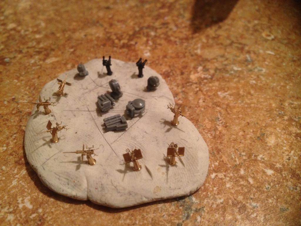

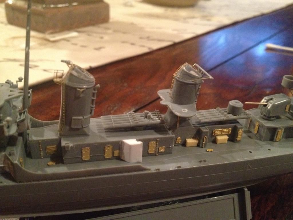

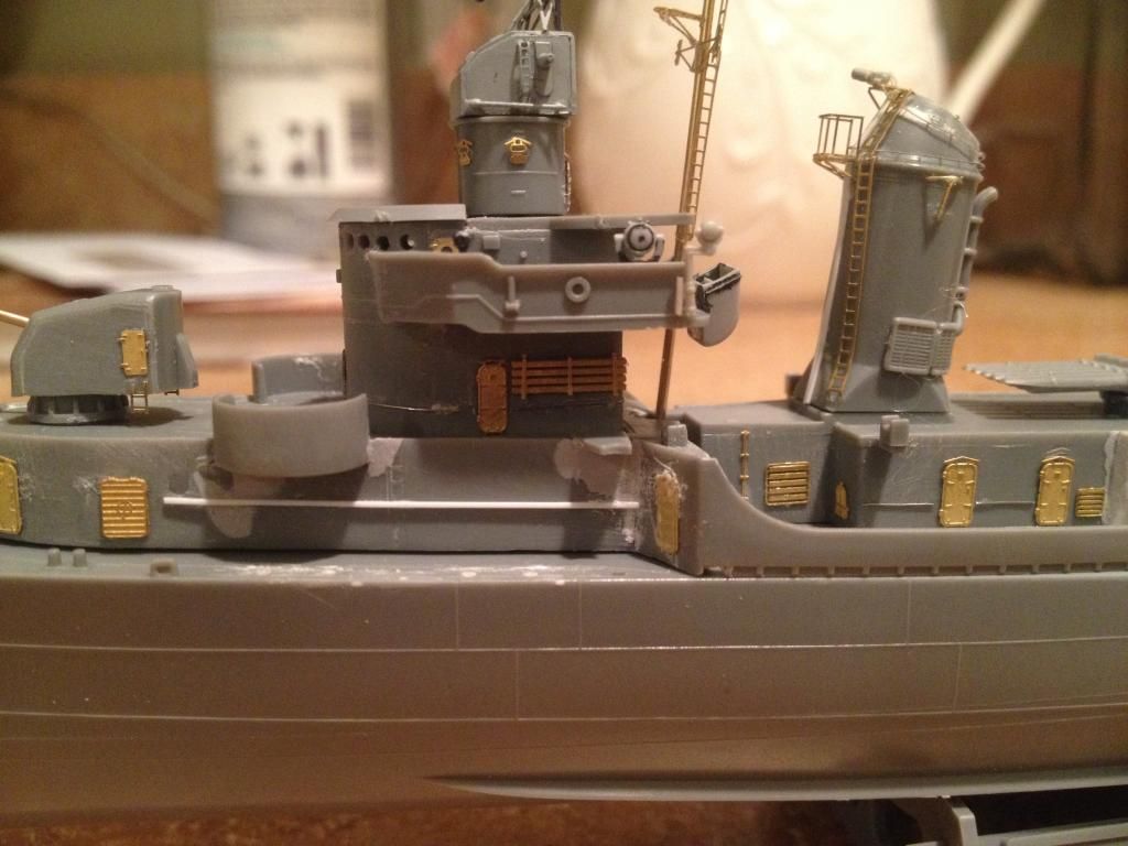

I've finished assembly of almost all the little parts. I plan to make some extra depth charges, which will lay near the starboard rack with crew around them (implying that they're reloading the rack.)
Here's the nasty little clay patty with all the the small pieces on it. Forgive the dog hair.
D28E3841-EA92-40D4-B28B-005CF1C52DD2_zps

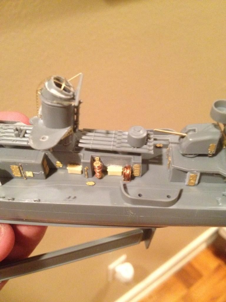

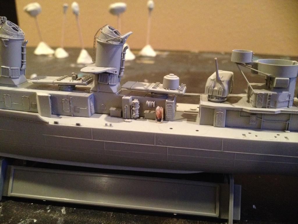

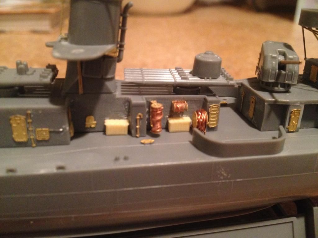

Port side of the forward midships area. I need to do a little more sanding where I think Mr Surfacer is a bit too thick. There's also need to clean up some of the shoddy superglue work and around the hatch leading astern. I also need to fill some gaps in the range finder and carve off extra plastic on the rain gutters. I hate how they look right now. This area is the one area that'll need some TLC before paint (and seeing this is why I like taking photographs.)
92B98189-C696-4842-8E10-D5FFA315067E_zps
I plan to add some more detail to the torpedo launches, though mostly post-paint. I also removed some of the bulkhead PE where the cable reels now rest based on some photographs I found. Blast bags also need to be added via some thickened white glue. There are also little places here and there needing some additional light sanding before priming.
67E8E1F5-553E-43A2-BDC6-2A44EE765712_zps

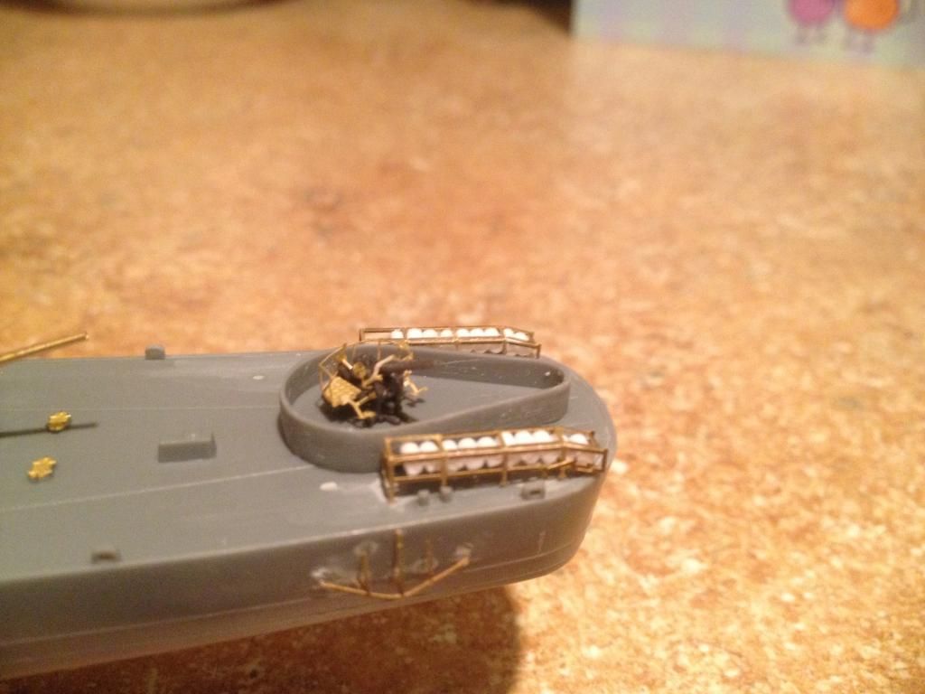

GMM Depth charge racks. I have some VERY detailed AMW versions, but these were easier to assemble and I'm sort of ready to get this thing painted. At any rate, they're still VERY nice. 40mm bofors is the AMW version.
E5B0B801-0721-447E-AD3F-238F46440441_zps
Higher level view of the midships area. I appear to have gotten something on the hull. I'll clean that up before I paint.
EEF7928D-3A85-40E8-A956-B99B43F65C93_zps

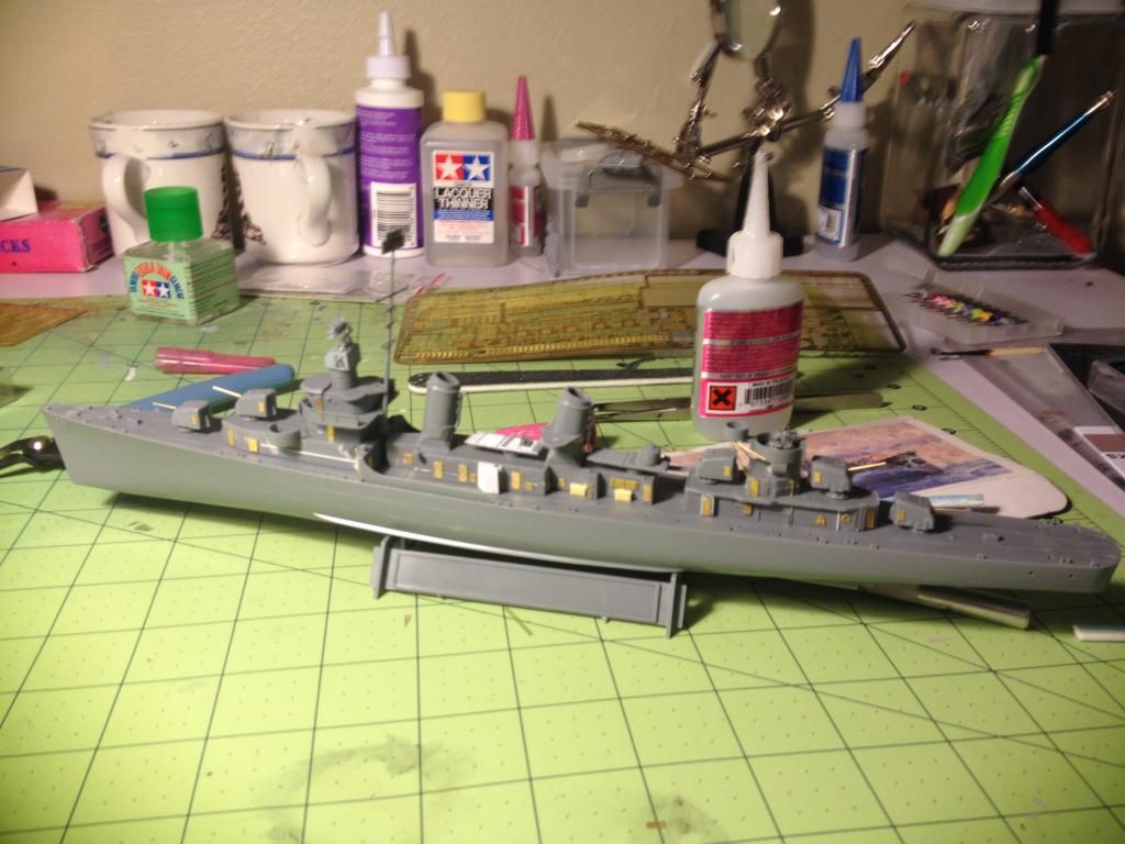

Overall, I'm needing to tighten up some of the fine details and clean up the plastic prior to priming. I try to spent a LOT of time at this stage to eliminate stupid thumb prints, obvious crusts from bad CA glue work, and other imperfections that can sully an otherwise good build at a show. I'm not competing until mid-September, so I have PLENTY of time to complete this ship and MAYBE repair/finish my Combrig Maine.
Guest PetrolGator

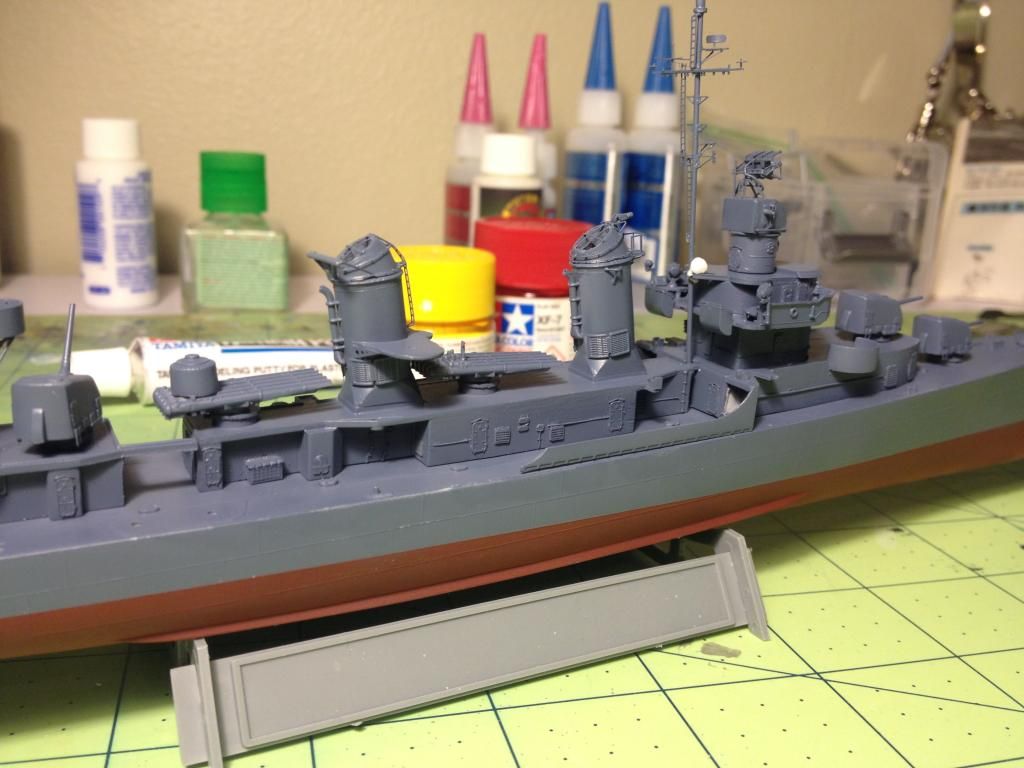

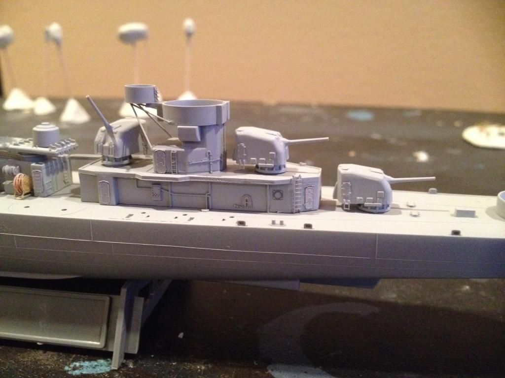

I gave in to some positive criticism of the awardships are, because frankly, Tamiya's kit had a glaring flaw. I really appreciated the feedback. I did manage a first primer layer and noted a few small flaws that'll be easily fixed.
Here's the boat as of now:
B6C4D61A-E36E-493E-B761-6BBEDEF781FF_zps
79C01455-AD06-441F-8210-A46343680DDB_zps
6C80F10A-DE30-455E-98E3-3A4D503DCDB8_zps
B08ADC18-4A90-4046-BF5D-19D935FA886C_zps
There are several deck and bulkhead details (valves, stretchers, etc) that I will add after the main paint is placed. These will be mostly hand painted and/or hand touched up. It's my experience that masking around them tends to cause undue damage. This also includes some scratch details at the auxiliary bridge. I'll add a small compass, wheel, etc.
Any more comments are welcome.

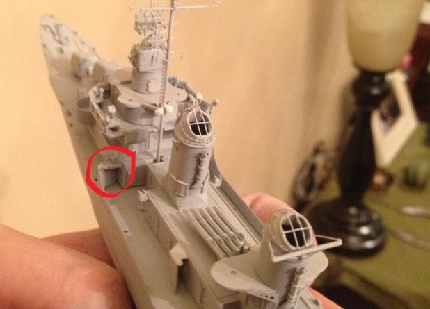

PG, to what glaring flaw do you refer? Inquiring minds want to know.... ;^P
R/ Robert
Guest PetrolGator
Originally, Tamiya had this little bit enclosed. I cut away the superstructure as you see here.
Thanks, Chris - that was fast! What is that thing, anyway? Is it an armored cover for a hatch?
R/ Robert
Guest PetrolGator
In reality, it's rather thin. Fletchers were wet up front and this little structure was meant to help keep her amidships dryer.

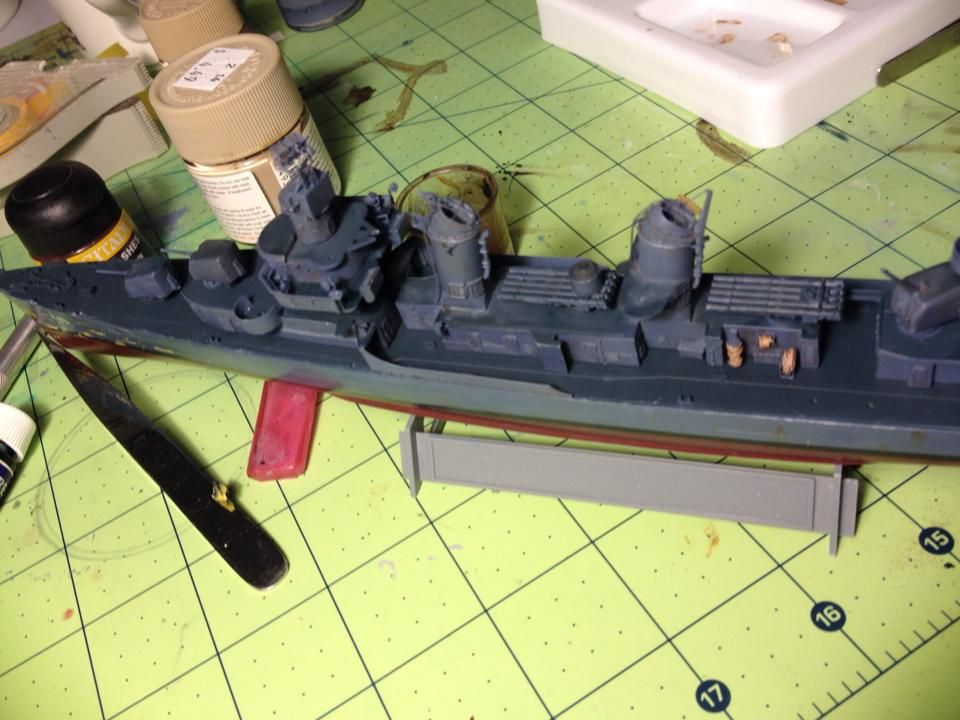

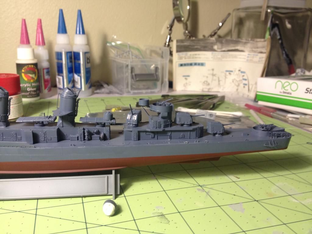

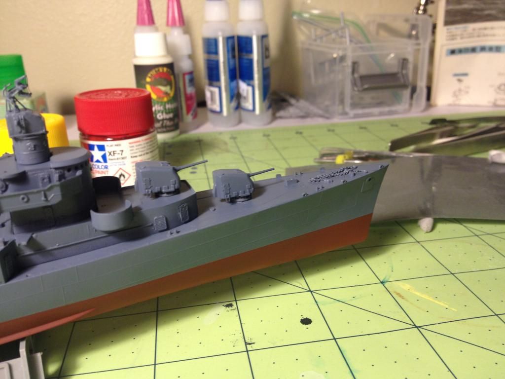

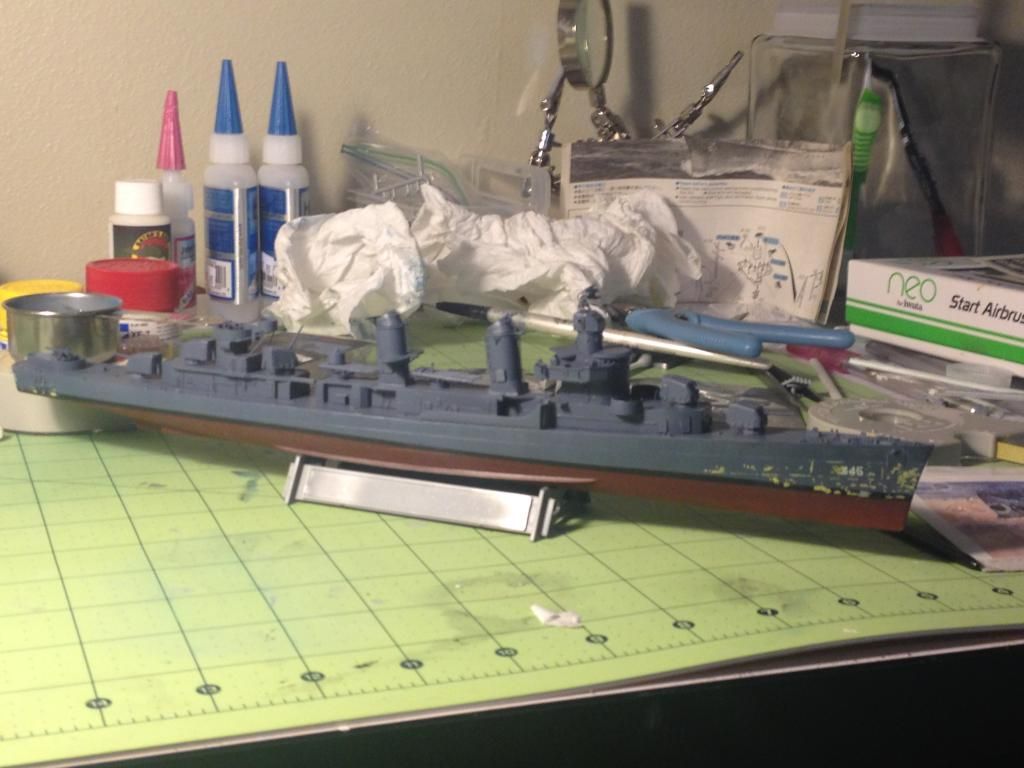

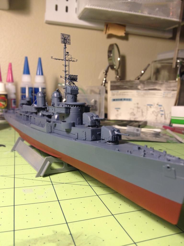

Paint! Yes, she has paints. I had her hull partially painted on Friday but suffered a massive airbrush fail (was lazy about replacing tired parts) and ended up having the scrap the paint, primer, hairspray, and top coat. Oh well.
Queue second attempt and I'm pretty happy so far. Fletcher saw heavy action in the Solomons and I wanted her to show the toll of time and abuse on her hull. I matched yellow-whiteish primer from photos and NOVA's excellent build as a base.
I'm using Master Model 5-N and will be using the remaining stores of my 20-B from Poly Scale (RIP) to paint the hull. Her antifouling paint is a mix of flat red and the Tamiya "hull red" to bring it more in line with the USN shade. Hairspray is being used to chip areas where the 5-N would be exposed to heavy wave action and splashing. I'm fading the paint with some oil mixes I made and will use oils to add rust to appreciable levels on her hull. Superstructure will be largely clean with some fading and yellow-white paint patches as per some color photographs of USN destroyers that are touched up in the field.
Clean destroyer!
918B1168-C930-408A-B72E-ECF9F19A80F4_zps
7A8592E6-217B-461E-B4CB-EFE0D08C7AFC_zps
F66F6DCE-0800-42F6-9AB4-109EDE756D6B_zps
94DE14FC-F5E6-491D-B40C-E2020523CD51_zps

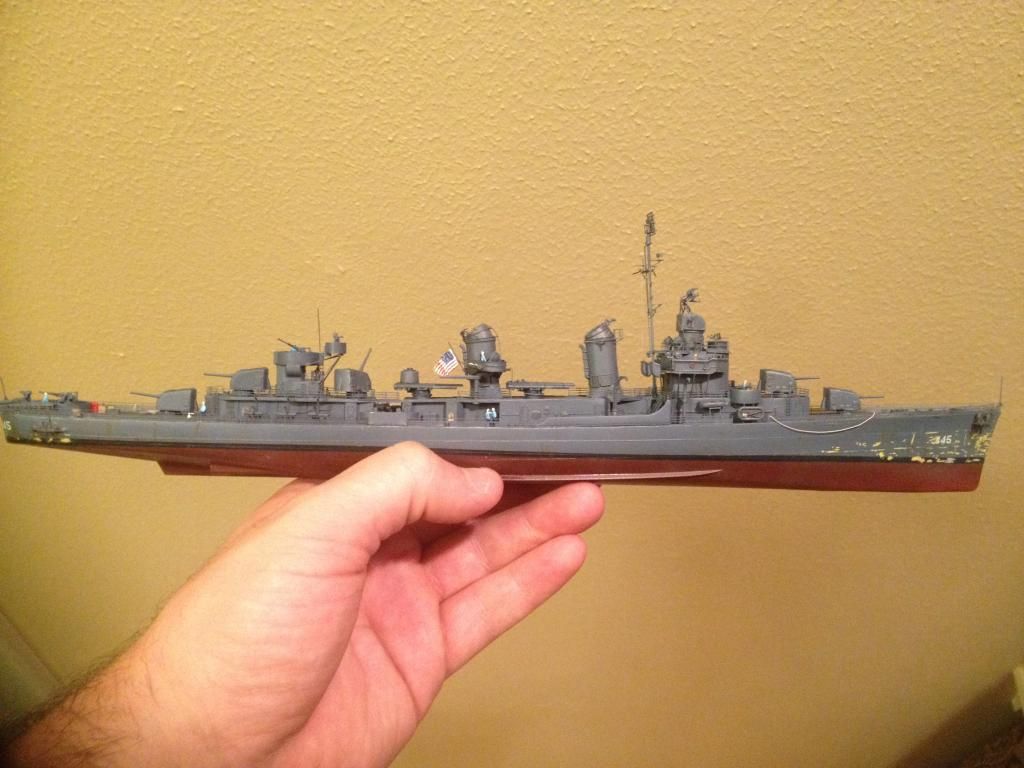

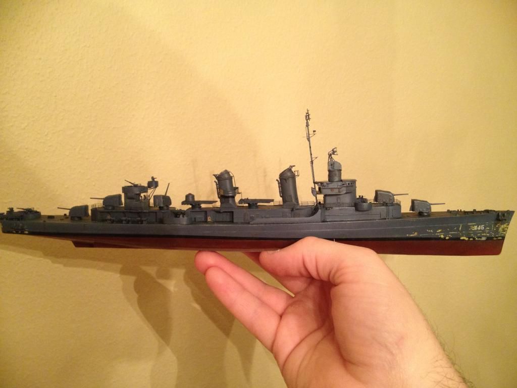

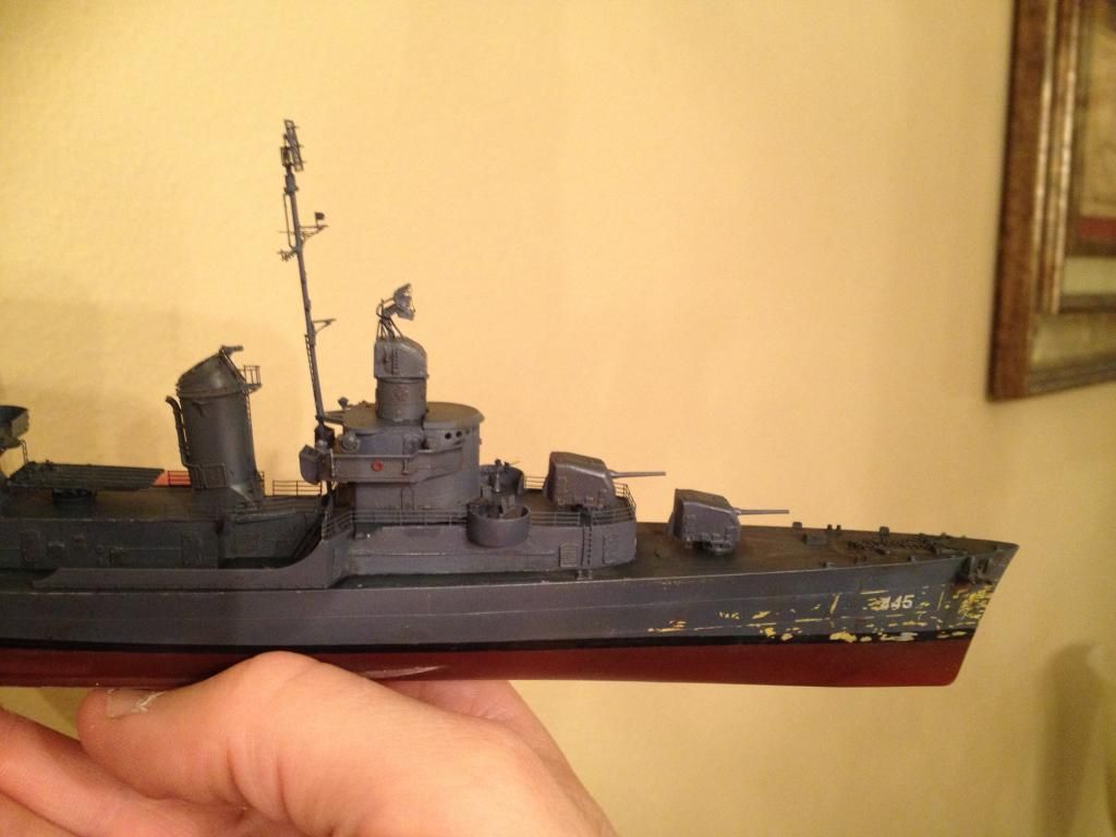

...not so clean destroyer. Note the effects of the faded paint and chipping. I made "chip" along her side a bit with a damaged brush We'll see.
D10E3B13-C2CC-495F-9515-9E7F7C2A7278_zps

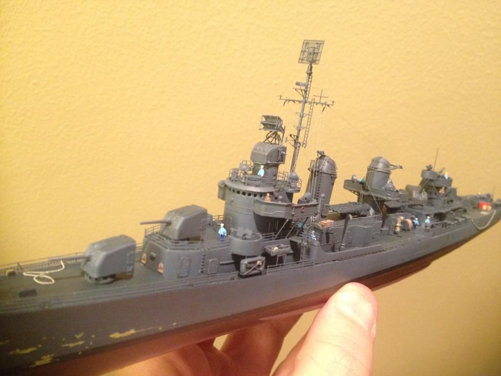

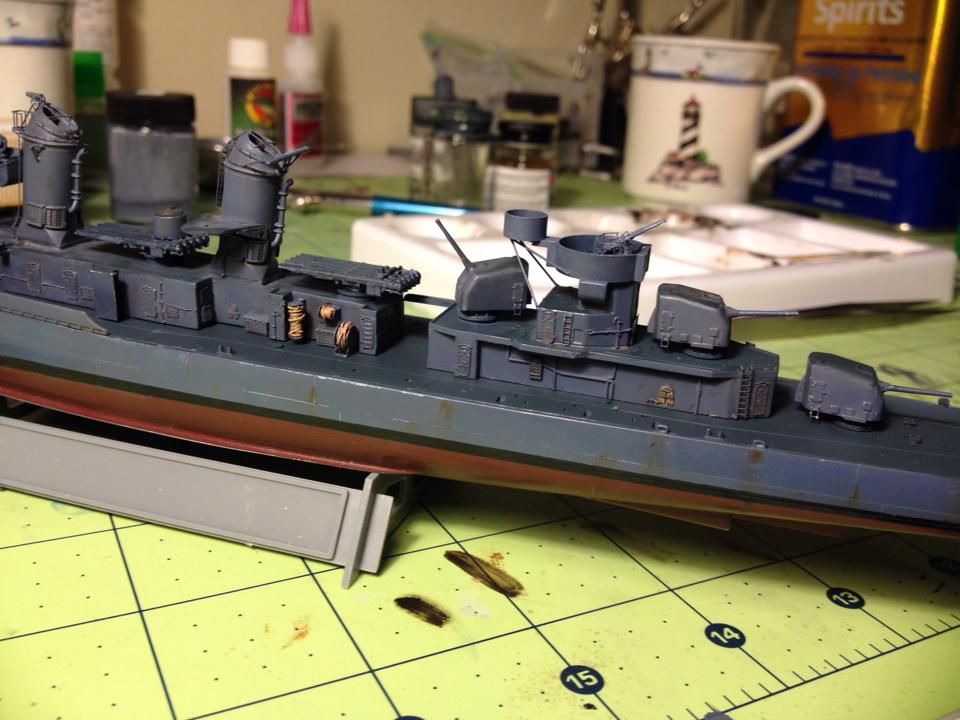

I did some oil weathering to help beat the heck out of a ship that saw near constant action around the Solomons. Early in the war, the USN didn't have a lot of time to pretty up the fleet. Her main deck hasn't been weathered. There's still a lot of construction left that I want to do before adding any salt stains/fading to her hull. I might tone down some of the oil on the upper platforms, though. I'd be happy with opinions.
1908027_10105478982387191_71850810202241
10501861_10105478982157651_3361764629702
10420031_10105478981818331_8901132232896
It's funny. Fletcher nearly looks done but I'm FAR from the finish line.

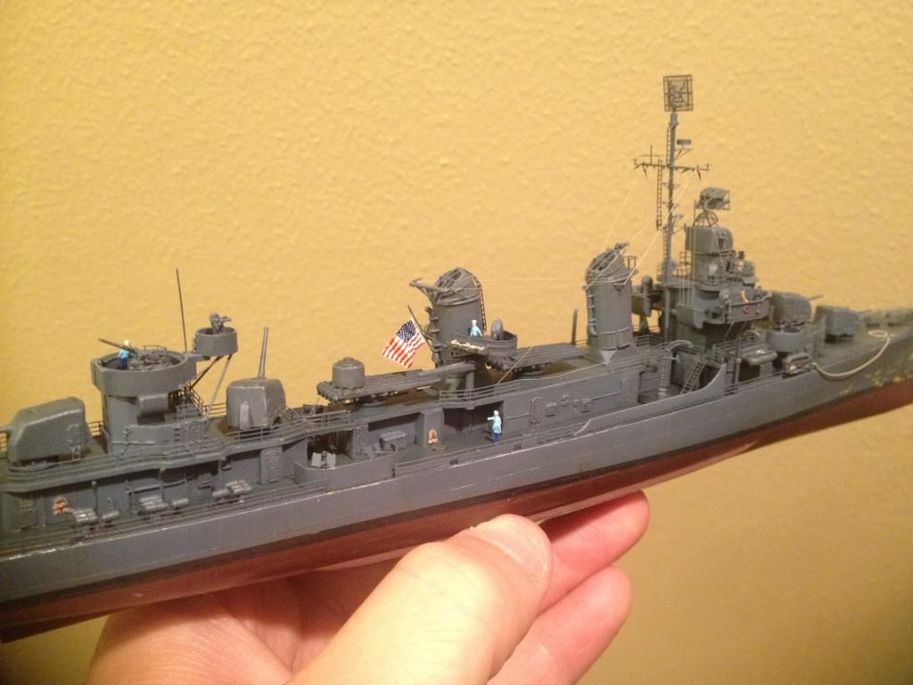

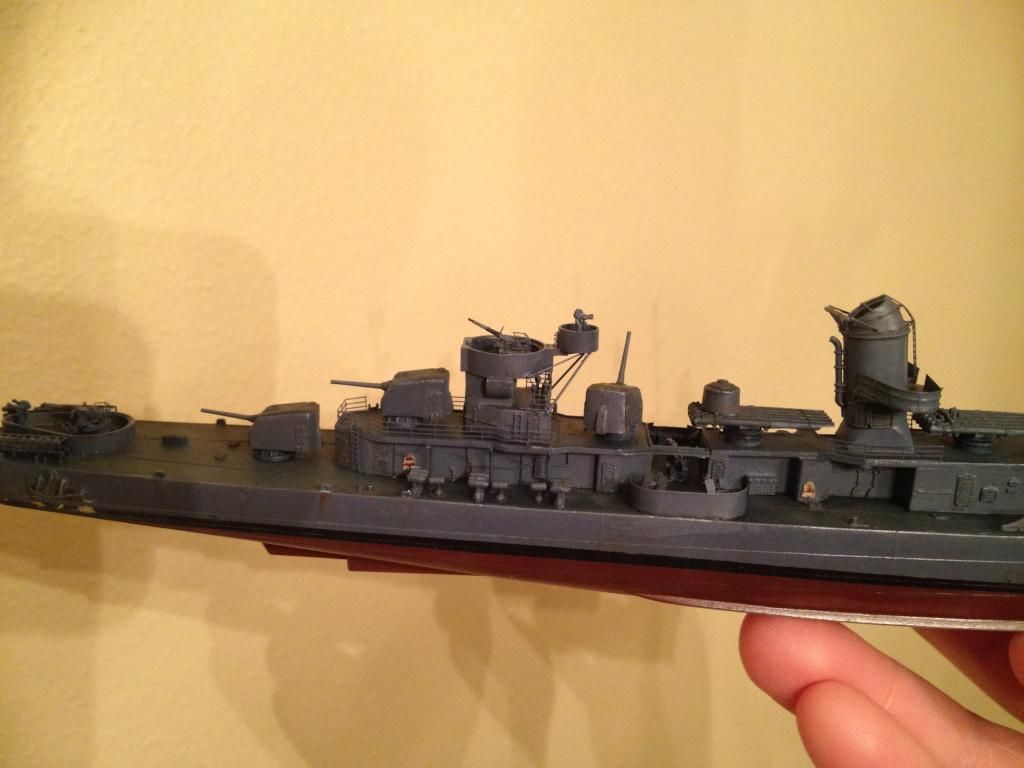

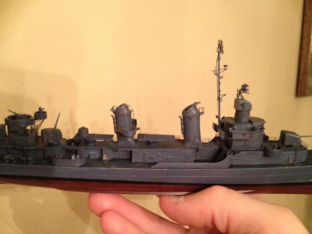

Modeling time has been short, but I am making progress on the ship. I'm hoping to have all superstructure railing and detail done tonight. Ideally, I'll have the ship crewed out and rigged this weekend and may even start her water base. There are still some spots on the hull I need to work on, weathering and consistency wise. I DID lighten/stain some panels on her hull unevenly to give the illusion that she's received touch ups on particularly bad paint during her service in the Solomons. One may say that I am building her at the conclusion of that campaign shortly before heading stateside for an overhaul. I've always love a grizzled look for a destroyer.
62BE6B3F-A24D-44D5-96E9-727FDAFD97D2_zps
Bow. Lots of work to do here. I have a ton of PE to add to the bridge area as well as searchlights (which I may do a bit of detail work on.) I also still have the top 20mm gun to install above her navigation bridge. Several plastic details were either scratched or taken from a DML kit that I use for scrap.
2573CC41-37A4-46FE-A22C-311952944DDC_zps
Annoyingly blurry midships. I'm VERY happy with the way the funnels, mast, and tubes came out. The torpedoes are scrap from DML kits that I did not use and are FAR better than the old Tamiya offering. I scratched the whistle on the forward funnel. Guards in front of her 20mm guns amidships are brass strip. Ammunition boxes are all AMW offerings.
DC1DF4E4-E979-4516-B0D6-538E36EEEC83_zps

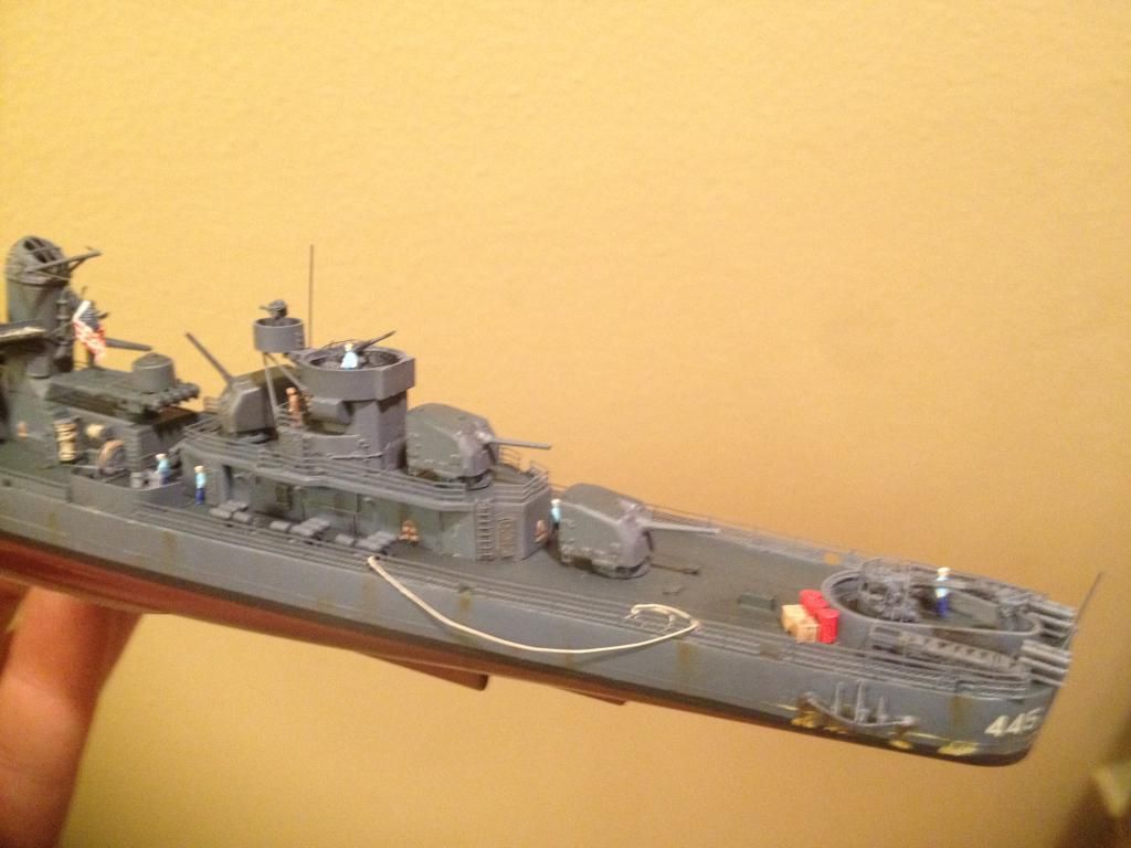

Stern, where I'm most proud/ashamed of this build. Tamiya's auxiliary bridge is devoid of detail, both on the platform itself and on actual navigation equipment. All was scratched according to photos. The K gun launchers are... adequate and incorrect. I found ONE picture of a Fletcher (which is at home) that shows the Benson-type launchers, though it could just be wishful thinking on my part. At any rate, Fletcher never had them and replacement would involve significant damage to the build. I just wish I had spent more time researching this. Bofors are from different manufacturers. One is L'Arsenal and one is AMW. Both have their merits. The gun tub came with the Fletcher kit (not on instructions) but was significantly thinned, wall wise. I also sanded off the bottom of the tub. 40mm gun directors are surplus from DML kits.
Close inspection also shows an annoying smudge I did not previously notice below the gun tub. I'm hoping to mask it with some strategic weathering of the hull. I may even use a LITTLE bit of thinner to try to remove it.
E0A1C748-CD78-4634-9062-F2E862879A98_zps
...and here we have the ship for now. Tonight's plan is, again, continue the railing process and detail out the ship from the inside out.
With my work schedule, I'm HOPING to have it done by next weekend. I have a half finished Bainbridge sitting on the shelf and some new shipyard plans to help me pretty it up.

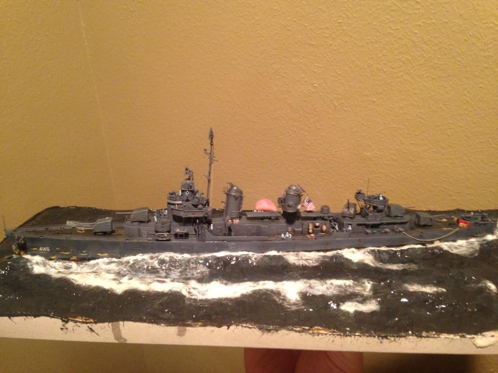

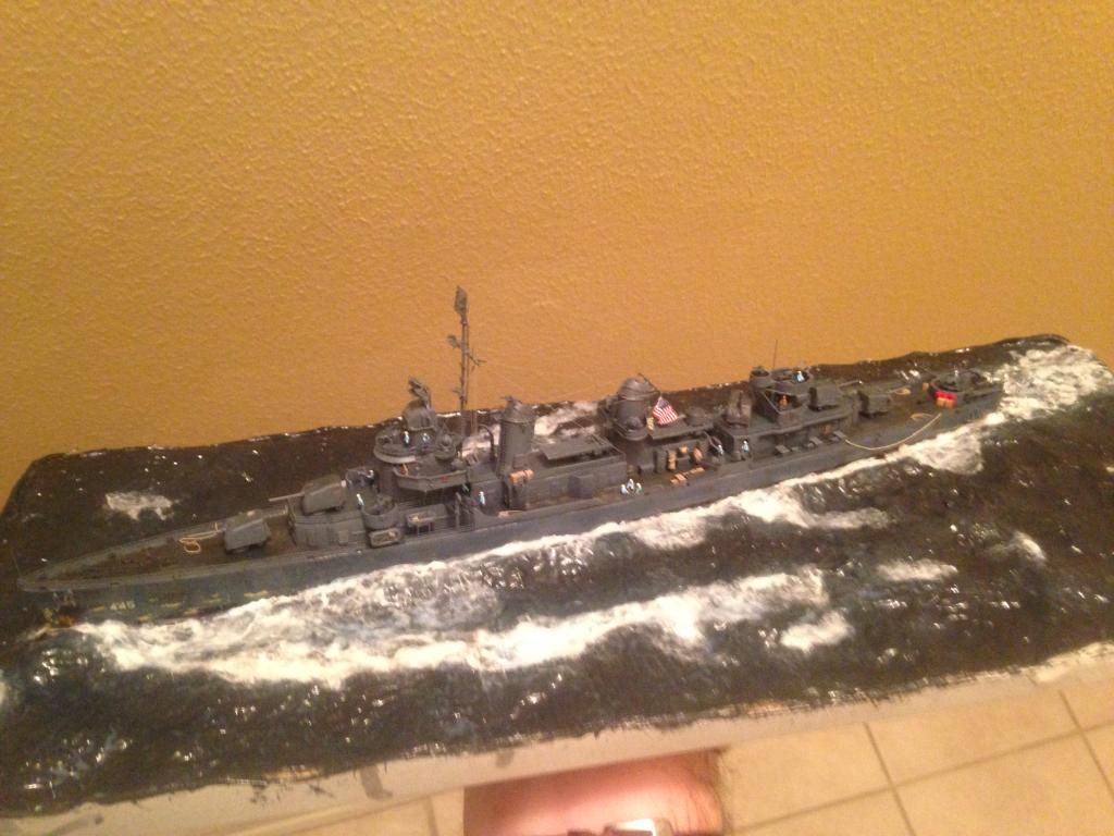

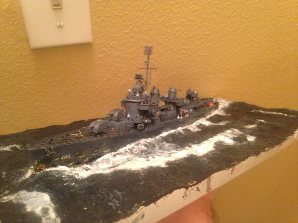

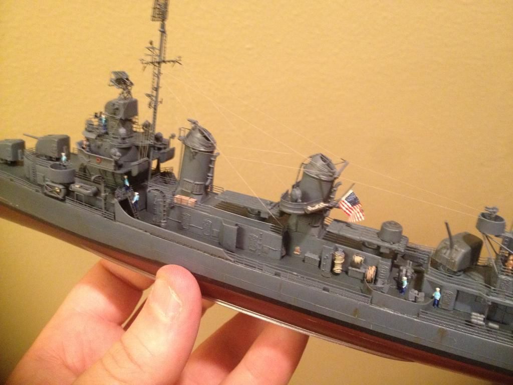

Minus water, this one is about done. I'll add her launches once I finish the waterbase. It has been my experience that fumbling around loosely hanging boats tends to break them loose. :\
7F777DB3-AB01-440F-AAF1-DAE6049B619A_zps
2840CF09-D54E-4A31-95CB-335166714747_zps
CF2C16CF-6A96-46F4-9BB7-1D8D5F83FD0B_zps
7C0501FF-B381-49AF-B72A-7980179F6473_zps
DAAD3466-6D7B-4DD7-9870-99075783E050_zps
958AE3EA-1057-4BBE-AE7C-538346E2F6AA_zps

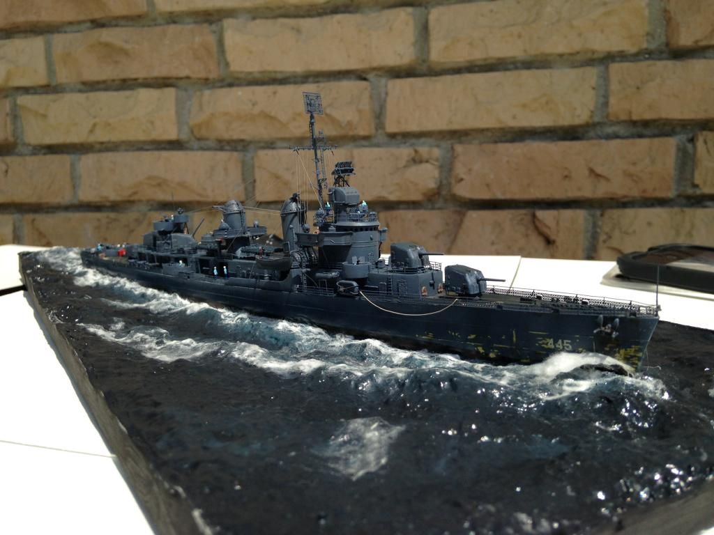

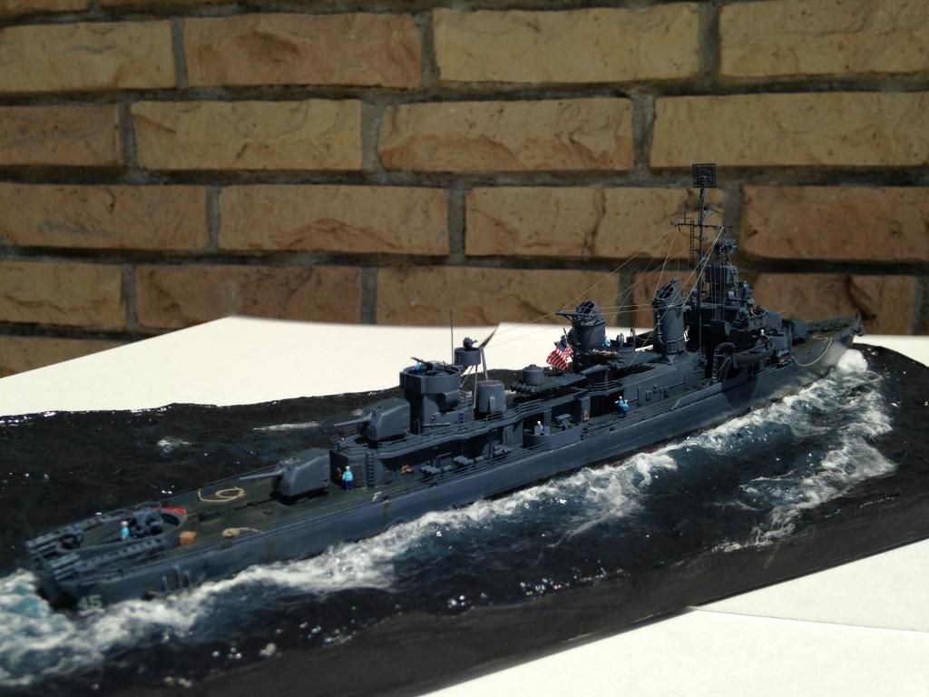

Guest PetrolGator

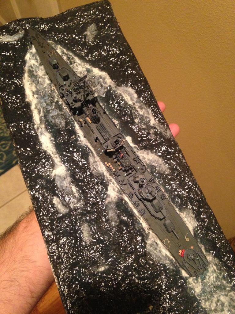

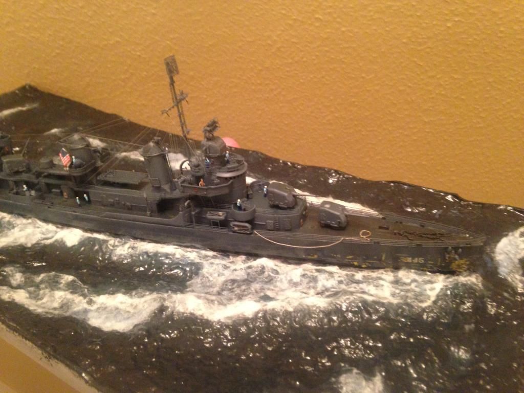

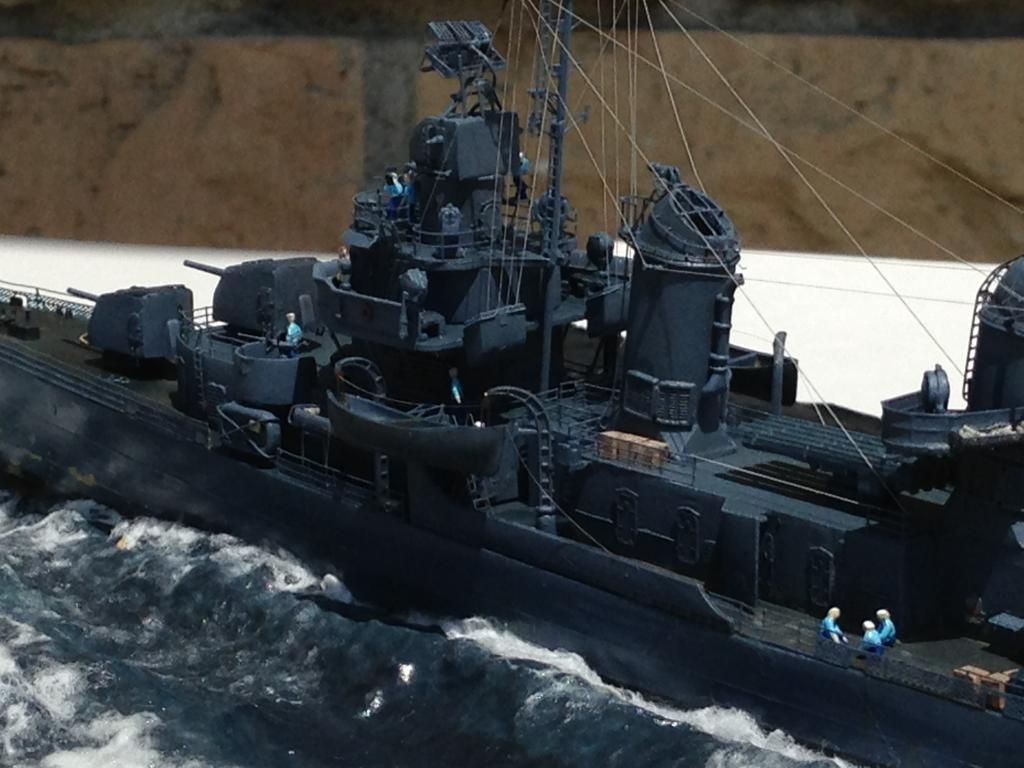

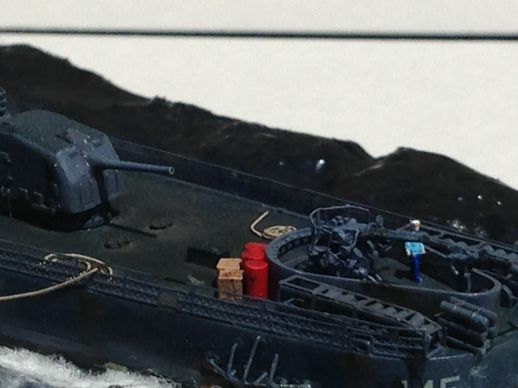

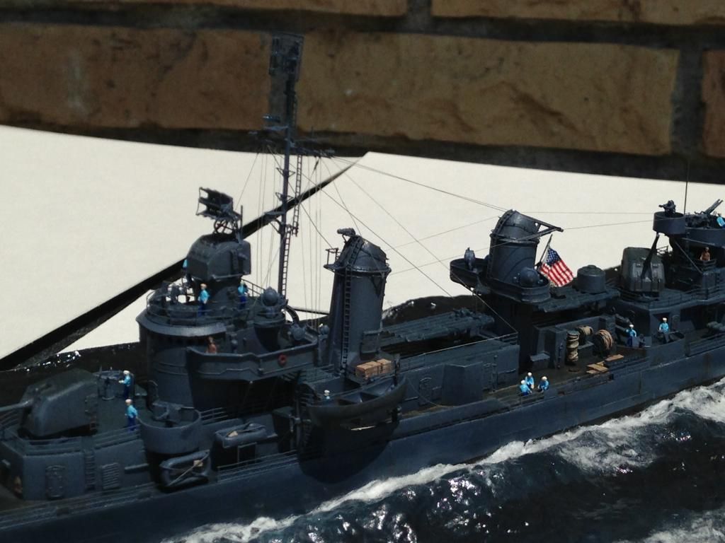

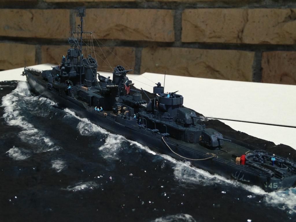

...water has SHINE.
I still need to add her launches and bow wave, among other details.
48210319-1706-4D4C-A113-92BEFF80E4CE_zps
35479C4D-2F91-41AE-B927-B7459A92B7D5_zps
C10BBCF2-E3CF-4B25-A87B-F8D40124E6F2_zps
C0548297-8FCF-45D1-ACCA-68646AA8D48F_zps
B4436DBD-FBCA-4F71-8CD9-6EA17F8B5D7B_zps
FE0103AD-20A5-446D-9594-ABC7EEFB06E4_zps
This is pre-shining but I love the view.
"...doing the railings & PE detail from the inside-out..."
Words of wisdom that I will apply directly to the icebreaker in work.
That DD looks freekin' beautiful in the water. You've really got something there. Shoot that last pic again with a gray, stormy sky behind her!

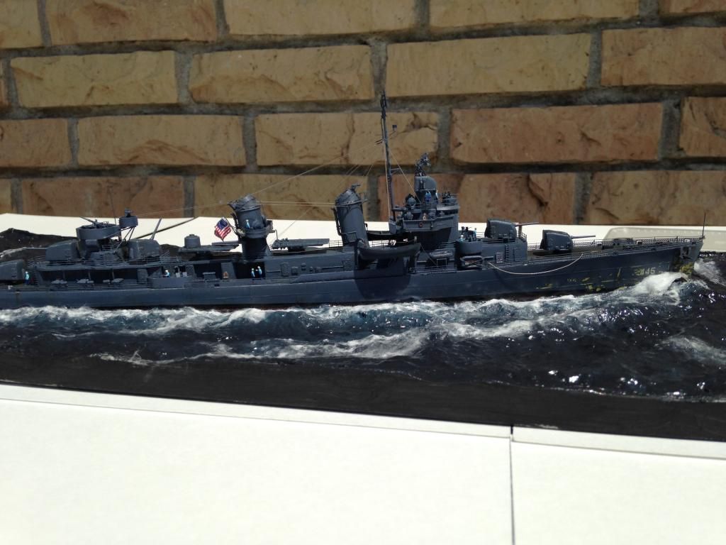

Guest PetrolGator

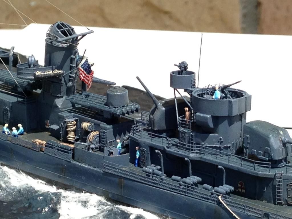

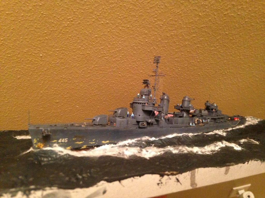

I took these outside with near overhead sun. I may try to get some other photographs later when it cools a bit. Southern Louisiana is under a heat warning and it seems to be affecting the varnish.

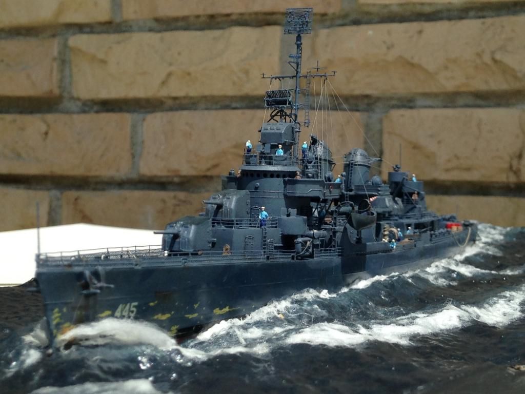

Kit used: Tamiya 1/350 USS Fletcher with some stolen DML bits from a destroyer that has been, effectively, "decommissioned."
Photo etch:
  • Gold Medal Models USS Fletcher (Late and early war)
Alliance Model Works 40mm bofors, hatches, deck details, funnel hand rails, radar, etc.
L'Arsenal 40mm Bofors, figures
Fujimi IJN sailors in working positions
Model Master's awesome 20mm guns (turncoated!)
...and others.

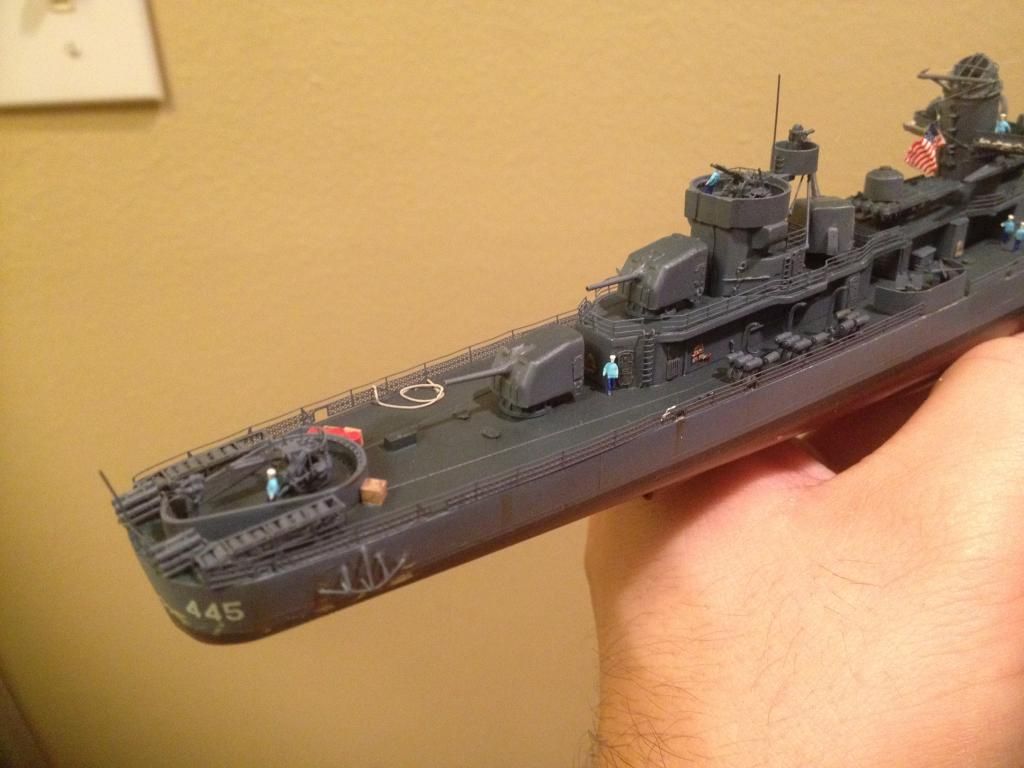

I painted the model using Polyscale (RIP), Master Models acrylics, and some Tamiya paints. Weathering was done via oil and acrylic washes. I added crates, barrels, and hoses using brass and styrene stock and rigged with stretched sprue. The ocean base was made using oat bran and paper towel, heavily soaked in gel medium.
Now, for the pictures:
4C262C78-14FD-48C7-9F40-49CB077463BF_zps
D0AD8ADE-E603-44C6-A376-0CEE288CE32C_zps
A629EF21-C73F-4AB1-A837-FEE0D5FA46AE_zps
B26C5CA5-AFBA-44A3-8BDB-0281DED5C2CA_zps
E54262F1-864A-41AD-92D5-734EB09C0260_zps
EF346D15-91E8-471A-9585-737068B6DE2E_zps
7C09D8E3-1454-42DA-952A-4E224EFA8293_zps
A46A8A25-0CED-477A-A6D9-1C811752B3ED_zps
5B82DF8A-D35B-4A68-ABC9-C52EF1A9324E_zps
WooHoo!!!!! Looks GREAT!!!!
That's really sharp! Still wanna see a b/w or sepia shot of her in front of a stormy sky.
