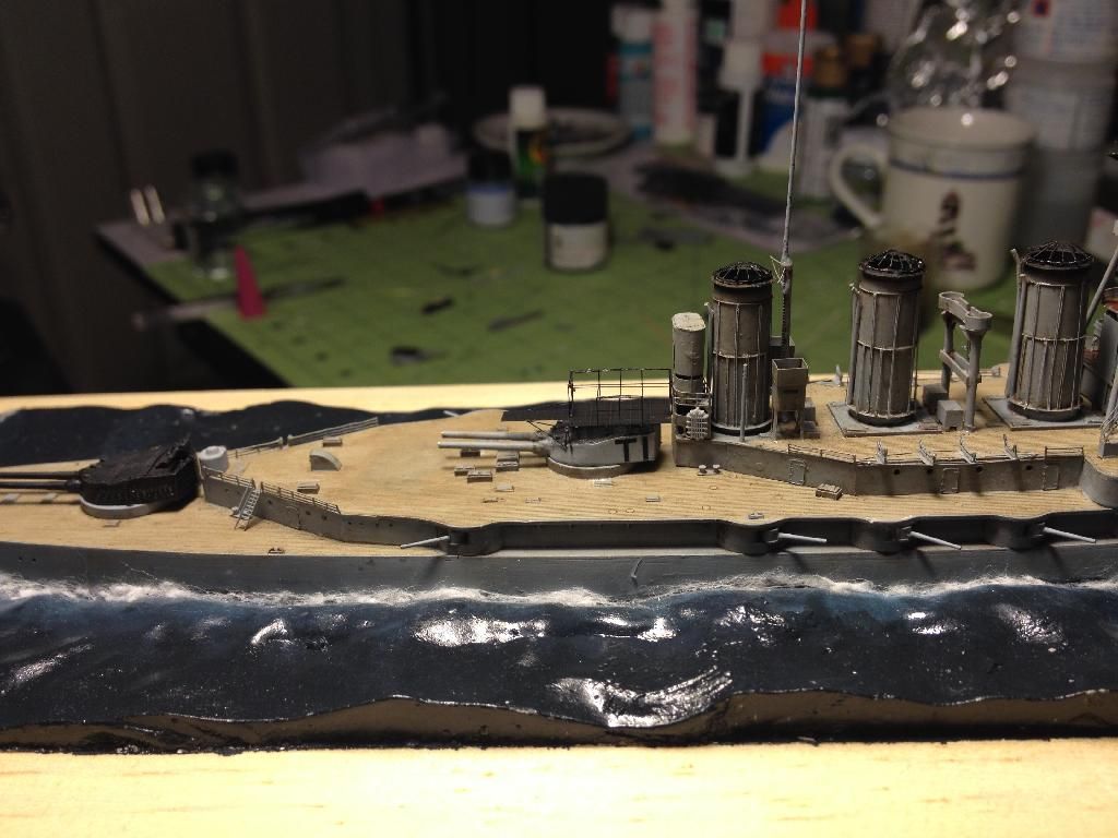

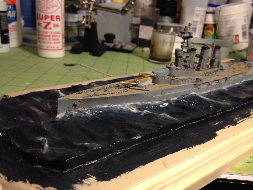

Further water work. I've also added two 3" AA guns near the bridge. These little things were made of up FIVE bits of PE and a resin gun barrel...
I've added teased cotton for what will be under the water. What you see now is a sealed base layer with some needs of touch up due to unseen air bubbles (easy fix at this stage.)
Further work tomorrow will focus on the main turrets and launches.
Keep in mind that I will be adding spray to the model once I've finished the ship itself.

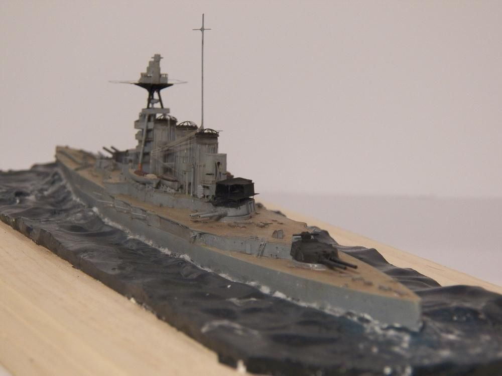

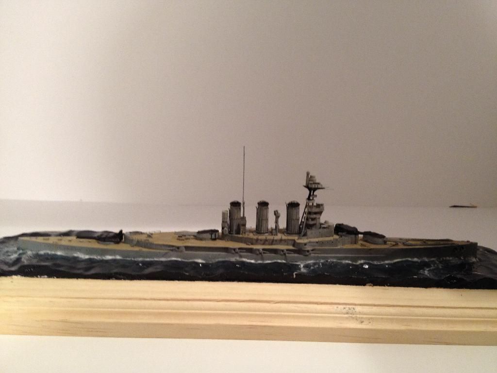

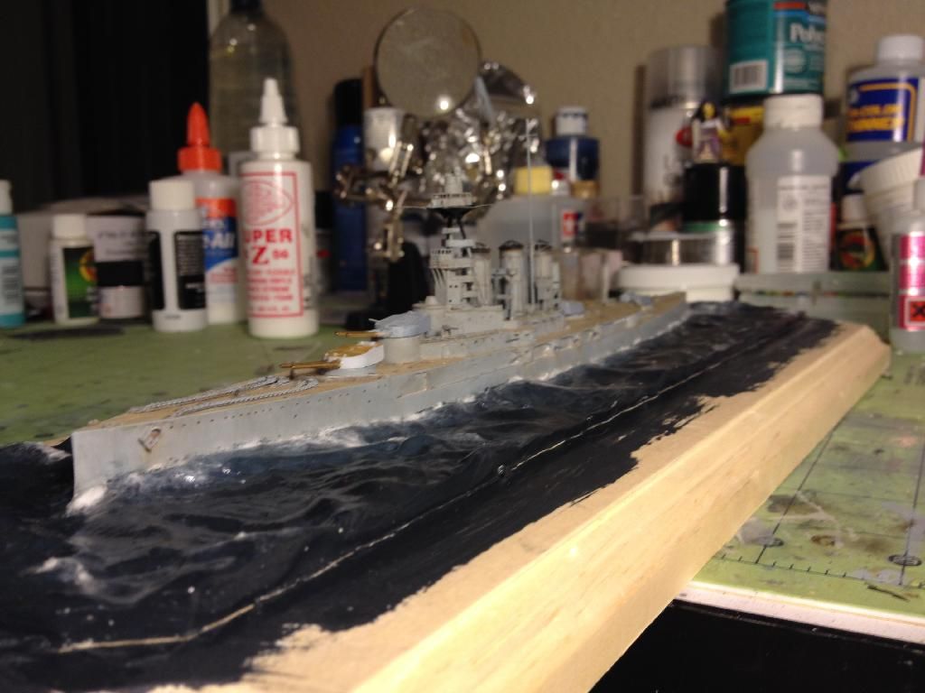

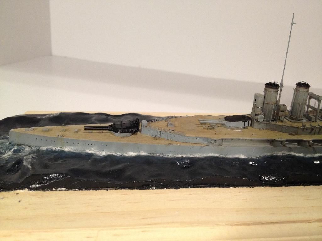

I finally have some reportable progress. I've put a lot of work into the sea base, though the plaster did, sadly, chip in a few areas. That's an easy fix, though. I'll be adding more wave caps to the surrounding sea and spray once I finish the ship herself. I've finished painting the turrets and added decals from masters given to me by the master, Jim Baumann. Jim, thank you again. I couldn't be where I am without these. One of the Northshore club members here made me the decals.
I'm hoping to get her launches fitted tomorrow and I may even throw on the crane booms. Once that's done, I'm hoping to get her crewed, railed, and rigged. I'll then finish the sea base, stain and clean up the base. Final addition will be her ensign, of course. :)
Pictures taken with my iPhone, so forgive the resolution.

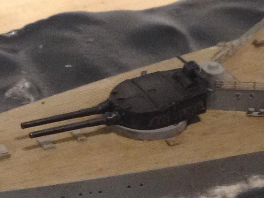

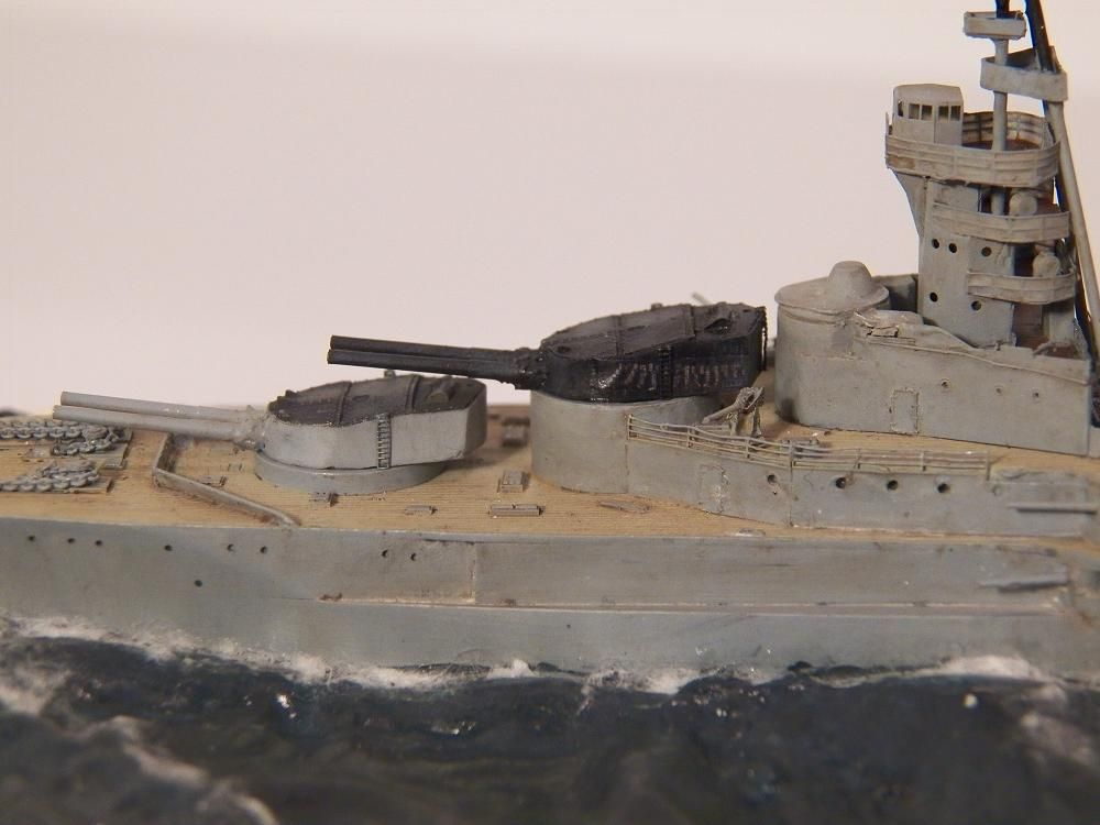

Black turrets ARE really shiny due to a few layers of Future. I had to blend in the damn decals. I still need to dry brush them with a bit of German Grey to help give 'em a little more visual interest. I painted the main turret tops with a flat black, hit them with a wash, then dry brushed with the same German Grey. I'm not sure exactly what color they were, but the affect is a dark grey in person.
Comments welcome.
John, your resourcefulness in finding out the details is making this more and more realistic looking. Way to go!
Chris, that ship is coming along. I like the technique you used to make the turrets look dark grey. Most impressive.

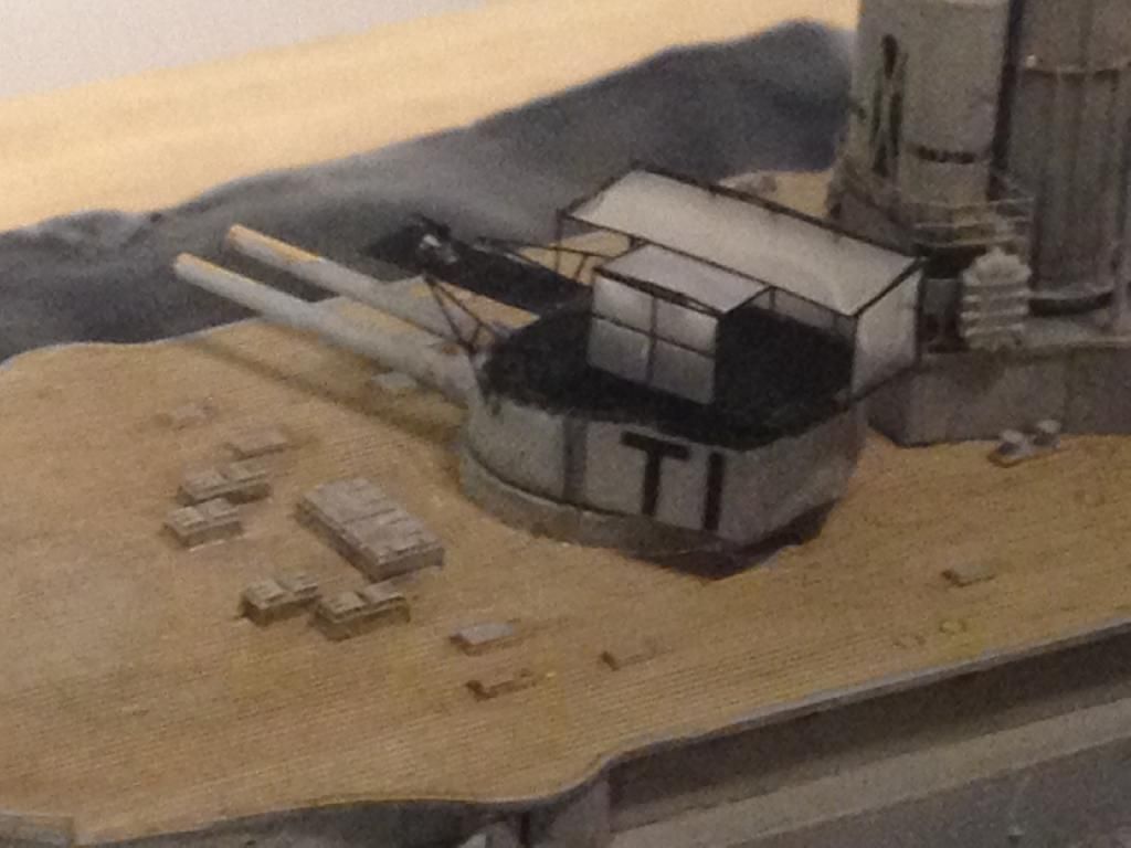

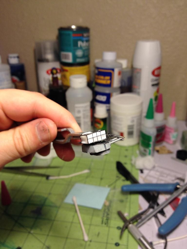

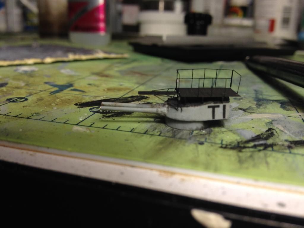

So, I finally finished the PE on the turrets putting me at oh, only a few days behind schedule. Artist Hobby provides a VERY detailed but intense little hanger (?) for Tiger's spotting plane (sadly, not included.) I was struggling with whether or not to cover it in canvas, and ended up choosing well, partial.
521BE3E8-11C9-4853-9C5C-3C803A688FF4_zps
Here's the structure, minus top. The PE base is incredibly detailed and fragile.
EE14EA2A-5EBE-47FD-8DD5-ED7647EEE30E_zps
Turret sitting on the deck. Note that the back of the hanger was position a WEE too close to the aft superstructure. I'll uh, turn her to the side to keep that less obvious.
9F03220E-BA48-46C9-BD01-957BF11292C8_zps
Old trick. Cover the panels in Elmer's and let dry overnight.
8F4F3120-E1DE-4445-928F-7E09A4ACFE5D_zps
Here's the dried hanger canvassing. The panels left open will have Elmer's blotted at the top to simulate rolled canvas. This will be painted with ENAMEL black. Using acrylics will dissolve the glue. Note the brass showing on the barrels. Blame my tweezers. I'll touch it up once the hanger is done.

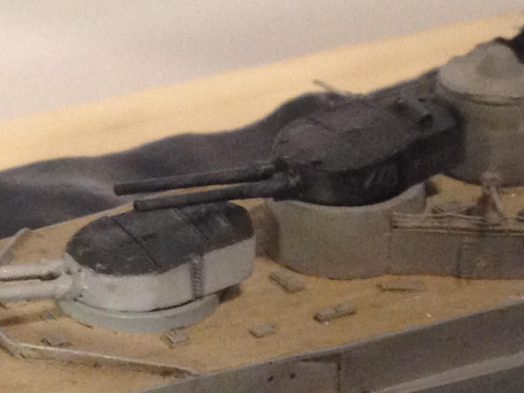

Aft turret. You can see the tick marks on the side.
DEF04299-9279-4097-A371-4EBE530A01D9_zps
Forward turrets, showing PE and weathering. I'll take clearer pictures once she's done.

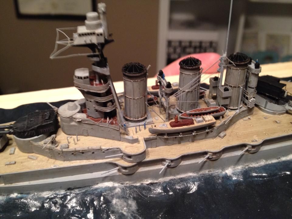

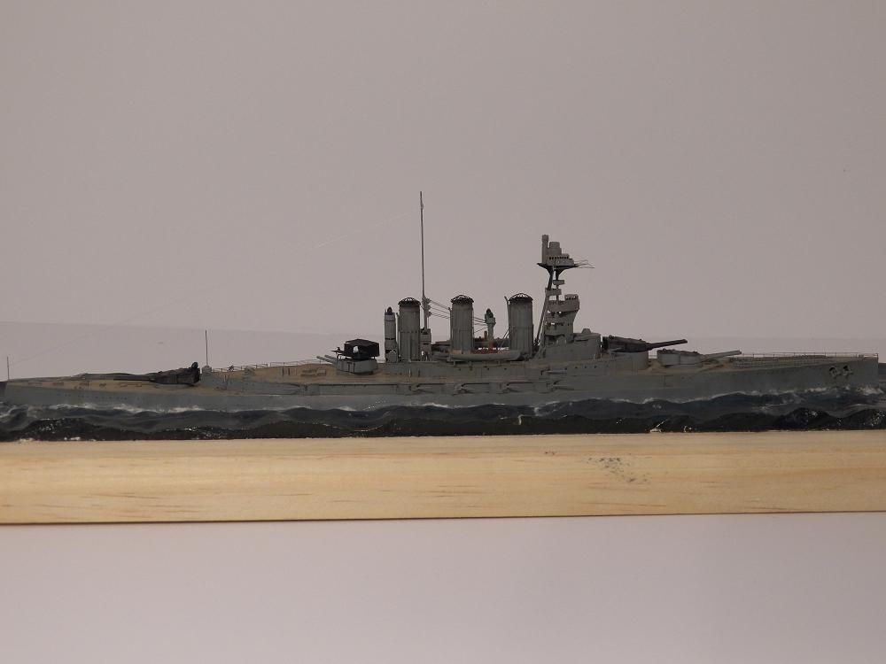

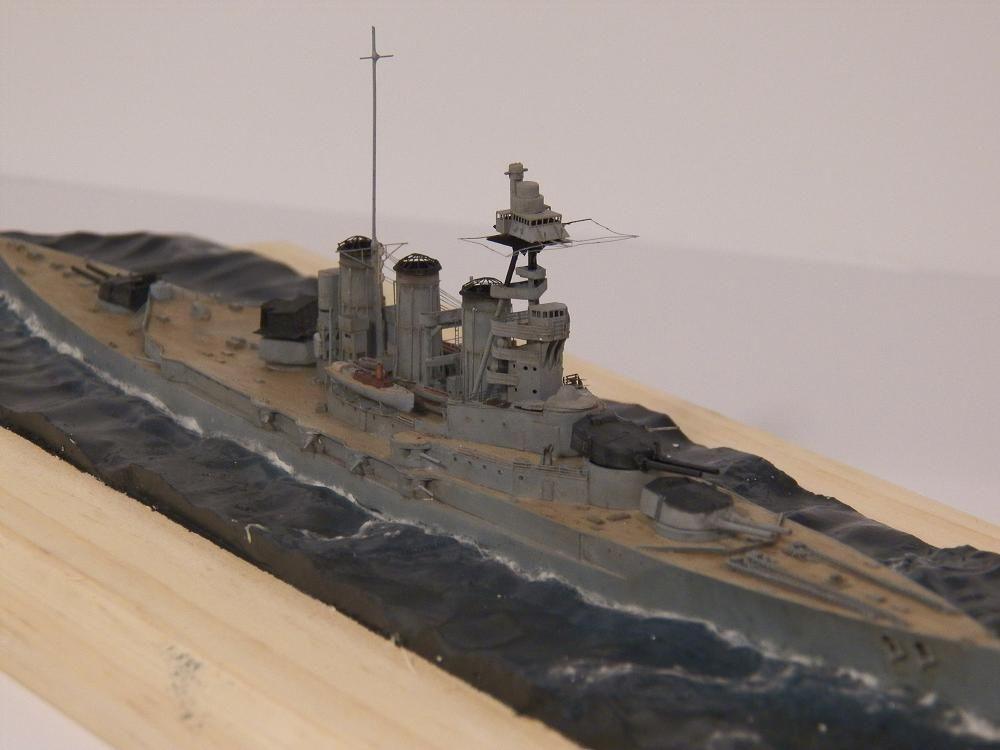

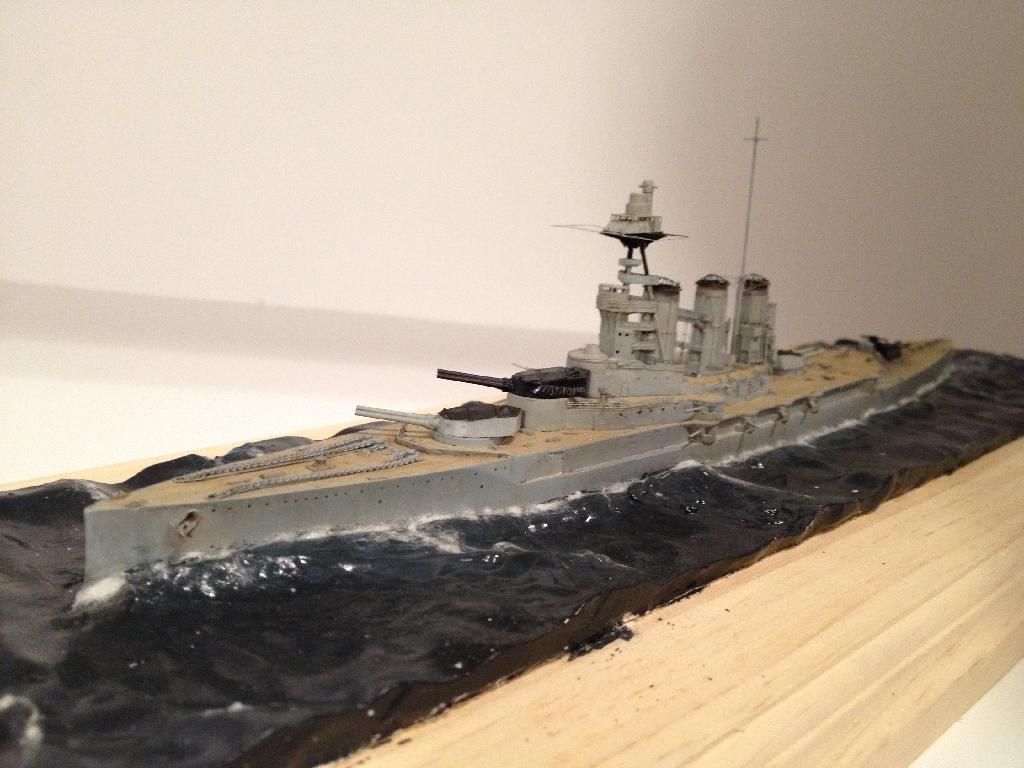

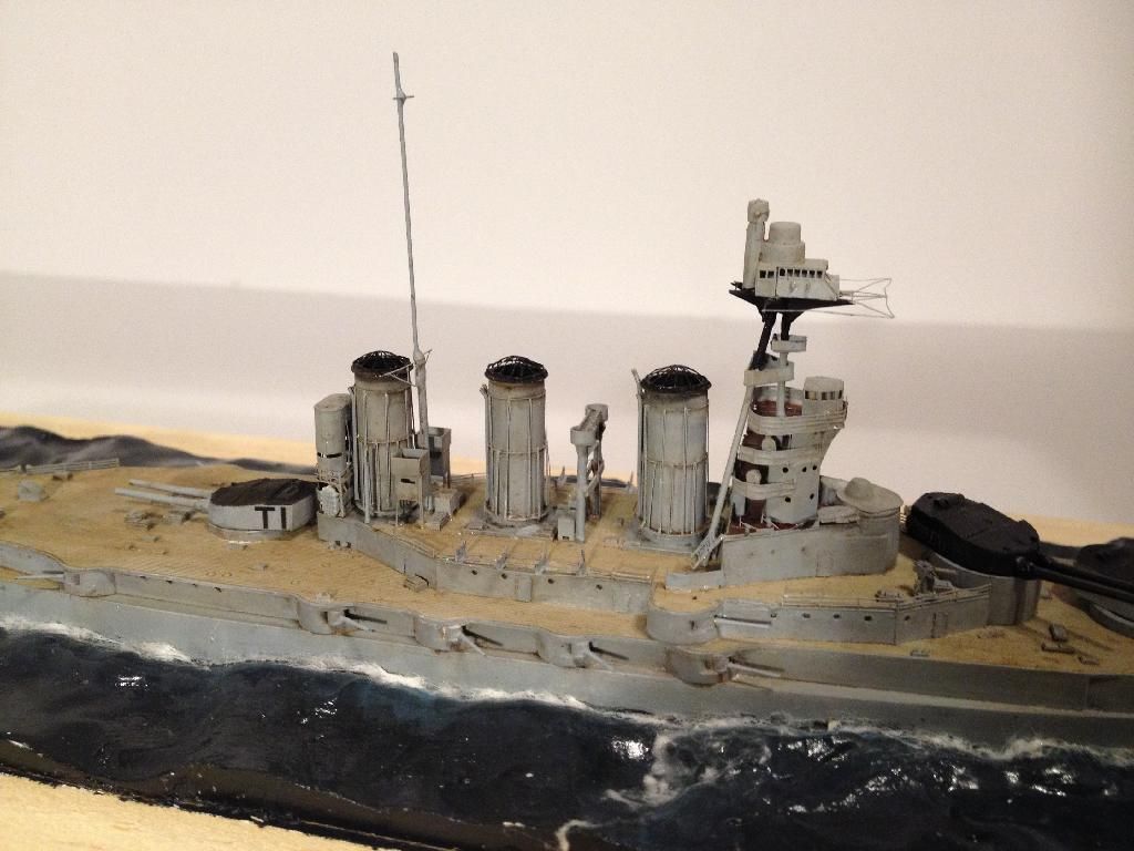

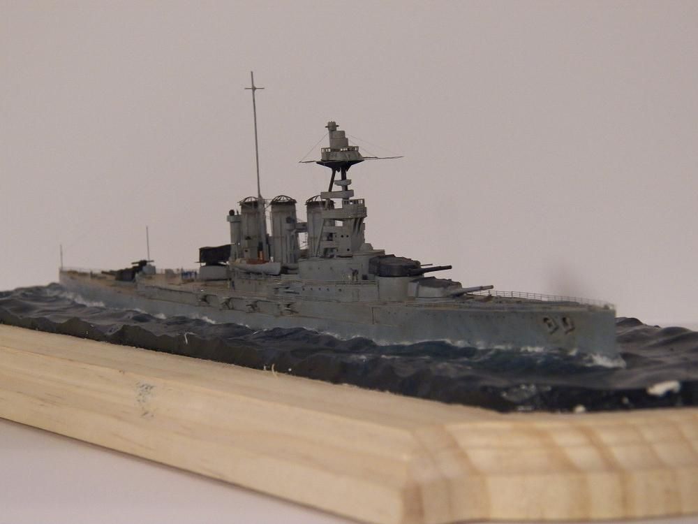

I took some pictures with my nice camera after I painted and installed her launches. There is, obviously, a TON of work to be done....
I left a few of the panels on the "hanger" un-canvassed. I've got little bunches of the raised canvas simulated with painted white glue as well. It's REALLY hard to see.
Forward turrets. No. 2 has the demarcation lines.
Fighting top. I REALLY need to bend all that flimsy PE into shape before rigging. I keep hitting it with my hand.
I love bow views. They always make a battleship look intimidating.
...aaand the ship in profile. I placed the main crane on... just because. It'll need some painting.
Tomorrow, I add the rest of the lifts, cranes, etc! I might even add some rail and crew!!
The end is in sight!!

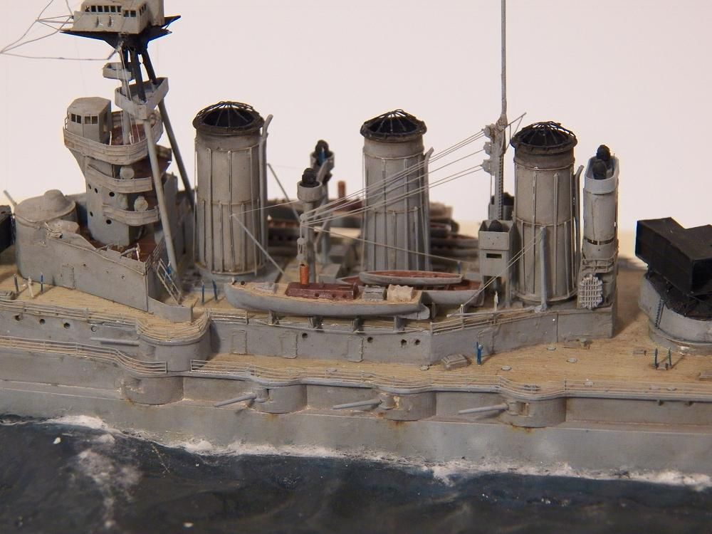

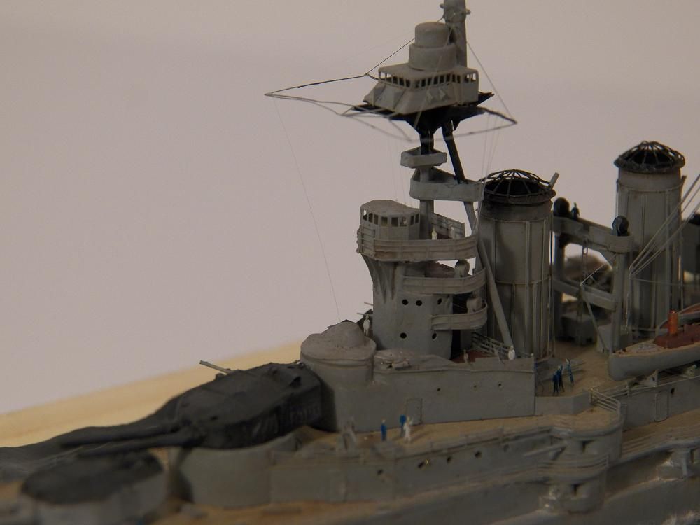

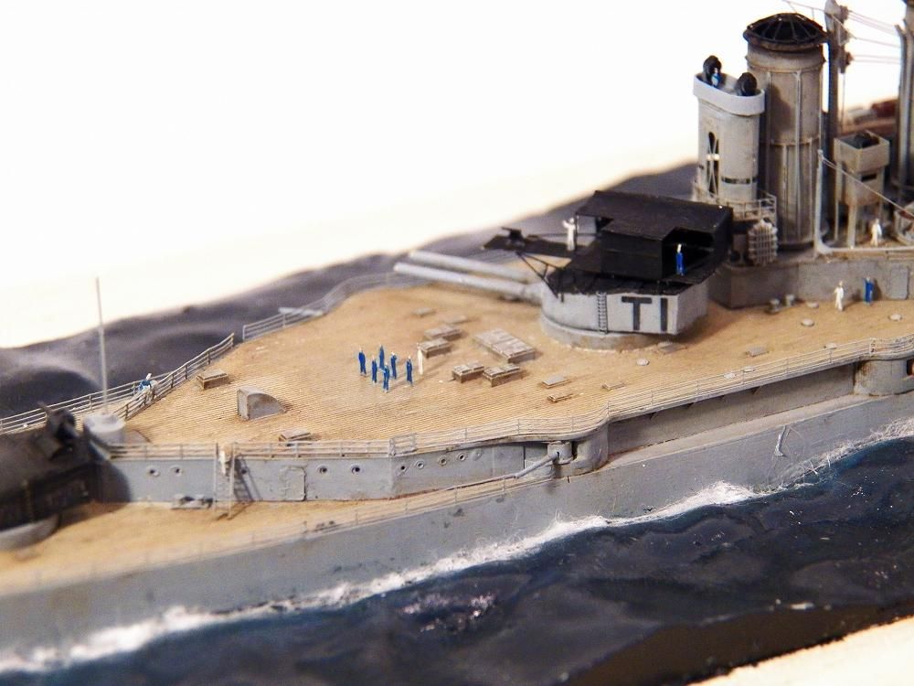

Small update. I've used some brass wire to create crane booms as per photographs I have of the Tiger around this time. I've also started adding Eduard crew members and some small bits here and there. Some of the figures are leaning, on account of unequal glue distribution. I'll occasionally right them while setting, but some just were stubborn. They'll be removed this afternoon and re-placed.
1896892_10104819923301881_1332028203_n_z
I'll be adding additional figures and deck bits today. Ideally, Tiger will get her crane booms fitted with stretched sprue for cable and railing. If I'm REALLY productive, I may even start the general rigging process.

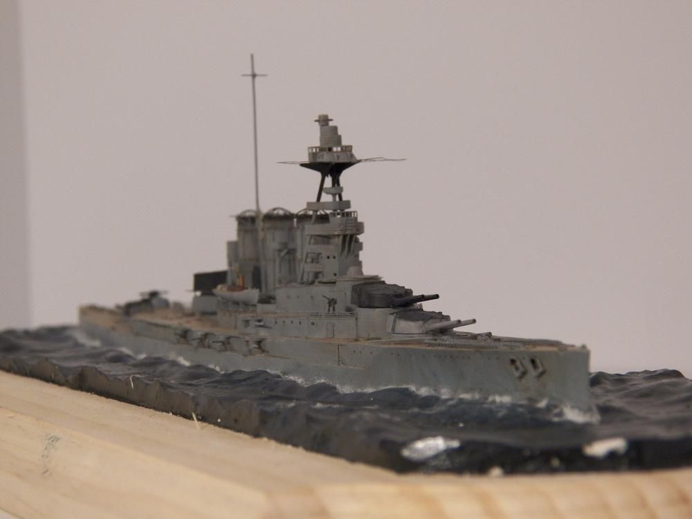

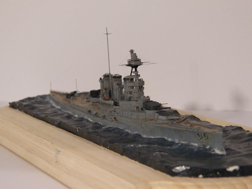

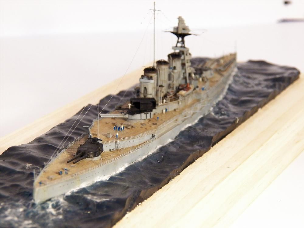

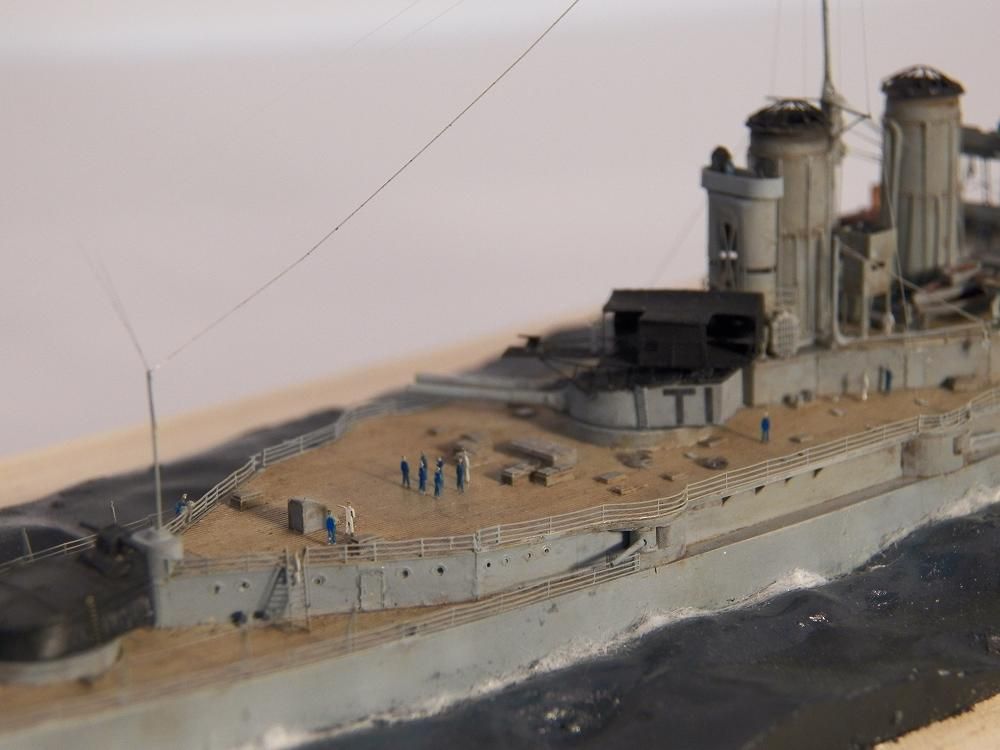

Small though time consuming update. I've been trying to get railing on this thing. Between a brand new puppy and a frustrating PE set, well, it's on. I need to still do some work to unify some railing, but that'll be easy.
Note that I've attached some rigging to the ship. I've trailed a new way to use REALLY fine stretched sprue. It's working, so far.
Crew have been added. All that is left is clean up, rigging, finishing the base, and then the sea. My last act will be to add her colors.
I feel like this model has gone decently. There's a lot of messiness that I'm rather unhappy with. Still, she looks like a masterpiece from a distance... just won't win any shows. :big_grin:

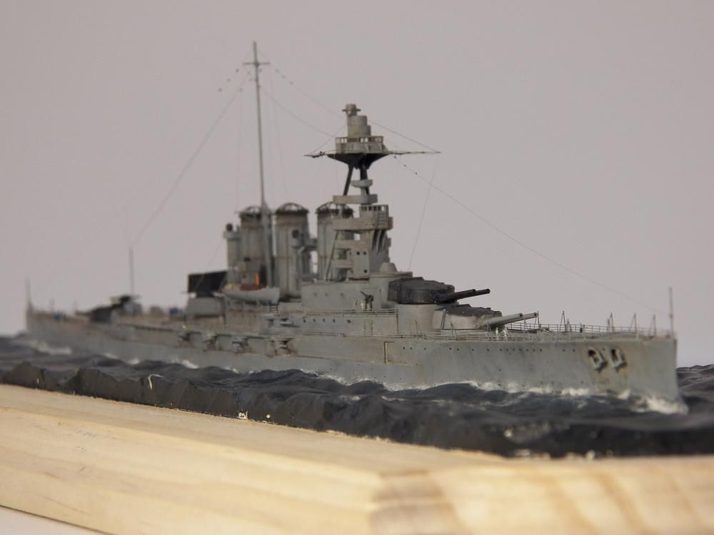

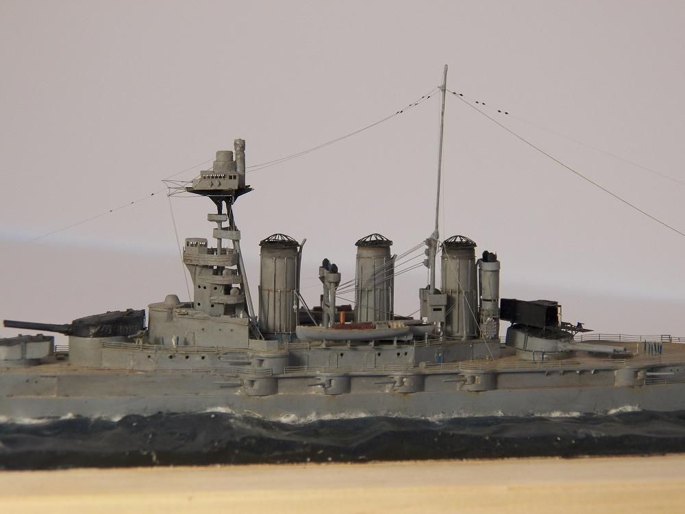

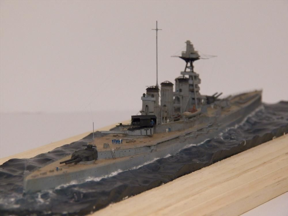

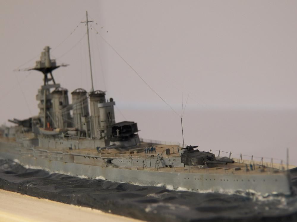

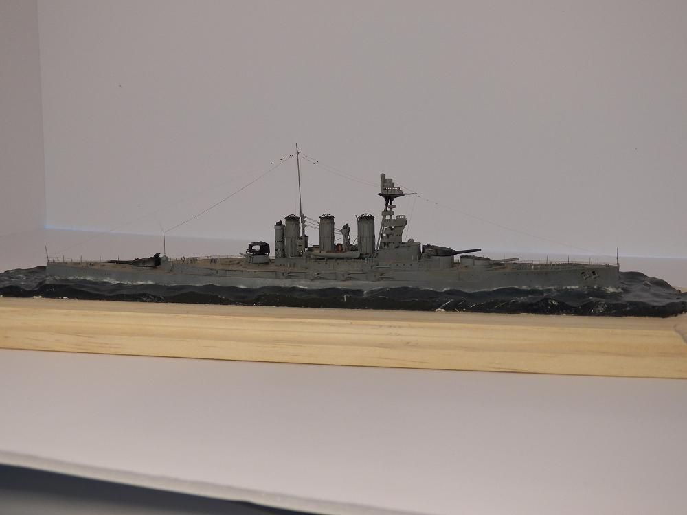

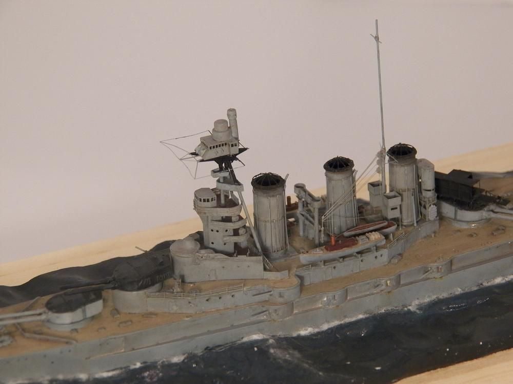

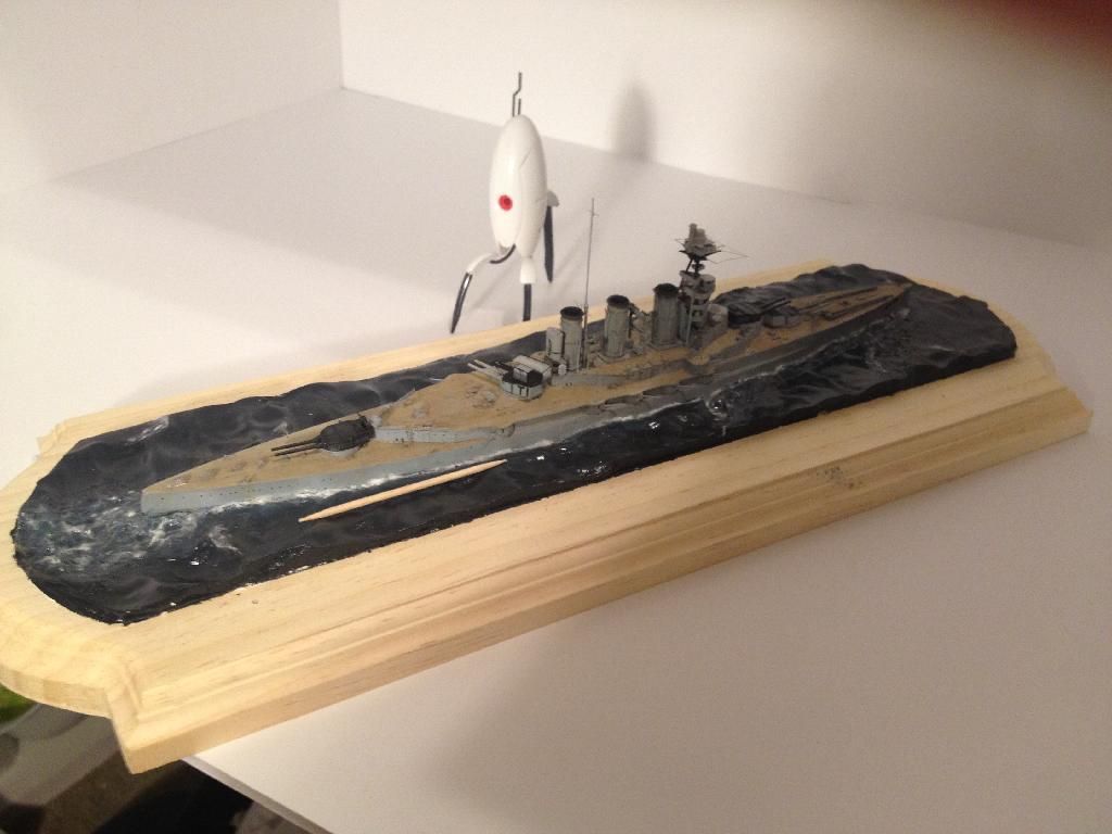

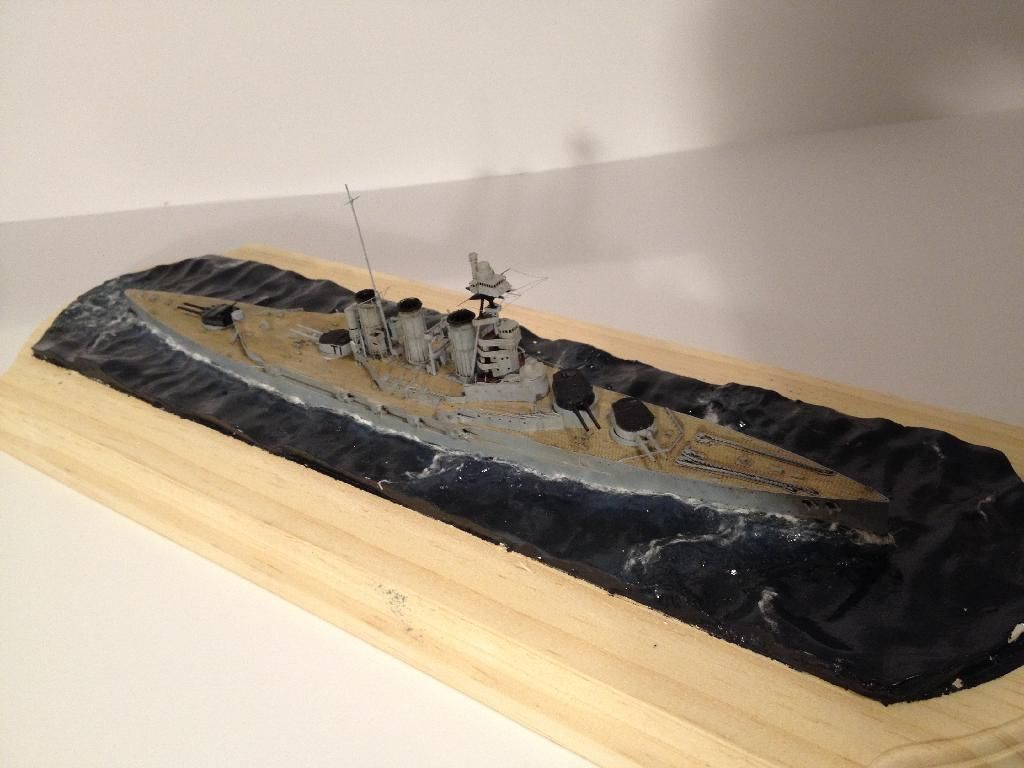

Update! Construction of the ship is finished. I'm going to touch up a few lengths of railing here and there (brass) and then hit her with a matte varnish to eliminate any glue spots, shininess, and bring her together. Once that's done, I'll add some more lengths of sprue between the awning supports with matte varnish, add her naval ensign, finish the water and base, then done!
Guest PetrolGator
OH NOES! I almost forgot the obligatory scale photo. How dare I.
5D4DC0BB-D0DE-463E-B119-9744B76121AA_zps
