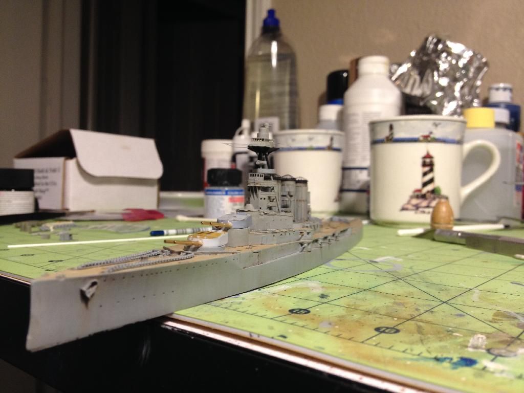

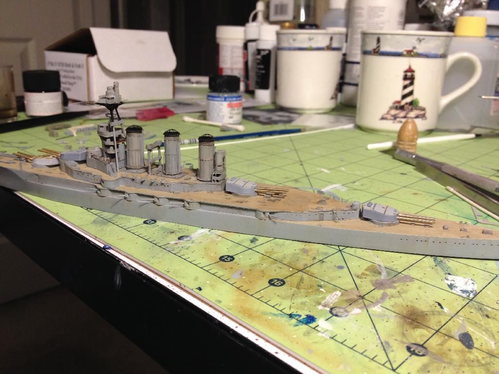

Guest PetrolGator Posted February 12, 2014 Report Posted February 12, 2014 Done: - Major turret construction. Not painted. Added blast bags to forward guns (clear stuff) - Installed small AA guns around bridge - Funnel stays and pulleys. - Main mast scratch built (broke.. ugh.) - Scratch built funnel piping. - Oil and pin washes + some dry brushing.
Guest PetrolGator Posted February 12, 2014 Report Posted February 12, 2014 Note that some filling will needed at the base of the citadel. I'll use some Elmer's or some such.
Mark Deliduka Posted February 12, 2014 Report Posted February 12, 2014 That is really coming along. It's amazing what an oil wash will do on a ship. Way to go!

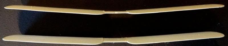

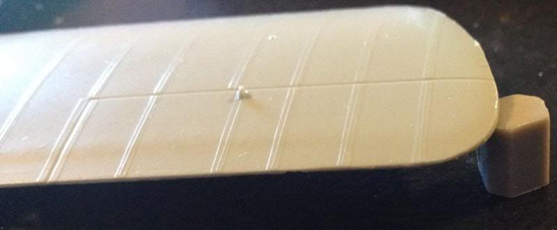

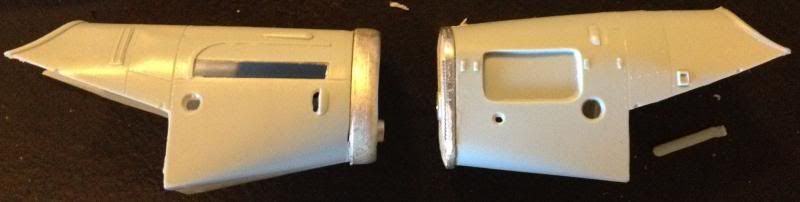

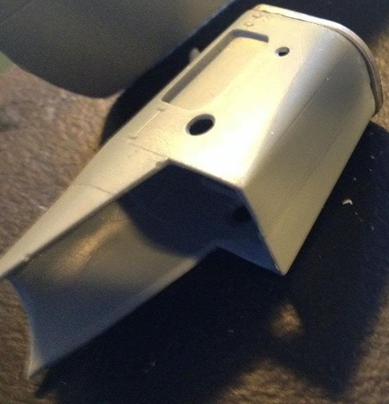

Brews Posted February 15, 2014 Report Posted February 15, 2014 (edited) Bruce, I have that kit. The decals appear to be in much better shape - they are yours if you want them. I have other options available if/when I ever get to it. Thanks, John. I might take you up on that. If you've ever built a Pegasus / Blue Max / Silver Cloud kit, you know what this feels like for me. I'm not going to complain, but suffice to say that I can get the Revell kit for less than I could get this for, and it has all the parts of the Eduard (Weekend Edition, I presume). Still, this has the Arab cowling, so that's something. I've actually been enjoying fettling this thing together. I didn't start with the cockpit! I glued both nose halves and radiators together. I will not use the Eagle III nose, but it's nice to have it to hand. The nose sections have big seams to fill. Additionally, they will need putty to fair them into the white metal radiators. Both nacelles have some fairly large openings, but no engine or engine bay detail was provided for either version. Choosing the Arab, which looks similar to a Hispano-Suiza 8 (although different in key mechanical areas) may be a happy result - as the HS isn't a difficult engine to scratch, and its mounting is fairly simple, too. However, some black blanking pieces may be all that's really needed to prevent the see-through possibilities. The radiators have depressions for a prop shaft, but neither have open holes. The Eagle's radiator has circular depressions on the front and back, while the Arab's only has one on the front. The detail of the radiator is nice. You won't see it once the prop is in place - so a removable prop makes sense. The provision of two and 4-bladed props is handy. These could be interchanged on any particular machine, I'm fairly sure. The suggestions are to use the 4-bladed one for the Eagle, and the 2-bladed one for the Arab. t tried supergluing (butt joints) the wing pieces together. Apart from the centre-sections, the wings are identical. The centre-sections don't fit the outer wings in profile. They might, if the wings didn't have dihedral, but even after sanding the outer wing edges down to an angle, they don't fit anywhere near closely. I don't know how this can happen. Isn't a kit is built from the parts to test that they fit? If so, am I doing something wrong? I'm settling for the eventuality of a session with Milliput at a later date. At this point, a decision had to be made as to which surface fitted flush - the underside of the upper side. My decision was made for me quite accidentally, as it turned out. I drilled holes for pins in matching halves of the centre section and outer wings. On the lower wing, the upper surface mated better. On the upper wing, the lower surface mated better. That's not the way I would have preferred it, but it's the way it turned out. It means that I'm going to lose all the moulded surface detail on the most visible parts of each centre-section, but at least the final product should look ok. My next task will be to paint the insides of the fuselages in clear doped linen. I might use Tamiya Wooden Deck Tan or Deck Tan (the paler of the two). Xtracolour's CDL is nice, but takes days to dry. The timber structure is provided in white metal. I'll paint that in varnished wood colours. I think I'll use a Humbrol enamel for those - somehow I don't trust Tamiya paints to adhere well to metal - but it's worth a try. Painting these things is something I can do with a brush while watching TV with the beloved tonight. Here is the book that contains my reference drawings: Sample drawing: I made a crude jig out of a piece of stout sprue. View of the dihedral on the main planes. View of the fit between the radiator and the Arab's nose. Note the large holes! Comparison of the Eagle's nose (left) with the slightly less-aesthetic Arab's nose (no pun or offense intended) on the right. Remember, when the Blue Max kits came out, they were the only game in town for virtually the entire range - at least as far as injection-moulded kits go. Eduard and Roden have really raised the bar in 1:48 scale, let alone what Wingnut Wings has done for these birds, and the hobby. Edited February 15, 2014 by Brews

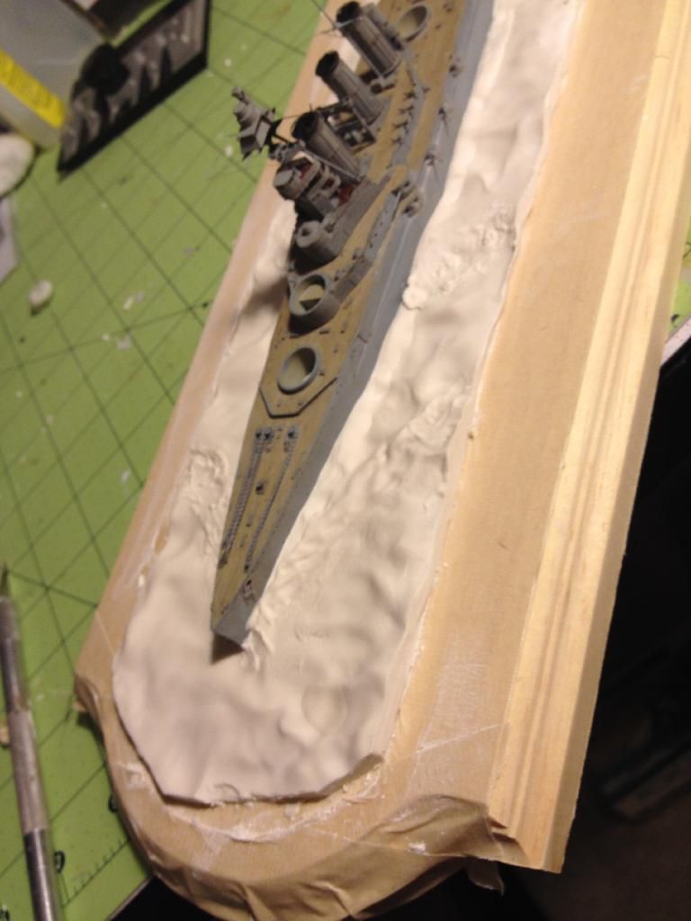

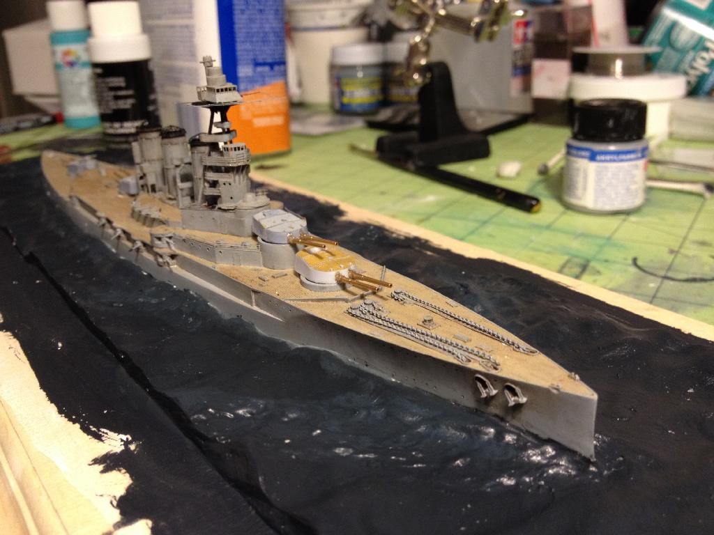

Guest PetrolGator Posted February 21, 2014 Report Posted February 21, 2014 I needed to do some work on the water before proceeding with the ship itself. I used blown plaster to form the water itself, which initially looked like Play Doh. Further work was done by adding additional plaster for the bases of her wakes. I painted the water using a dark blue/green/black base. I then cleaned up any messes on the hull side and began lightening areas around the hull to show turbulence and underwater foam. She dried overnight and will have teased cotton added to give the ocean some life.Additional work will be done to vary the surface and add an illusion of depth. However, I don't want to overdo it. WWI battlecruisers weren't known for giant wakes. Significant work remains for the ship itself. The main mast is scratch built and seems to CONSTANTLY break. I've also got to add its cranes, railing, crew, rigging, boats, and small bits. The turrets also need paint. I have some cool custom decals that represent the demarcation lines added in 1919. This has been a LONG build, partly due to my available time and significant scratch building. Pictures: Plaster doesn't look much like water, eh? Adding color. Hull needs cleaned up. You can see the color variation here. These old battlewagons weren't particularly fast, so a HUGE wake is unnecessary. This is a picture with the turrets fitted. Note that I'm cleaning and mess off the hull. I'll touch up anything that remains when I get home.
ghodges Posted February 21, 2014 Report Posted February 21, 2014 Obviously working its way through the Black Sea... :P Good looking work Chris, in spite of your frustrations. The addition of the water seems to better accent the sweep of the bow profile too! GIL
