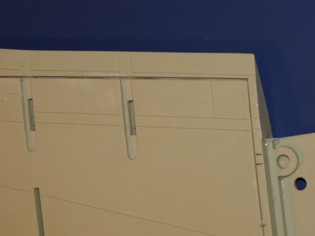

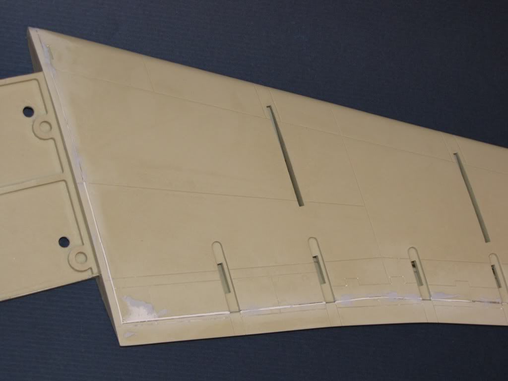

I'm not sure plastic will work, here is a picture so you can have a better idea. I need to form a more round shape on the bottom, as you can see it's concave now.
Anyone have any experience with long term bonding of filler or bondo on resin?

In situations like that, I've used combinations of sheet plastic, 5-minute epoxy, putty and a bit of brutality with the rasp and file set, just to keep it strong and get the shape close. Show it no mercy.
Epoxy sounds like an idea, Ive used that before on resin with very good results.
