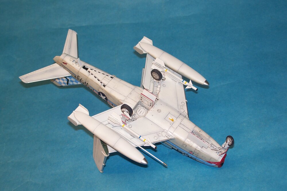

Finished this one this evening....I closed up the ammo bays and gun bays, and left out the engine. The wing fold is a kit option, and fits very well either way. I did add all of the detail on the shelf behind the seat as KH provides absolutely nothing back there as well as the forgotten seat rails. I also lengthened the nose gear strut as KH molded it with almost no oleo showing (ala a museum bird); and turned it some "for that more candid look". By the way, the white on the wing tip lights is Micro Krystal Klear which hasn't dried yet! The markings are from Caracal and performed flawlessly.

Pic of the model in progress...see below for short cuts in building this kit!

Sorry to see KH call it quits. This is one of their better kits...hopefully someone will pick up the molds and release it again.
GIL :cool:
Good looking Fury Gil! I really like the additions behind the seat to fill the “black hole”.
