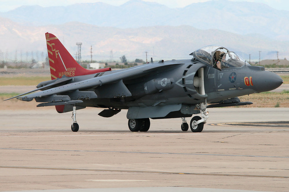

This next build is the1/48 Hasegawa AV-8B Harrier II Plus. It will be detailed with Eduard photo etch and the scheme is going to be the infamous VMF-214 Blacksheep. The squadron was started by Major Gregory Boyington back in World War II. The Blacksheep transitioned to the Harrier in 1989 and deployed to their home base of MCAS Iwakuni, Japan. The decal set is produced by Caracal decals (set # CD48115) I will be doing the blue tailed scheme from 2015.
