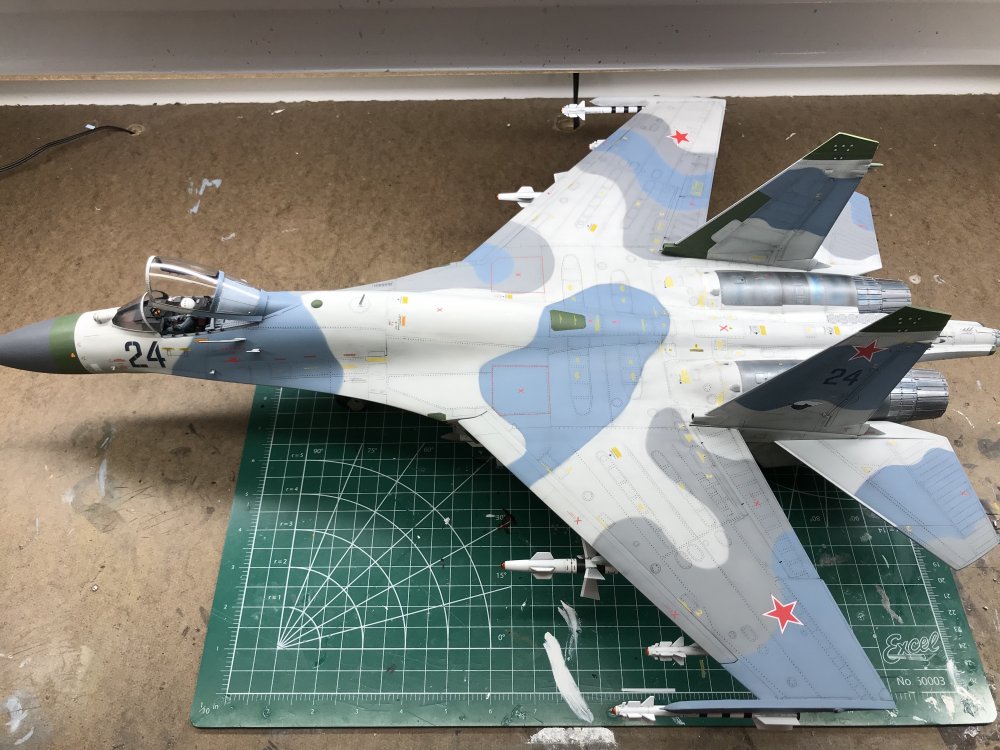

            Thanks Bill. All the sub assemblies have been completed. The missiles took quite a long time to paint and apply decals. I got this kit at a swap meet from a vendor. After a closer inspection of the kit, I noticed that it had been subjected to a lot of moisture. There was actually a light film of mold on top of the decal sheet. With a damp rag, it wiped right off. The staples were rusted on the instructions. The decals were a challenge. I experimented with pre-shading on the rudders, and elevators.
            I did something pretty stupid. I assembled the wings with the leading edge slates installed , WITHOUT looking at the instructions first. When it came time to attach the wings to the fuselage, they would not fit. After using a few #11 blades to carefully remove the slates and some sandpaper, the problem was fixed. I'll never do that again.

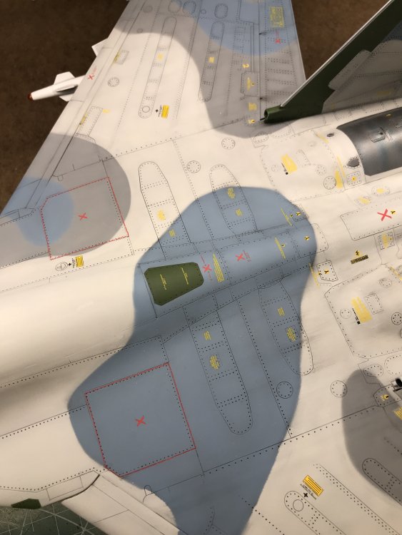

                           Well, I'm finally in the homestretch. Everything is ready for decals, then a pin wash of artist oils thinned with mineral spirits. I was not happy with the exhaust nozzles. Again, I got in a rush, and did not look at any photos before I started. I stripped them down to bare plastic and started over. I used Testor's metalizer lacquer on the nozzles, and engine panels on the rear of the fuselage. Buffing, and non-buffing. 5 different colors. These are for airbrushing only. No need to thin them. Easy to work with. The heat marks are Tamiya clear blue thinned down. No fit issues at all on the rudders. After a little sanding, they fit perfect. No need for putty either. I should be able to start on the base this weekend.

                                                                         Thanks Bill. I lightly hand traced the pattern with a pencil, then used poster putty as a mask. Thanks again Mark. The decals were a combination of kit, and aftermarket. Took some time to apply them. Completed the base this morning. I made taxi light from my scrap box. The static grass is from a company in Germany. I used masking tape and pastel chalks to simulate tire marks on the taxi way. She's a big one. The base measures 22 3/4 by 26 3/4. Good times indeed.
