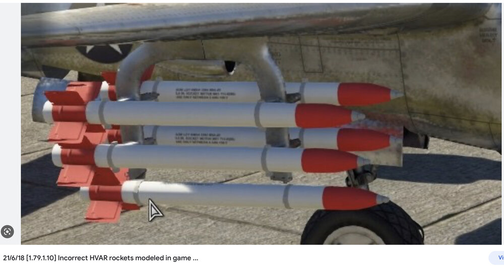

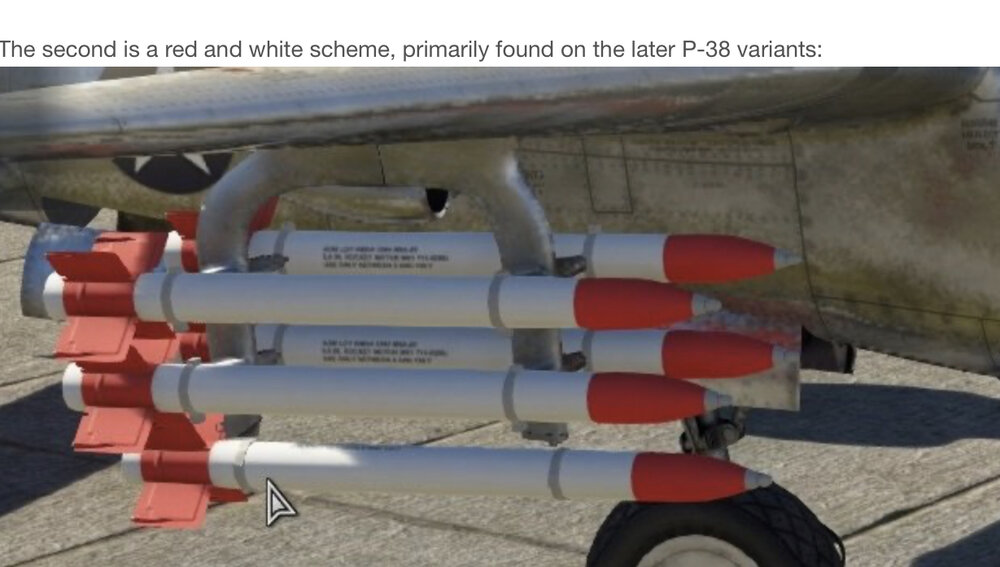

StuartMont Posted February 9, 2023 Report Posted February 9, 2023 I am currently building the Trumpeter 1/32 P-38L. There are no indications of the color scheme for the HVARs and there are no decals for the rockets and bombs. I found the attached photo on the web and it is captioned as pertinent to later versions of the P-38. I really like this look and plan to proceed forward. My question is whether anyone knows where I might find decals appropriate for the HVARs. Any suggestions would be appreciated. As always, thanks for the help for a very needy modeler. 😀
Stikpusher Posted February 10, 2023 Report Posted February 10, 2023 I don’t know where they came up with that red and white scheme for the 5” HVARs. The rockets came out of the ordnance factories in standard colors with OD warheads and depending upon Navy or Army use, light gray or bare metal rocket bodies. Presumably the gray paint on Navy rockets was for corrosion prevention at sea in the damp salt air environment. Yellow stenciling is seen on the warheads, and the fuse is in bare metal. USN USAAF/USAF
StuartMont Posted February 11, 2023 Author Report Posted February 11, 2023 Well thanks very much for your reply. Happily no red has been laid down and I have yellow decals from a separate weapons set. I’ll use the army scheme for the P-38. The photo looked real and I did not delve any further into it’s origins. I appreciate your pointing me in the right direction.
Stikpusher Posted February 11, 2023 Report Posted February 11, 2023 You’re quite welcome. That photo is quite real, but it most likely came from either somebody’s restored warbird, or a museum aircraft with somebody’s artistic impression of how they thought the rockets might look. I did a bit of read up on the 5” HVAR, and it turns out that the Army and Navy rockets had different electrical firing connections, so that would be another reason to have the motor casings in different colors for the ordnance armorers. Apparently there was also an adaptor kit available for the firing connections to make the Navy rockets compatible with the AAF connector wiring. I imagine that in some theaters of war, such a thing would come in useful.
StuartMont Posted February 12, 2023 Author Report Posted February 12, 2023 Thanks for the additional information, cool stuff. I did some more digging also and found this . . . Yikes! Not sure what game they are referring to but perhaps that was the genesis for the incorrect red/white color scheme. Based on your AAF photo I will be painting the tail fins the same color as the warhead.
