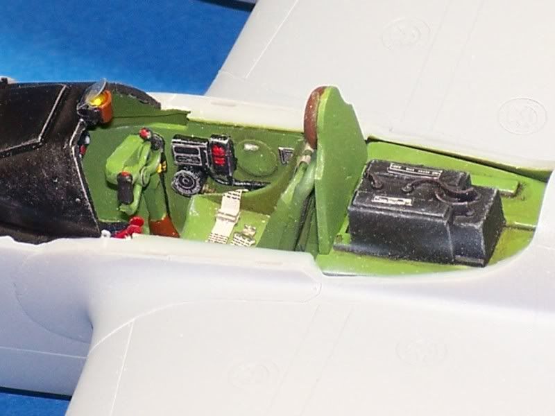

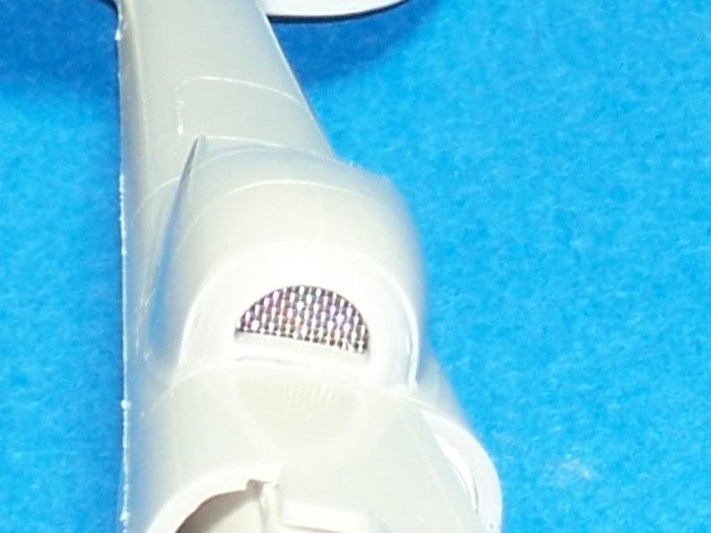

ghodges Posted September 6, 2009 Report Posted September 6, 2009 I have been getting some modeling done (in between posts! ).... This is the Hasagawa (HAI!) 1/48 P-38L, that I've backdated to a "J-10". All that means is that I've added the underwing landing lights in place of the later wing leading edge light, and deleted the rockets and the underwing compressability flaps. The cockpit is 95% kit, with a few extra pe levers and doo-dads, Eduard colored seat belts, as well as some left over Waldron placards. I'll probably shorten the instrument coaming and add a Quickboost gunsight to finish it up. I added some screening to the oil cooler intakes (and those football intake thingys too). The only other "modification" I plan to the kit is to lengthen and turn the nose strut to make it sit more nose high, ala most Lightnings! Made a lot of progress on gluing all assemblies. Next is the dreaded sanding phase, but I hope to have the main airframe assembled and primered by next weekend. I'm doing "Stinger", which is an OD/Nuetral Gray ETO bird; the only Lightning scheme I don't have built at this time. Also, I am still working on the 1/32 T-28, albeit at a slower pace as it doesn't need to be done until the Warner Robins show in October! Cheers! GIL
Glynyrd Posted September 7, 2009 Report Posted September 7, 2009 Uh, I dunno, Gil. I'm kinda partial to those compressability flap thingies. When you dive towards the floor with that plane after finishing it, they might come in handy ;) Looks great so far. I love the cockpit... Glenn

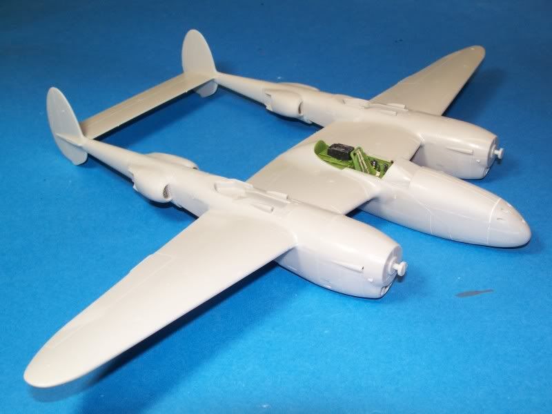

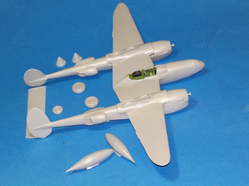

ghodges Posted September 8, 2009 Author Report Posted September 8, 2009 Got her assembled... Paid close attention to alignment and not the fit of the wings to the nacelles Think it'll all be good! Letting the glue dry overnight before attempting the final sanding/scribing phase. Less worries than I expected so far! Cheers! GIL
Guest Bun E. Carlos Posted September 8, 2009 Report Posted September 8, 2009 Oh You Stud You!!!!!!!!!! Looks Good!!!!!!!!!!!!!!! I just about threw one of the "L's" into a wall........the Virginia Marie Issue..............your fit looks a lot better!!!!
66Foxtrot Posted September 8, 2009 Report Posted September 8, 2009 Great work as usual...especially the cockpit!
MikeBrickman Posted September 9, 2009 Report Posted September 9, 2009 How many hours have you invested in it so far?
ghodges Posted September 9, 2009 Author Report Posted September 9, 2009 Hours?? 4, or 5 maybe. Perhaps 2 for the cockpit, 1 on doing the mods (wings lights, curtailed cockpit coaming, and adding screening), and 2 or so on sanding and scribing everywhere except the main wing/nacelle joints; which don't look too bad. It's a refreshing change from the T-28, where it takes 2 hours just to construct 5-6 gear doors! I started the model last Friday morning and got to work on it over the weekend. Jack, I understand where you're coming from and had heard some horror stories about this kit (P-38's are tough anyway). I did have to "twist" the left vertical tail a bit. Something went CRACK (inside I guess as I don't SEE a crack) and since then it's been straight! Now if I can just avoid dropping the nose heavy beast....Cheers! GIL

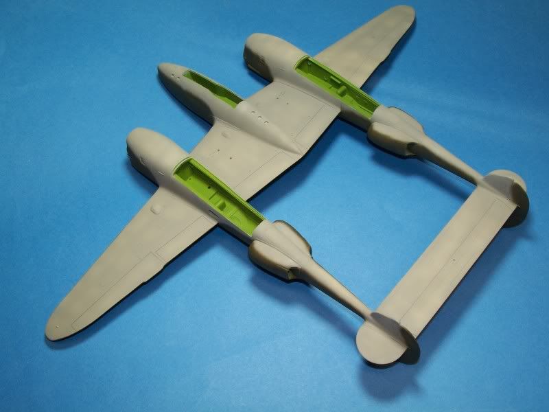

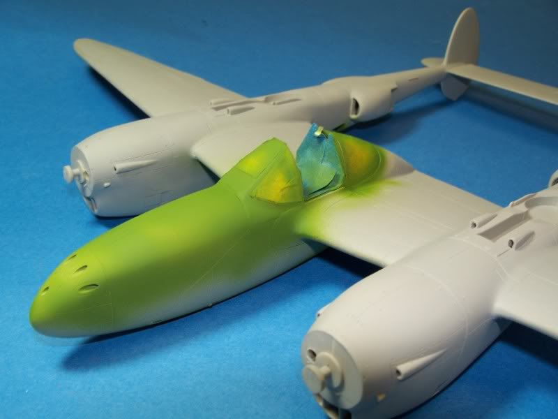

ghodges Posted September 18, 2009 Author Report Posted September 18, 2009 Finished up all of the cockpit stuff in prep for adding the clear parts. The instrument panel coaming was cut back by 1/8in. which helps it to clear the control stick and make it possible to glimpse the main panel. I also added a Quickboost gunsight, which really makes for a nice touch! Masked off the windshield and rear canopy with Tamiya tape and glued them in place. They fit well! I primered them in Zinc Chromate so that it'll act as the inside color for the framing. Also, note the holes beside the prop bosses. I put those there so I could insert a couple of paintbrush handles to allow me to hold the model while painting. No need to fill them later as they'll be hidden by the prop spinners! Just about ready to start painting this one! Cheers! Questions, comments and critiques welcome! GIL

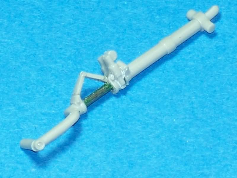

ghodges Posted September 19, 2009 Author Report Posted September 19, 2009 Forgot to post this yesterday... I lengthened the nose gear strut to give the model a bit of nose up stance, which is seen in a lot of P-38 pics. I also opted to turn it for that "more candid appearance". You lose the kit oleo when doing this. The new oleo strut is a piece of floral wire and the oleo scissors came from the spares box. GIL
Mark Aldrich Posted September 20, 2009 Report Posted September 20, 2009 Every non-model builder that sees my man cave or a model I work on keeps saying they don't have the patience to try it. You aircraft builders are the patience masters! Gil, that is looking completely beautiful! Keep the pictures coming. How you have the patience to do the re-scribing work is beyond me. To willingly and knowing fill and sand joins that you have to re-scribe completely boggles my mind. Mark

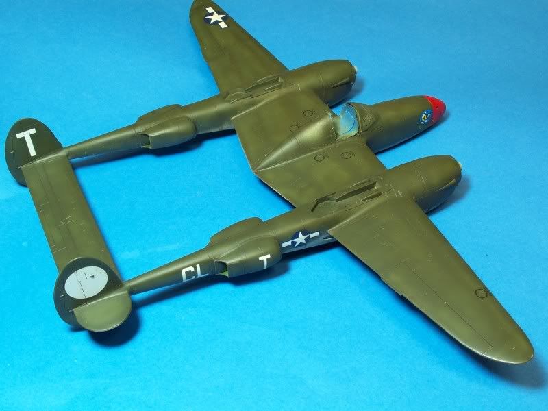

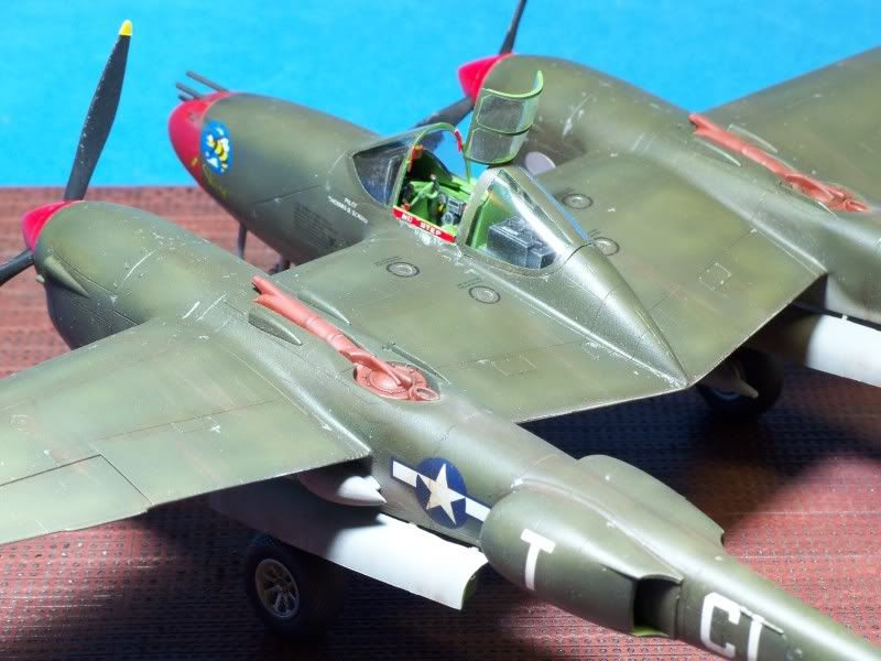

ghodges Posted October 7, 2009 Author Report Posted October 7, 2009 Decals, another MM gloss coat, wash, and flat coat have been applied.... Wash was a water-soluable oil paint (Raw Umber), thinned with water and about 10 drops of dishwashing detergent added to the mix. The "rough" texture of my overall finish worked to my favor as it made it difficult to remove all of the wash, which in turn added some nice weathering! The decals are from Superscale #1179, P-38H/J Lightning Aces. The flat coat is Testros Dullcoat, thinned with laquer thinner. I love that stuff, as it dries in about 5minutes! Next pics will be when she's done. Questions and comments welcome! Cheers! GIL
Daniel Koss Posted October 9, 2009 Report Posted October 9, 2009 (edited) Very nice Gil, I like the subtle weathering and wash. Edited October 9, 2009 by Daniel Koss
ghodges Posted October 12, 2009 Author Report Posted October 12, 2009 She is Fini! Overall scheme for "Stinger". Note the replacement prop blade on the left, w/o stenciling. Ok, so I loused up the 6th decal......in which case I had to use a replacement prop! I also failed to get as much nose-up attitude as I wanted, but I didn't want to chop and lower the main gear also, so I'll live with it. Of note in this pic is that the side windows are "down". Not the kit glass (of course), but simple strips of sheet plastic with the No Step applied and painted chromate green on the inside frames. You can also see the canopy locks added to the windshield. "Chipping" was done with a sharpened silver Prismacolor pencil. You can see the blue formation light on the vertical fin. It, and the wingtip formation lights were first painted silver, and then coated with Tamiya acrylic Clear colors. The bottom view shows the weathering best. Besides the wash applied earlier, I also applied some Warpigs weathering powders. The IFF lights are colored MV lenses. The #200 (red), #201 (green), and #202 (amber) fit perfectly in the Hasagawa depressions! Glad to have this one done! I got what I wanted, an ETO OD/Gray P-38, so it strikes another off the to-do list! But take my word for it, this thing is rough when you get closer than 6"! I really envy people who can apply smooth layers of paint! Comments and critiques welcome! Cheers! GIL
