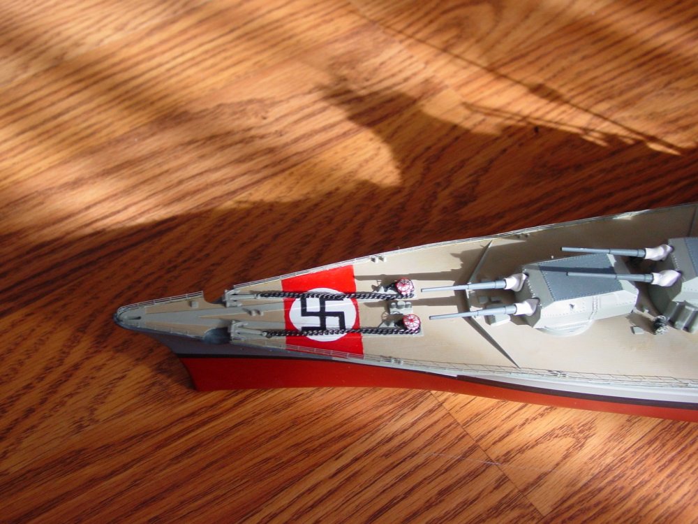

Wolfman63 Posted March 21, 2020 Report Posted March 21, 2020 I used shrink tubing like for electrical wiring. Shrink one end for the barrel and leave other end to go into the turret. You can buy it on amazon in various sizes for all scales. They come in colors. I used white on my Bismarck. You can even still move the barrels. Here is a photo of the Bismarck I did.
