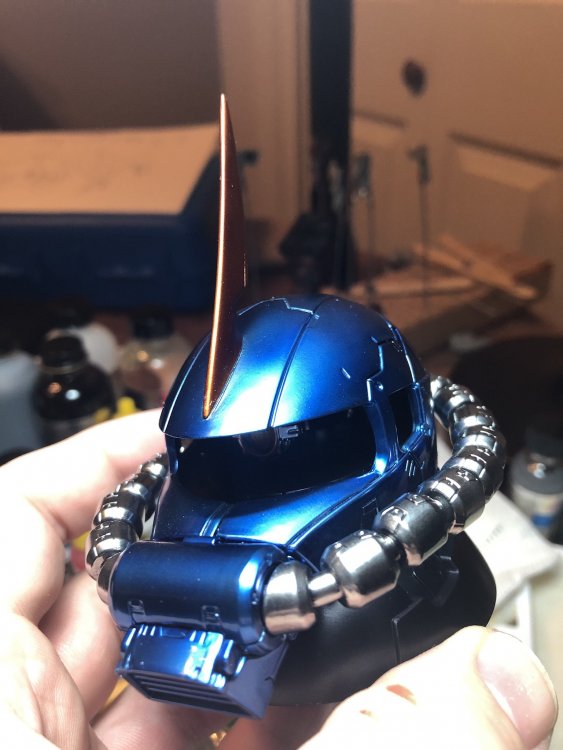

Paul Posted April 22, 2020 Report Posted April 22, 2020 I'm a big fan of Alclad's metallics - they get a really good shine without that grainy look of, say, a Tamiya Chrome Silver or something. Maybe grainy isn't the right word, but it's all I can come up with at the moment. Gil's right - put on a black gloss primer and make sure it's super smooth and shiny for best results. I haven't had any issues with the Alclad black primer. You may need to polish the primer coat a bit to get it nice and even, but the effect is worth it. I did some candy paint on a sci-fi model I built not too long ago, and the Alclad chrome really made the final color pop. 2
