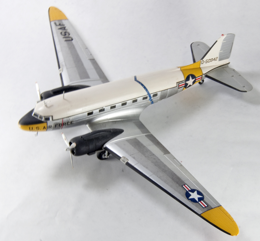

To explain, many, many moons ago, I did a SAC version of the C-47D (or it may also have another designation?!).  But, since I was working from just a small B&W photo, I got the colors wrong.
After using the ol' Mk 1 A1 Eyeball, I decided that the bands of color should be yellow, as they were sort of mid-range color:
Only after taking the then newly-finished model to a model contest,  was I politely informed that the yellow color was mostly only used on rescue type aircraft, not on other types.  Doh!  (Oops -- just hit the wrong thing and posted the article before the end... guess I'm just full of errors...)
Anyway, after slinking home from the contest, I hid the model for decades way in back on the bottom shelf of the display cabinet, thinking that perhaps one day, I could salvage it.  The main problems were that the lettering and all the cheat lines came from old Stoppel silk-screened decals, and were no longer available.  Plus, I did not have enough left in the stash to risk masking and raising them from the model, which is finished in Metalizer and Model Master paints, with either no topcoat or the thin Metalizer clear top coat.  Also, I could not find any paint that I trusted enough to try hand-painting.

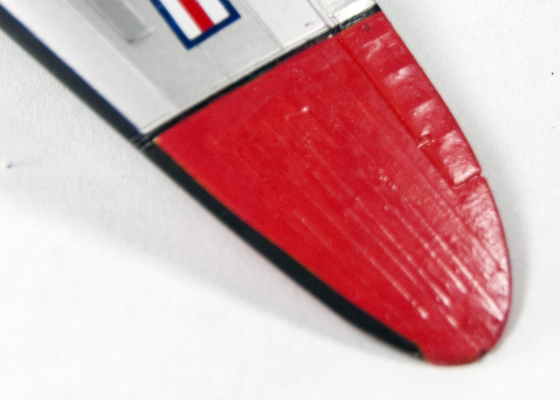

After one coat, above on the underside of the left wingtip, the paint covered pretty well.  I was not trying for a single-coat finish, so put the paint on rather thin, and then after the first coat had dried, added a second coat:
Although hard to tell from this picture, there are almost no brush strokes after the second coat had dried.  You can however, still see a tiny bit of the yellow underneath, but certainly looks better than the bare yellow.  Also, having yellow as a base coat, rather than the usual white, make the paint look not as fluorescent, but I'll settle!

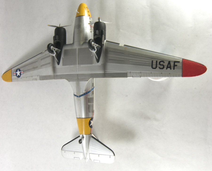

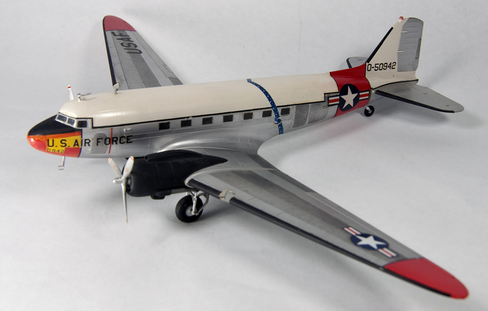

The whole thing has been done in two coats (a little third coat touch-up here and there), all except for the nose, where thankfully, if my hand brushing skills aren't good enough to save the decals, I still have enough from the stash for just that area:
I'm sure you'll agree, it's starting to look a LOT better now -- if only I could do something about that old, yellowed white paint...
I still don't know how it airbrushes, but as far as I'm concerned it hand brushes as good as ( maybe slightly better then) the old Humbrol tins.
