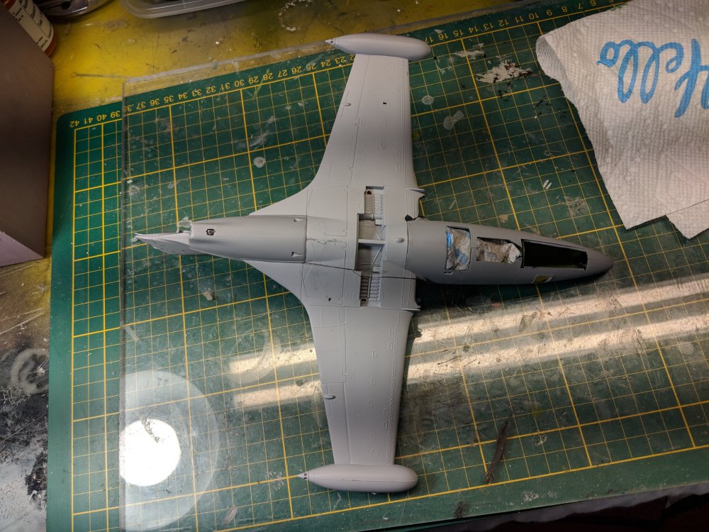

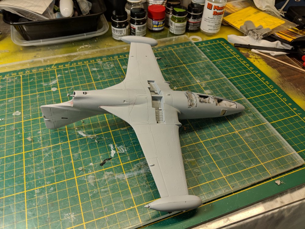

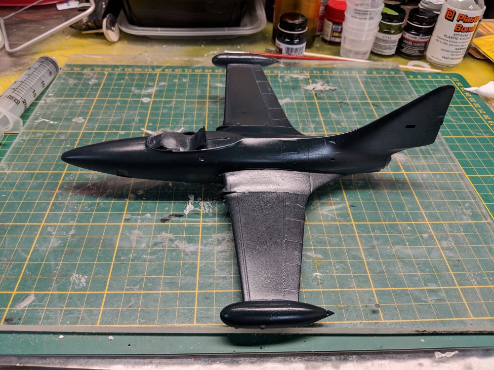

nmertes Posted February 10, 2019 Report Posted February 10, 2019 Successfully glued the wings on my F9F-5P this afternoon. A little seam cleanup & some putty down the cut line should make it ready for paint. It will never be a contest entry but, that's not what I'm building it for. The cut line is a lot narrower than I expected it to be. 1
ghodges Posted February 10, 2019 Report Posted February 10, 2019 (edited) Yep, a little filler, or even a strip of plastic in that front gap and you'll almost forget it was ever there. Way to persevere! By the way, in the future if you're updating a project (like this one), you can simply post the new pics and info at the bottom of your original post and it will jump back up to the top of the topics when you post it. That saves having to "add" a new post when you do an "update". Hope this helps! GIL Edited February 10, 2019 by ghodges
nmertes Posted February 10, 2019 Author Report Posted February 10, 2019 Thanks for the comments Gil. I'll remember about the add next time.

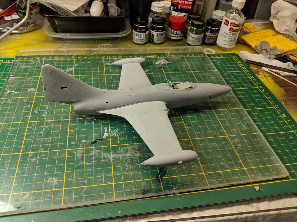

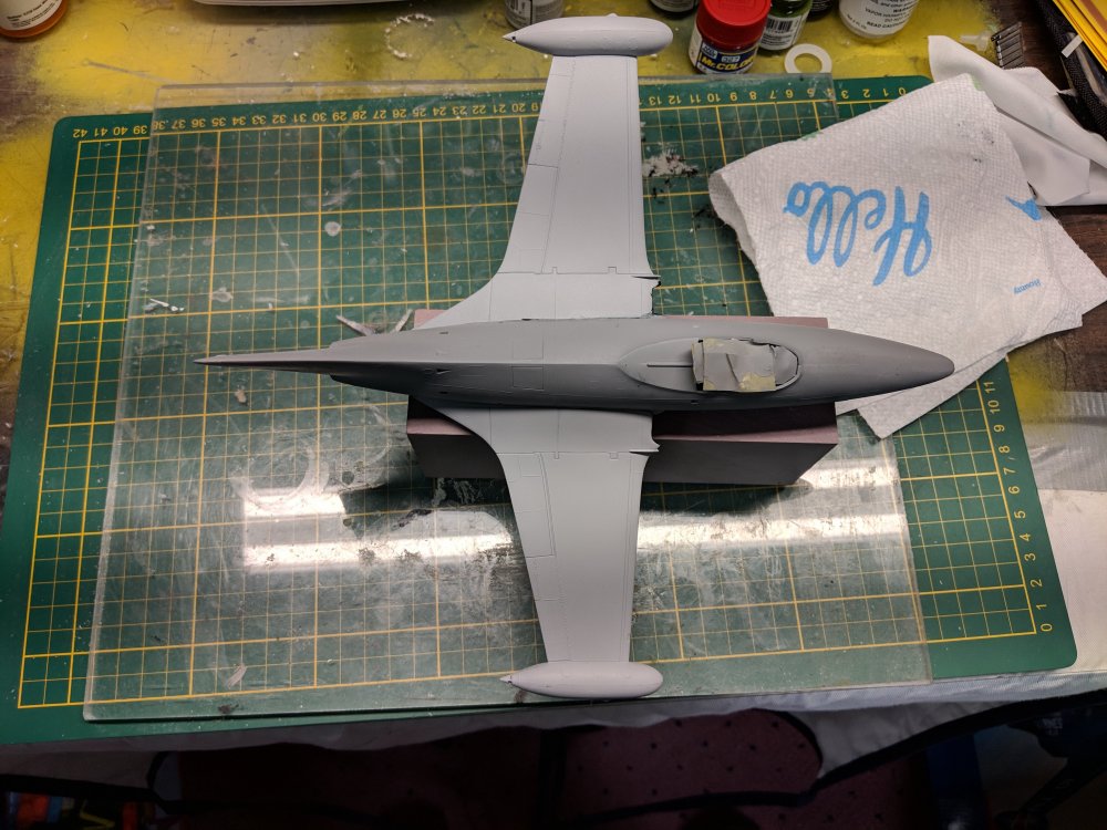

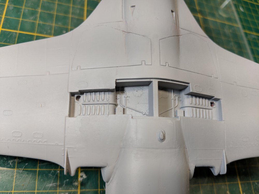

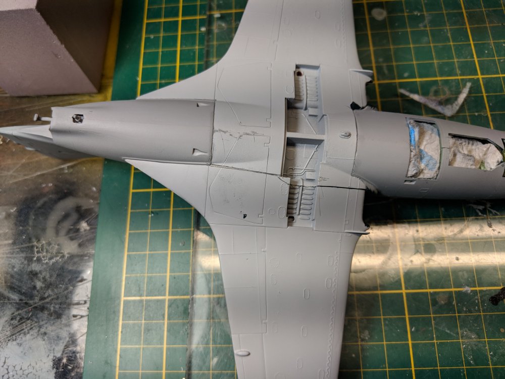

nmertes Posted February 21, 2019 Author Report Posted February 21, 2019 The Panther project is making progress. Some Bondo, sanding, & another coat of primer have it just about ready for a coat of Dark Sea Blue. Hopefully that will happen Saturday. The cut through the port wing root, while not invisible, turned out a lot better than I had expected.
ghodges Posted February 21, 2019 Report Posted February 21, 2019 Shhhhh! There was never a problem, nor is there any "cut line". Trust me, if you don't mention it, no one will see anything. I'm looking, KNOWING it's there, and having trouble seeing anything! Excellent recovery! By the way, do you have any Tamiya Fine White primer? If so, I'd recommend a coat of that before starting with the blue. It'll cover easier over the white than the gray. GIL
sprueguy Posted February 21, 2019 Report Posted February 21, 2019 I'm not a wing-wiper per say, but I got to say you have done a great job on this one, can't wait to see it finished, good luck!!

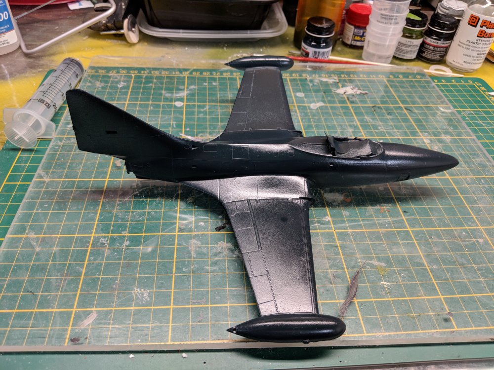

nmertes Posted February 24, 2019 Author Report Posted February 24, 2019 More progress. I missed Gil's recommendation of Tamiya white primer before spraying blue. Next kit on the docket is the Kitty Hawk F2H-2P. I'll remember to use the white for it. Experimenting with Mr. Color Leveling Thinner. Thinned MM Dark Sea Blue 2 parts paint to 1 part thinner. Looked extremely thin. Dropped the pressure on my compressor to 12 psi & moved the needle a little further forward. Guess it's been too long since I've done any airbrushing. The topside will need another coat & a couple days drying time before I shoot the bottom.
ghodges Posted February 24, 2019 Report Posted February 24, 2019 You're off to a good start, and that color looks dead-on! Do you have any 1000 grit or finer wet/dry sanding pads or sticks? If so, you might try LIGHTLY wet sanding the paint job before applying the next coat. You can even use 600 grit paper IF you're really light on the touch, letting the paper do all the work. That should smooth out most of the orange peel look and that next coat of paint will look even better. I agree with Mark, regardless. This is coming along very well and is going to look the part! GIL
