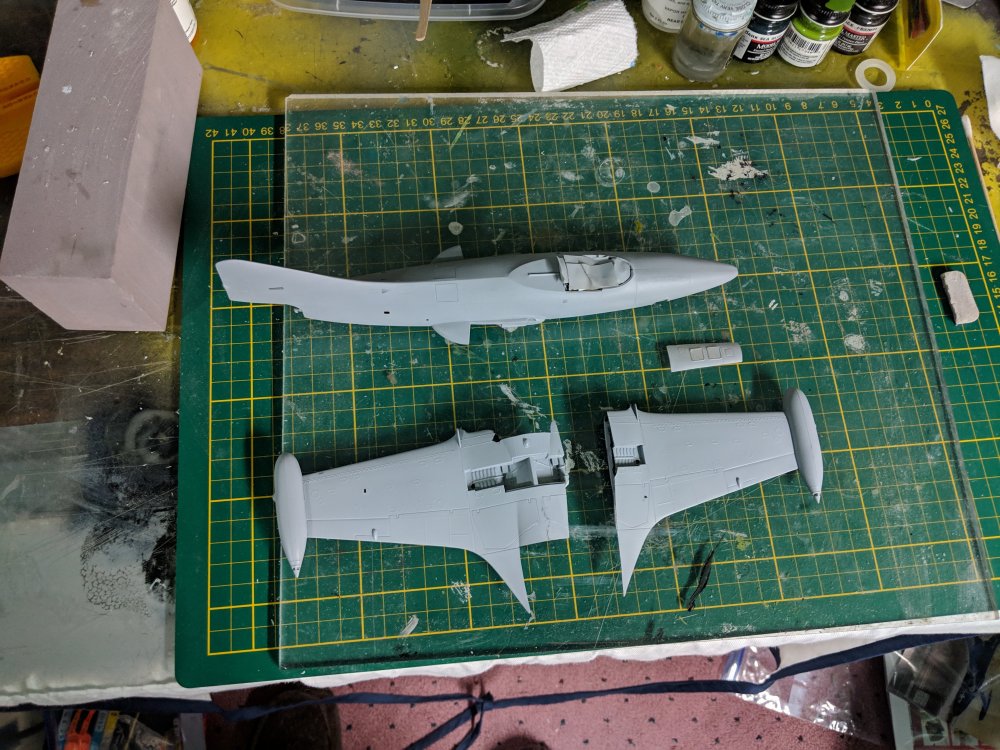

nmertes Posted February 7, 2019 Report Posted February 7, 2019 Attempting to get back to actively building with the old Monogram F9F-5P recon Panther. Planning to mark it as VC-61/VFP-61. Will have to finagle the markings from other sheets as the kit only comes with Marine squadrons. Good kit for its age. Not very many parts. Certainly not up to the detail of the Kitty Hawk Cougar or Banshee. I made 1 major error. I glued the upper halves to the lower wing before installing the lower wing to the fuselage. The instructions read to glue the bottom half of the wing to the completed fuselage. I think I've salvaged it by cutting the port wing off. It will require a little putty work to correct. Won't do that again. The initial primer work is done. Will assemble this weekend & shoot the 1st coat of Dark Sea Blue. Had hoped to have it ready for Blizzcon next weekend. Don't think I'll make it. 1
ghodges Posted February 7, 2019 Report Posted February 7, 2019 Tough way to build it, but I have no doubt you'll salvage it and we'll never be able to tell the difference. As I recall on the Monogram Panthers, it's the intakes that determine the order of the wing assembly. I believe I altered the construction sequence with the intakes (finagled them somehow) so I could put them in the wings and then add the entire assembly later on; which allowed me to work them and blend them into the wings easier. If I remember, all you need to do is saw off those protrusions at the rear of the wing roots and you can slip the entire wing in place. Looking forward to seeing you overcome this setback! GIL
nmertes Posted February 7, 2019 Author Report Posted February 7, 2019 Wish I'd thought of that, Gil. It would have preserved the detail I lost cutting the wing.
