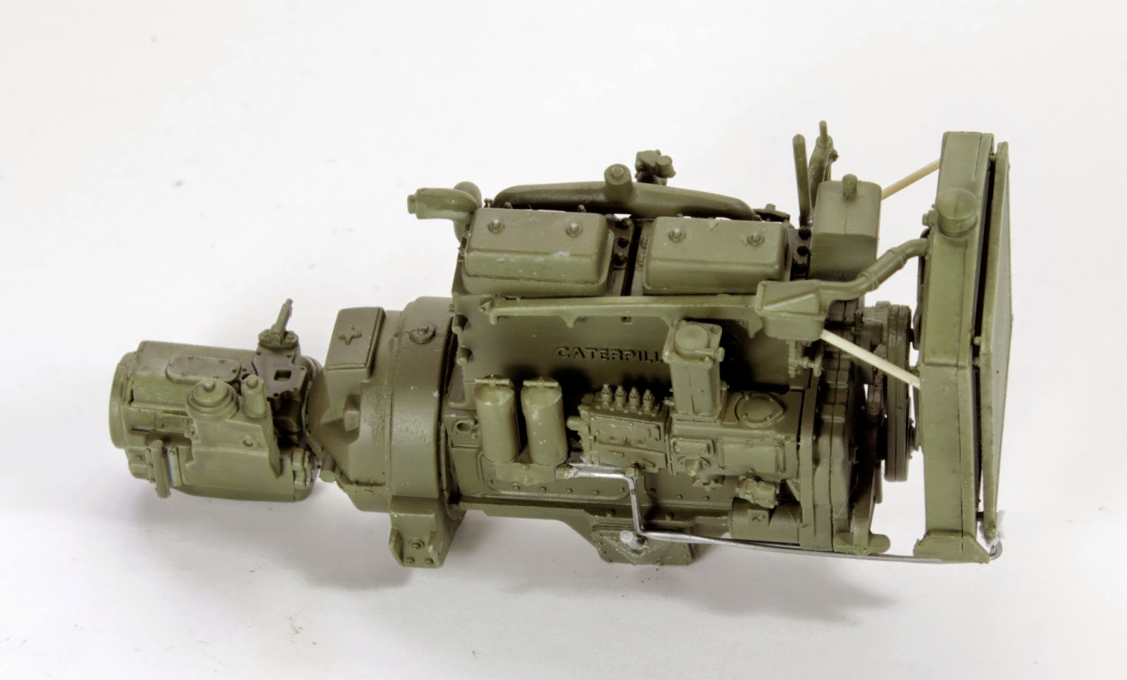

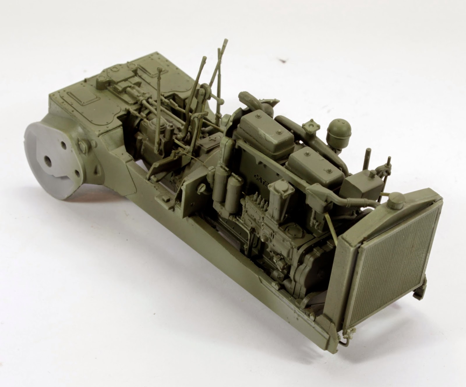

The engine is quite impressive due to the many components, I decided to start painting very soon before I could be unable to reach some parts with ease.

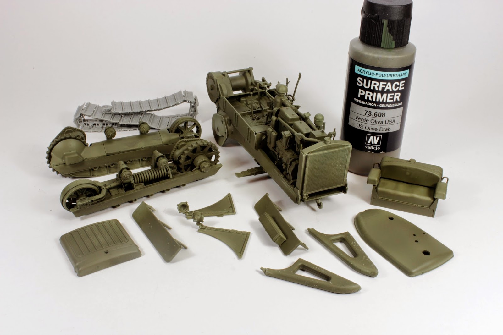

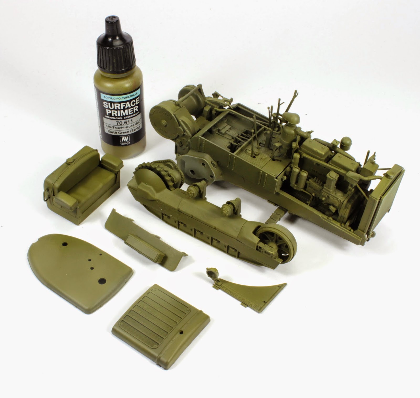

I used an Olive drab primer to paint the different elements as I added them.

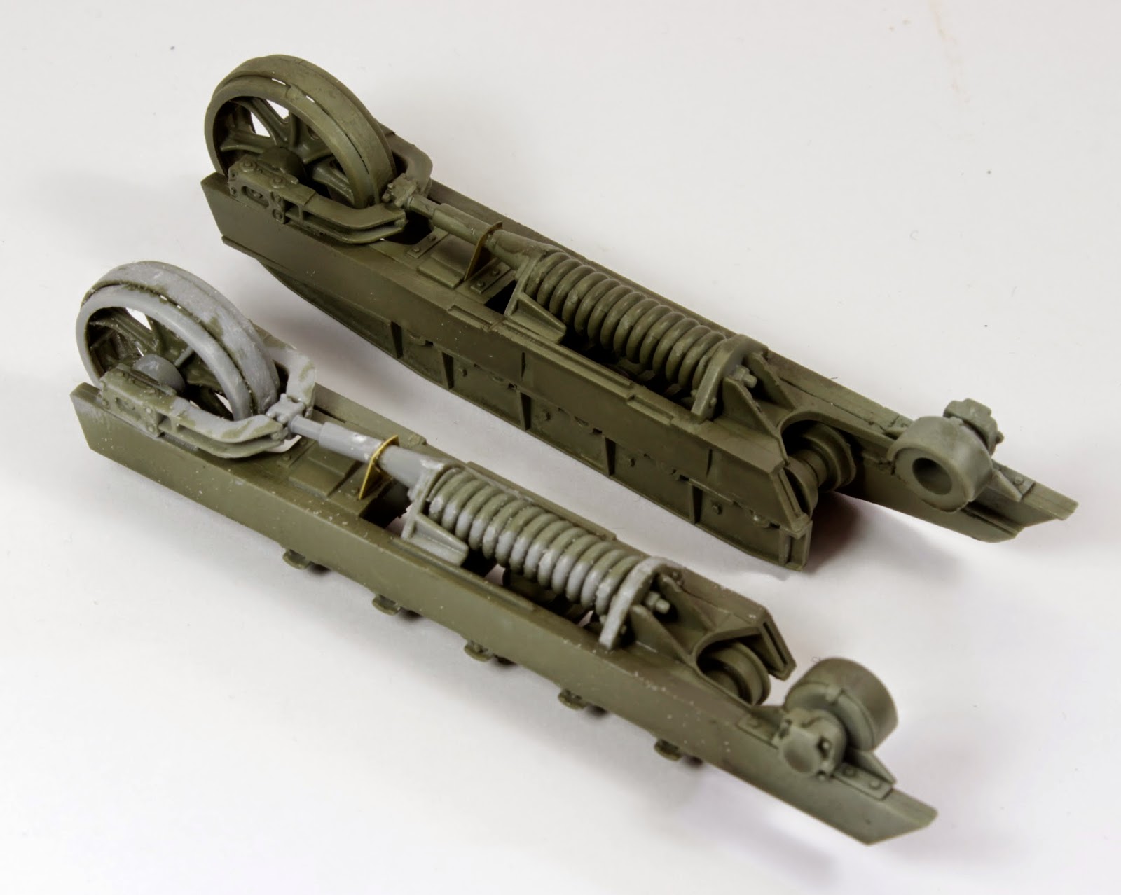

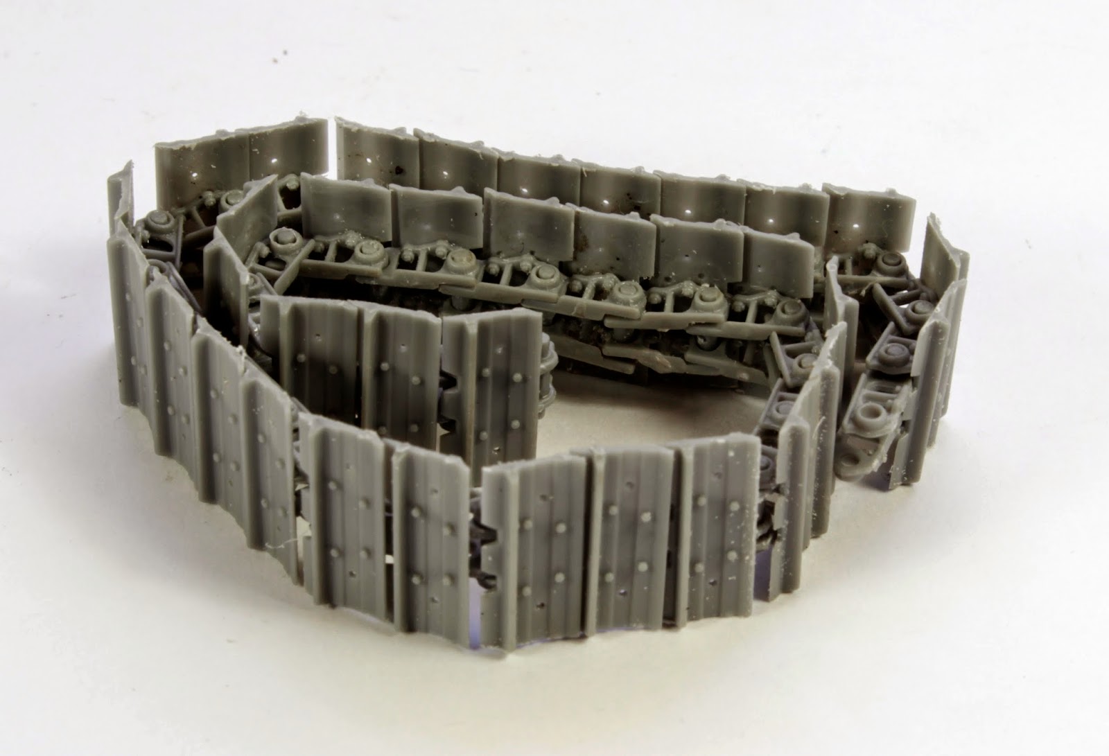

The tracks is the most boring part of the building, each link is made out of four pieces that you must align properly and fix with car in order to let them articulate and move freely. This process will allow us to palce them perfectly atthe boogies and reproduce the typical sagging on the upper links.
After painting all the parts with the olive drab primer, I applied some filters with the airbrush with lighter tones to produce some lights.

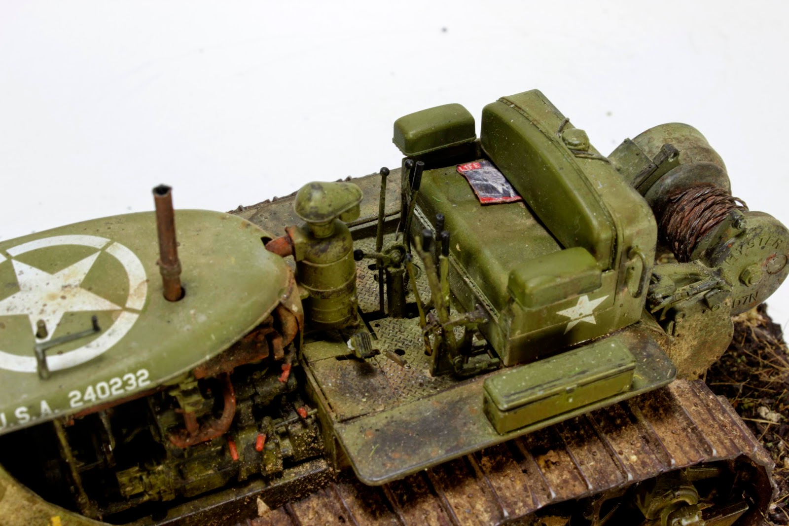

I painted the chipping with a mix of dark brown and black colours using the stencilling technique.

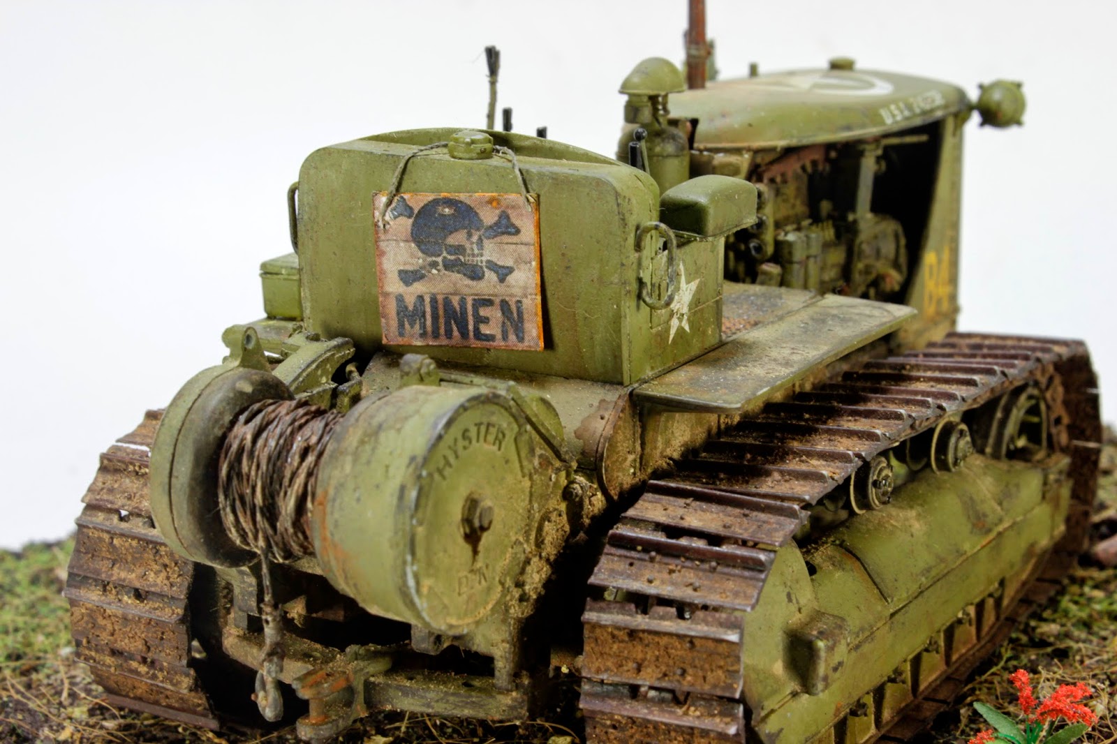

For the towing cable I used one made by myself with copper wire twisted with the Dremmel tool.

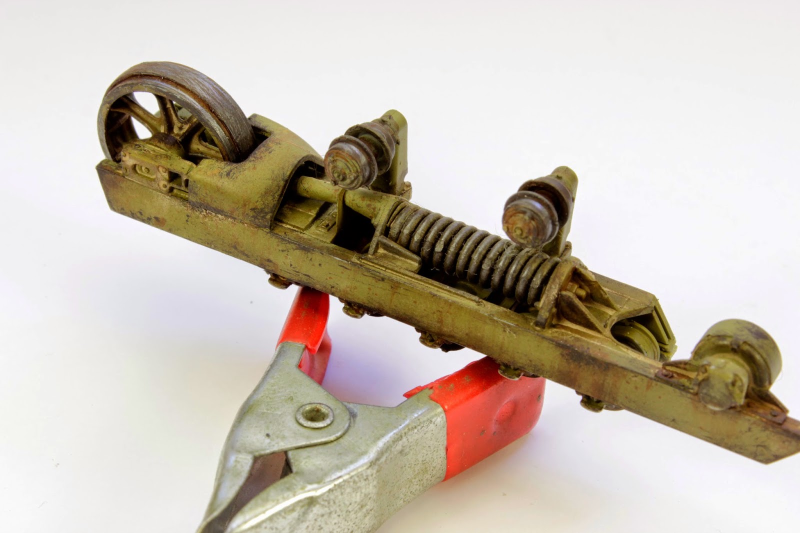

I used many pigments over an acrilyc wash moistened surface to create a rust texture and colour look.

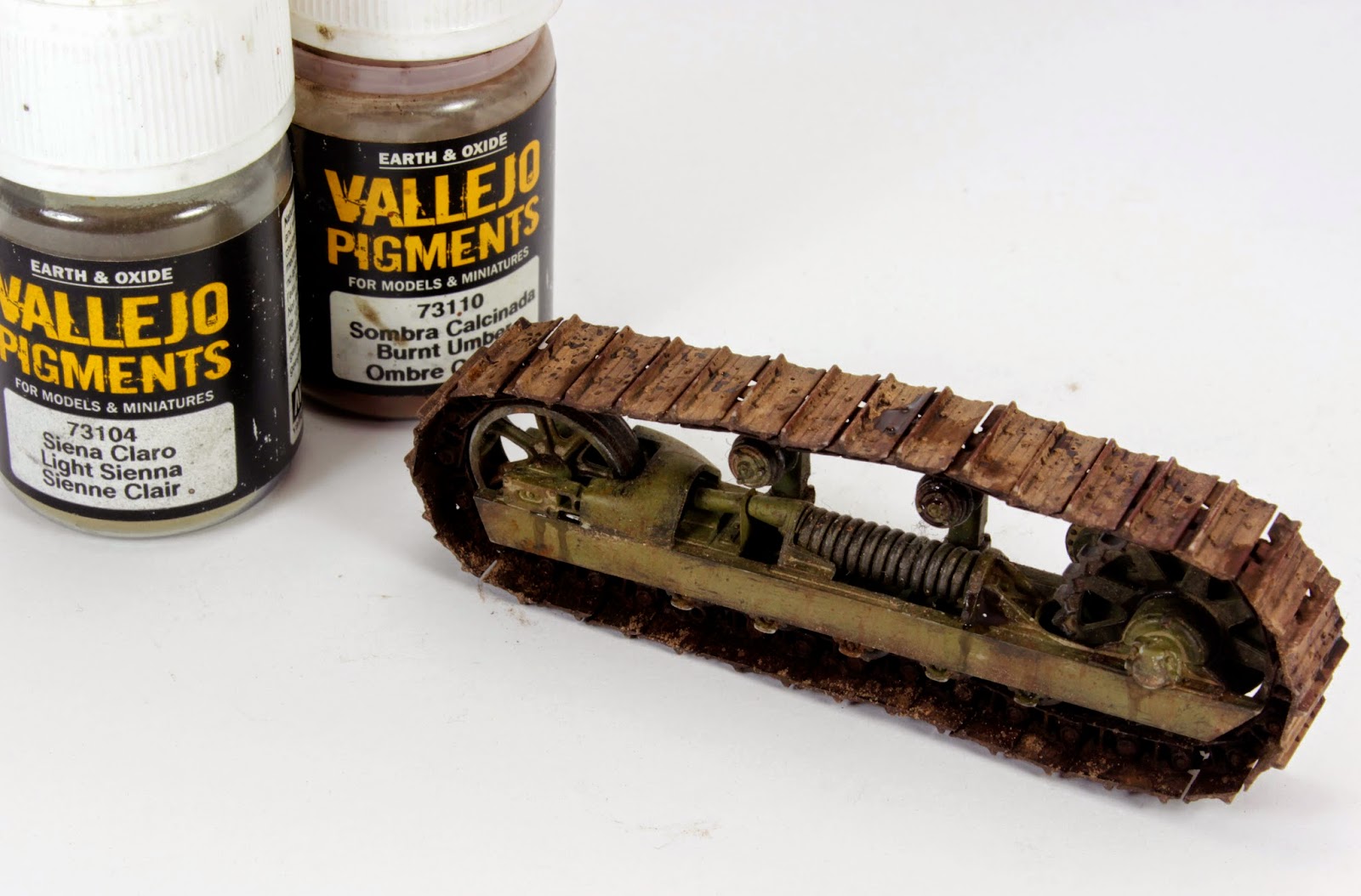

The graphite pigment is perfect to imitate the polished metal.
The accumulation of different earth colour pigments is perfect to imitate a dry mud texture overthe tracks, just fix them with white spirit or ant special pigments fixer.

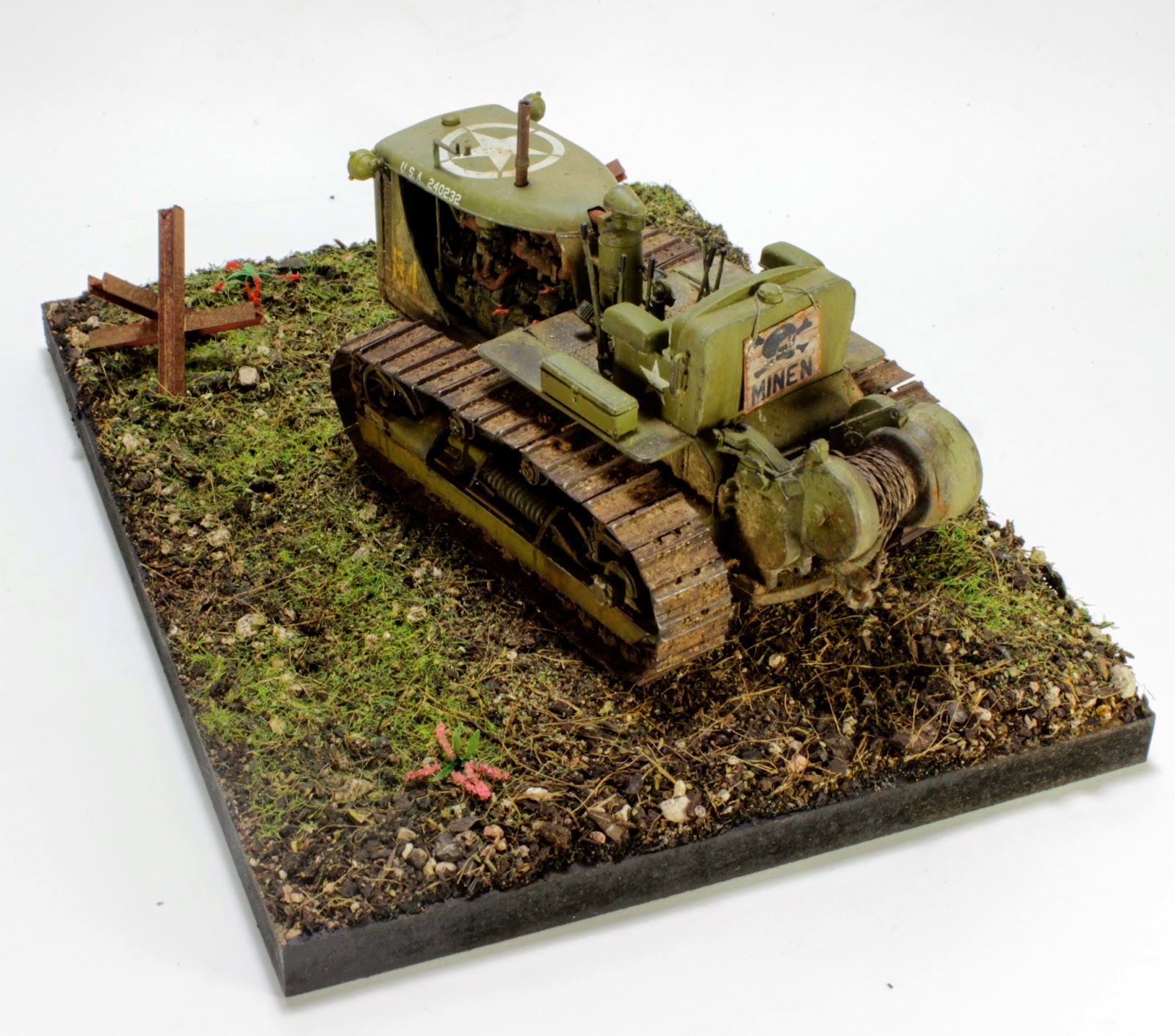

I added a Life magazine and a "mines" wood sign to break the general olive drab tone and created a simple base with a couple of anti tank obstacles to show the finished model.
That is wonderful looking. Nice wear and tear and heavily used look and taking us all through the process
