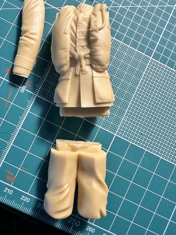

Good morning. As noted in the title this is my first attempt to assemble and paint a 1/16 scale resin figure. I have spent one hour looking for a video on how to remove those big blocks of resin on the upper body and the lower body surfaces to be joined. Do you simply sand them off? Would someone be kind enough to point me to a video on how this is done?  These figures come with no instructions.

Those blocks are called pour plugs from when the mold gets filled with the liquid resin.
Most times you can simply use a model saw to cut it off. Some even use a dremel with a flat cutting blade.  However you choose to cut it, I would recommend to go at it from a few different directions to make sure your final result is flat. This will save you a lot of time filling and sanding.
I would be remiss is I didn't mention to protect yourself from the dust. It's been reported to be nasty stuff especially if it turns out you're allergic. Wear a mask or have some sort of shop vac nozzle set up to suck up the dust. If you have neither, keep the model part to be cut wet. That will help keep the dust from flying around.   HTH  And let's see you figure when you get finished.
For large pour plugs on flat parts I have used a Dremel belt sander. You need to go slow and check your work often, but it sure does make short work of it. I get it down to where I can hand sand the remainder so I don't go too far with the power tool.
