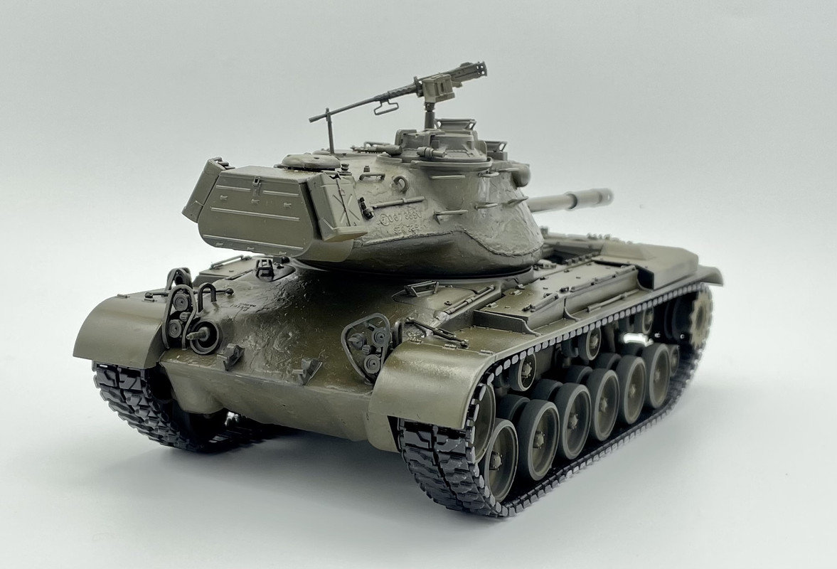

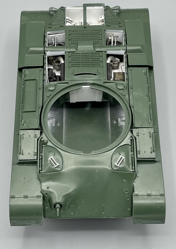

Stikpusher Posted February 24, 2021 Author Report Posted February 24, 2021 Wash on and cleaned up, then power pack installed. and what will be visible.... Time to get this one moving forward past this stage. 1

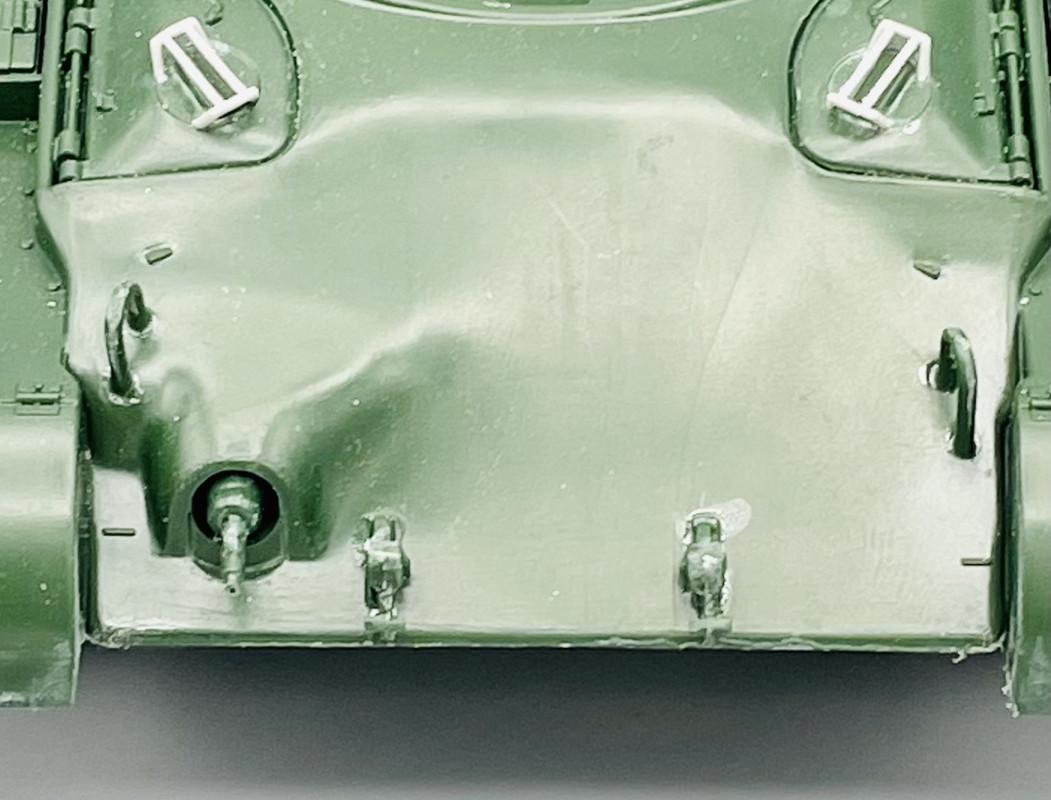

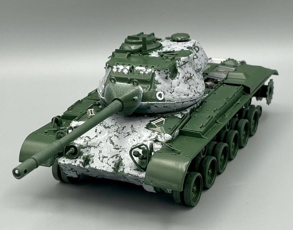

Stikpusher Posted February 24, 2021 Author Report Posted February 24, 2021 Today I got the upper hull glued in place. Starting to look like a tank now! I need to deal with one seam on the bottom rear and then I can add all of the last little bits to complete the hull 1

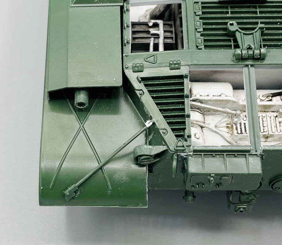

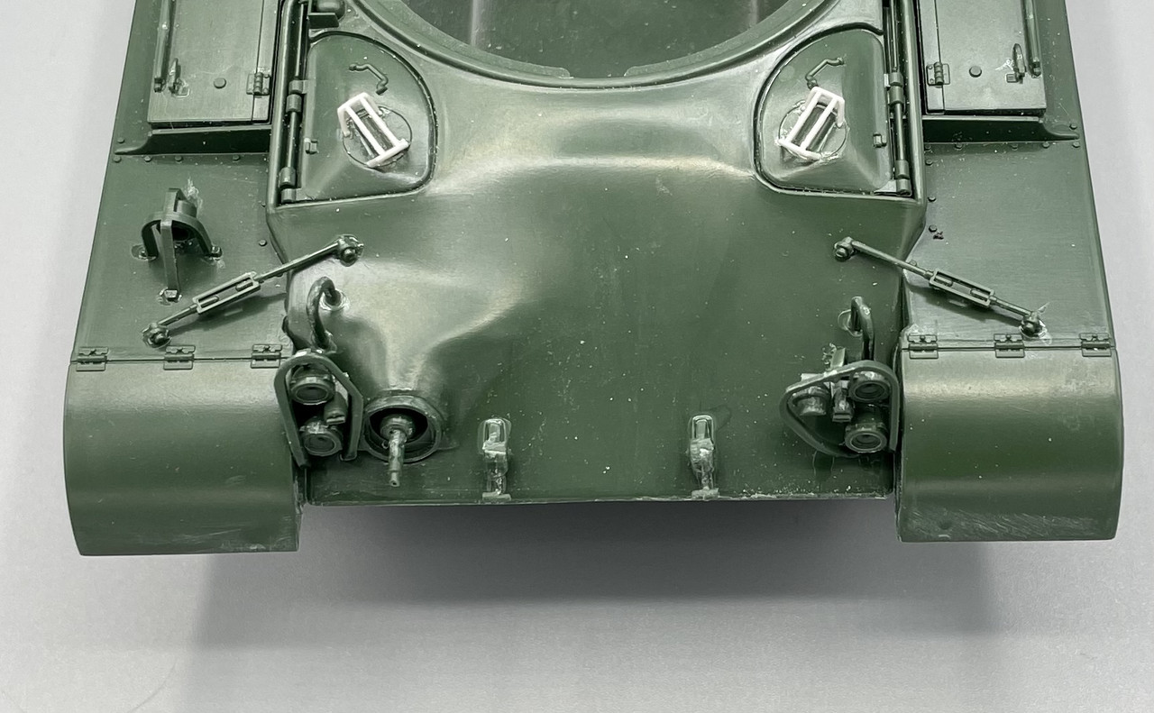

Stikpusher Posted March 17, 2021 Author Report Posted March 17, 2021 I finally finished all the basic construction on the hull. It was pointed out to me elsewhere that the hull attachment point for the rear fender braces was inaccurate. So I modified them to look more like the real thing. And I added all of the little bits to the front of the hull Now I just need to add the cast armor texturing and casting marks to the hull 1

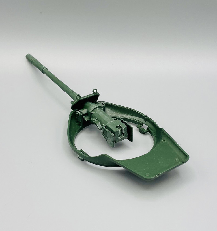

Stikpusher Posted March 18, 2021 Author Report Posted March 18, 2021 Small progress on the turret. Over the past few days I assembled the main gun, sanded the seams smooth then installed it into the turret bottom And today I airbrushed the turret interior white... I just need to paint the breech block steel, sand off the paint on the surfaces to be glued, and assemble the turret halves... then this will start looking like a TANK! 1
Stikpusher Posted March 19, 2021 Author Report Posted March 19, 2021 Well, I just had to forge ahead this morning.... Breech block painted steel. Not sure if it’s accurate or not for the M47, but I like the look, and I’ve seen it before on other types. Besides, the turret hatches will be closed and no one will see it... Then I glued the upper and lower turret halves together and well, I just had to fit it on the hull Now it looks like a tank! Next up, adding all the little bits to the turret before the cast armor texturing 1

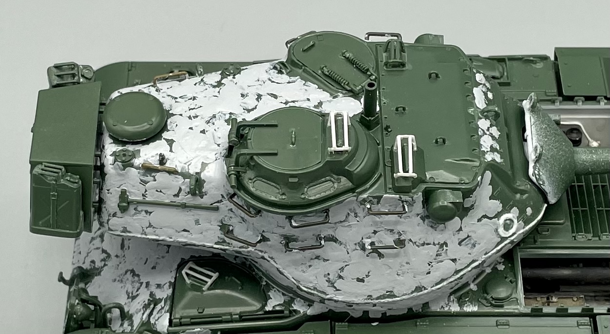

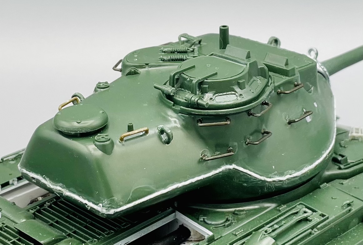

Stikpusher Posted March 26, 2021 Author Report Posted March 26, 2021 So more work on the turret this week. Firstly I puttied up the points where the cargo rails attach, since I won’t be using the kit parts. I also added some very thin rod styrene along the seam line where the turret halves go together to replicate the weld seam on the real turret. Today I sanded the putty smooth and using some “hotter” plastic cement and my finger nail to texture the weld seam bead. 1
Stikpusher Posted March 27, 2021 Author Report Posted March 27, 2021 Yesterday I added on the early style grab rails on the turret sides using parts from my spares bin. Now I just need to add the rod frame type guards on the commander’s and gunner’s sights and the backdating of the turret will be completed. Next up, cast armor texture. 1

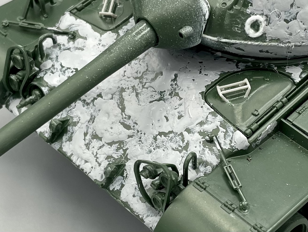

Stikpusher Posted March 31, 2021 Author Report Posted March 31, 2021 (edited) A little more progress to post. Over on Armorama, it was pointed out to me that the turrets had some external “dimples” welded into the armor where the gun trunnions attach to the turret sides. So I cut some small pieces of tube styrene and glued them into the appropriate spots Then I sanded them to a more scale thickness, doused them with liquid cement, and gave a bit of weld texture around the edges with a toothpick. Now I can proceed to adding the cast armor texture where needed... nearly all of the turret and much of the front and rear hull... Edited March 31, 2021 by Stikpusher 1

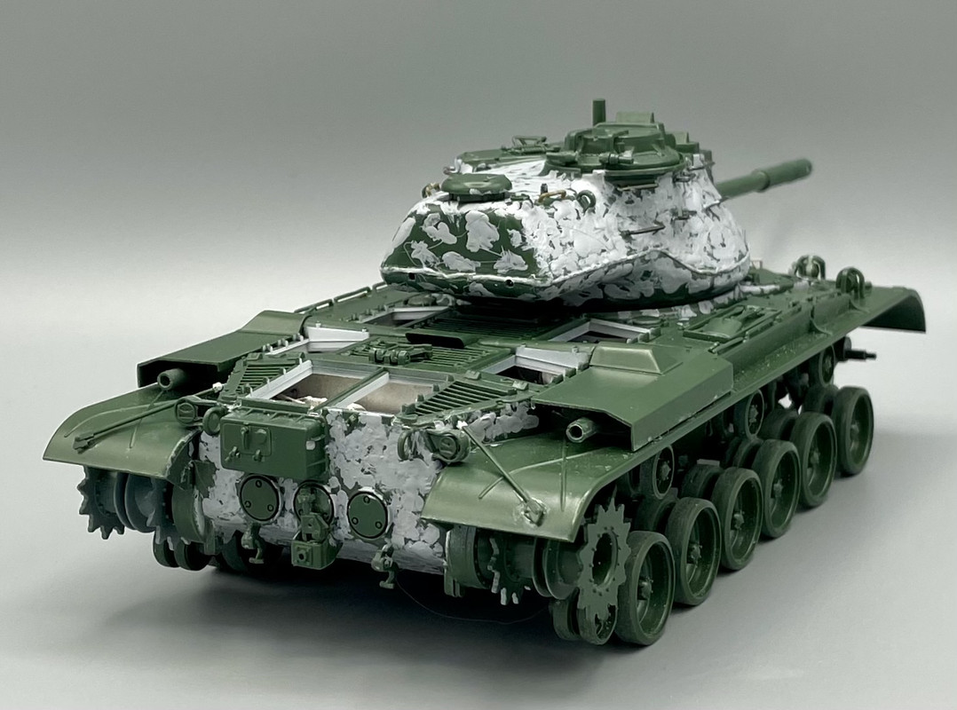

Stikpusher Posted April 1, 2021 Author Report Posted April 1, 2021 One more update- I finished adding the cast armor texture a bit more rapidly than I thought that I would using Mr Surfacer and a Microbrush. and a couple close ups it should look good under a coat of paint... This will be my last update on this until next week. Have plans for the weekend, so I won’t get any bench time. 1

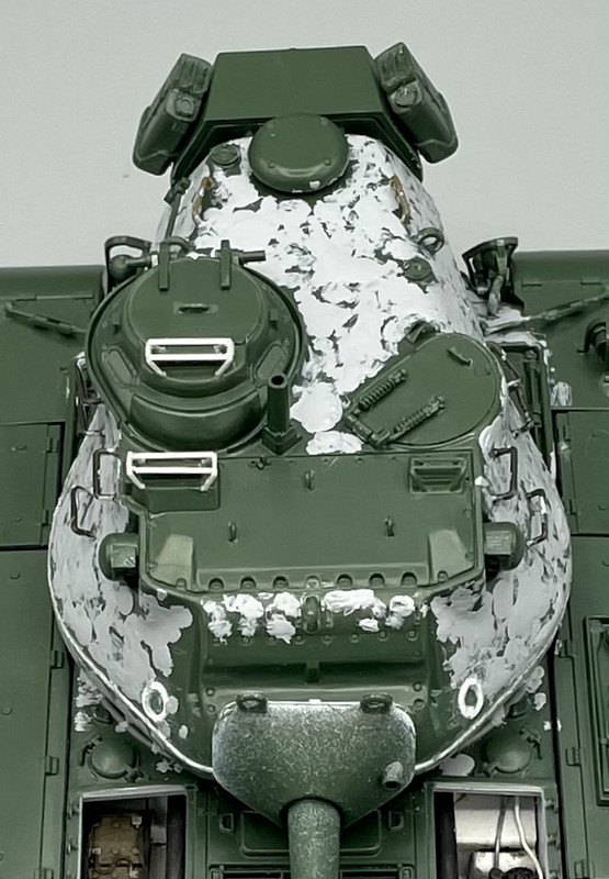

Stikpusher Posted April 7, 2021 Author Report Posted April 7, 2021 Well, the back dating of the kit is now complete. I added the wire cage style brush guards to the commander’s and gunner’s periscopes, modified the sledge to reverse its positioning, and then added the hatch handles, rangefinder housing lifting eyes, and rear turret stowage bin. All I need to do now is add the mantlet dust cover and armor foundry casting marks 2

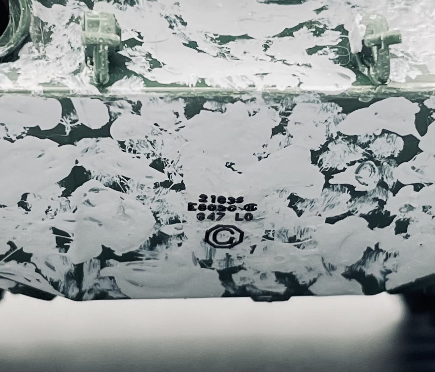

Stikpusher Posted May 3, 2021 Author Report Posted May 3, 2021 I had a mishap while adding the casting marks on the first go, so I stopped, ordered some Archer raised resin decals and awaited their arrival before resuming work. Monday and back in action with this one. I added some Archer raised resin decals casting marks to the turret and hull. We shall see how they look under a coat of paint soon. Yeah, these are for a Sherman, but most likely only a M47 fanatic would know that they are not proper for a Patton 1

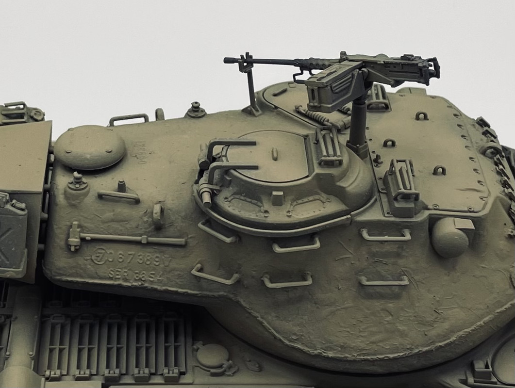

Stikpusher Posted June 18, 2021 Author Report Posted June 18, 2021 Woohoo! Olive Drab applied! I used Mission Models FS 33070 version of OD on this one. In all honesty, the more that I airbrush Mission Models, the less that I like them. Maybe it’s the dry climate here, but I get far better control and results with most every other brand. Anyways…. and some close ups of the casting texture and marks decals under the paint More to come in a few days… 1

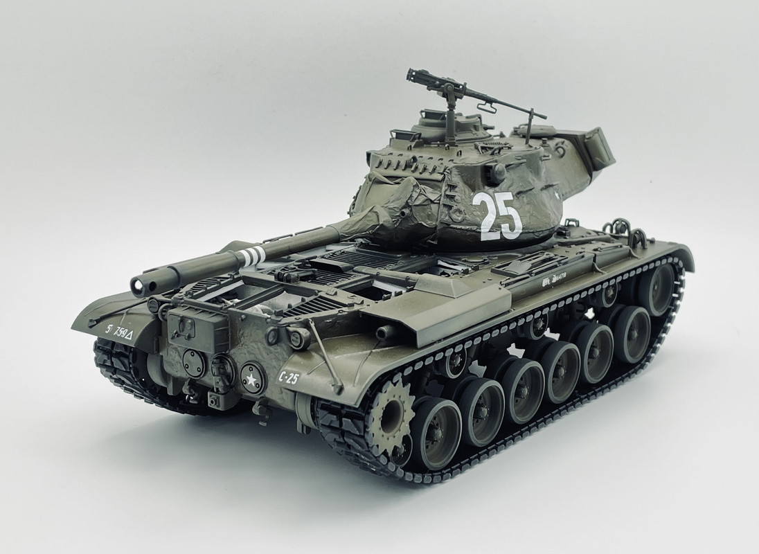

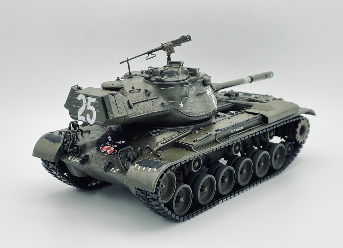

Stikpusher Posted November 6, 2021 Author Report Posted November 6, 2021 Well, after sidelining this one in the mid summer due to life going on, I knuckled down on this one and wrapped it up over the past few day. Calling this done for now until I can whip up a proper base, a figure, and perhaps a few more additions. 1
