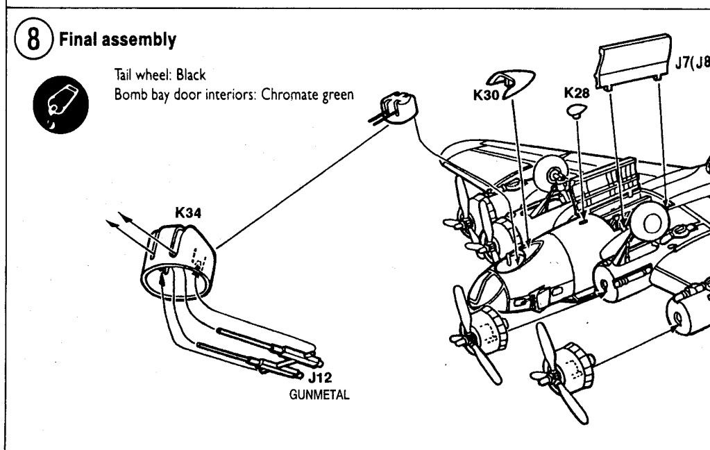

Here is a scan of the appropriate page. I'm looking at how to attach K34 without cement (that's what the black squares mean). There is a spigot point on the model as shown in the drawing, but nothing to attach it to.
Rob.

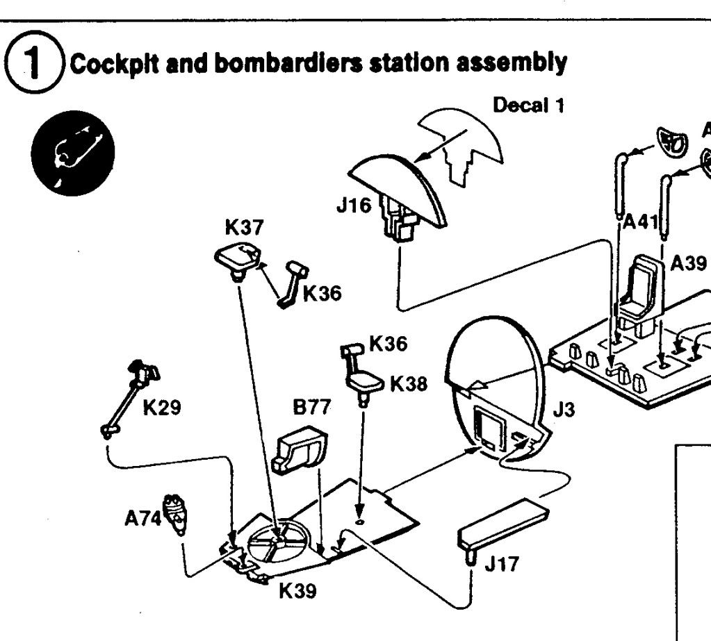

I'm looking at the instruction sheet for Academy B-17G Kit #2143 from 1995. In Assembly #1, the bombardier's floor piece is K39. At the nose end, there is a recessed disk in the floor the diameter of the chin turret, with a pair of cross braces and a raised center with a hole in it to accept the mounting pin for the bomb aimer's seat (K37). Thus, the bomb aimer sits directly over the center of the chin turret below. On the underside of this floor piece K39 is a pin approximately 3/16-ths inch long dropping down from the center of the raised circle (the circular locator for the turret piece K34). The purpose of the pin is not to permit the turret to turn, but it traps the twin machine-gun part J12 into position inside the turret and allows the guns to move in their slots.
The chin turret K34 and guns J12 are mounted to the fuselage in Assembly #8. If the kit is not designed to have a slight force (or snap) fit of the turret to the locator ring under the floor so you can position it wherever and whenever you want, you will have to pick a direction and glue it into a permanent location. Sorry, it won't be the swivel mount you want. I did not check my SB-17 kit because others have done so. Good luck with the rest of your build. Post some pictures.

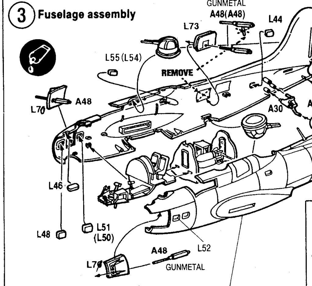

I was not ignoring you. I've had a special project that pretty well took up all day Wednesday and Thursday. Here are three scans from the Academy B-17G kit instructions showing the parts involved with the chin turret. The first is Assembly #1 with the bombardier's floor from the top side.
Next we have Assembly #3 showing the completed parts from Assembly #1 being attached to the right fuselage half. Note the pin for the lower chin turret guns is shown.
Finally we have Assembly #8 with the chin turret assembly (insert guns into turret) and then attaching the turret to the raised locator circle under the bombardier's floor.

No problem at all, thanks for getting back to me. Steps 1 and 3 are virtually identical to the Airfix/Academy kit that I have. Step 8 differs in the detail for attaching K34 and J12 to the underside of the fuselage. Your instructions clearly do not show any indication of the ability to rotate the turret while mine clearly do, yet the component pieces are identical. If my instructions did not have the 'no cement' squares I would have happily cemented the chin turret in place (which is what I will do now).
