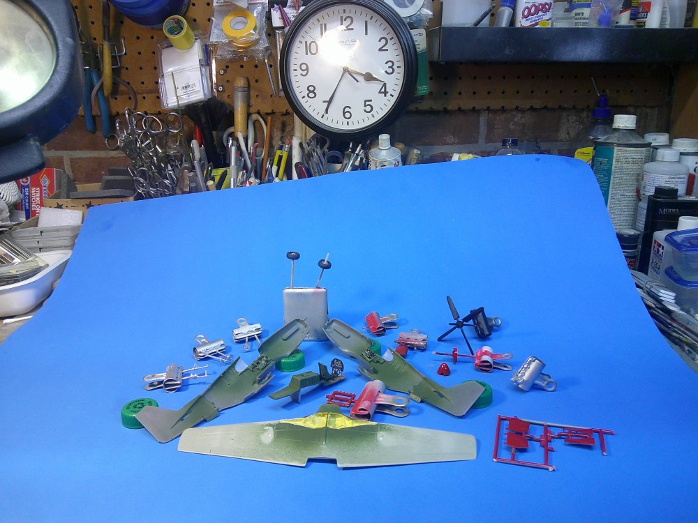

This where things stood at 3:35am. The very first thing that was done was to spray rattle can Tamiya Interior Green wherever needed (and the overspray would later cause problems!). I used the Tamiya paint because it would dry very well in an hour or less. In the meantime I assembled the wings and painted the interior parts. I also used acrylic brush paint for the details since it wouldn't interact with the paint it was going over and I could proceed faster. Note some of the parts have already been painted rattle can Tamiya TS-8 Italian Red.

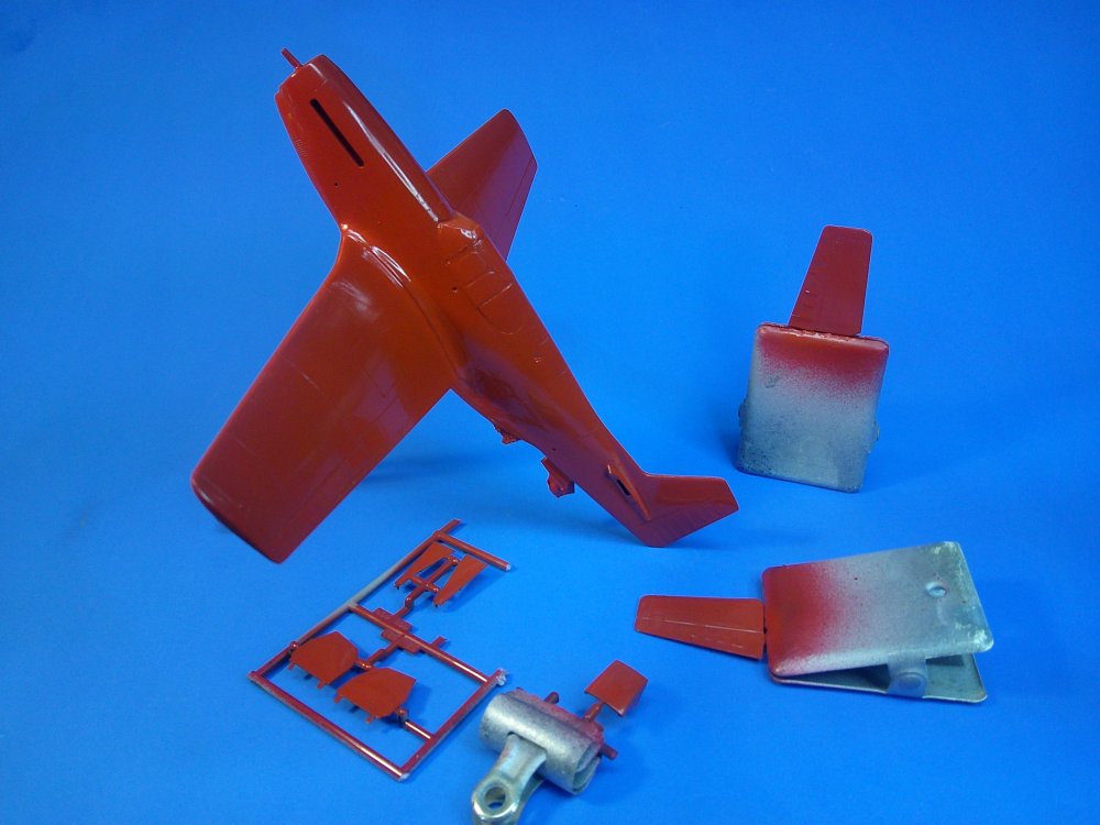

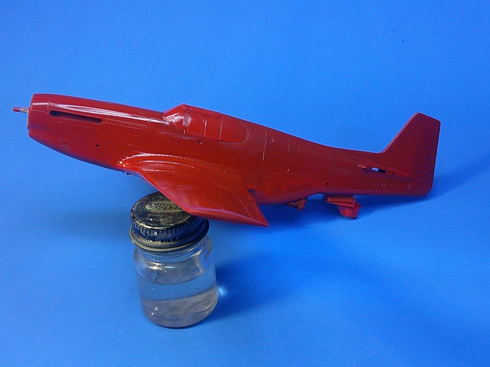

I sprayed the model at 5:30am with the Tamiya rattle can TS-8 Italian red. Unfortunately this is where I ran into problems. The different colored plastic made for a tonal mis-match between the wings and fuselage. The green overspray on the bottom also caused tonal problems. I tried spraying more paint on the model to try to even it all out and then ended up with some runs behind the wing roots. At this point I went to bed to get some rest and let the paint dry.

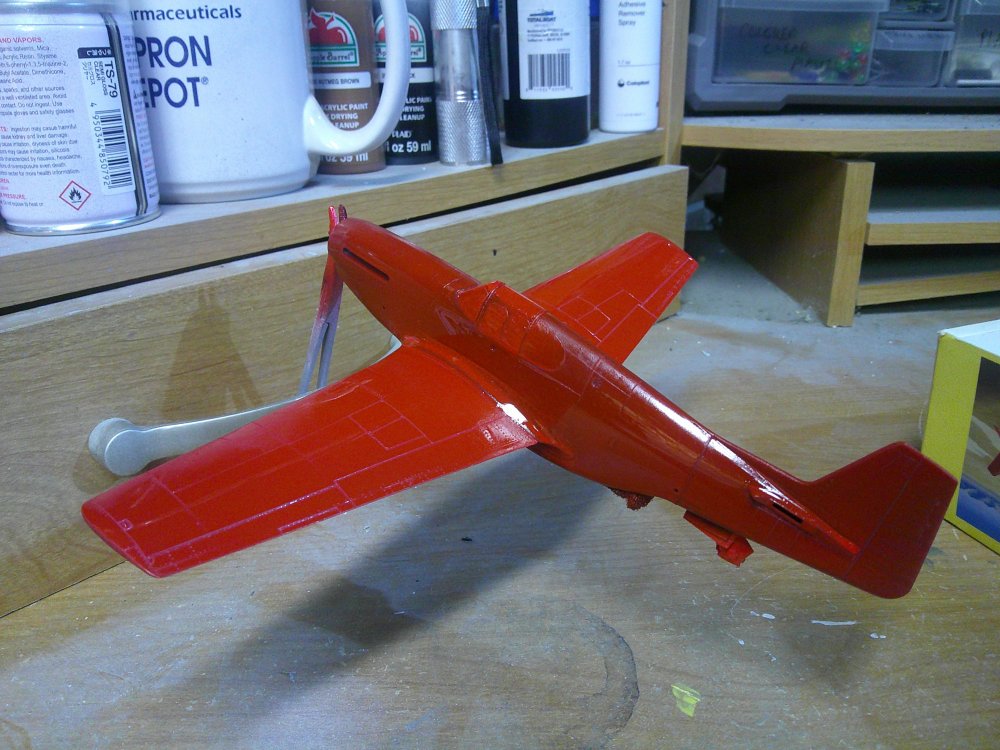

Got back to work about 2pm and shortly afterward had airbrushed the entire model with Testors Gloss Red (cut with lacquer thinner) to fix the paint problems and even out the coloring. I then stepped away to let it dry for 5-6hrs.

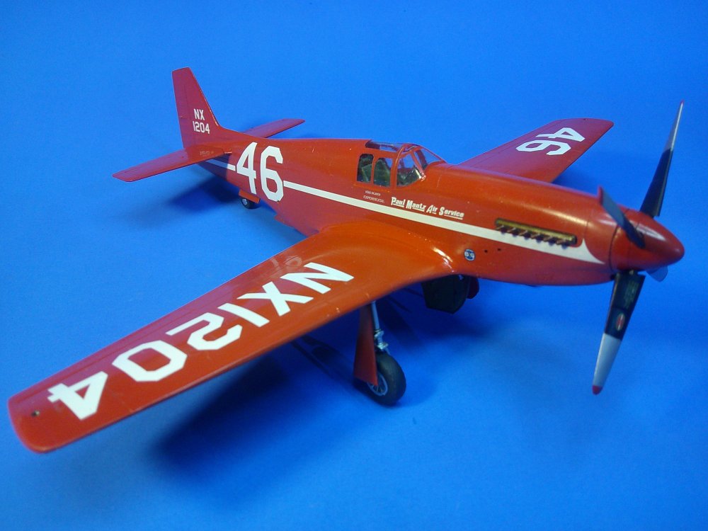

Got back to work about 8pm and by 9pm had all of the decals on. Stepped aside for an hour or so to let them set and dry.

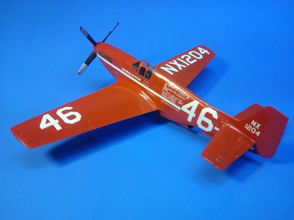

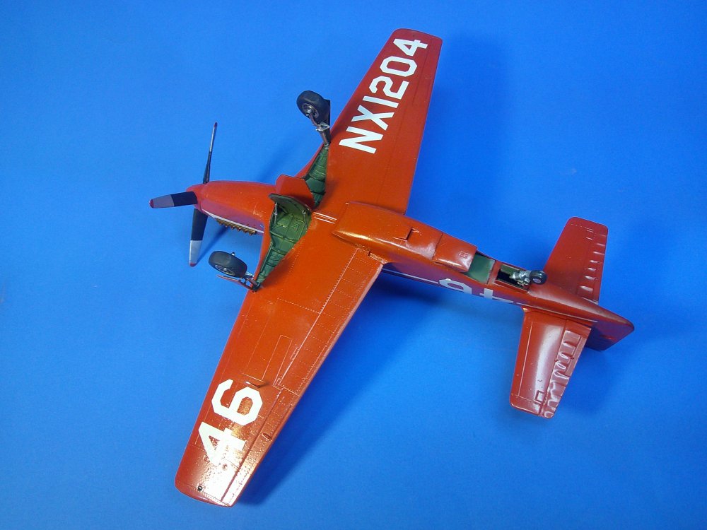

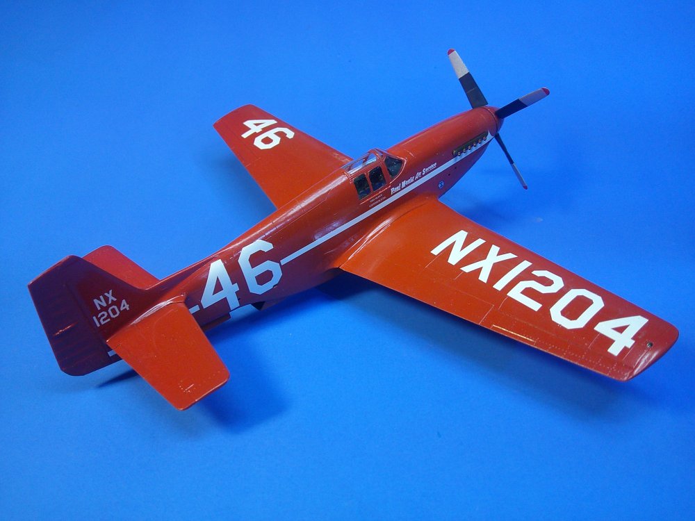

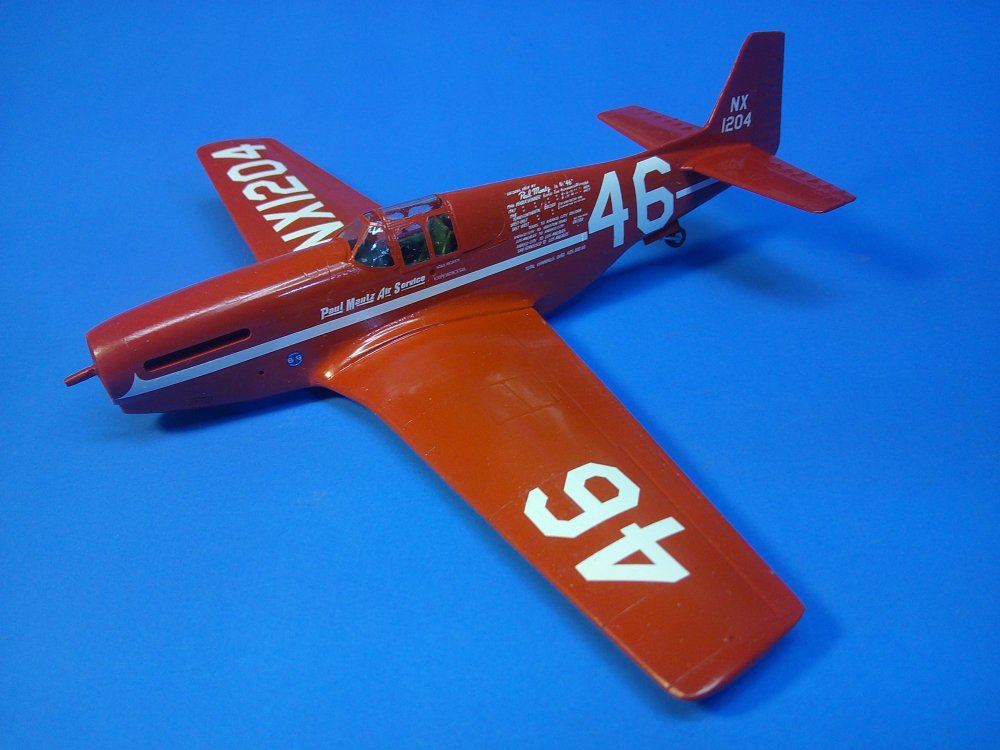

Finished adding all of the final parts and detail painting of the lights, etc. at 11:13pm for a build time of 23hrs-10mins. It would have been 5-6hrs faster if I'd avoided the paint problems!
All in all I'm very happy with the result. More importantly, there's one day down and one model completed for 2026! On to the rest of the year.  🙂
You are a trooper. By the time you started this model, I had been in bed and asleep for hours. I hear you about the color mismatch thing. Yellow and Orange are also prone to this. To try to avoid it, I undercoat with either light grey or white, depending on how I want the final color to come out. I know you know this and am wondering why you didn't do a quick coat of Tamiya White primer as it dries very fast and wouldn't have impeded your progress. In any case, you turned out a very nice model.
 You are a better man than I Gil! For a one day build, that Stang turned out great!
