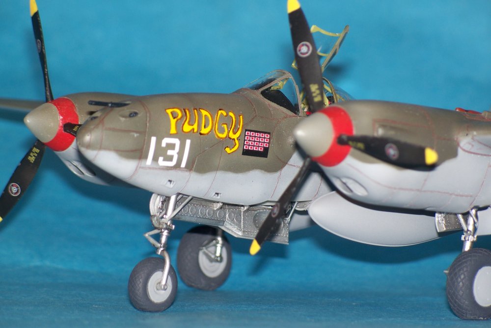

A recent example of my using a fine tip black Sharpie was to create the letters for "Pudgy" on yellow decal paper. I lightly drew them in with pencil, then traced that with the Sharpie to create the letters, and then carefully cut each letter from the decal sheet for application. Not perfect, but faster and easier (for me) than doing a bunch of copy/paste/photoshop/print work with a computer.
