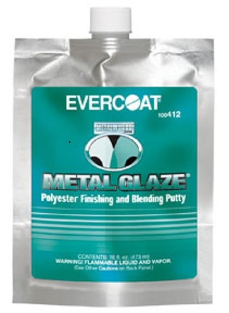

PeteJ Posted September 13, 2018 Report Posted September 13, 2018 (edited) I have used Evercoat glazing putty for years but it has a couple of issues. First you have to buy large quantities and second, over time it gets thicker and harder to get out of the container. I recently found this in a pouch and really like it much better. First off, it is about the viscosity of a milk shake coming out of the container so it fills small spaces very well. Second being in a pouch, it seems to store well and not thicken like the other stuff. It is a two part so you do have to mix it. I use a 4"X4" ceramic counter tile to mix it on. It won't stick to tile so it is easy to clean off. It hardens quite quickly so you can get on with the work. Depending on the amount of hardener you put it it you have about a 5 minute open time. It is sandable in less than 30 minutes. It feathers out very nicely and fill spots don't ghost back through even when using lacquers. Last, it is about $15 for 12 oz. which is a lifetime supply. Oh and if you do get it, one thing I have learned. Put the catalyst in a glass jar. Over time the catalyst will cause the plastic tube it comes in to harden and crack. The old small square model enamel bottles are about the right size for one tube. You can get it on Amazon but because it is flammable the shipping kills the cost. One last thing, you have to go to a professional auto paint store to find it. It is ok for me because I get a lot of stuff for modeling there. Edited September 13, 2018 by PeteJ
