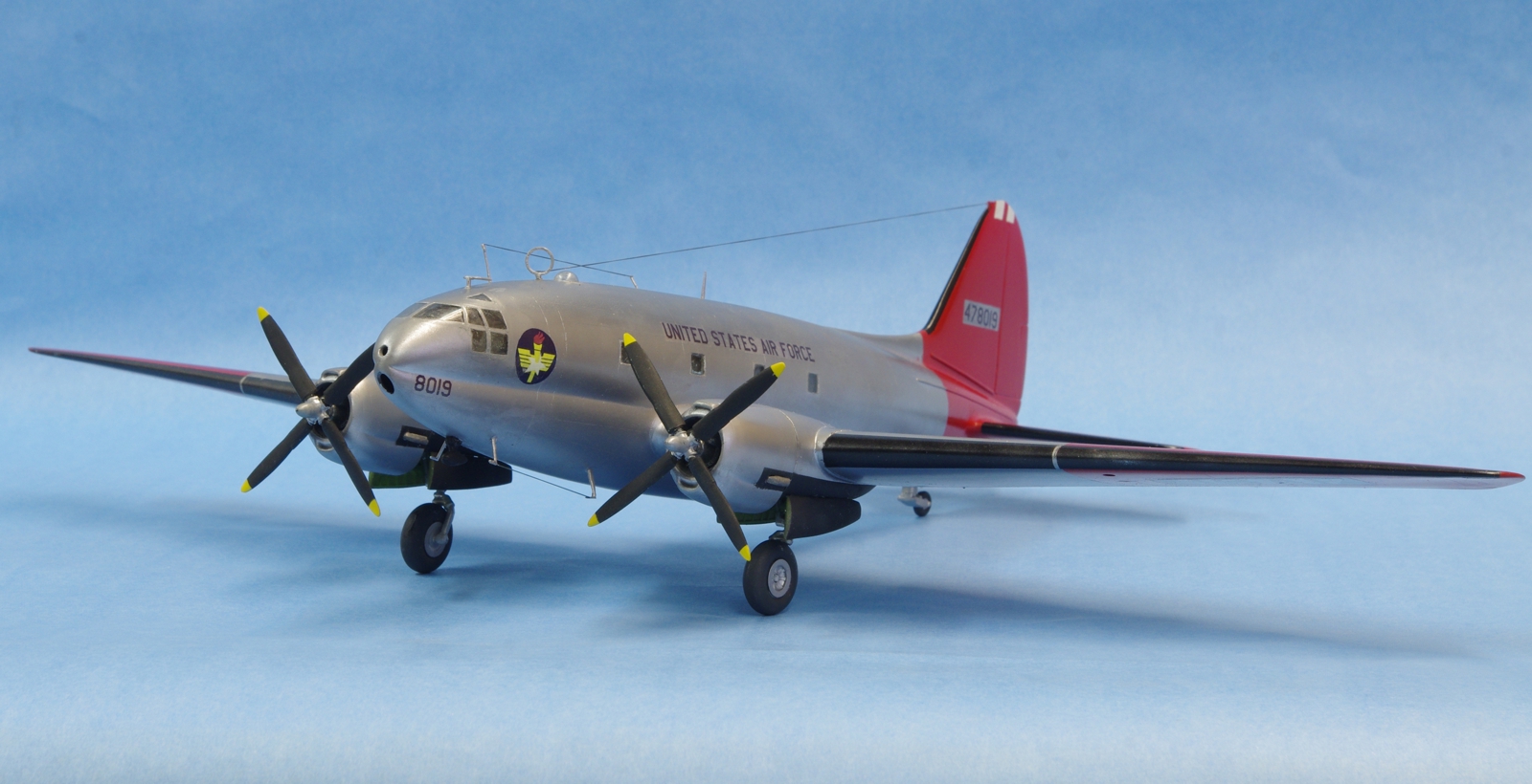

I thought I had already given a link to my build log but here it is, and a picture from it. I made the decals using Corel Draw and an ALPS printer.

Hey John,
Your C-46 is a dandy. Very nice effort. I'll be using a vac canopy as required by my client. The photoetch is still available from the company's website (http://www.maestromodels.com), as well as ebay and a number of other online sources.
