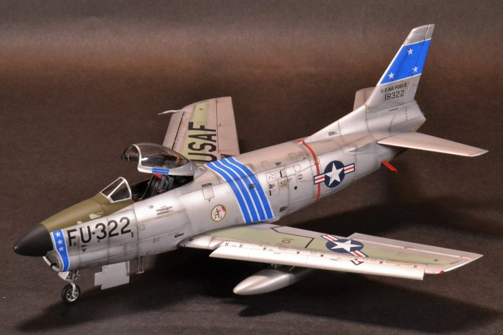

After Vallejo Clear Satin has dried, I ground up artist black charcoal over fine sand paper. Then using a flat thin brush, I picked up a small amount and lightly brushed it over the panel lines. The residue from the charcoal fills into the cracks and panel edges. Apply lightly and repeat application for darker shaded results. You may lose some of this panel shading with applying the final flat coat. If so, just reapply the charcoal. Good Luck.
I use Alclad White Aluminum. Next, Future coat for decaling prep. After that, Vallejo Clear Satin to protect the decals. Do some subtle weathering and then spray AK Ultra Matt Clear to seal in it all. Picture is a 1/48th scale Revell F-86D Sabre Dog.
