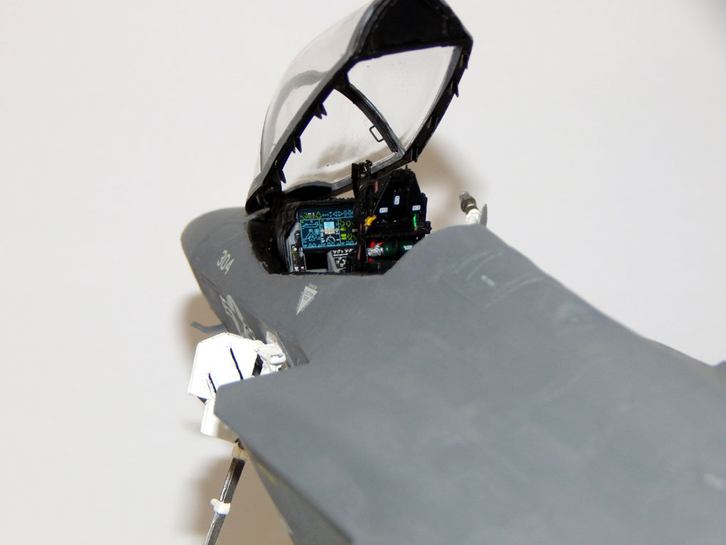

Wolfman63 Posted April 3 Report Posted April 3 This is the Kitty Hawk 1/48 F-35C. I will be using Red Fox 3D decals, Reskit resin exhaust, Furball decals for the VFA-86 scheme, and I also added the Eduard 3D Brassin ejection seat. I started off with the cockpit as usual. I cleaned up the panels to prepare for the Red Fox 3D decals. These look great and fit perfectly on the instrument and side panels. The decal set has the option of the instrument panel display “on” or a blank screen for the “off” mode. I looked at the kit ejection seat and it is not very well detailed. I researched this kit and found some folks noted the kit ejection seat is too tall and if you wanted the canopy closed it will not close because of the seat. I opted to use the Eduard 3D brassin ejection seat. The seat is very detailed and the instructions also offer other details that can be added. Care is required to trim the parts off of the carriers as they are very delicate. There are eleven different parts as well as a sheet of photo etch and decals for all the warning placards. I am currently finishing up the cockpit assembly and details then moving on to the nose gear bay and then the weapons bays. You can see all the photos and details from the start in the build log at: https://davidsscalemodels.com/build-log/1-48-f-35c-vfa-86-sidewinders/
