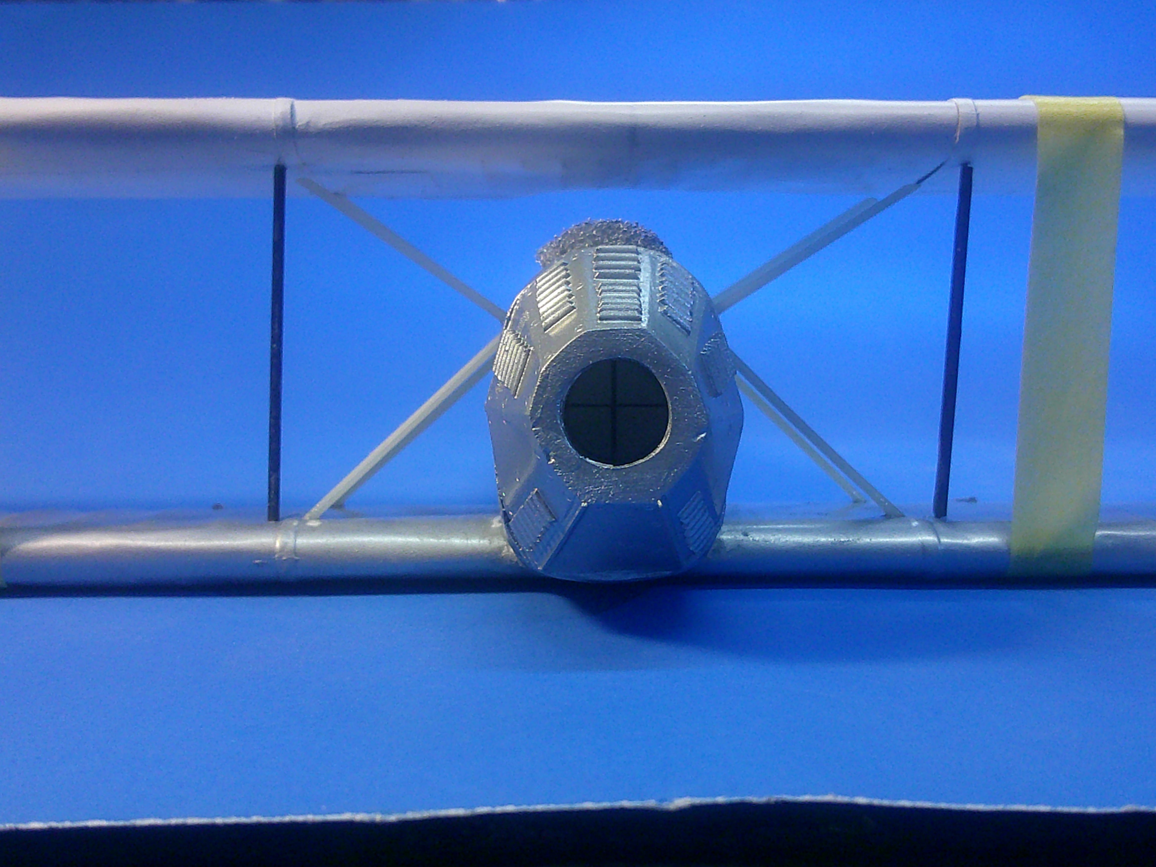

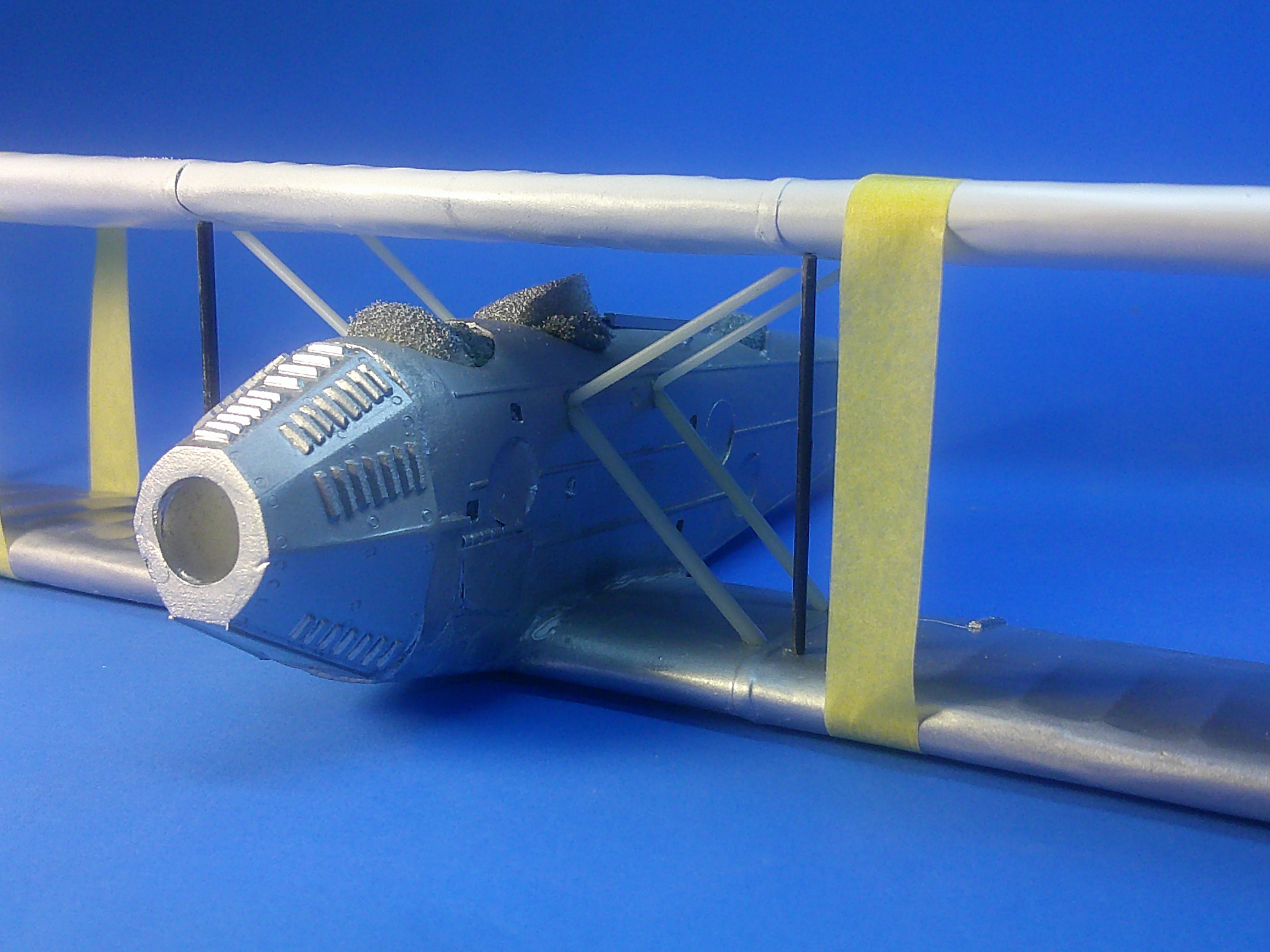

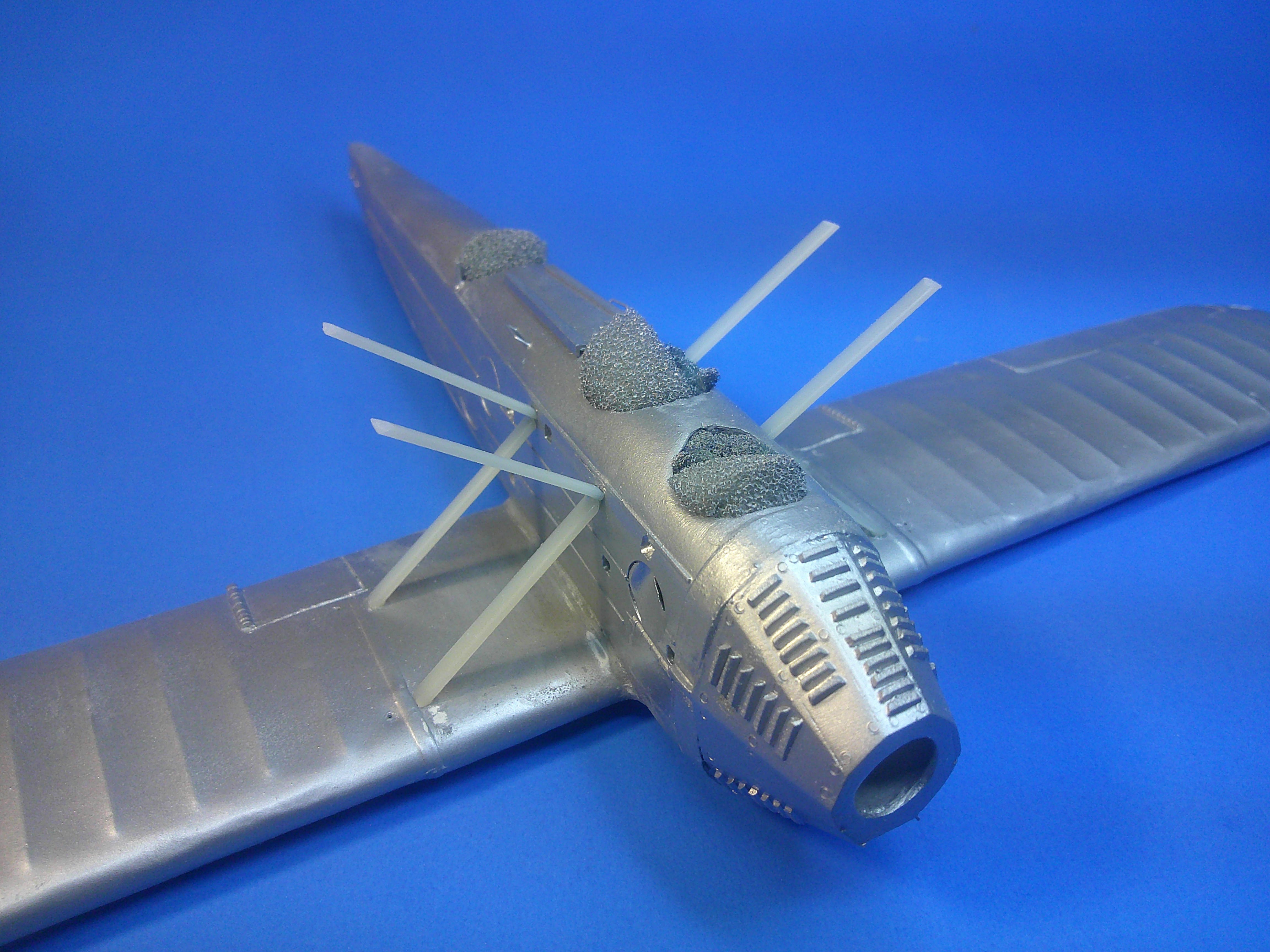

I got 2 more important steps completed today.... I added the vent louvers to the nose and also vacked and built up the engine crankcase cooling cover.
I cut 1/4 round strip plastic pieces to as consistent a size as I could and then placed each one individually.
There's more than 50 louvers on 7 of the nose panels.
Note the the very top nose panel is the only one with a slightly different pattern to its louvers.

I've since also primered the louvers on the nose. Getting close to gluing the fuselage to the wings. More pics after it starts resembling an actual model airplane!

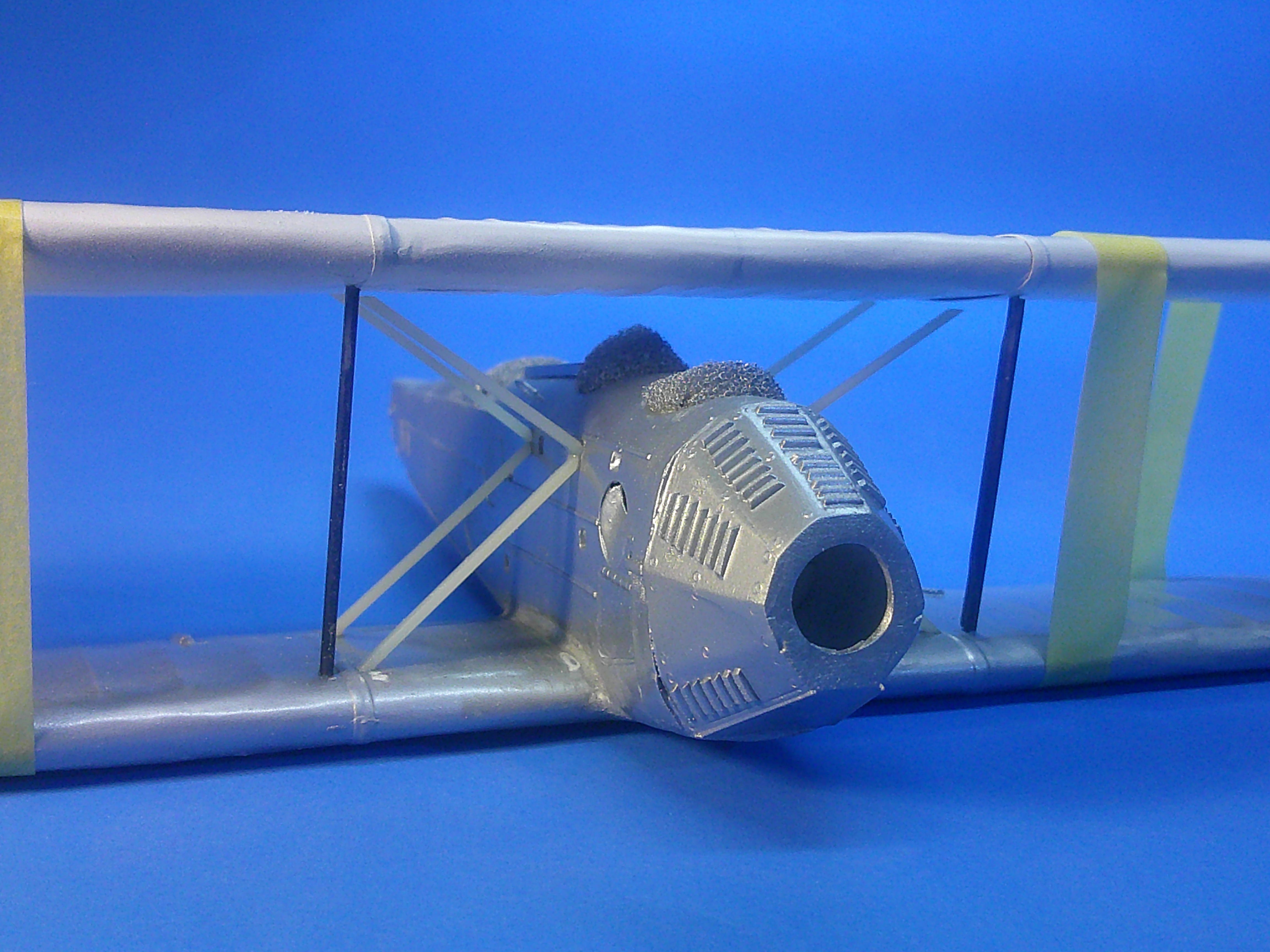

Still have a good amount of engine detailing to do too..... but I may just go ahead and get the fuselage glued to the bottom wing just so I can take something resembling an airplane to our model meeting Saturday! More pics then!

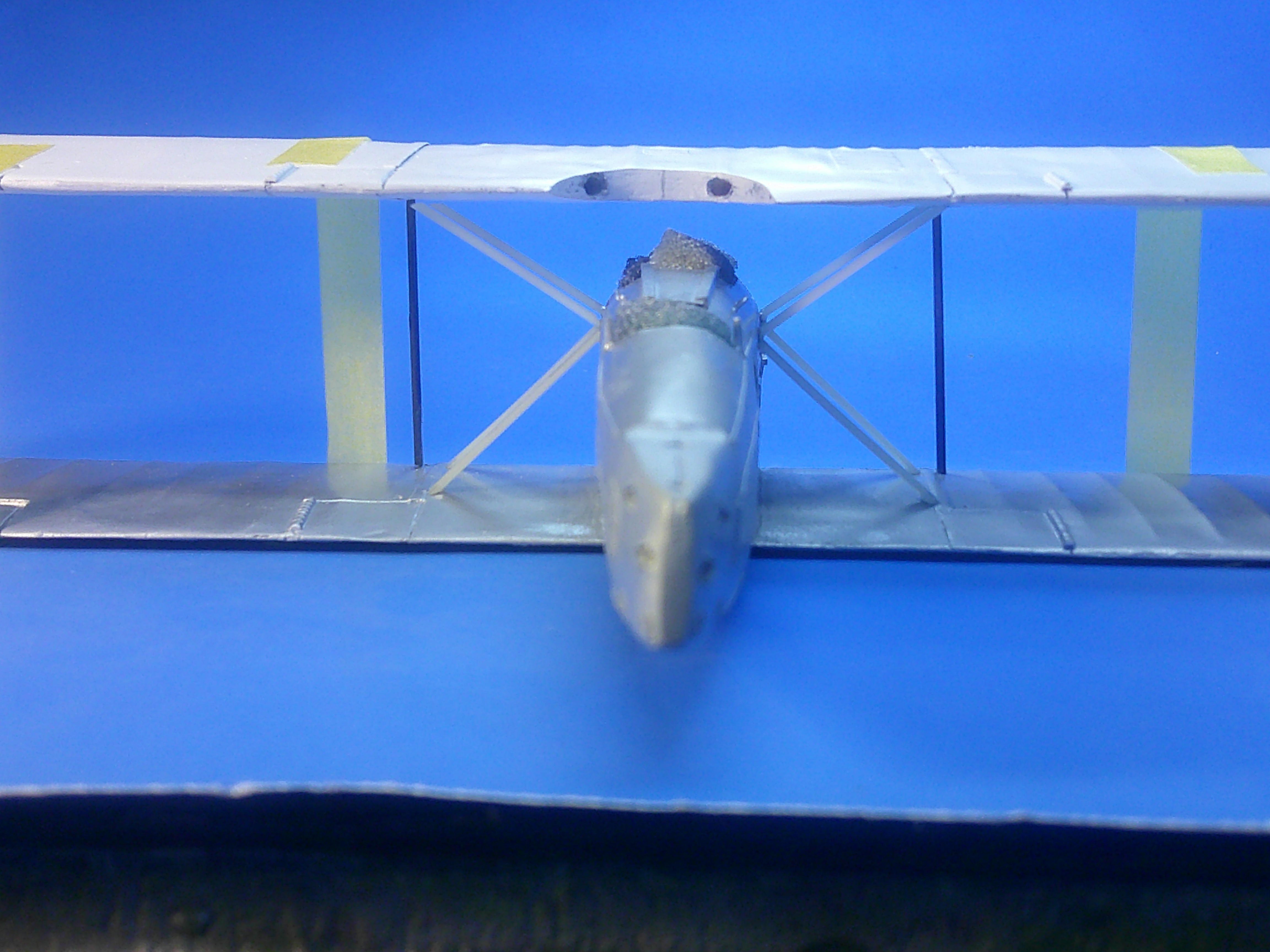

BIG STEP FORWARD..... the bottom wing and fuselage have been joined together!
I've done the initial filling and sanding, but will wait to do the priming until after my model meeting today. The landing gear and wheels and empennage are all just sitting in position for the pics.
I still have 4 major struts to add that attach to the fuselage and wings, but have finally reached the stage where they CAN be added. There's no turning back now!

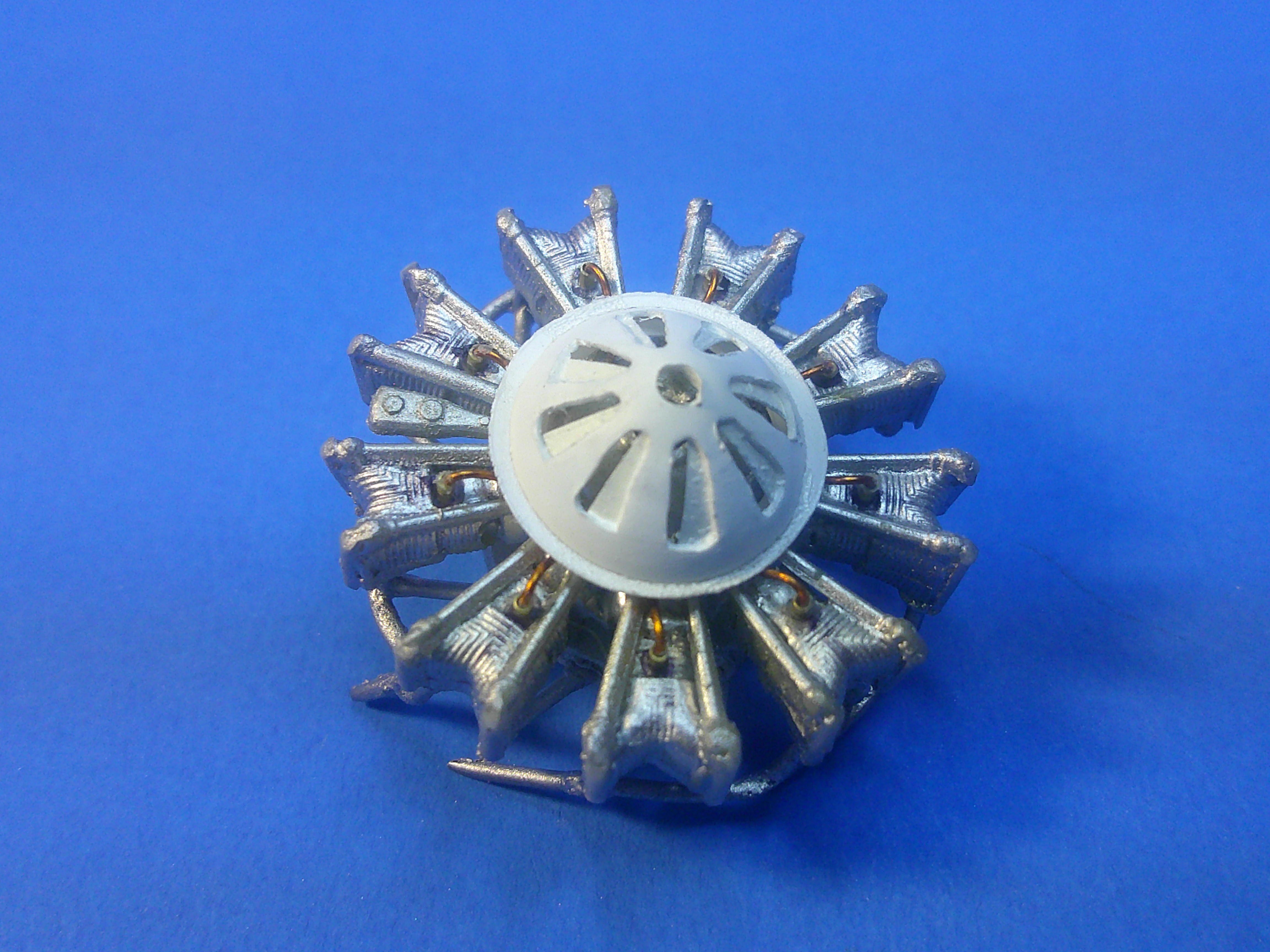

With the fuselage and wing in the filling/sanding/priming stages, I turned my attention to the engine and the prop.....
For those of you old enough to remember when Saturday Night Live was funny, as Rosanna Rosannadanna said: "if it's notta one thing, it's a somethinga else"!
Turns out the engine I had wanted to use (and every other engine on hand) was `1/4" too small in diameter. That's a scale foot too small! Since no one makes a resin P&W R-1690 that meant I'd have to "enlarge" the engine on hand.
It was enlarged by first removing every cylinder from the crankcase and then installing thick punched discs at the bottom of each one.
This pic shows the plastic sheet used to make the discs and the half round rod used to detail the tops of each cylinder. I used my trusty (and now rusty) old Waldron punch set to do the job!
Since the cylinders were now longer, the original push rods had to be cut away from the crankcase cover and individually installed to fit. Since they'll all be covered by the oil cooler cover, those gaps at the bottom of each one won't be seen.
Once the engine was the proper size and the front and cylinder tops detailed, I worked on the rear side....
The white intake/exhaust manifold ring was made by first drawing it on paper in order to get its 9-sided design and then copied onto sheet plastic laminated to the proper thickness. Holes were drilled in its top edges and into the rear or each cylinder for the intake and exhaust piping. Solder wire was then bent to shape and cut to length to make each set of pipes. Drops of superglue where  pipes join will resemble "welds" after painting (I hope!). By the way.... as for the exhaust pipe arrangement.... I've seen at least 3 different "ways" in various pics and so felt free to make this design with 2 sets of pipes for each side of the plane since I couldn't pin down any "one" accurate design.
The 4 pics above show how the finished engine and exhaust piping looks when mounted. I may add a few more small bolt heads here and there for additional detailing, but it's essentially done.
I had no prop of the proper size either in my spares box and couldn't find one to order either so I "Frankensteined" one from spare prop hubs and blades.
It still needs some cleanup here and there (the blades will be chromed!) and I may also add some counterweights for detail, but it's also essentially done.
I have to say I was a little bummed out when I realized I'd have to modify the engine, but it went much smoother and faster than I thought it would in the end, all of the above work (including building the prop) taking about 4-5hrs.

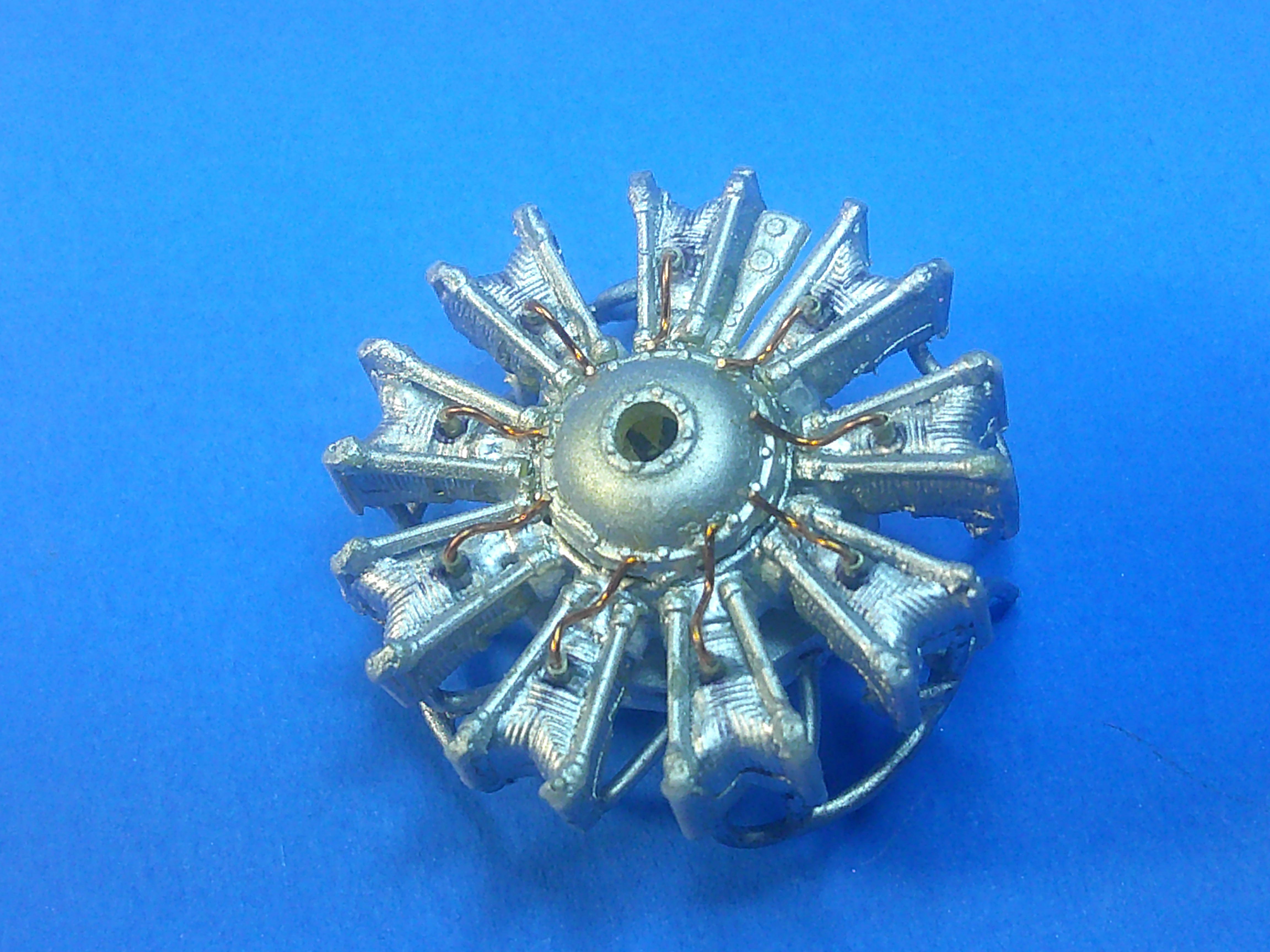

Could that engine have been more fiddly to do? While doing all that piping where did you get the extra hands/fingers to hold stuff in place?
That's the nice thing about solder wire..... it bends easily but also holds the shape well. Glue one end into a socket hole, bend, apply a dab of superglue at the next juncture, and keep going from there. It was tedious, but not too taxing from a "holding" standpoint.
Got the engine plugged and wired.....
As you can see the oil cooler cover covers a multitude of sins of omission around the crankcase!

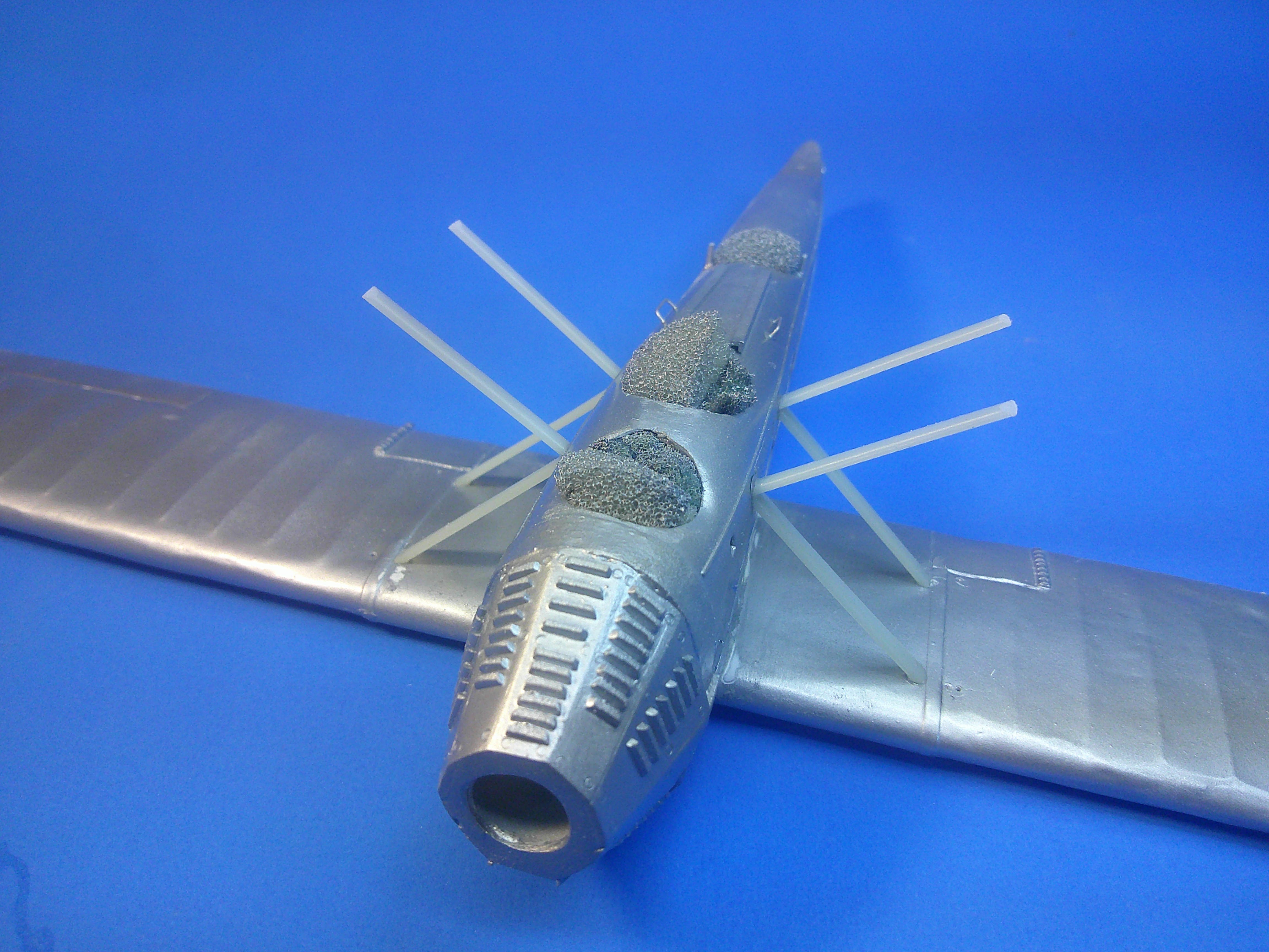

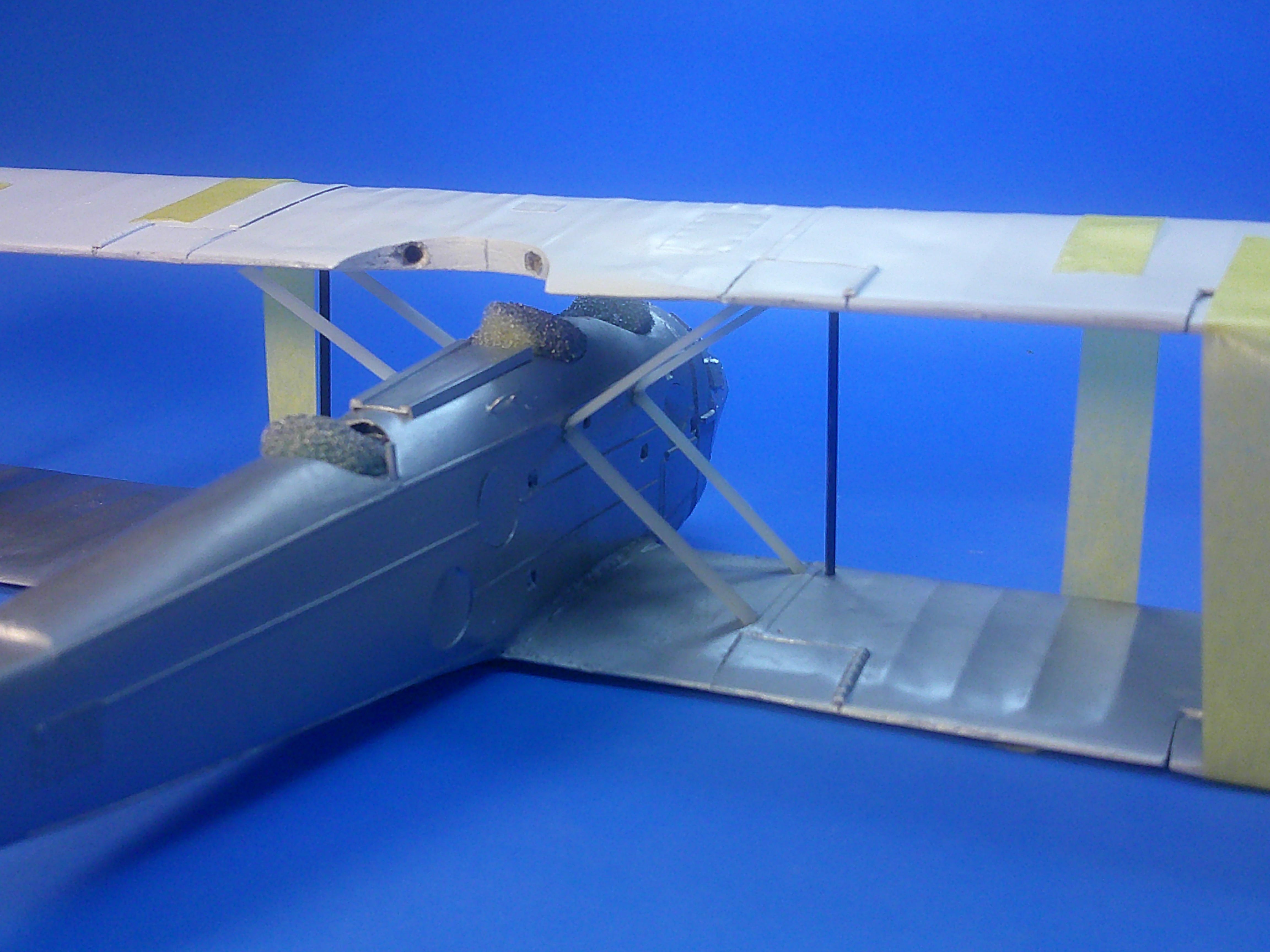

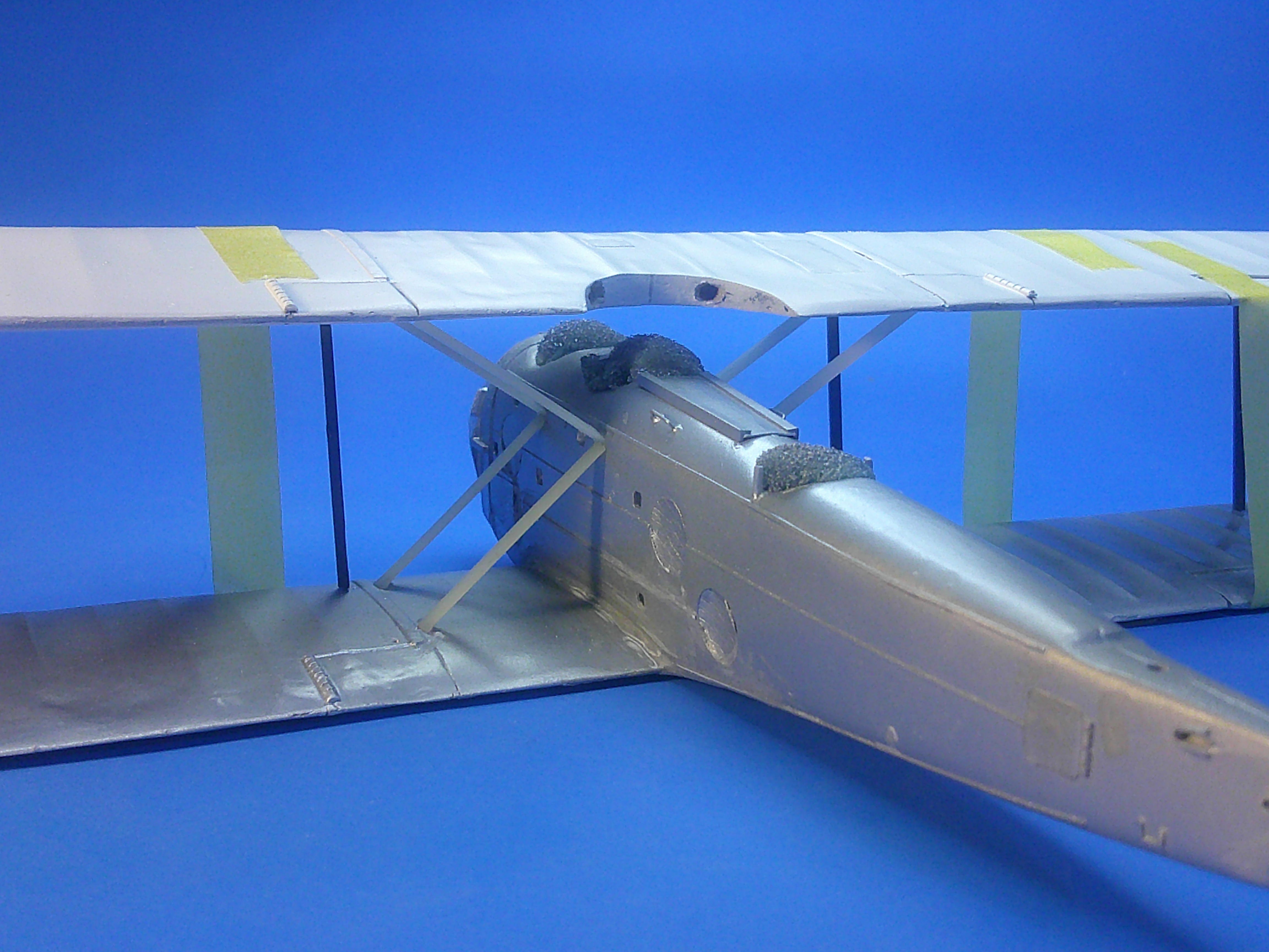

The final support struts have been added!
The top struts are not cemented to the top wing yet!
I'll have to be careful handling it from now on as those struts are glued, but not pinned!
Yet another major step and what should be the last "major" components needed for the build.

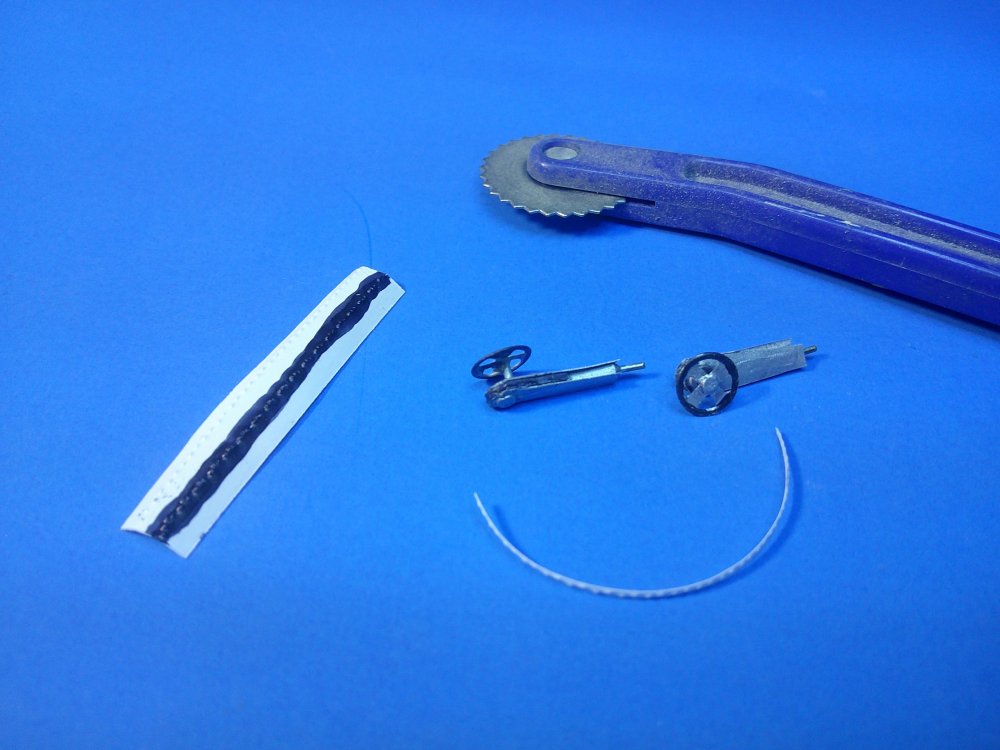

 I decided I needed to rebuild my control sticks into control columns.... Although references are scarce, I've seen other builds with control wheels instead of the usual "stick" for the pilot.
And thusly I installed control wheels on the sticks.....
The problem is THAT wouldn't actually work as turning the wheel would have no affect on a plain stick. It occurred to me I needed a control column with a mechanism that would react to the wheel movement. Again, without references, I resorted to other types from that time period which used chain drives to transmit control movements. The only problem was I had no columns nor any chains on hand....
My solution was first to make a stick post that could be sheathed in sheet plastic shapes to make a column while leaving a "channel" for the chain to sit in on each side and at the top. I also added some punched discs to imply circular control for the wheels. But how to make some "chain"? I used a ponce wheel that was run along some .005 plastic sheet (while on top of a folded paper towel for padding) 2 times to emboss the pattern seen on the piece at the far left. The thin curved piece shows how it looks if just cut apart from the sheet without coloring. I used a black marker to quickly make the pattern black, cut it thin enough to fit over the top and down the sides of each column so that (hopefully) it looks like a chain that can move with the movement of the control wheel.
While this probably wouldn't work well in a larger scale I think it makes for control columns that are at least plausible as compared to the obviously implausible original stick-wheels. Anyway, that's my story and I'm sticking to it!

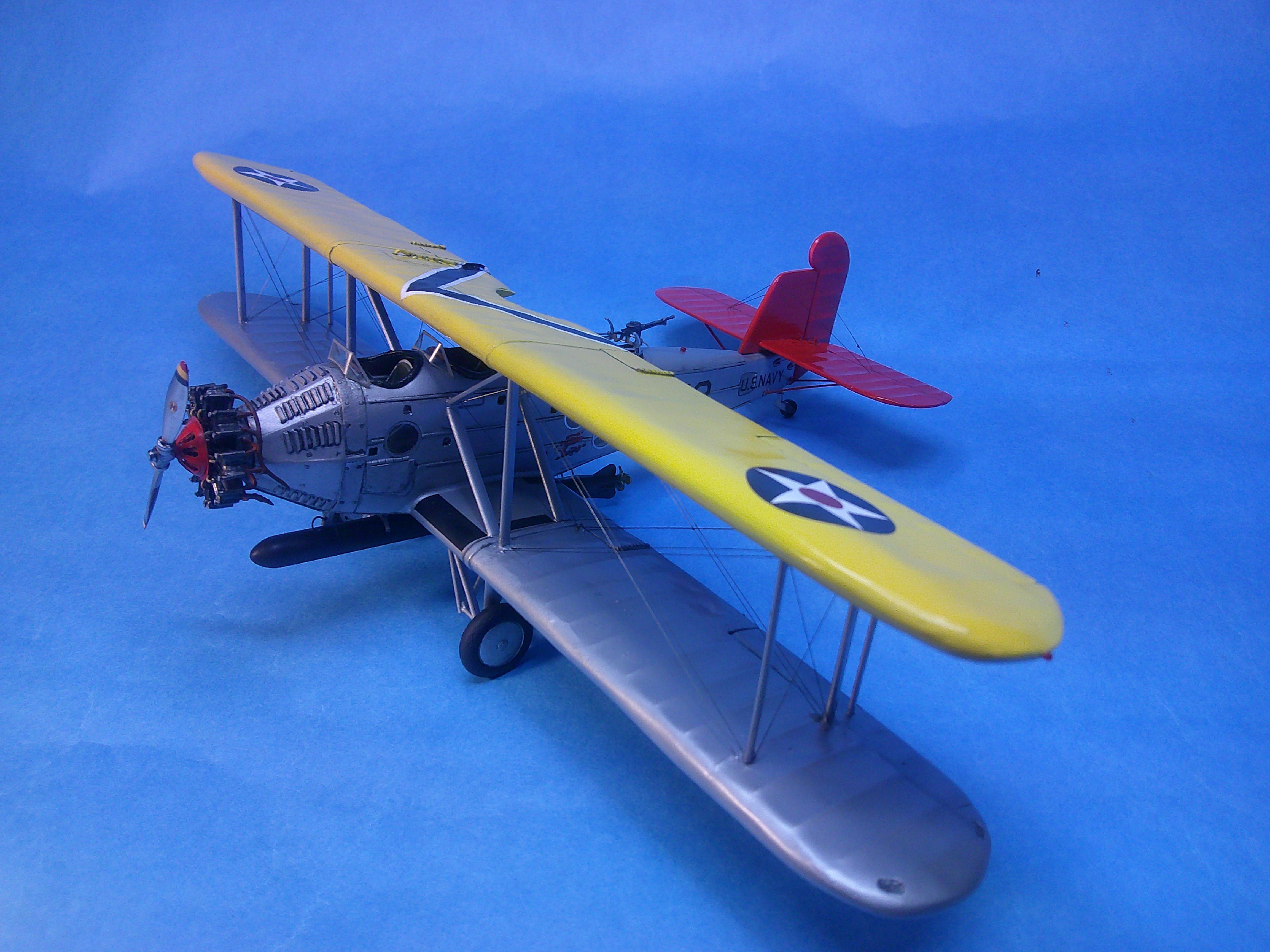

Almost there.......
The model is rigged except for 4 wires on the tail, the tail planes are on the model, and so are all of the wheels.

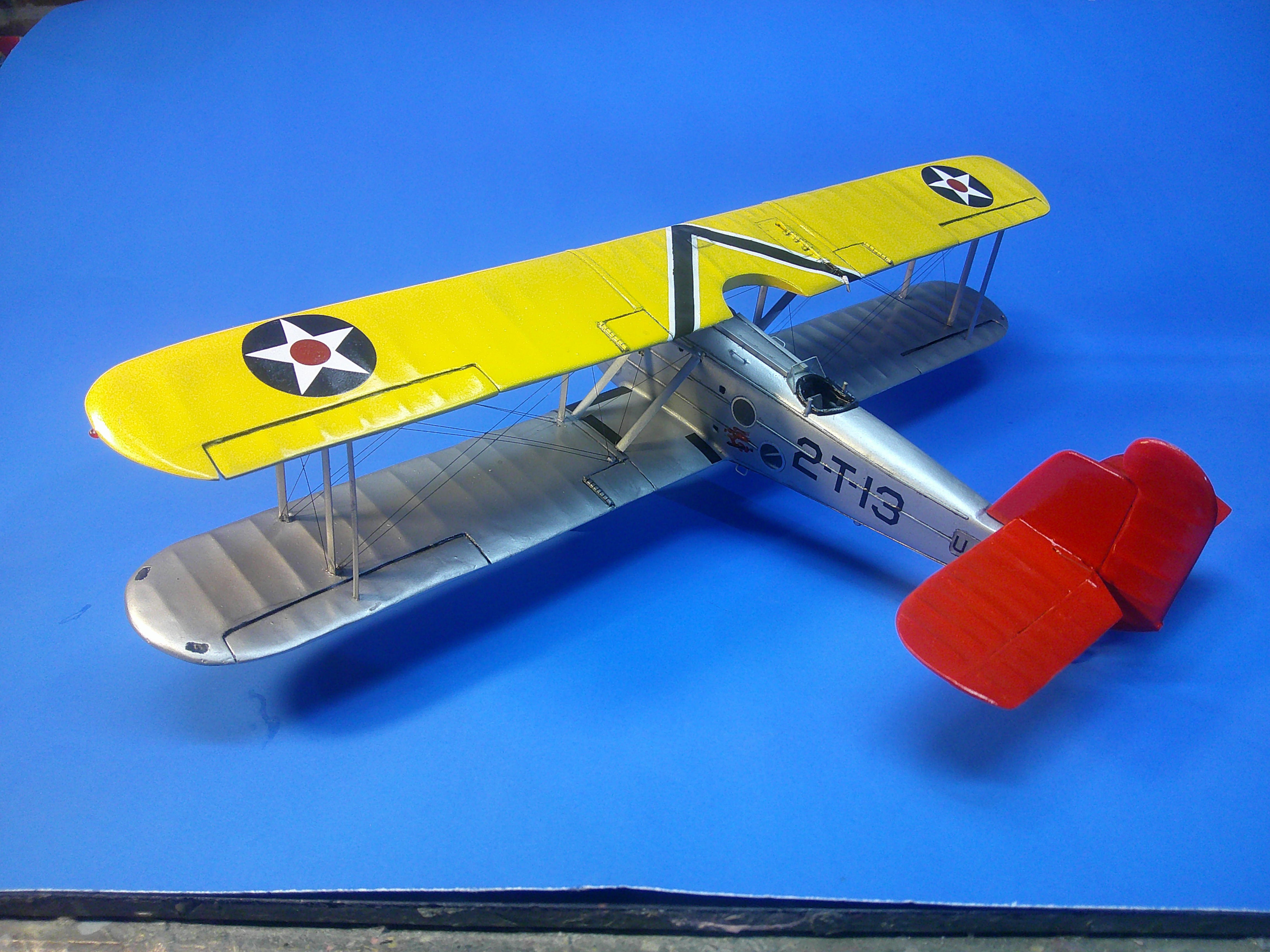

The sharp eyed among you will notice there's no "T4M-1" on the vertical tail anymore. That's because the paint CRAZED after I gloss coated it! So.... it had to be stripped, sanded, and repainted and I ain't doing no more decaling!
Still some "final" things to be done.... but it should be done in a day or two. More pics when she's finished!

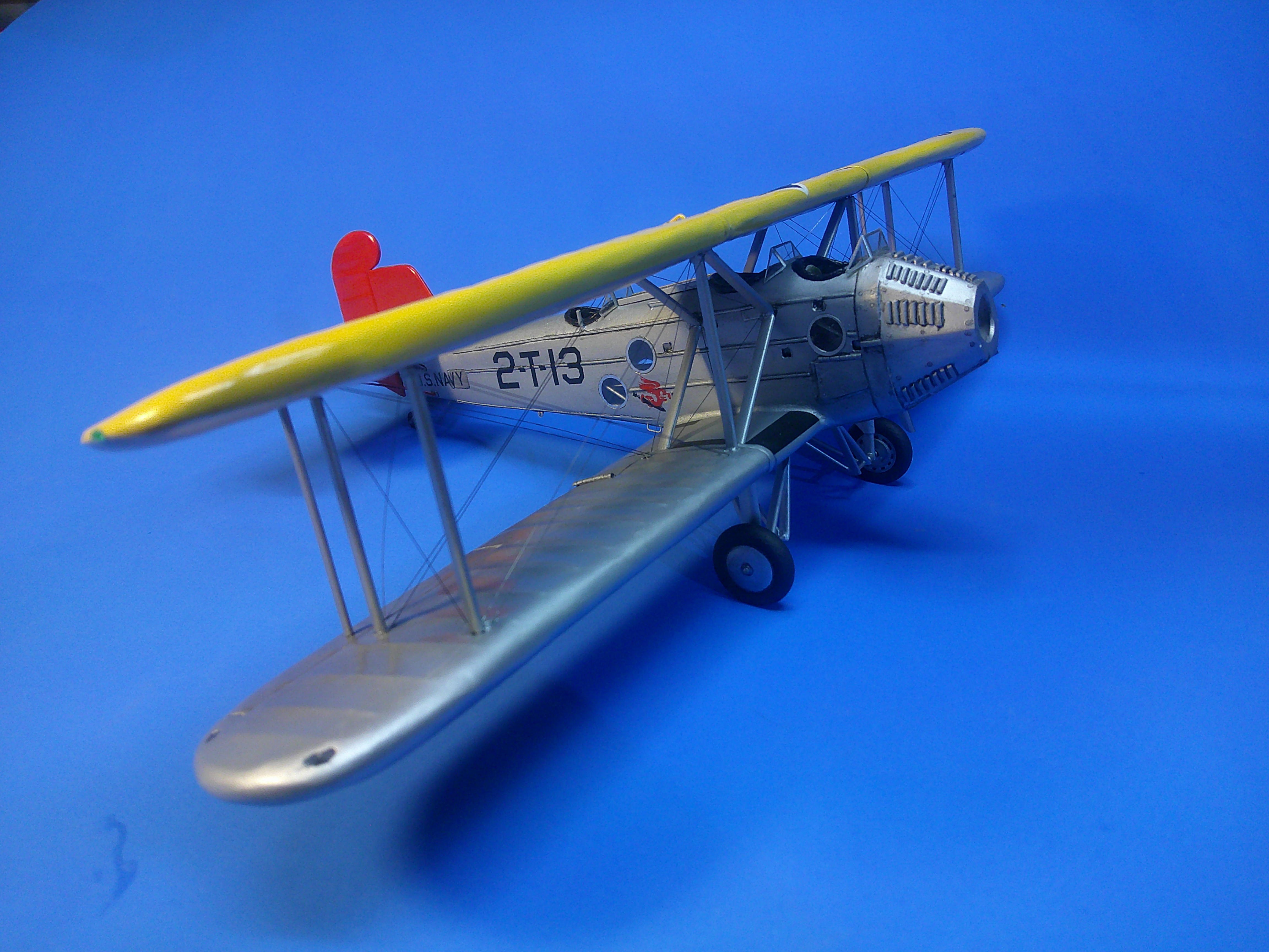

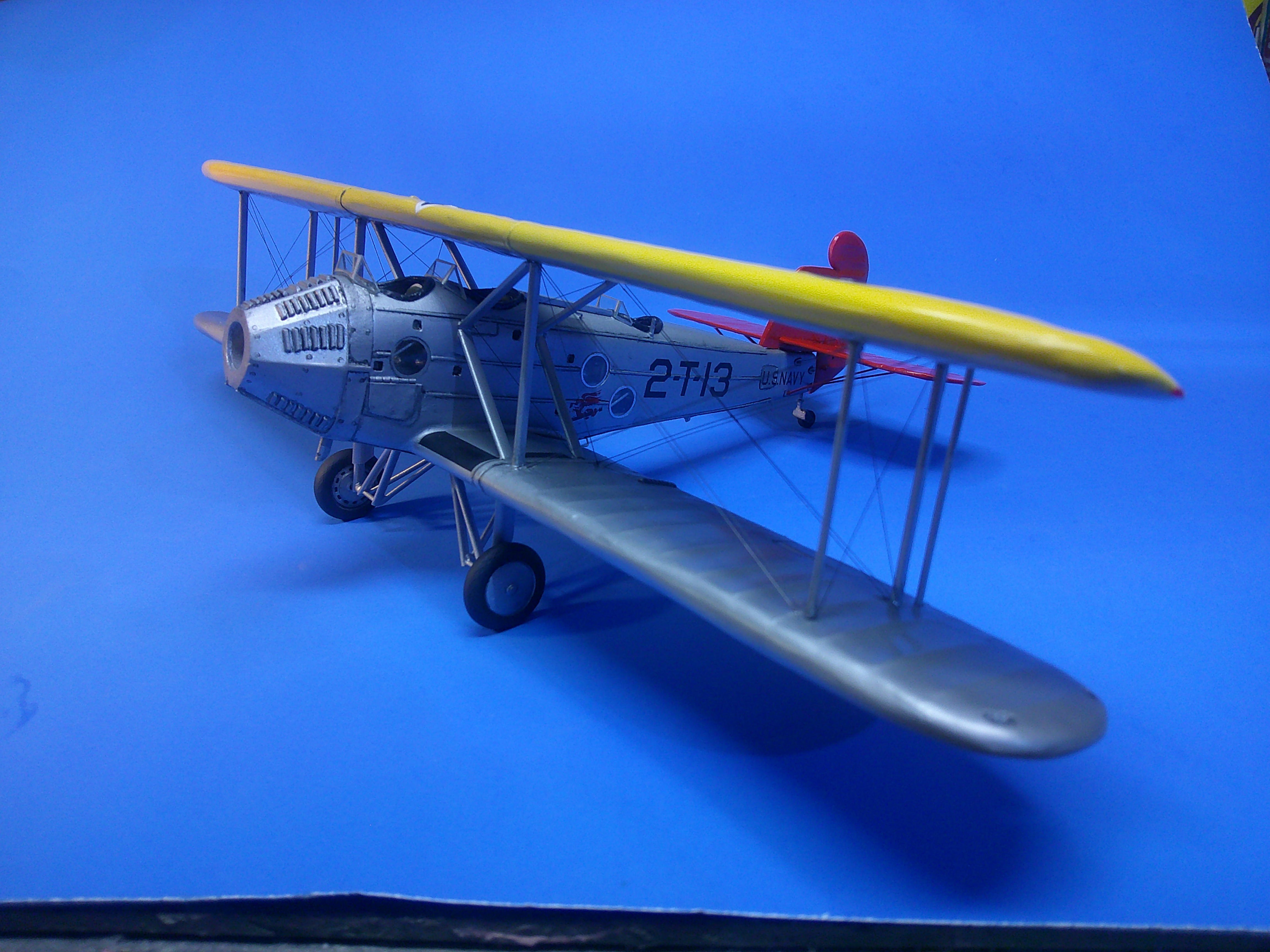

Calling it done!
See more finished pics in the Aircraft topic area!
