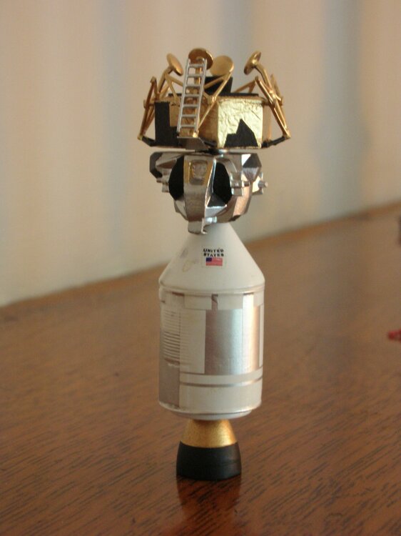

Ron Bell Posted March 12 Report Share Posted March 12 Here's my run at the same kit. Link to comment Share on other sites More sharing options...
TonyD Posted March 12 Author Report Share Posted March 12 Nice! Gives me something to shoot for! Link to comment Share on other sites More sharing options...
