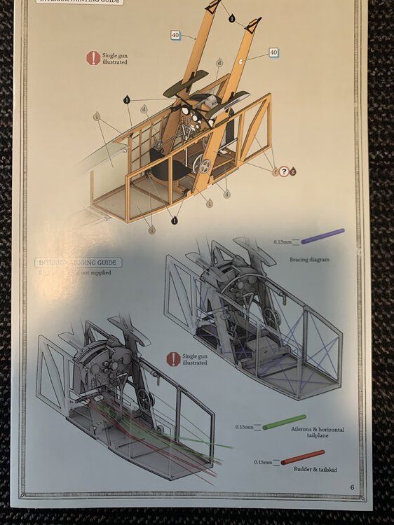

So I’ve decided to finally build a WWI plane for my collection.  I am close to the point where the instructions show interior rigging (see photo).  There was a great thread here about rigging biplanes but I am still at a loss.  The interior framing of this model is made up of incredibly thin parts and I do not see how to drill any holes to pass the rigging line though.  As usual, I was hoping that someone might have some words of wisdom.  Thanks in advance for any advice.
Stuart
I always recommend Wonder Wire (ceramic wire) since it can be easily cut to length, flexes into place, and is stiff enough to not need any heating to make it taut, especially for exterior rigging with longer runs. Lacking that, for those smaller interior runs I'd try stretching some sprue. Try to find some harder sprue (Hasagawa/Tamiya) as it'll yield stiffer stretched sprue than the softer kit sprues. The short runs needed for the interior should be able to be added using white glue, so no holes needed and (hopefully) no need to heat them to make them taut.
If you're not experienced or comfortable with stretched sprue, go to your local florist and ask for a handful of their thinnest floral wire.  It can be very easy to work with IF you can get it in thin enough sections. Lacking that, check your local hobby shop/store for very thin brass wire, usually sold in the RC/control line flying model areas. The drawback to the thin wire is that it can be easy to "kink" a section, making it useless.
Hope this helps!
Gil :cool:
Thanks very much for the reply Gil, it helps greatly. I have some homework to do.
