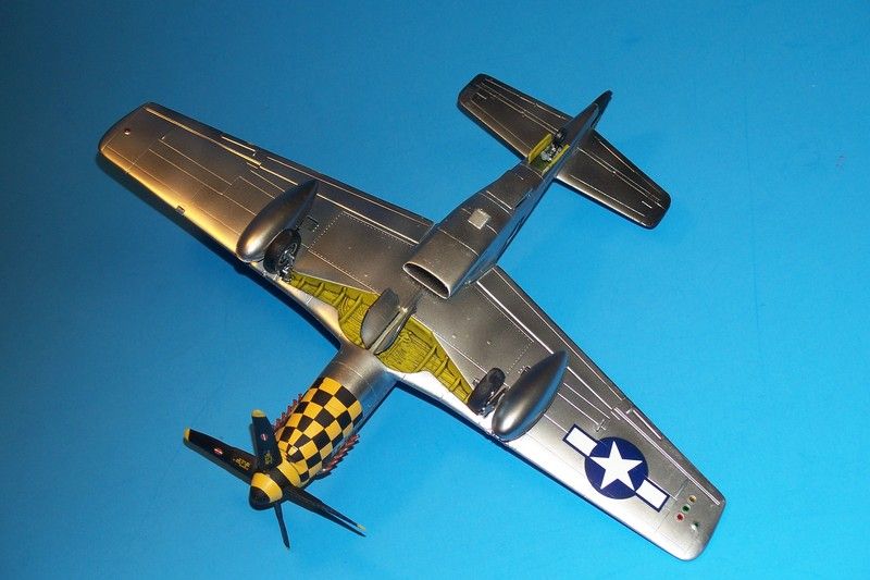

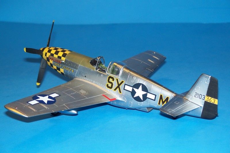

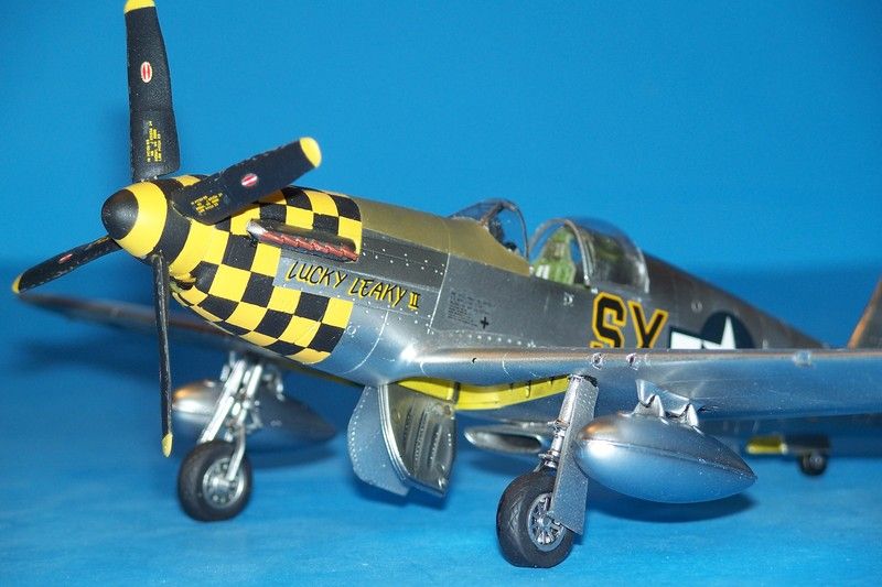

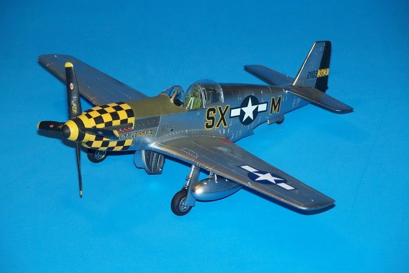

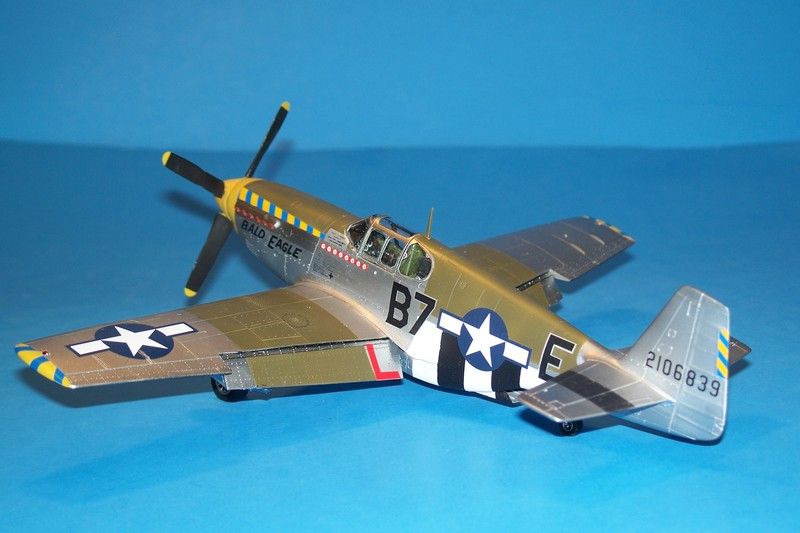

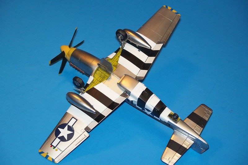

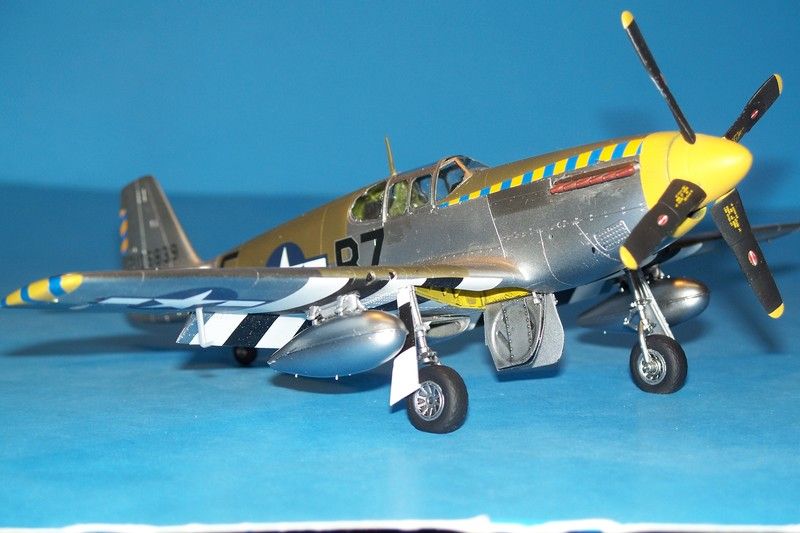

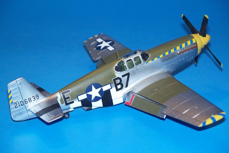

Built these two "B"s at the same time I built the P-51D posted below.
This is the ICM copy of the Tamiya P-51B in 1/48. Unless you're on a tight budget, spend the extra few dollars and get the Tamiya kit, as the ICM copy is much cruder in execution.
NMF is Alclad and AK Aluminum. I used the Tamiya P-51D invasion stripe decals on this B, and they worked "ok", needing only a little touch up here and there. The Bald Eagle markings are from Aeromaster. Built OOTB overall, and the first Mustang I've ever built with a completely closed canopy.

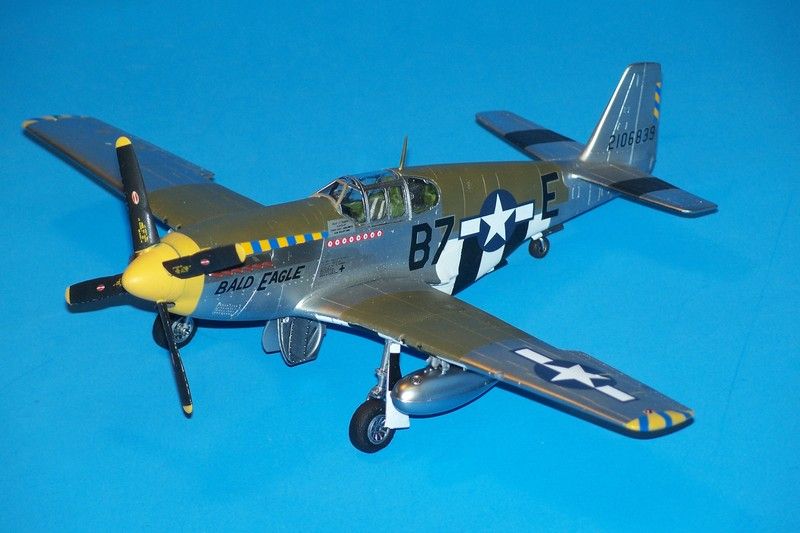

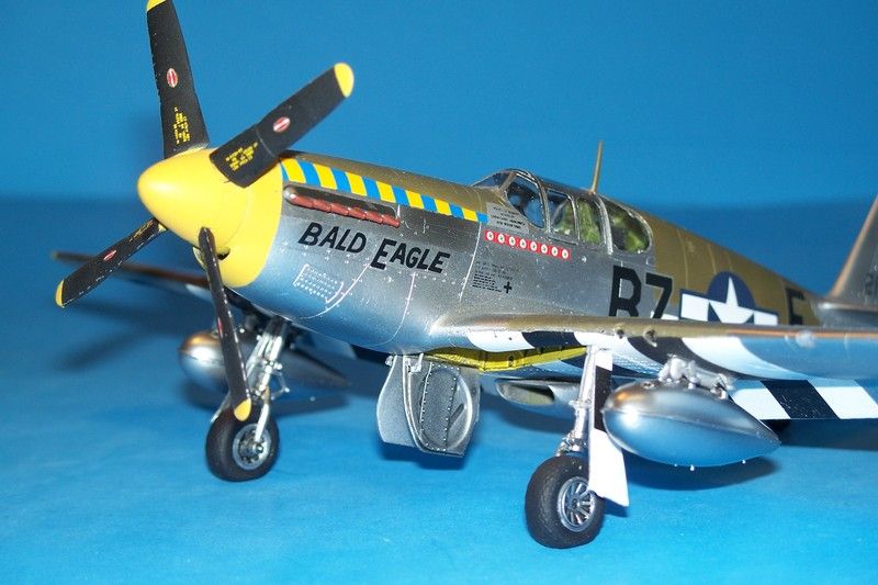

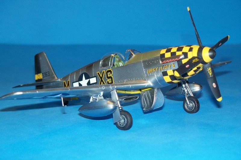

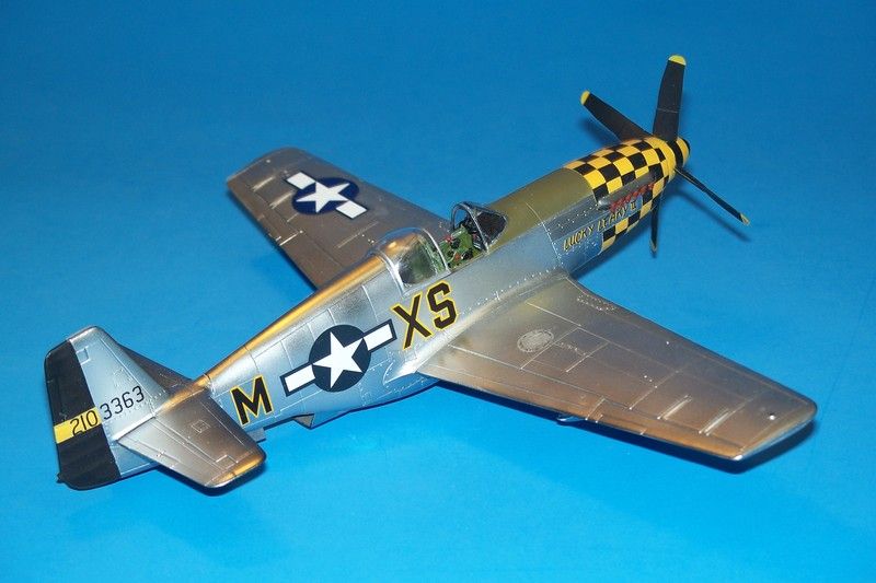

The last of the 3 Mustangs I built at the same time, this is the ProModeler update of the venerable old Monogram P-51B. In my opinion, except for the indented panel lines, this is not a great improvement over the old Monogram kit, especially if you're just building it for your shelf, like I did.
The model is OOTB. NMF is Alclad and AK Aluminum. The nose checks were painted after trying to use the Aeromaster nose decals. The rest of the decals worked perfectly.
