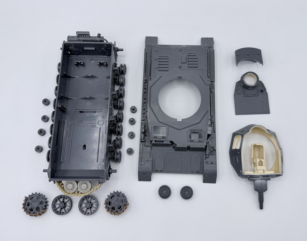

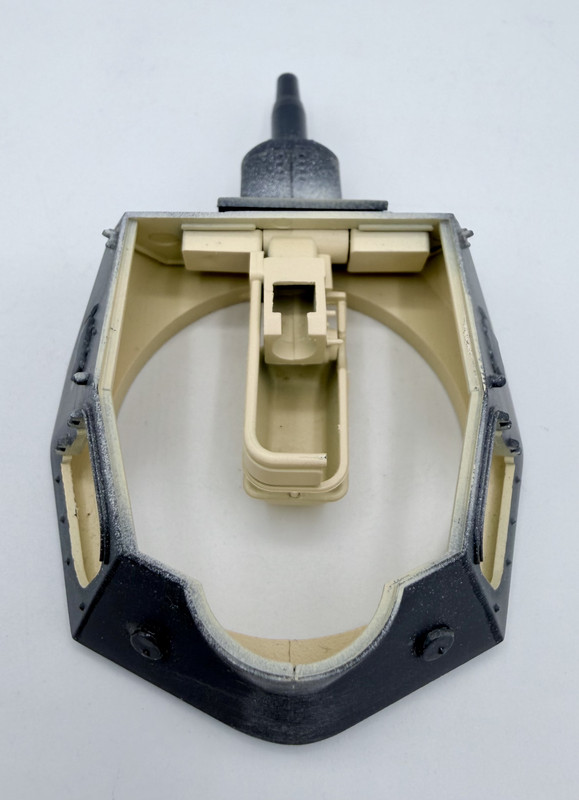

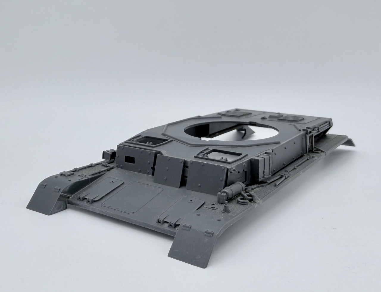

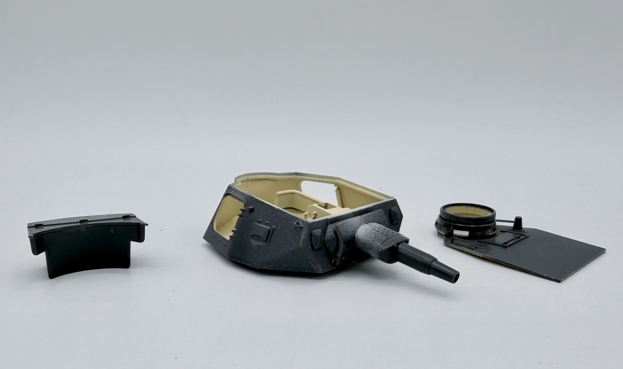

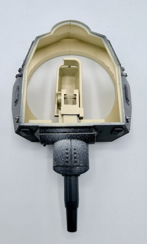

My latest resurrection project from the Shelf of Doom… I started this for a So.Cal AMPS Panzer IV GB about 10 years ago
I was going to replace the kit tracks with some AM tracks and eventually settled on some Modelkasten indy links

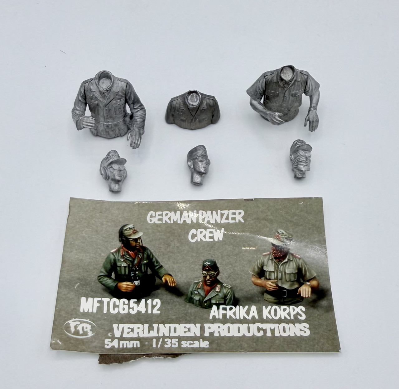

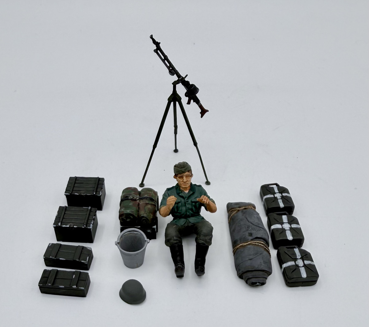

Since I wanted to do a DAK Panzer I decided to replace the crew figures with a set from Verlinden and the kit decals are replaced by a set from Bison

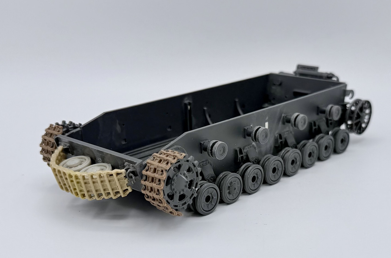

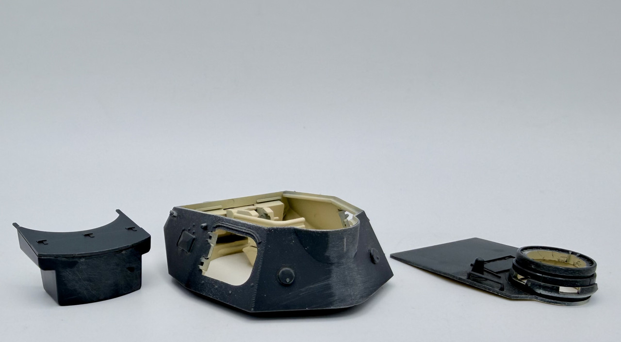

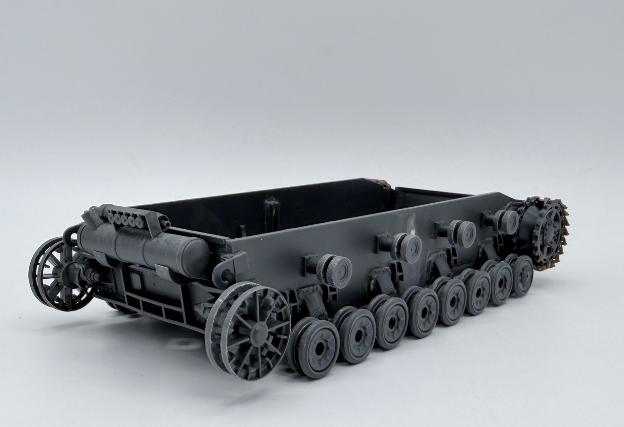

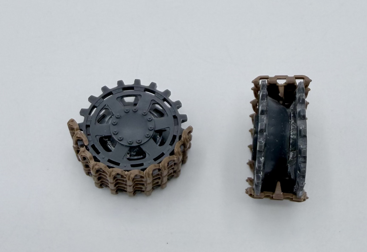

I got most of the basic assembly finished, but then hit a snag when I tried to fit the AM tracks to the kit sprockets. The sprockets were too wide as engineered. So I put it onto the shelf of doom after getting this much completed
So yesterday I decided to pull this one off the shelf and tackled the reason for the stop first. I cut the sprockets in half, sanded away some of the middle section until they would fit the MK tracks, then glued them back together.
Then a test fit onto the lower hull
This won’t be my main project, but I will be chipping away at it for the next while until it is finished.
