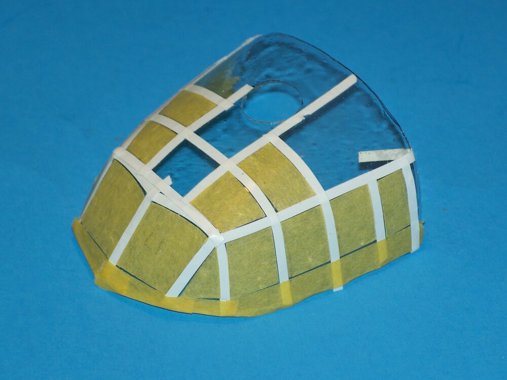

Below are pics of a 1/48 C-119 canopy that I push molded because it was too big for my vac machine. If you removed the frames from your mold, I suggest simply using tape and or paint to replace them, which should be much crisper and to scale.
Hope this helps!
Gil  :cool:
