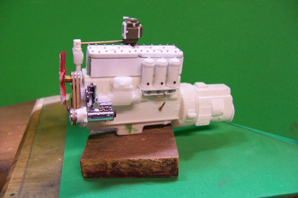

I have a question for you folks:  I need to scratch built two "straight six cylnder" gas engines.  Any suggestions on where these can be found, or modified?  I may have to scratch build these too.image.thumb.png.82735e0ab9dcc63bd861e244ea7888bc.png

Nice work.  As for the engines you need, straight 6 engine blocks can be found in some of the older vintage Chevy car kits.  Now whether or not a Chevy Staight 6....also known as a Stovebolt 6...could form the basis of the 6 cylinder engine you need is another question.  Maybe, maybe not.

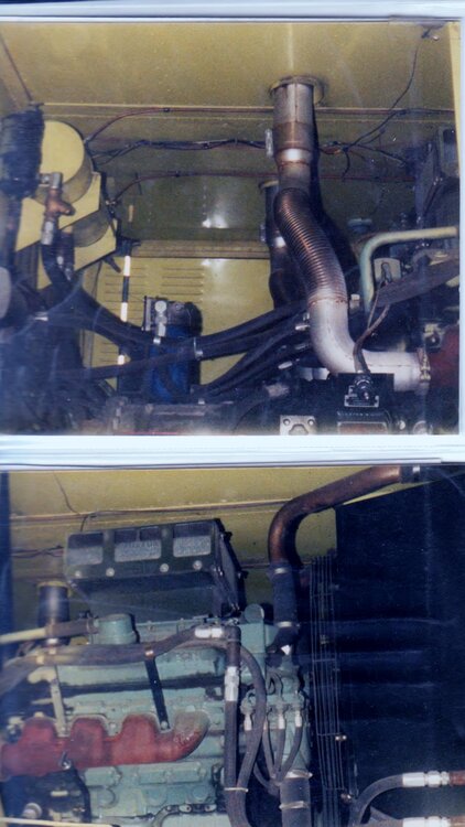

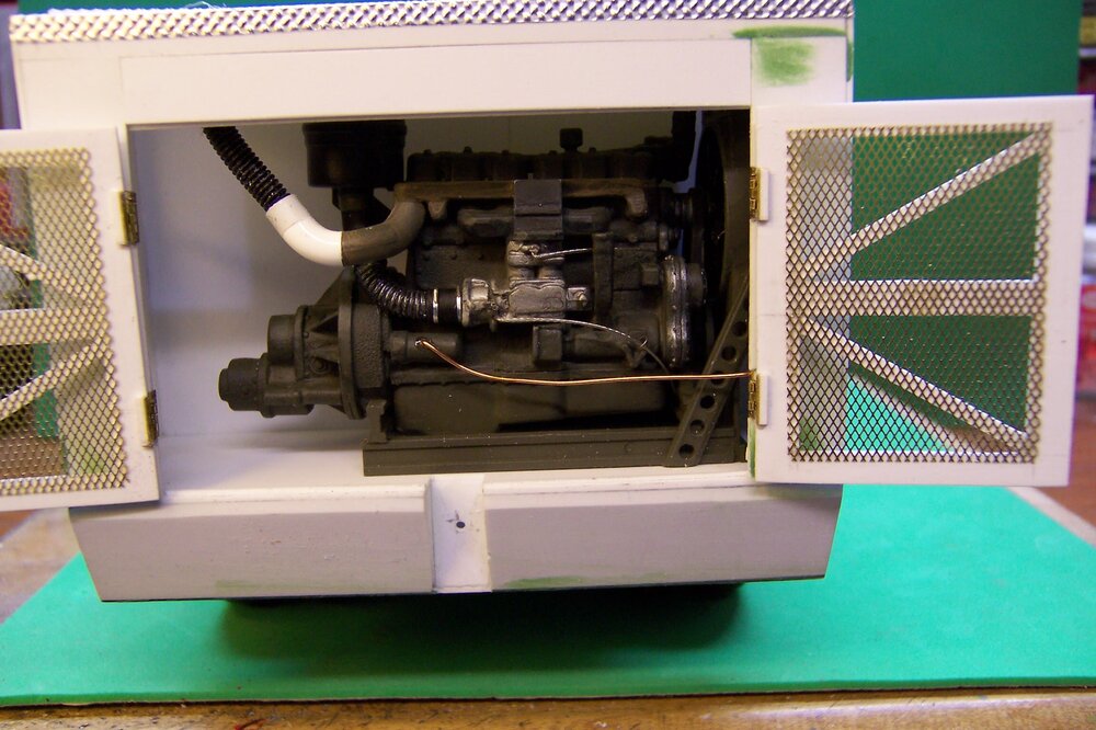

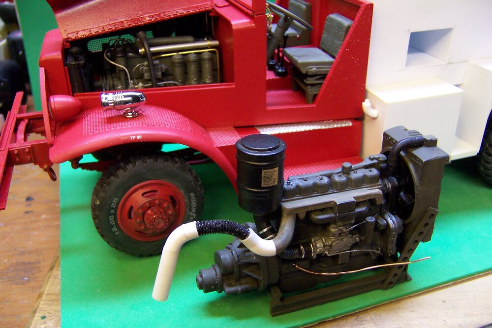

I built a P-2 many years ago in 1/25 scale. Not as detailed with engines & opening doors. Tires are what I could find that are close. Engines for P-2? As I recall the engines in a P-2 were Continental like the O-11 had. Most of the model truck kits now days have a Cummings diesel engine. Leave off the injection & all diesel parts add intake with a carburetor. The rebuilt P-2 by Quality Manufacturing in Talladega Alabama. I worked there on the P-4 rebuilds. The new engine for P-2 was as I recall were Detroit Diesel 8 V 92 TA. I was at Firefighting school in Chanute AFB Ill. when the first proposed P-2 rebuild was unloaded from transport trailer. Allegedly the person who took the wheel & drove the new P-2 as normally would. The front tires came off the ground. Mostly due to no water or foam in tanks lightened the P-2 to have breakneck power. I have a facebook page blog with my many builds of " Model Fire Apparatus" by same name. Pictures are of My P-2 & P-4 along with a New Bright Simba crash truck. The next picture is the engine compartment on P-2. Weird? I found the listing for this build on a search for pictures of Crash Trucks. I tried to find this form on IPMS home page forms. Nothing.

Thanks.  I found what appears to be Cummings engines on EBay, and heavily converted them.  Building crash trucks are pretty easy since they're "slab sided."  I wrote an article for IPMS,  so we'll see when it's published.  A question--  what does the "P-" signify?   USAF never responded.

Do you know what size or Cubic inch the inline 6 gas motors are?  Or a brand / model number, such as Hall-Scott or Continental.  Check out Iceman Collectibles.  High quality 3D printed engines and all sorts of other parts. https://icemancollections.com/
