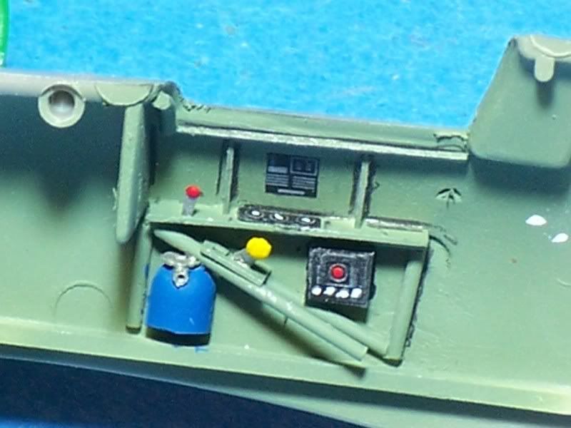

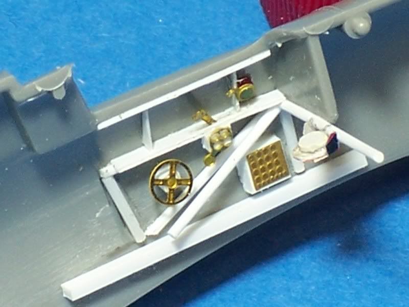

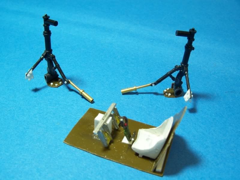

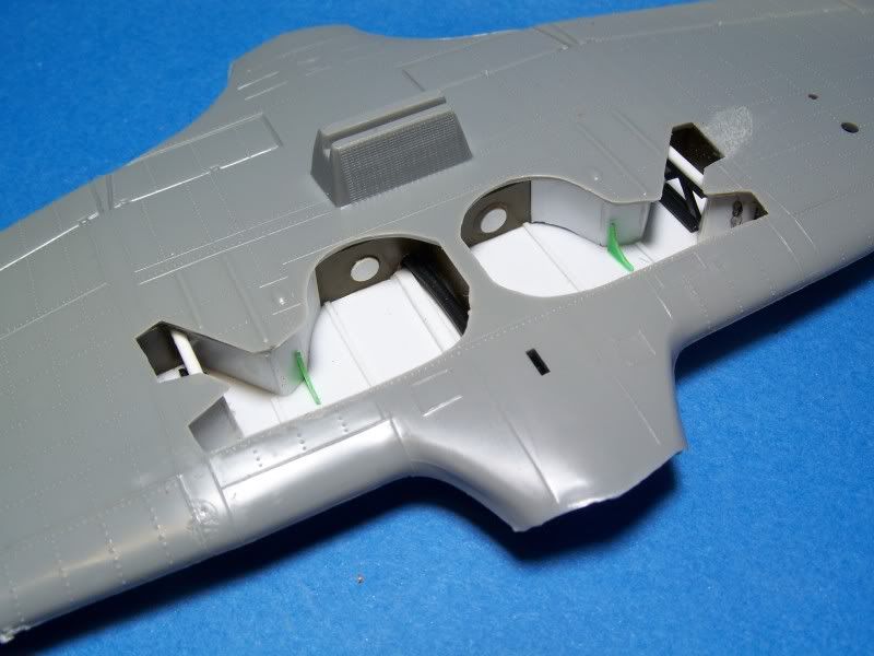

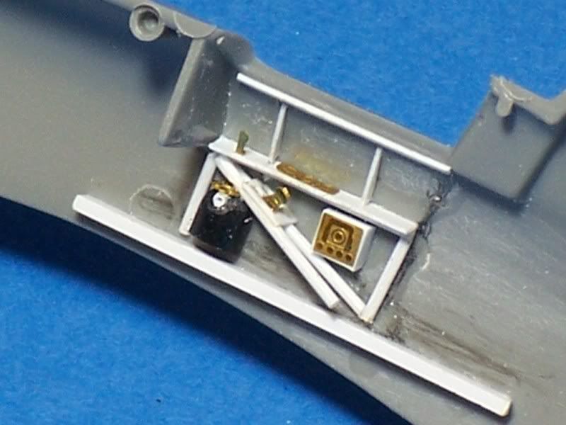

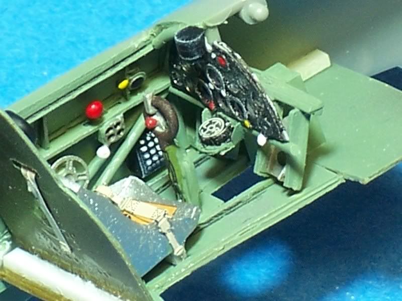

ghodges Posted September 27, 2011 Report Share Posted September 27, 2011 (edited) There's a Fellowship Build for Hurricanes over on Agapemodels.com, and the old Monogram kit is all I had in the stash! As I have a couple of them on the shelf already, I decided to convert it to a Sea Hurricane. All that's needed for that is some simple cutting and boxing in in the rear. I've also built the arrestor hook, but forget to take a pic of it! It needs a totally scratch built interior, as it comes with none! And here is the rest of the cockpit, except the main panel, which still needs to be built up. You can also see the main gear rebuilt (originally designed to function) and detailed with actuators... Which fits into the boxed in main gear wells... Still have a l-o-n-g way to go, but the hardest work is done. Questions, comments, and critiques welcome as always! GIL Edited November 21, 2011 by ghodges Link to comment Share on other sites More sharing options...
Ron Bell Posted September 27, 2011 Report Share Posted September 27, 2011 Are those Hodge-Podge parts I see in the cockpit? Link to comment Share on other sites More sharing options...
ghodges Posted September 27, 2011 Author Report Share Posted September 27, 2011 Ahhh...Fame! Yes, those are some of my old pe parts thrown in there for gratuitous (and inaccurate) detailing! The rest are gathered from an old Airwaves "generic" cockpit detail set (who obviously copied MY idea!) GIL Link to comment Share on other sites More sharing options...

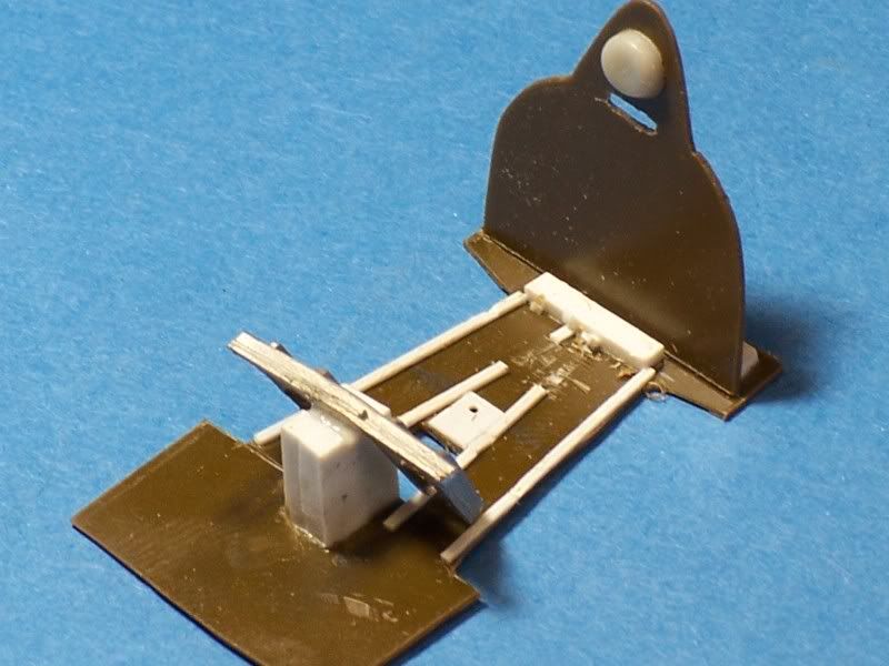

ghodges Posted September 28, 2011 Author Report Share Posted September 28, 2011 (edited) There's no difference. But, since Agapemodels.com is a Christian modeling website, they use the term "fellowship". Made a small allowance for accuracy and modified my floor, making some cut-outs so the "whole" floor looks more "floorless" when installed. This is the new look... The slot for the shoulder harness and the headrest have also been added, as well as detailing for the foot channels. That nasty looking area will be covered by the seat! GIL Edited September 28, 2011 by ghodges Link to comment Share on other sites More sharing options...

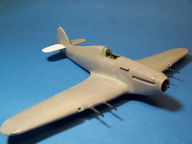

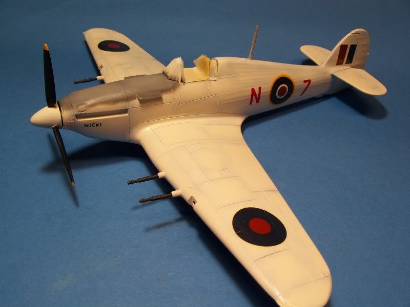

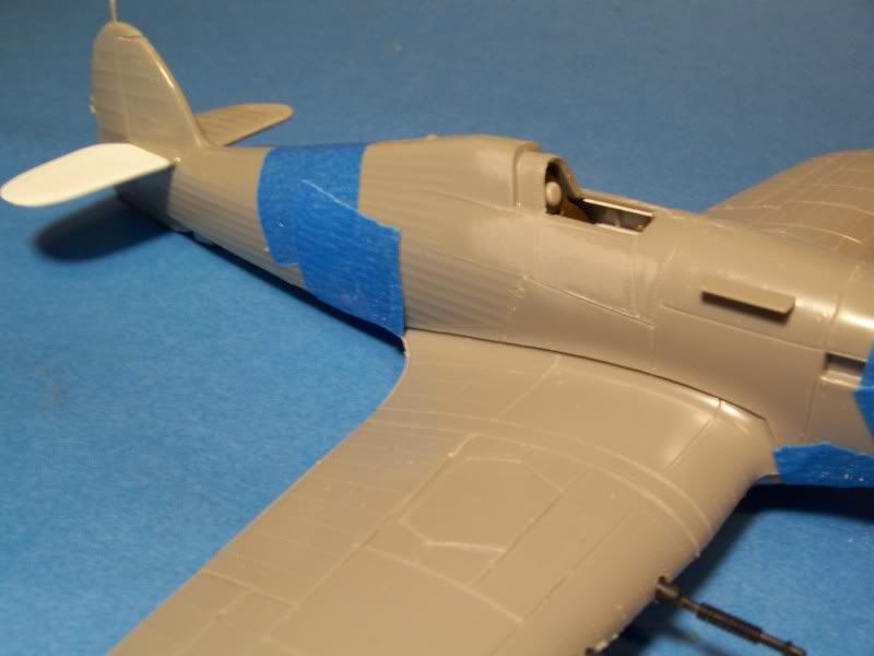

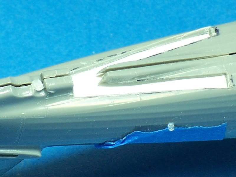

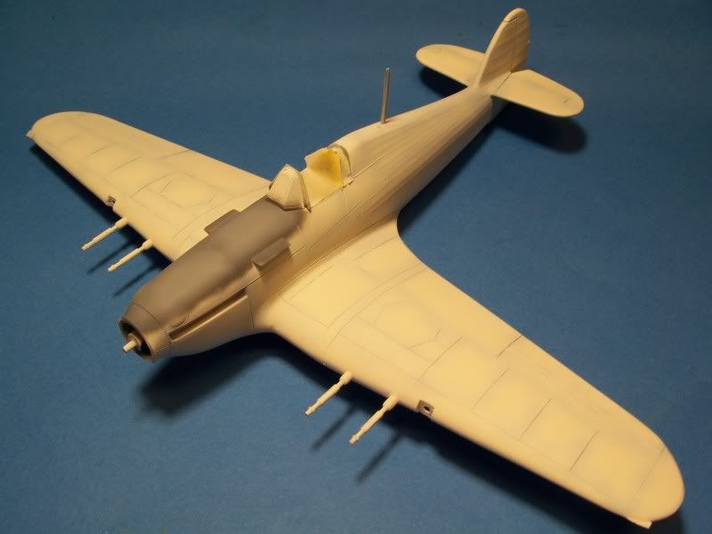

ghodges Posted October 8, 2011 Author Report Share Posted October 8, 2011 (edited) Model has been rescribed, but no sanding has been done yet. Yeah...I could've worked for Matchbox! Hopefully, the panel lines will look much better after all the surface sanding has been done.;) Also, you may note the white right tailplane. My kit was MISSING it! I don't know if I lost it, or if it was gone when I bought the kit from a vendor, but regardless, I had to scratchbuild a new one. I superglued 2 sheets of plastic together and used the left tail plane to size it and rough shape it. I used a motor tool and a half-round file to make the "sagged" areas (to match the kit part better), and then scribed in the elevator and trim tab. In between all of that was a lot of sanding with 360/400/600 grit sanding sticks to establish the airfoil shape and thin the trailing edges. Wire pins were added to mount it to the fuselage. This was easier than I has anticipated and only took about an hour. Hope to start painting by the holiday on Monday! Cheers! GIL Edited October 8, 2011 by ghodges Link to comment Share on other sites More sharing options...

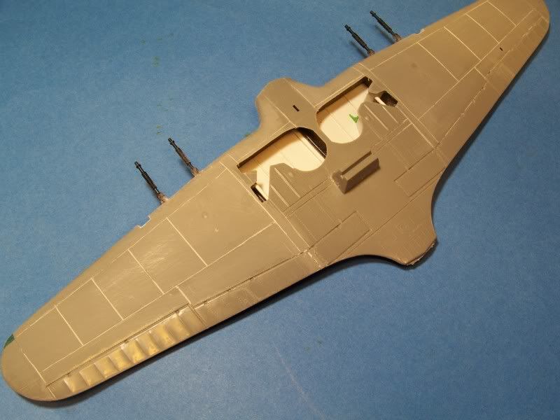

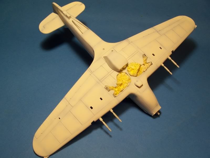

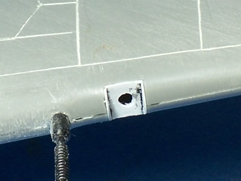

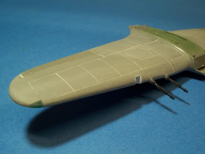

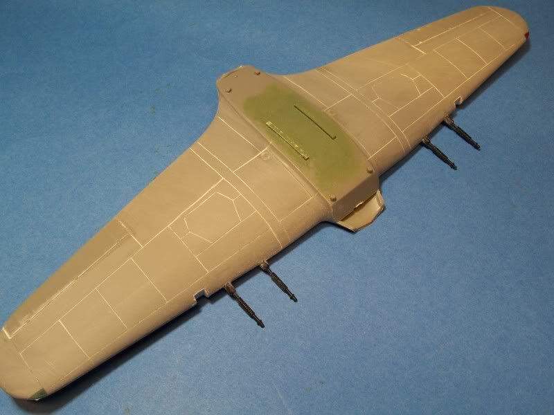

ghodges Posted October 14, 2011 Author Report Share Posted October 14, 2011 Progress made on the wings.... This closer look shows off the tip light and the leading edge light housing a bit better. I also got the cockpit painted interior green, which you can see some of on the top center of the wing. Questions, critiques, and comments welcome! GIL Link to comment Share on other sites More sharing options...
ghodges Posted October 23, 2011 Author Report Share Posted October 23, 2011 Slow progress continues...... I decided to keep it simple with the light housings, and drilled a hole for an MV lens. The clear cover will be done with packing tape at the end of the build. The interior is painted too. The belts/buckles are pre-painted Eduard RAF items. All of it is now buttoned up in the fusleage. Now it's back to more filling and sanding chores! Cheers! GIL Link to comment Share on other sites More sharing options...
ghodges Posted October 25, 2011 Author Report Share Posted October 25, 2011 She is assembled! Got the first round of sanding done. Hope to have the first primer coat on in a day or so. Cheers! GIL Link to comment Share on other sites More sharing options...

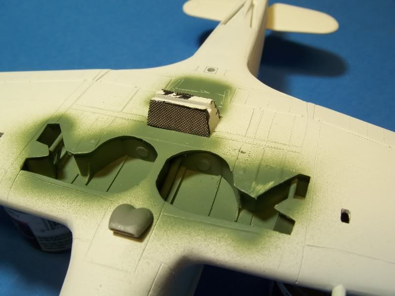

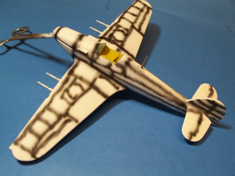

ghodges Posted November 8, 2011 Author Report Share Posted November 8, 2011 I've been making slow, but steady progress... I cut some wire mesh to detail the radiator... And I've also got the preshading done... Almost ready to start painting! GIL Link to comment Share on other sites More sharing options...

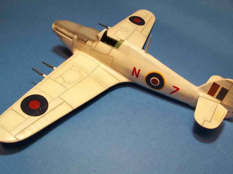

ghodges Posted November 10, 2011 Author Report Share Posted November 10, 2011 She's painted! The shadow shading is more evident than the camera shows for some reason....In any case, gloss coat and decals are next! GIL Link to comment Share on other sites More sharing options...

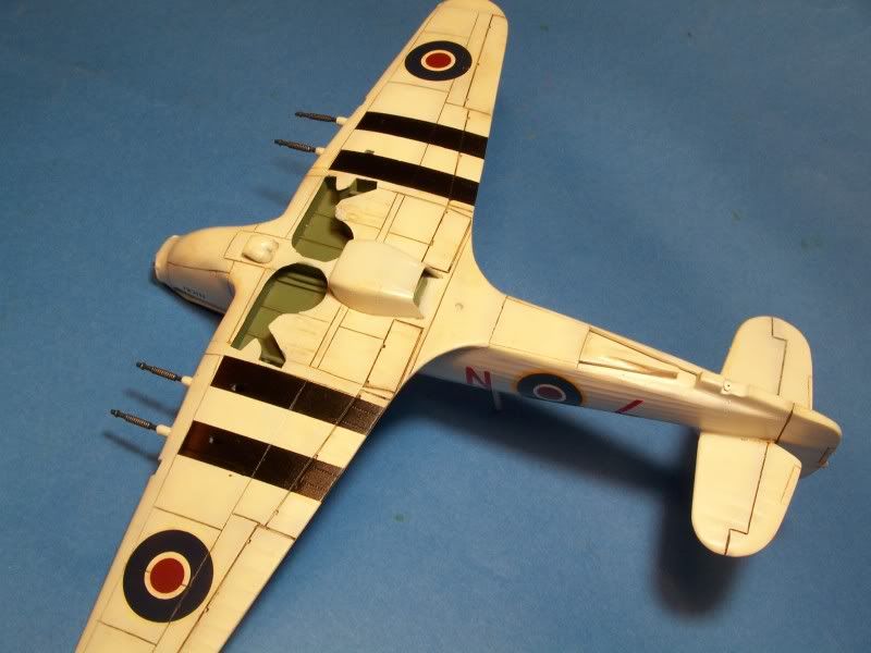

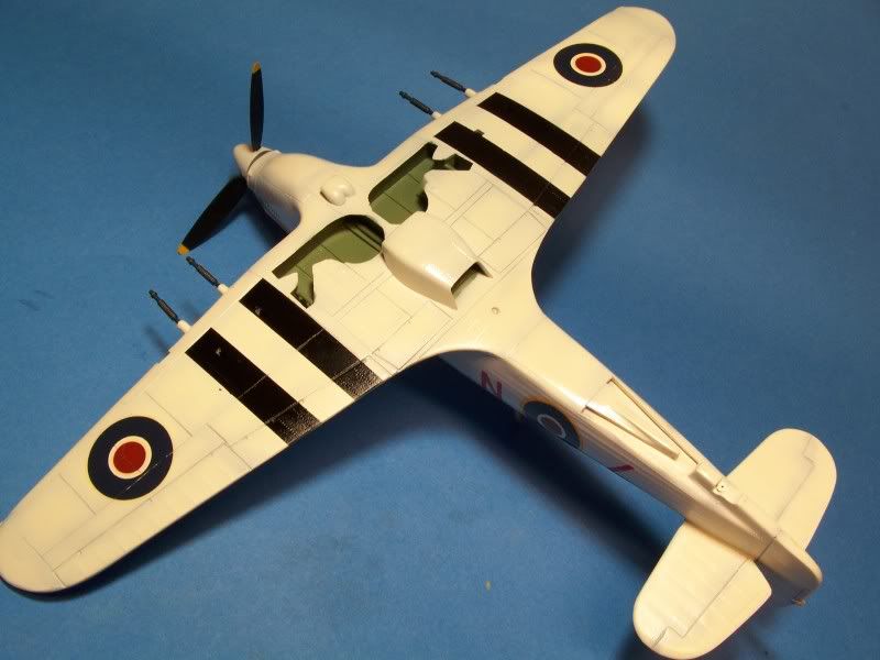

ghodges Posted November 16, 2011 Author Report Share Posted November 16, 2011 She is decaled, except for the "horsey" Porsche-like shields that go under the cockpit. My buddy Jerry is making those for me on his Alps printer, and will be added when I get them! The decals are all form the spares box, and are a mixture of Microscale and old War Eagle decals. "Nicki" was done with individual dry transfer lettering, applied directly to the nose and then sealed with another gloss coat. The wash is next! Cheers! GIL Link to comment Share on other sites More sharing options...
ghodges Posted November 18, 2011 Author Report Share Posted November 18, 2011 The wash is done! Why is it a plane looks so dirty AFTER it's been washed..... GIL Link to comment Share on other sites More sharing options...

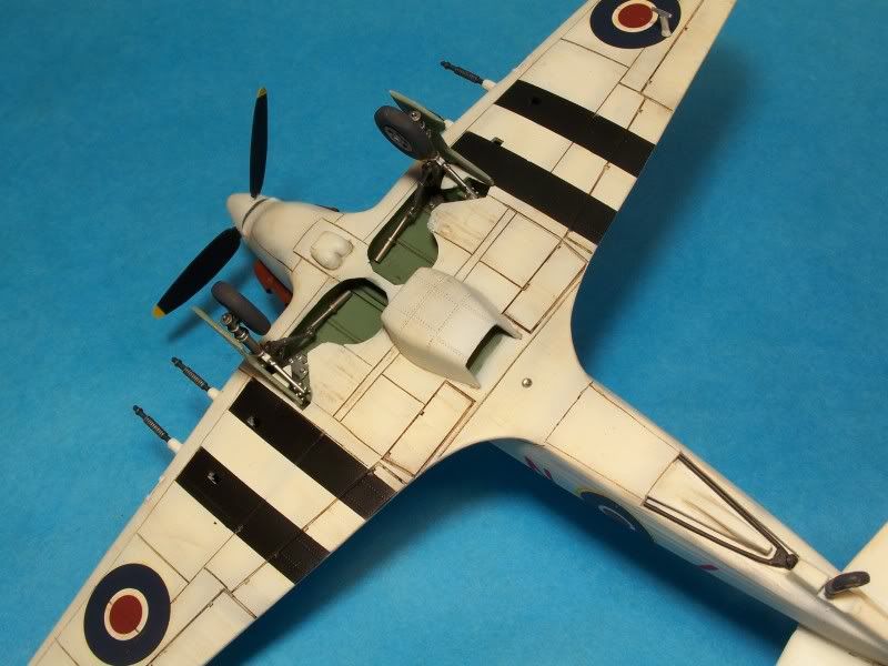

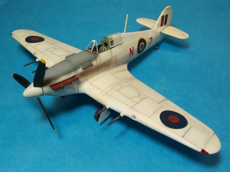

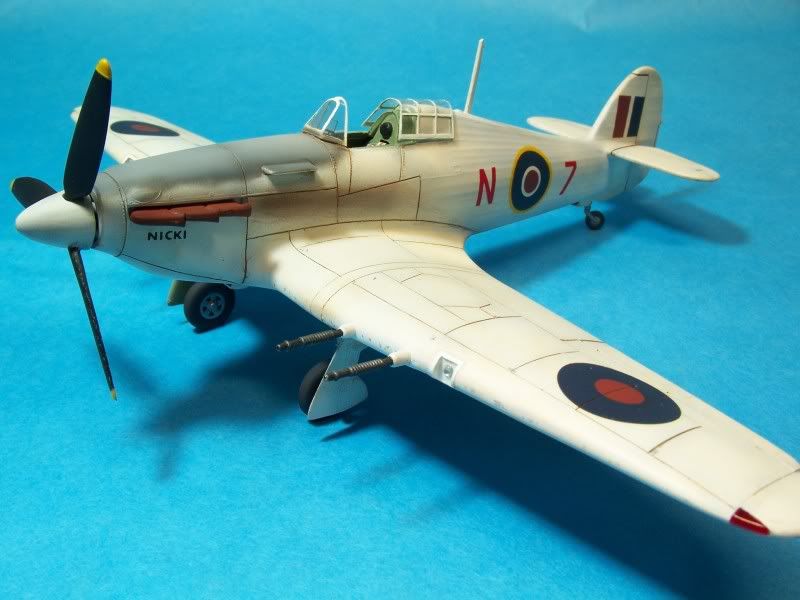

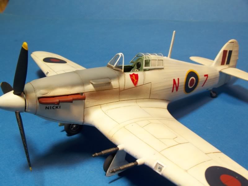

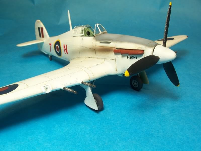

ghodges Posted November 21, 2011 Author Report Share Posted November 21, 2011 (edited) Except for the 2 shield decals mentioned above, she is fini! The landing lights are MV lenses with clear tape covers. The windshield and canopy are Falcon vac items. Overall, I'm happy with the way it came out. It has too many warts to win at a show, but I'll proudly display it none the less! Questions, comments, and critiques welcome! Cheers! GIL Edited November 21, 2011 by ghodges Link to comment Share on other sites More sharing options...

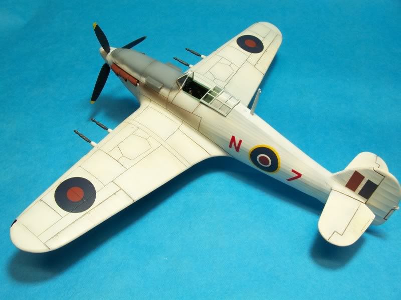

ghodges Posted December 2, 2011 Author Report Share Posted December 2, 2011 Now she's REALLY done! With the shield... and plain Jane (without)... Viva le differance! GIL Link to comment Share on other sites More sharing options...
