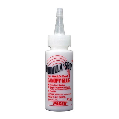

R/C canopy glue has always been a go to for me.  Dries perfectly clear, cleans up with water, tacks up pretty quickly and doesn't fog clear plastic.  Not sure what more you could ask for.
ZAP Glue ZAP Formula 560 Canopy Glue PAAPT56 Misc. Adhesives Fillers - Picture 1 of 1
